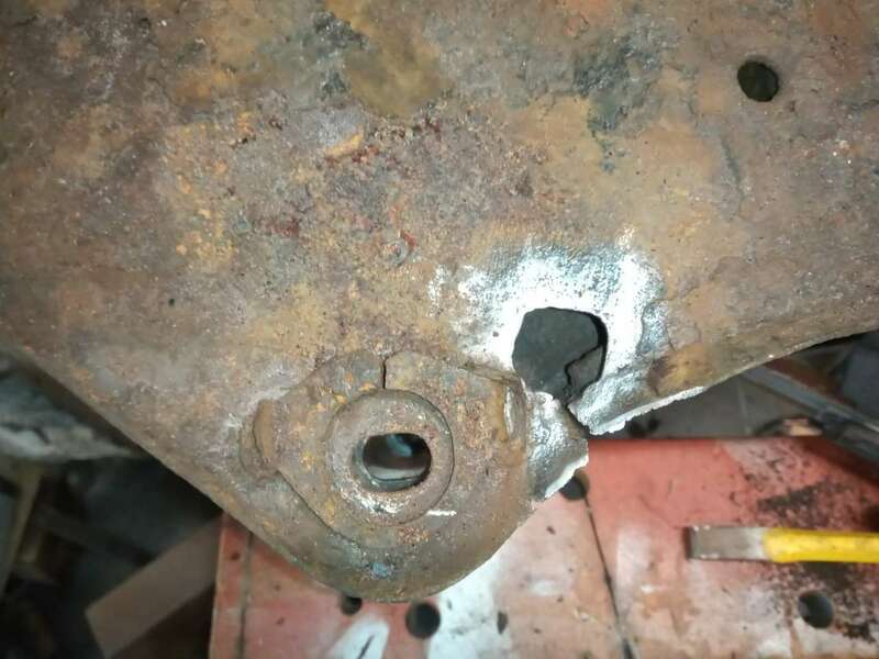

Marina door handles Posted March 20, 2023 Posted March 20, 2023 As some of you may know courtesy of my recent car buying threads, my old daily driver has thrown most of its toys out of the pram. About a month ago I started getting a bit of light bearing whine, this eventually became more of a full on underground train impersonation. After checking the car over I traced it to one of the rear bearings, I also discovered that both rear shocks had oil slicks running down them. I dragged the car into the garage and over the pit and started digging into the issues, I figured I would just unbolt the hub carriers and pull the shocks out, easy right? Nope, although the body is pretty rust free for a near 25 year old car, the multi link rear suspension seems pretty corroded in all the wrong places and unlike the front suspension none of it has been apart in years..... No amount of hammering would free the hubs from the suspension arms, so I decided to remove the arms from the subframe. As I examined the subframe I found a crack and a rust hole rather close to the left rear arm. This could well explain why I am getting a weird judder when turning sharp left out of junctions! 😗 Crack and hole (that sounds wrong!) circled and you may also notice that I had to get the grinder out to slice through the bolt, carefully running it between the arm and the subframe, chomping through the rubber bush before I could get the bolt..... Most the of the passenger side suspension bolts required fairly mediaeval methods to remove them, new nuts and bolts will be needed! After much persuasion the arms came off, meaning I could drag the complete suspension units to the bench and work at them from a more comfortable angle, pin them in the vice and attack them with the angle grinder and the ugga dugga gun..... Essentially the carriers have a long bolt running through them, picking up the suspension arms at both ends. On the passenger side one, removing the nut from the end did nothing the arms were seized to the bolt and the bolt seized the carrier... To get it out I cut the head off the bolt, then put the nut back on and set the ugga dugga gun to do up, essentially pulling the bolt the wrong way through the carrier, kinda brutal but it worked.. A very crap bit of potato shop to show the offending bolt before it all came apart and I lost my enthusiasm for taking pictures... A few days later I got back on it, next stage after freeing off all the arms from the hubs was to take the exhaust off, drop the diff and carrier to free the crusty subframe.. Then after a brief fight with the crusty bolts I got the subframe off the diff, think it looks a bit grumpy about the whole ordeal? But more importantly I could have a good look at the subframe in all its crusty glory.. Will it weld??? Looks like it will the metal is just thick enough. So far so good I think, this little project has taken days and days and there was a small matter of panic buying a Honda part way through and if you were wondering were the Rover has got to...... Its just behind the Forester being ignored, excuse the mess... And yes that is a B series engine just sat there and no it doesn't belong in either of those cars. Anyway, the next stage is going to be weld the subframe and make sure I am happy with the result, then fight with the subframe to diff bush remnants as they need to come out. Then drop the fuel tank (yes really) as the brake lines are getting rather crusty and run above the tank and are inaccessible. Whilst its all apart, it makes sense. Thanks for reading please unlike and subside...... AnnoyingPentium, theshadow, BlankFrank and 26 others 29

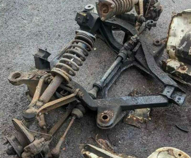

Asimo Posted March 20, 2023 Posted March 20, 2023 Lucky Forester to get all of your effort! I was very dissappointed when my old Subaru needed a bit of rear subframe welding at about 10 years old and it was dead at 13 years. Japanese brands seem to make no effort at all to protect subframes and suspension parts. Compare the pristine* Triumph subframe that @SiC found under his utterly rotten Dolomite. Marina door handles, theshadow and Scruffy Bodger 3
SiC Posted March 20, 2023 Posted March 20, 2023 That was protected by decades of oil loss from the engine though! Maybe if Japanese cars leaked oil, they'd do a bit better. Marina door handles 1
RoverFolkUs Posted March 20, 2023 Posted March 20, 2023 Aha, the infamous Subaru long bolt! Great perseverance, but make sure your welding to the subframe is top notch as some MOT testers will take a dim view to subframe repairs. They're not technically allowed, but if done well enough and "appears to be as strong as original" then a friendly tester may pass it Marina door handles and tommytwo 2
Blake's Den Posted March 20, 2023 Posted March 20, 2023 Yeah, Subaru rust. I've been there before, twice! The last time resulted in me utilising an Arnold Clark we'll by any car thing to get rid of it. Marina door handles and Datsuncog 2
Marina door handles Posted March 20, 2023 Author Posted March 20, 2023 1 hour ago, RoverFolkUs said: Aha, the infamous Subaru long bolt! Great perseverance, but make sure your welding to the subframe is top notch as some MOT testers will take a dim view to subframe repairs. They're not technically allowed, but if done well enough and "appears to be as strong as original" then a friendly tester may pass it Good point I will bear that in mind, I might show a friendly MOT tester my handiwork before I bother re fitting it to make sure I am not wasting my time. RoverFolkUs 1

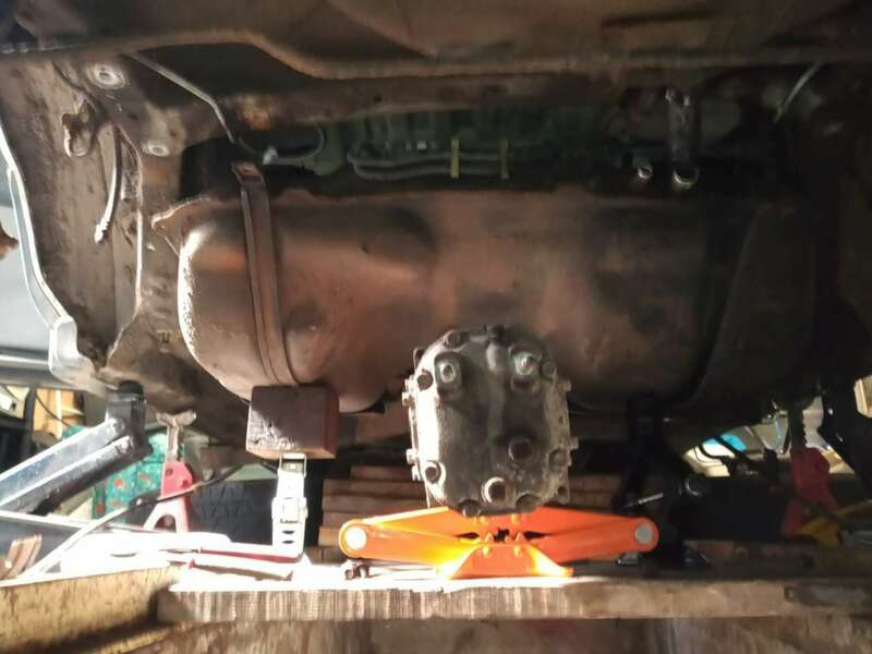

Marina door handles Posted April 5, 2023 Author Posted April 5, 2023 Update no 235783653432.1 Todays job draining the fuel tank (because I want to replace the brake lines that run above it). Unfortunately its got close to a full tank, the original intention was to run it dry before taking it off the road but the noise from the bearings and the sloppy handling courtesy of the shot dampers meant it came off the road much quicker than anticipated... Not really a fun job unless you like the smell of petrol, I kinda do but only in small doses, I am sure 4 star smelt better! Anyway after carefully unbolting the access panels (pickup and fuel gauge sender).... I dug out the new and as yet unused in an actual car MGB fuel pump (doesn't everyone have one of those lying around?) and jury rigged it to a car battery. And then set it to work, after filling four small-ish jerry cans and the tank on the lawn mower, it pretty much emptied one half of the tank and by this point my brain had enough of the smell. Stay tuned for another exciting update...... theshadow, stuboy, Datsuncog and 2 others 5

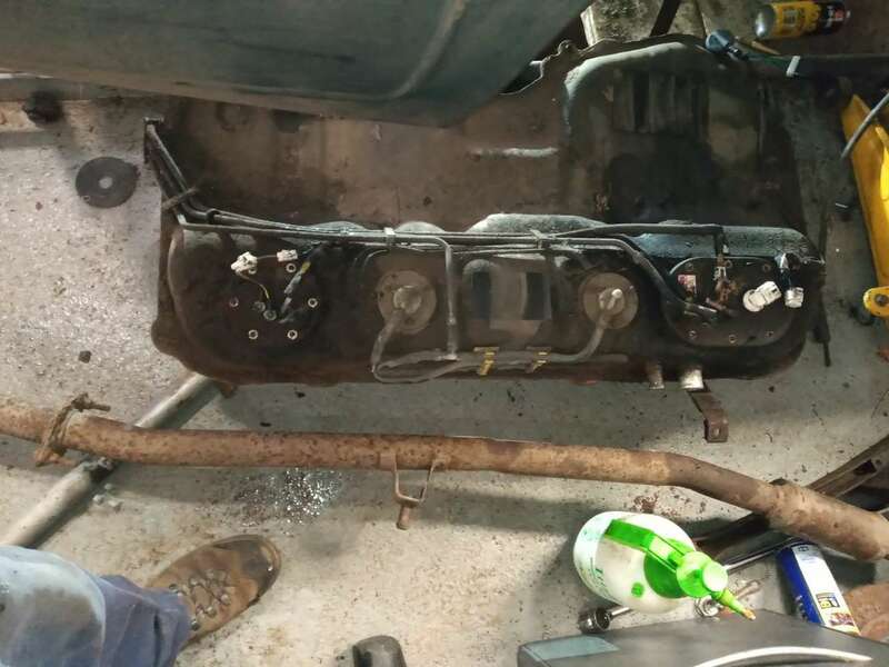

Marina door handles Posted April 6, 2023 Author Posted April 6, 2023 Progressing slowly on the fuel tank removal job. Drained as much as I could from the other side of the tank, then started on disconnecting everything underneath. Had to nick the scissor jack out of my new Honda and one out of the Forester itself to create a safe way to lower the tank. Amazingly I only broke one clip and snapped the end of one fuel line, during the process that's almost feels like a win! Obviously I did manage to cover my self in petrol but thats normal right? Jacks in place. Coming down And out... So much space! Tanked... Not much to show for quite a lot of work! Next jobs are putting the new shock absorbers together (McPherson strut), replacing the brake lines and repairing the broken fuel evap line, will the pictures be any better? Tune in next time to find out! theshadow, Asimo, Shirley Knott and 3 others 6

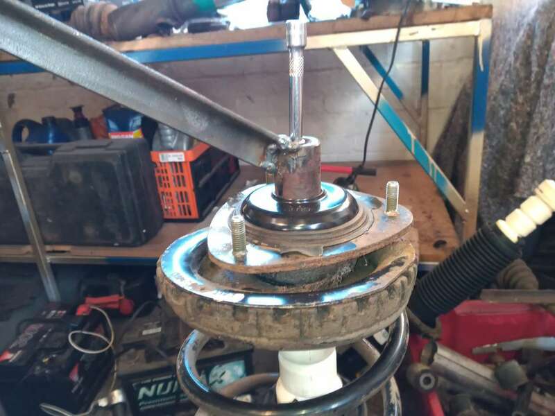

Marina door handles Posted April 7, 2023 Author Posted April 7, 2023 Well it was a good Friday to do some struts... The best part was I had to crack out the welder... To do struts WTF?! Well thanks to an awkward part of the design, the nut that holds the strut top mount to the strut is deeply inset and the strut itself has an Allan key hole in the top to stop it spinning (as you do up the nut). None of my spanners were deeply off set enough to fit so I abused a shabby old 21mm impact socket and welded it to some angled bar... This worked a treat.... That's pretty much it, exciting huh? Tune in next time....... Tickman, mk2_craig, rainagain and 6 others 9
EyesWeldedShut Posted April 11, 2023 Posted April 11, 2023 1 minute ago, mercedade said: Top tool fabbing skills. 2023 AutoShite FrankenTools Nomination right there Rocket88, AnnoyingPentium, Marina door handles and 1 other 4

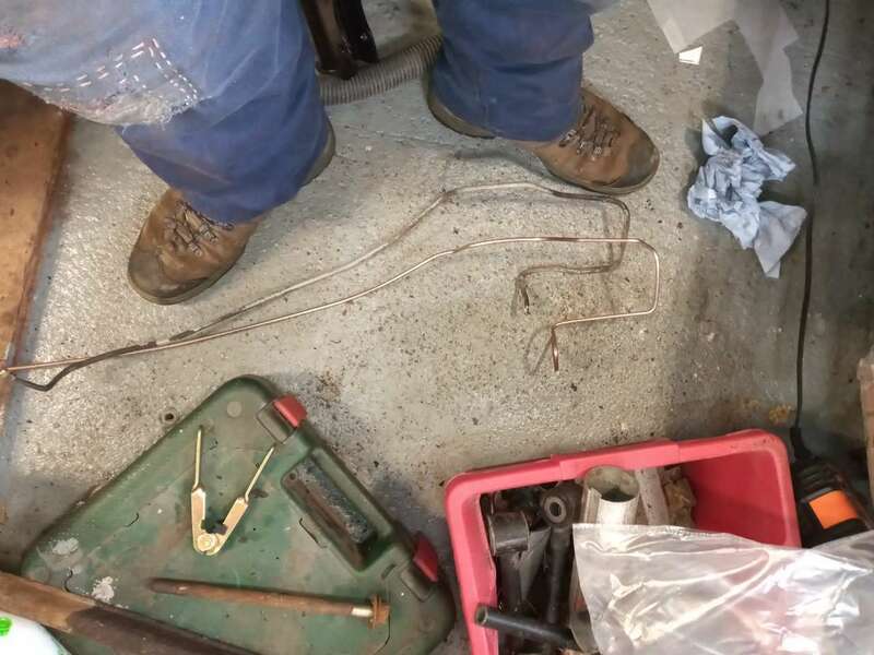

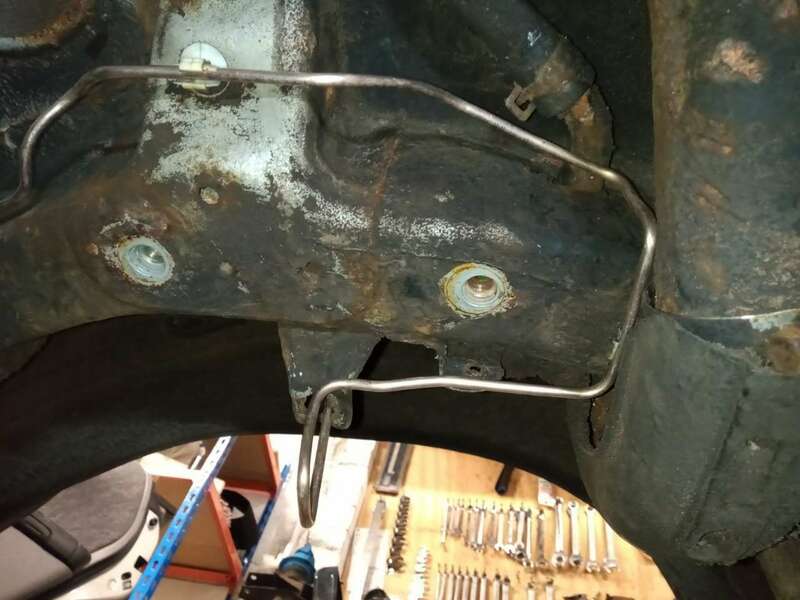

Marina door handles Posted April 15, 2023 Author Posted April 15, 2023 Today was a fairly busy day but I did briefly get in the garage. Turns out I am clearly a bit out of practice doing brake lines, brain fade in 3.....2.....1.. So in case you haven't spotted it, how do you get a flair if you cannot get the flaring tool between the union and the end of the line, muppet! I have now got replace the whole new line I made yesterday good job Cunifer isn't stupidly expensive....... Also I managed to kink the original steel hard line whilst trying to put a flair in. So I had to cut more line off and fit another union further down. Not an ideal start but its still progressing, sort of. rainagain, High Jetter, Popsicle and 1 other 4
Marina door handles Posted April 22, 2023 Author Posted April 22, 2023 Well the work hit a bit of an impasse, I had a bit of a technical issue, I started to notice that my pipe flares were quite inconsistent.. After a bit of trial and error and initial assuming I was the problem this bad workmen got to blame his tools! Turns out the thread in my brake flare tool was eating itself and causing the issue, bit annoying because although I have had this a few years it hasn't had a hard life at all.... So I dug deep (into my bank account) and bought a Sykes Pickavant Flaremaster. Its a bit of a revelation, really nice consistent flares, which means I have now completed the main brake line runs on both sides. I need to wait for new flexi brake pipes to arrive so I can complete the circuit and actual bleed and test the lines but I am a lot more confident now. Hopefully this new tool will last, it seems well made and I do have future projects in mind so hopefully it will be worth the investment. More like it! Both pipes in place. yep more pictures in the half darkness.... Anyway that's all for now, might post something other than boring brake lines next time! Minimad5, Dyslexic Viking, rainagain and 4 others 7
