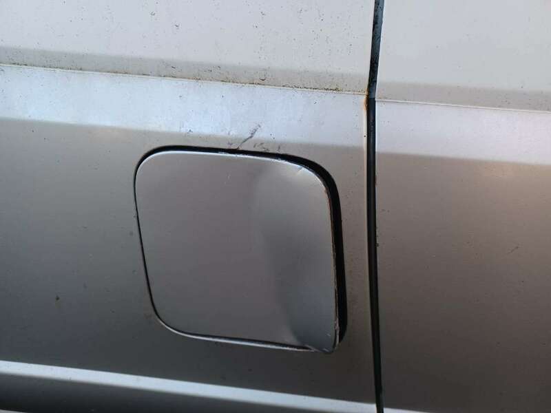

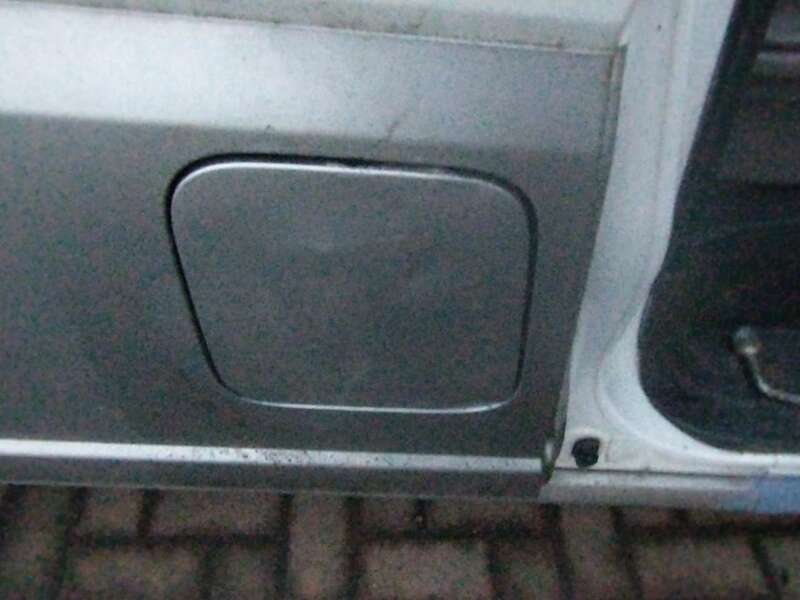

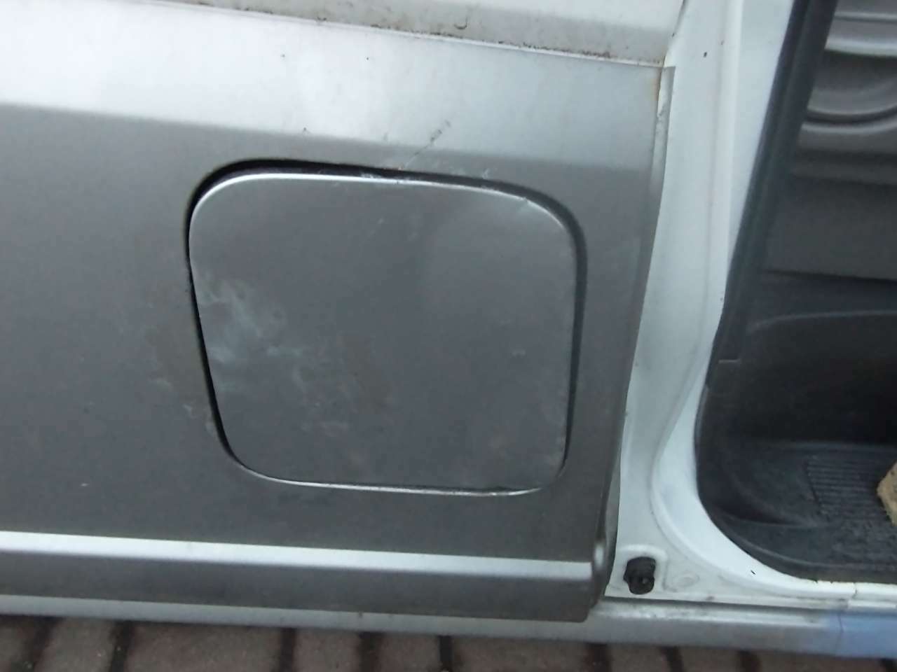

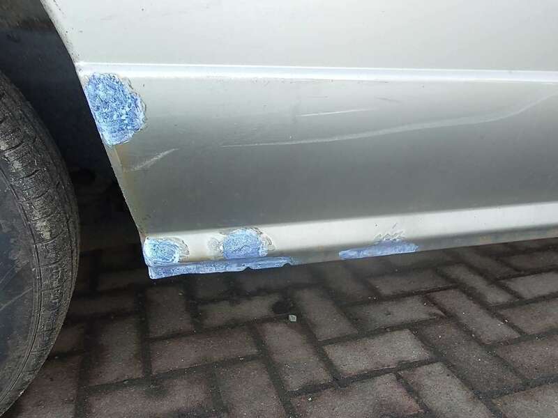

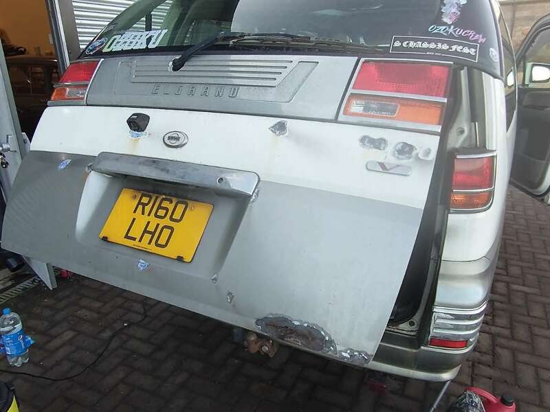

320touring Posted February 2, 2023 Author Posted February 2, 2023 As the week has progressed, the novelty of cruising about in dog scented, belt squealing van has worn somewhat thin.. To whit, an attempt to rectify a fair few issues was made yesterday. Thanks to @jaypee @Supernaut and @captain_70s for their assistance at various points! The first thing that we found was: THAT FUCKING SQUEAK was an easy fix! @jaypee had found a forum post online saying that a sqeal from the alternator was usually due to a belt being too loose. The previous owner had just fitted new belts... @Supernaut found the tensioner bolt The belt was able to be turned to 90degrees initially, so we tightened it until it could only twist 45/50 degrees.. Result? No squeak and a full 14v at idle as soon as it starts. An additional fix was done to the negative connection on the battery so it clamps properly. The second thing we found out was that I am a time served panel beater... As it initially was After application of a hammer and dolly* (block of wood). @captain_70s stopped it popping open as I caressed it. Removed for further fettling Refitted and tweaked by hand It's not @GingerNuttz quality but it is fucking miles better, and worth at least 1mpg due to less drag🤣 I also went round some of the rust blebs, knocking them back then coating them with vactan before some primer. they need done properly but hopefully this will stop any further deterioration until I can complete them. @Supernaut also took a pass at the plastic headlamp lenses with polish. Before after sporty-shite, Coprolalia, theshadow and 21 others 24

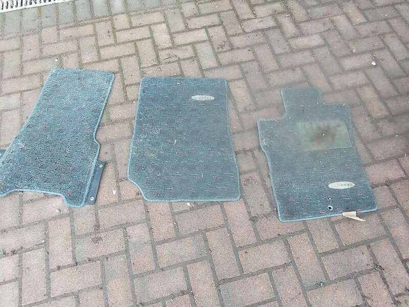

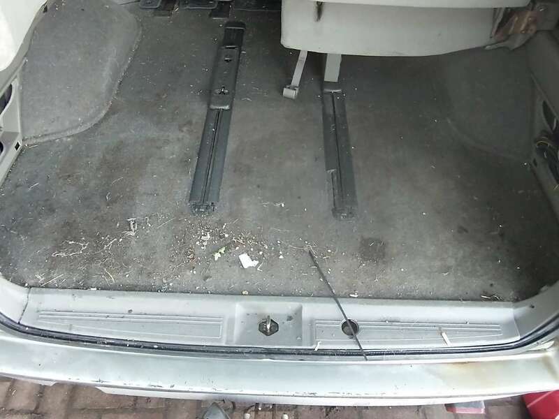

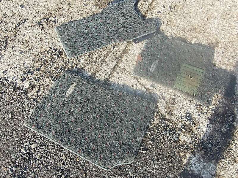

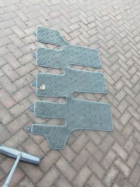

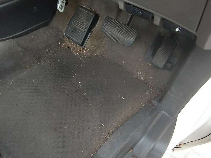

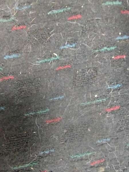

320touring Posted February 2, 2023 Author Posted February 2, 2023 The interior was also attended to. The front mats were removed and the cabin hoovered plenty work there for the hoover, but they came up really well! I also gave the driver and passenger seat an initial hoover, scrub and wet vac - still some work to do but significantly less mank The mats needed a stiff brush to remover the white dog hair, then hoovering before a scrub and second hoover to dry them out. Before After (laid out to dry in the sun) They look great back in! The back passenger compartment got pretty much the same treatment - mats out/brushed and hoovered and the carpet all swept and hoovered. The seats were all hoovered too If you look closely you can see the plastic discs that slide beneath the seat rails to locate the mats, and the poppers that let the two rear sections securely connect. They are belters of mats - @Jim Bell would barely be able to control himself if he were to see them in the flesh. there was plenty of detritus to be removed from the rear. after all that, the interior was a significantly more pleasant place to be - here we see @Supernaut enjoying* it Schaefft, dome, Rust Collector and 36 others 27 12

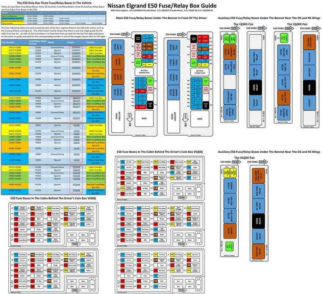

320touring Posted February 3, 2023 Author Posted February 3, 2023 One cause of consternation on Wednesday was an inability to locate the fuse that controls the supply to the windscreen washer motors. I get no noise when operating either the front or rear ones, and the bottle is tucked away in the inner wing. So before I pulled it apart, I wanted to check the fuse .. The only info I have to go on is that the fuse should be on an internal fuse box - but the guide I have to read is too blurred for use on my phone.. Anyone any ideas? It's a 1998 e50 Elgrand thanks
captain_70s Posted February 3, 2023 Posted February 3, 2023 The internal boxes have have fuse 3 down as "front wiper". Can't see anything directly related to the washers... 320touring 1
320touring Posted February 3, 2023 Author Posted February 3, 2023 47 minutes ago, captain_70s said: The internal boxes have have fuse 3 down as "front wiper". Can't see anything directly related to the washers... Yeah I saw that - wipers work ok, so I assume that fuse is alright.. I'm going to have to get into the washer bottle to check, ain't I..

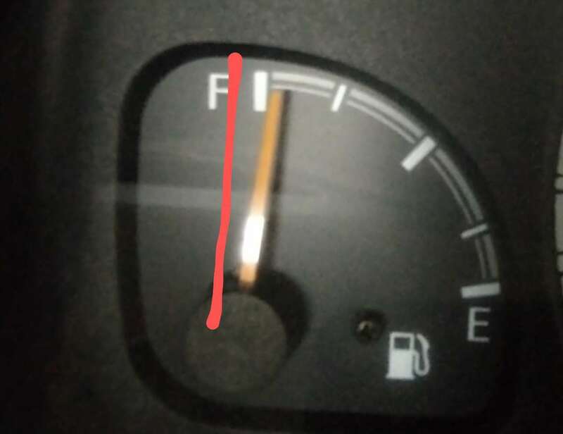

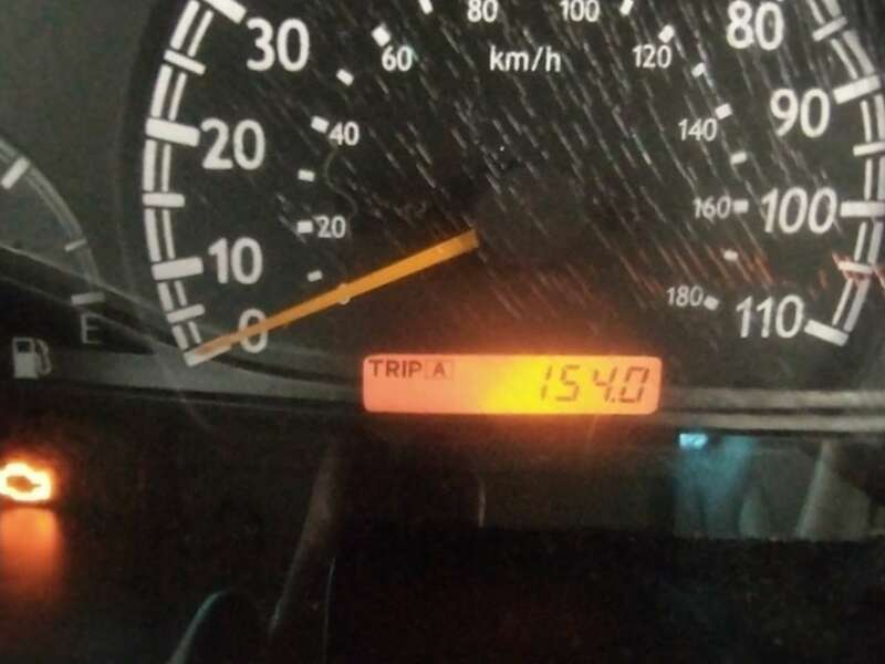

320touring Posted February 3, 2023 Author Posted February 3, 2023 What's moar fear inducing than being in the same room as Priti Patel when she has not been fed an asylum seeker for 15 mins? That's right, filling the tank on a new car .. This has been on fleet for precisely 8 days and 20hrs at the time of writing. So far it has all been splash n dash. But not today. Today, I had the testicular fortitude to avail myself of all the lovely E10 that the ElGrand would swallow.. How much? £91 quid!!! Now, a 3.3v6 coupled to a 1990s 4+ OD autobox and stuffed in a brick shithouse is never going to be a recipe for high MPG. The aim of this (costly) experiment is to see if TOLERABLE economy can be achieved. Off then to my mates in Edinburgh for a most convivial afternoon. Handily, it dropped no petrol whilst being filled or sitting at my mates. There and back, 154km was covered (95.7miles) No idea how much fuel has been used but the gauge has gone from touching the F (red line) to where it rests over 154km ( 95.7 miles). It appears that not kicking the hoor ae fuck oot it constantly has dramatically improved fuel consumption... Who would have guessed?! I shall continue to pootle it aboot and see what number we land on.. If it did 25mpg on a run that wouldn't be the worst privatewire, RoadworkUK, AnnoyingPentium and 4 others 7
