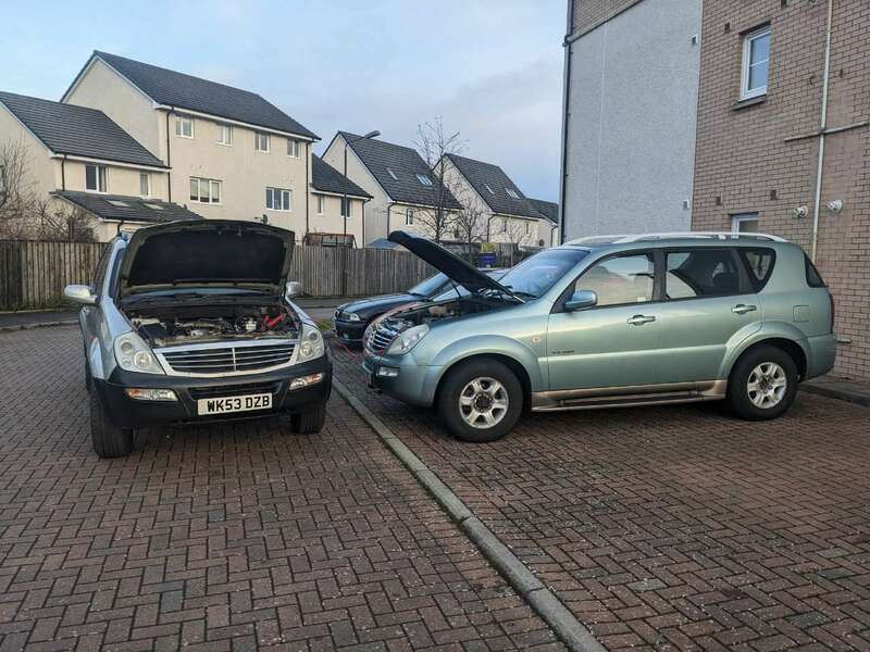

Supernaut Posted January 15, 2023 Author Posted January 15, 2023 I just went out and put a multimeter across the battery. 13V. The indicator relay seems to have unstuck itself, but it did stick slightly when I was flicking them on and off, but went off again. I tried to crank it and it shat itself though. Definitely seems like an earth issue on the starter. Jim Bell and Mrcento 2
Supernaut Posted January 15, 2023 Author Posted January 15, 2023 Just had @Lacquer Peel round to compare and contrast. Swapped the battery from his one over to mine, and mine cranked over perfectly. So it does need a new battery. We still couldn't get it to start, as it seems to need new glow plugs too. The light comes on and the relay clicks, but it just sits there puffing half-burnt diesel out the exhaust without firing. Progress has been made, anyway! I have a rough idea of what it requires. AnnoyingPentium, Jim Bell, Coprolalia and 8 others 11

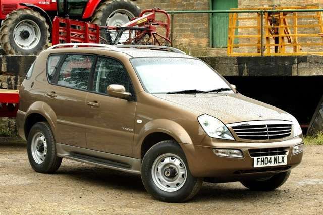

Lacquer Peel Posted January 15, 2023 Posted January 15, 2023 With enough cranking I think it would have started but @Supernautwas worried about flattening my battery. I think it's a decent enough vehicle that has been a bit neglected. It is interesting to see the differences between an E model and my high faluting SE but this thing has extras like a sunroof and side steps that mine doesn't. The E should have steel wheels like this brown lad which also has that side skirt/side step setup. aldo135, loserone, Amelia and 12 others 15

Out Run Posted January 15, 2023 Posted January 15, 2023 I've never seen an E. Just S and SE. Mine's an S. no idea what they stand for. AnnoyingPentium, somewhatfoolish, Lacquer Peel and 2 others 1 4

Zelandeth Posted January 15, 2023 Posted January 15, 2023 I think step 1 with regards to diagnosing electrical madness on anything made this side of around 2000 is to make sure you've got a decent battery fitted. With even slightly marginal system voltages all sorts of ECUs can end up throwing their toys out of the pram in strange, unpredictable and on occasion exciting ways. I've no experience with these vehicles myself, but know two folks who owned them back when they were pretty new and they always seemed like decent honest work horses. Lacquer Peel 1
320touring Posted January 15, 2023 Posted January 15, 2023 5 minutes ago, Zelandeth said: I think step 1 with regards to diagnosing electrical madness on anything made this side of around 2000 is to make sure you've got a decent battery fitted. With even slightly marginal system voltages all sorts of ECUs can end up throwing their toys out of the pram in strange, unpredictable and on occasion exciting ways. I've no experience with these vehicles myself, but know two folks who owned them back when they were pretty new and they always seemed like decent honest work horses. These are all mechanical badboiz with an engine closer to your camper than a C Class😃 Relatively simple to diagnose, but certainly a good battery should cure most of the ills. Out Run and Lacquer Peel 2

Lacquer Peel Posted January 15, 2023 Posted January 15, 2023 28 minutes ago, 320touring said: These are all mechanical badboiz with an engine closer to your camper than a C Class😃 Relatively simple to diagnose, but certainly a good battery should cure most of the ills. I wish it was all mechanical so I could turn up the fuel. But there is minimal electronickery.
garethj Posted January 15, 2023 Posted January 15, 2023 Have you tried connecting a handy jump lead from the battery negative to a good ground on the engine block? A free first check to see if that heats up the glow plugs and awakens the starter. Otherwise I agree with others that a fresh battery is a good start, as yours is marginal anyway.
Supernaut Posted January 16, 2023 Author Posted January 16, 2023 10 hours ago, garethj said: Have you tried connecting a handy jump lead from the battery negative to a good ground on the engine block? A free first check to see if that heats up the glow plugs and awakens the starter. Otherwise I agree with others that a fresh battery is a good start, as yours is marginal anyway. Yes, we tried all that before swapping in a known good battery. The battery sorted it. The glow plug relay clicks and the light comes on but it struggled to start. I suspect it's probably on its original 18 year old glow plugs. Also, I'm really disappointed it's been upgraded to alloy wheels! Those steelies look ace! Jim Bell, JMotor, Dyslexic Viking and 1 other 4
