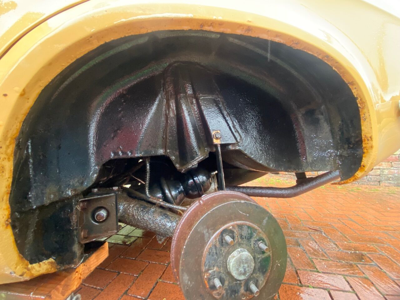

Another quick update, rear hoops fitted today and I took the opportunity to clean out the rear wheel wells. I’m pleased to say they’re still looking good shape, when the weather improves I’ll was a load of wax in there to keep things nice. Today however was bitterly cold with the odd hail shower to keep things fresh. Obv I smashed my knuckles on something which hurt to the max due to the low temperature but it’s another job ticked off the list.

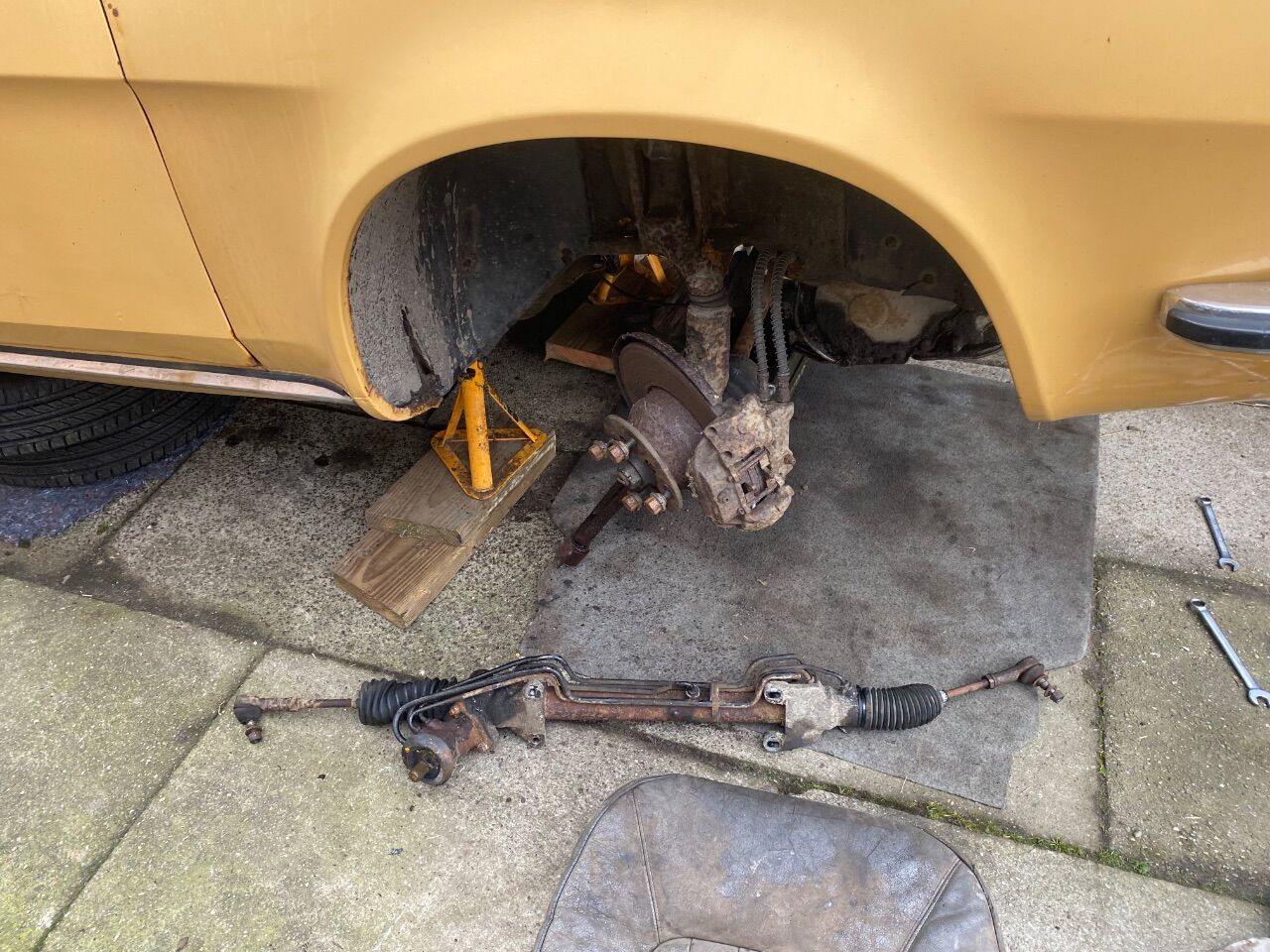

A few weeks ago I topped up the O/S Hydragas fluid as since I’d had the Princess it had looked a little low. A few pumps on the “Liquid levers” Hydragas gizmo had things at an even keel. I always find pumping up Hydragas suspended cars a little nerve racking. Years ago I ended up with an Allegro on the deck due to a faulty low loss connector but no such issues this time around.
After moving the Princess around on the drive a bit to settle things out I stood back to admire my work only to notice to my horror a puddle of liquid forming under the OSF of the car. What was it?? The suspension wasn’t going down so It wasn’t suspension fluid. An inspection showed the red liquid was ATF which was spraying from the steering rack. One of the steel pipes on the rack had rusted through and was liberally rust proofing the underside of the car.  Very annoying but better it goes at home than on the M6 or something.
The pipe wasn’t removable in situ so the rack was taken off and the errant pipe taken to a local classic hydraulic specialist who made up a new pipe the following day. With everything refitted the rack was leak free and after all the air was finally purged from the system worked perfectly again. While the rack was off I took the opportunity to replace the O/S rack gaiter as it looked pretty tired, the N/S being replaced a few months ago when it split.

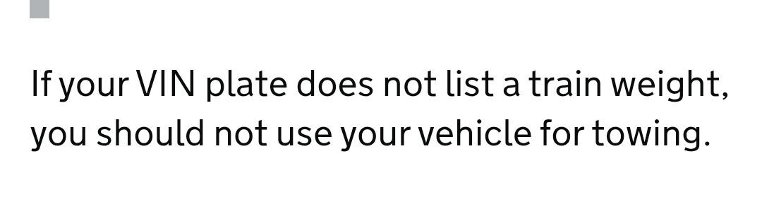

The rules are surprisingly simple!
I reckon you could argue a legal tow weight if it listed in the owner's manual or factory workshop manuals...
The argument is that a P4 does not have a VIN plate, it has a chassis plate. Back in the day the rule was you could tow up to the kerb weight (whick you could get from the handbook or your local weighbridge) and you could do 40mph on a single carriageway road and 60 on a dual or motorway. If the trailer weighed more than the kerb weight then it was 40mph max everywhere. Then it became 50 on all roads including motorways if you were below kerb weight and displayed a 50 sticker (which is why you sometimes see a 50 sticker on old caravans and trailers) and 40 if the trailer was over.

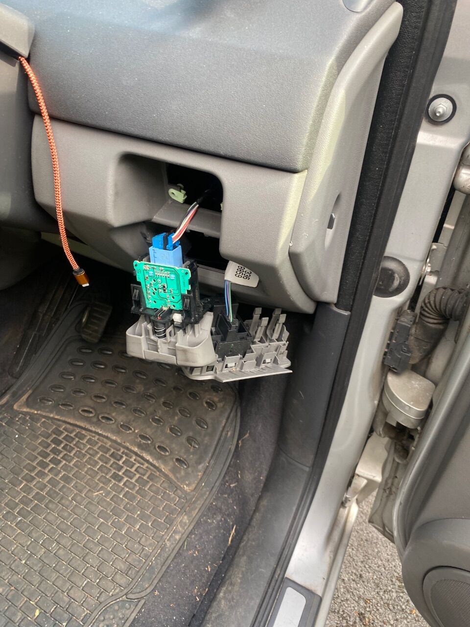

The Scénic has been a bit of a pain recently, the parking brake often refusing to release. This culminated in it gluing itself to My Dads driveway. The fault can be in a multitude of places, the switch, the parking brake unit or the wiring which has a habit of corroding when the scuttle drains get blocked and the floor pan gets flooded, knackering multi plugs in the loom.
Removing the electronic parking brake switch I was able to access the micro switches that  apply and release the parking brake. By manually operating one of them the brake would release. It seemed the plastic rod operating the switch had worn away a little with use, a hot screwdriver has used to re profile the rod and after a period of trial and error things seem to be working again. To celebrate the Scénic was treated to a driveway valet. Lovely!

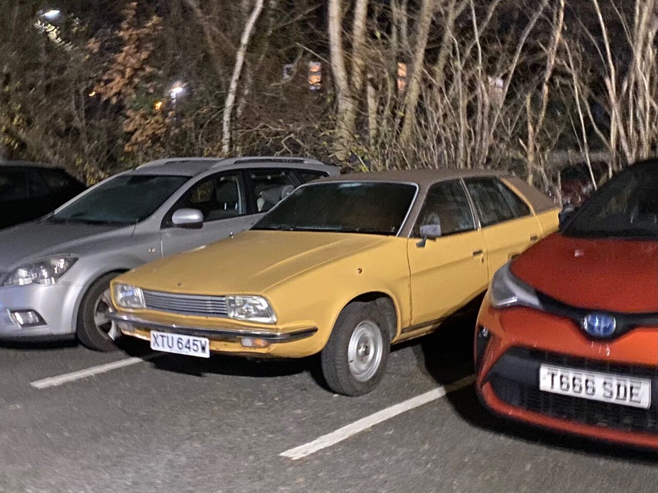

Finally Princess news. We took the wedge on a nice trip out to visit friends, a 60 mile mix of A roads and motorway, the furthest I’ve taken it in one go. The old thing didn’t miss a beat and is quite happy wafting along at 70. Bliss! I’ll be so sad to see It go but I know she’s going to a great home. I’ve every confidence you could get in it and drive it anywhere. Supremely comfortable too. The perfect classic?
