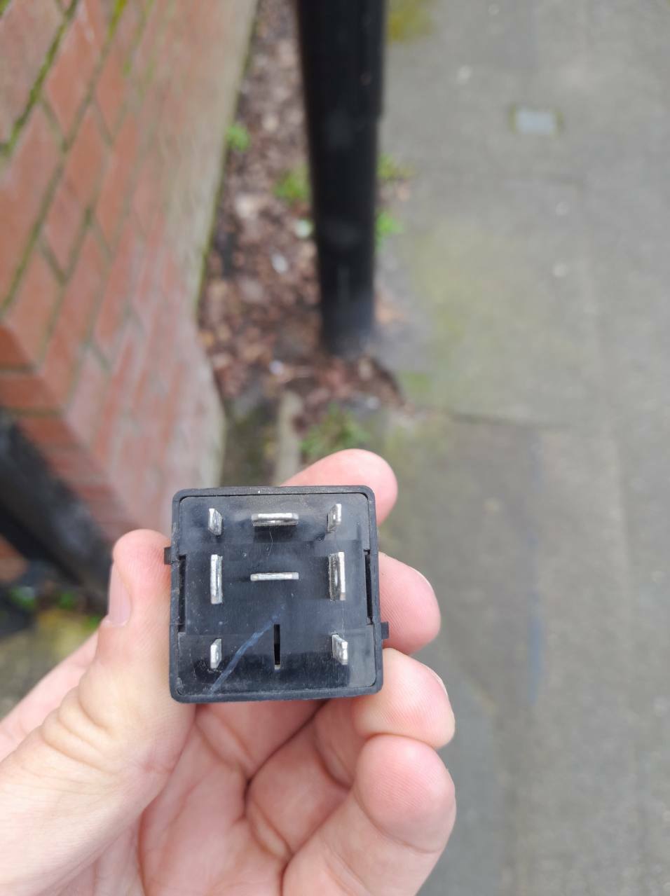

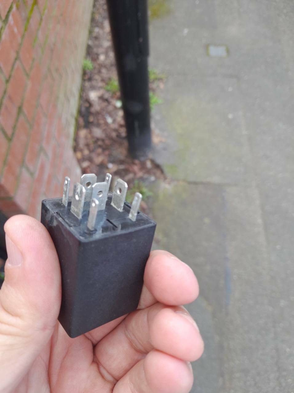

So after asking everyone i know in Rover circles messaging every ebay seller listing 800 parts and ringing round scrap yards even going as far as to ring America.... I still haven't located a relay or anyone who can repair or make one.
I did email Comus relays and Preston relays who both manufacturer car relays but they were unable to help. One thing i do know is it seems to be very rare and unique to the MK1c with slim trip computers only. Its also been some time since ive seen an 8 pin Lucas relay so i am now looking into potentially bypassing the relay without causing other electrical problems with the car.

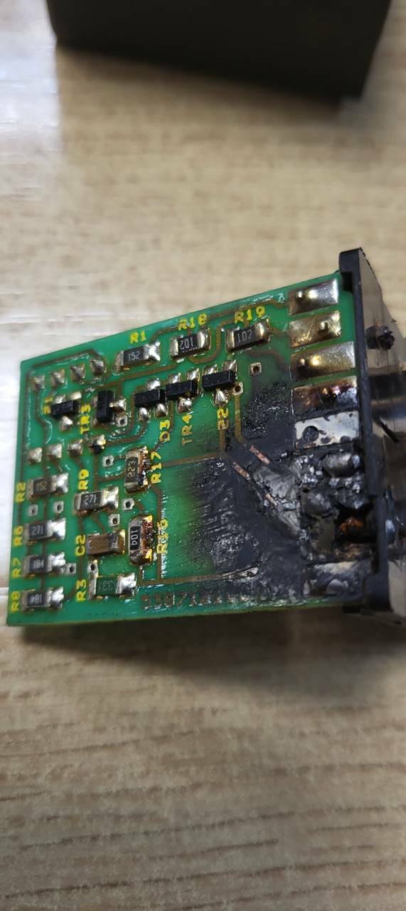

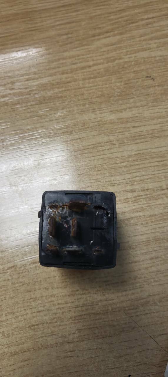

I am looking into getting a batch of these relays remanufactured i have emailed several companies and simply awaiting replies. Does anyone know were i could find a diagram or something showing how the relay works in order to get it remade.
LOOK at the pictures its beyond repair in my opinion.

I am not sure how the relay works or what it does entirely but not only does it seem to send a signal to the trip computer notifying the driver if a fault with the cars lights but it also assists in the functioning of the headlights as without the relay or in my case a blown relay they dont work correctly.....
I should also say that with all MK1c 800s with slim trip computers if theirs a fault with the trip computer unit itself or the trim computer is removed from the car the lights dont work.
