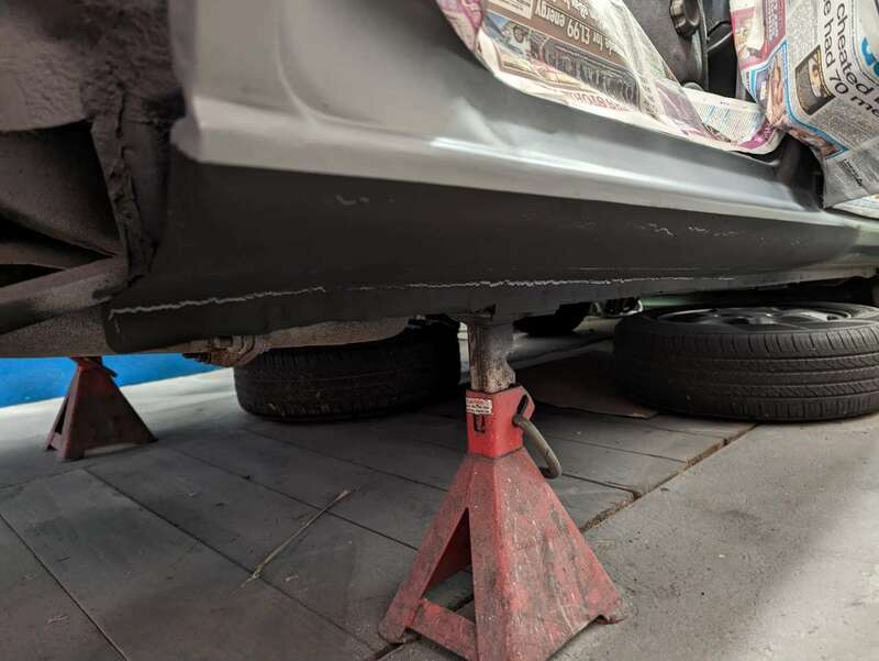

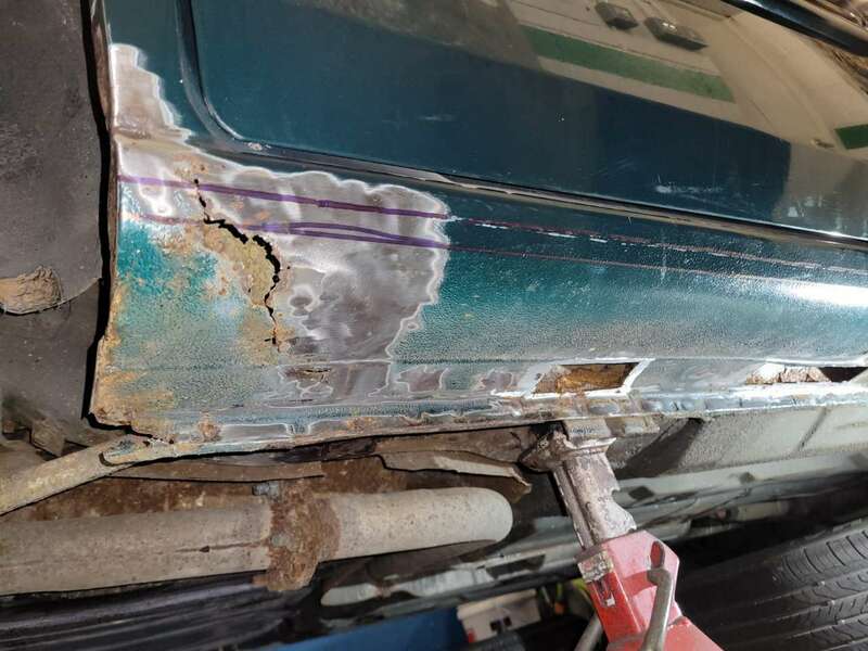

Progress is slow on the grotbags 800. The scabby bit on the offisde sill turned in to holes, bigger holes, inner sill repairs and a home made repair section for the back 1/3 of the sill. Take a look;
We've managed to spend a bit of time on it this week, and we're now close to the point that the sill will be British Racing Green again soon. The stonechip coating was replaced on the new section of sill today;

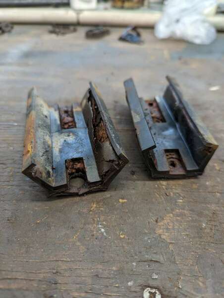

The past couple of weekends have involved fabricating and fitting some new mountings for the front and rear wings, to hold the sides of the bumpers in place. Original replacement items are made of unobtanium, and for good reason - because of their design, over the years they rot and become distored, meaning they don't hold the bumper any more, which causes them to flap in the breeze. See below!
So a tenners-worth of steel, cut, drilled and painted sees some suitable replacements ready to go!

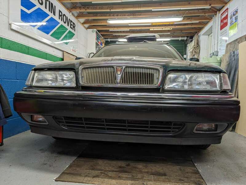

The front end went back together today, with a replacement front bumper in lieu of the knackered original. It was a bonus to find the fog lamps weren't completely rotted, so the backs have been rubbed down, treated and painted so they will live again (the fog lamps are also NLA!)
Back at the other end of the car, the bumper is off for its new brackets. Hopefully by the end of next Sunday it'll be ready to come out of the garage!

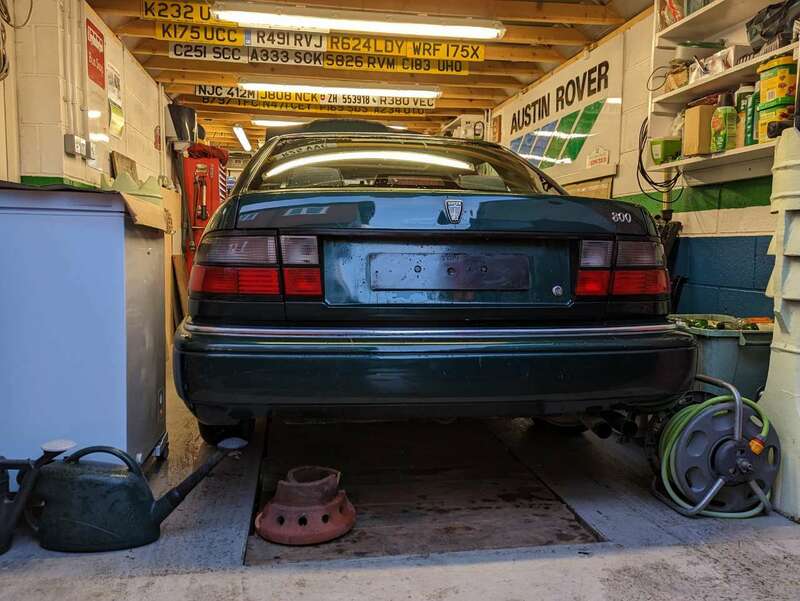

So the weekend just gone, everything was reassembled and the driveway cleared so it could be extracted from the garage and washed. We even got as far as running a clay bar over the panels before it was turned around and reversed back in to the garage. Now it is clean and back under cover the next weekend will see it attached with the machine polisher followed by lotions and potions to try and get it looking a little more loved.
Progress then will slow down again as my mechanic can't fit it in for some much needed attention until the middle of April. I had hoped it would be ready for the Pride of Longbridge event, but it looks unlikely now.
Anyway, a couple of pictures of it out in the open at the weekend;

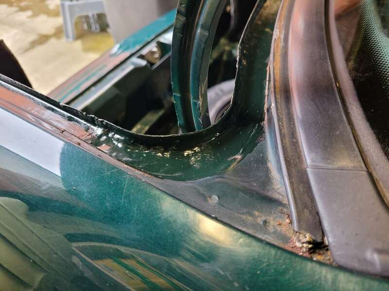

Problem #1 was the discovery that the sunroof tray was letting water in to the cabin. The driver's footwell was wet as was the top corner of the headlining. Dropping the headlining down showed the metal stub that the drain tube attaches to it rotten. I've effected a repair which was to stuff a grommet in to the drain hole, and avoid parking the car facing down hill. Success! This is one to investigate further in the warmer months. For now, crisis averted.
