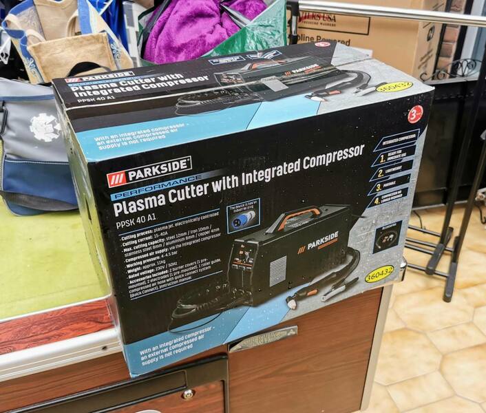

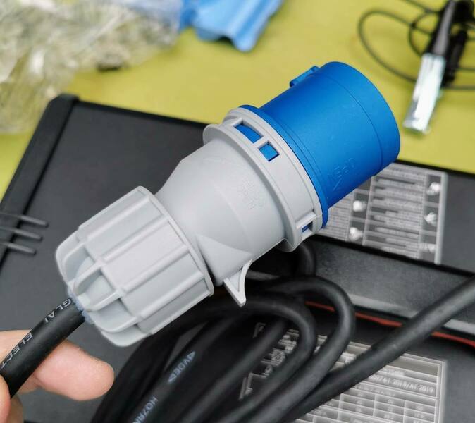

gm Posted February 18, 2022 Posted February 18, 2022 they had a few of them in a local branch i was i yesterday, i didn’t look closely but the photo on the box was of a round plug, the sort you see on building sites and need a transformer for (edit) one of these
Mally Posted February 18, 2022 Posted February 18, 2022 16 amp innit. Can be wired from mains, most garages will have it already Many welders/tyre machines etc need similar supply.
mitsisigma01 Posted February 18, 2022 Posted February 18, 2022 2 hours ago, Mally said: 16 amp innit Looks like 110v 🤔
Sunny Jim Posted February 18, 2022 Posted February 18, 2022 Yep, blue 230v and yellow 110v. somewhatfoolish 1
mitsisigma01 Posted February 18, 2022 Posted February 18, 2022 Just testing , whack a plug on it see what happens 🙄
PhilA Posted February 18, 2022 Posted February 18, 2022 34 minutes ago, mitsisigma01 said: Just testing , whack a plug on it see what happens 🙄 Would probably work really well on 230V. SiC and AnnoyingPentium 2

Dan_ZTT Posted February 19, 2022 Posted February 19, 2022 13 hours ago, gm said: they had a few of them in a local branch i was i yesterday, i didn’t look closely but the photo on the box was of a round plug, the sort you see on building sites and need a transformer for (edit) one of these 16A 230V, as others have said. Commonly used for stage lighting among other things. If it was yellow it would be 16A 110V, as mostly seen on building sites. If it was blue but bigger it would still be 230V but rated 32A. If it was red it would be 3-phase (and would have 2 extra pins). As you can probably guess I have to deal with all these at work... gm 1

gm Posted February 19, 2022 Posted February 19, 2022 40 minutes ago, Dan_ZTT said: 16A 230V, as others have said. Commonly used for stage lighting among other things. If it was yellow it would be 16A 110V, as mostly seen on building sites. If it was blue but bigger it would still be 230V but rated 32A. If it was red it would be 3-phase (and would have 2 extra pins). As you can probably guess I have to deal with all these at work... blue plug on the photo on the box, might mean something, might mean bugger all, i bought an angry grinder instead (quite a bit cheaper )

Zelandeth Posted February 19, 2022 Posted February 19, 2022 Success - I have taken my part as being a guinea pig. As folks have suggested... Confirmed inside the box. The actual specs which were absent from the listing. So max continuous current draw of 11.6A, but surge of up to 28A if I'm reading that right. Closer peering through the fan grill confirms the suspicion that it is inverter based. I see big caps and transistors attached to big heatsinks. Seems decent enough for the money to be honest. It's hardly the greatest quality item ever made but doesn't feel cheap or flimsy. They *really* want you to do this training course... Mark on the tip shows it has been actually tested (bags were still sealed so it's not just been returned) which is better than a lot of things. At least *seems* decently put together for the money. Sadly it's currently raining horizontally so it'll be a bit before I can actually try it out. mercedade, AnnoyingPentium, gm and 9 others 12
