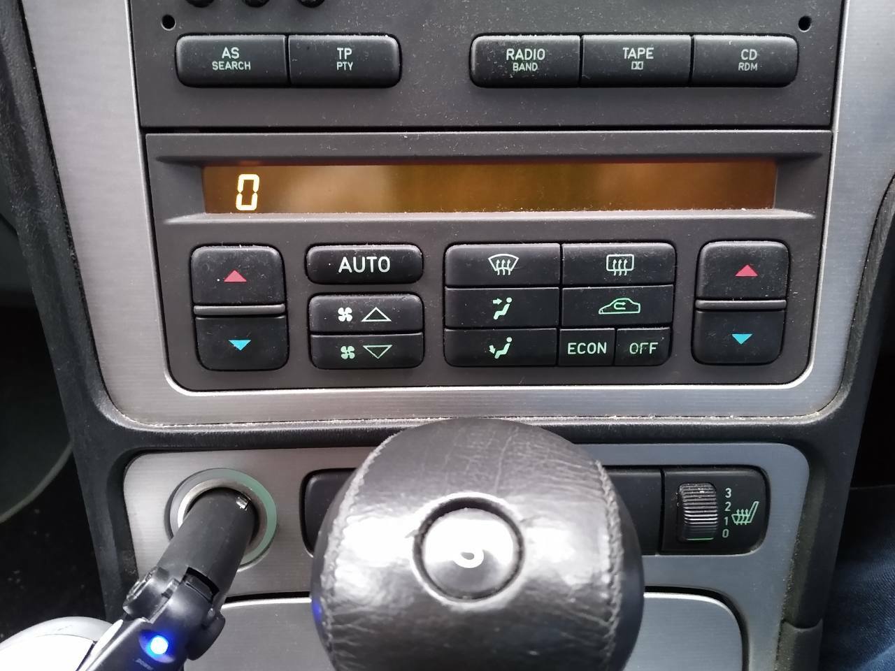

Well bought !    You can run a heater diagnostic check by pressing Auto and Off together on the control panel. And check the pollen filter,often ignored by owners!

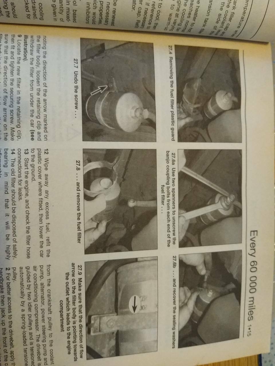

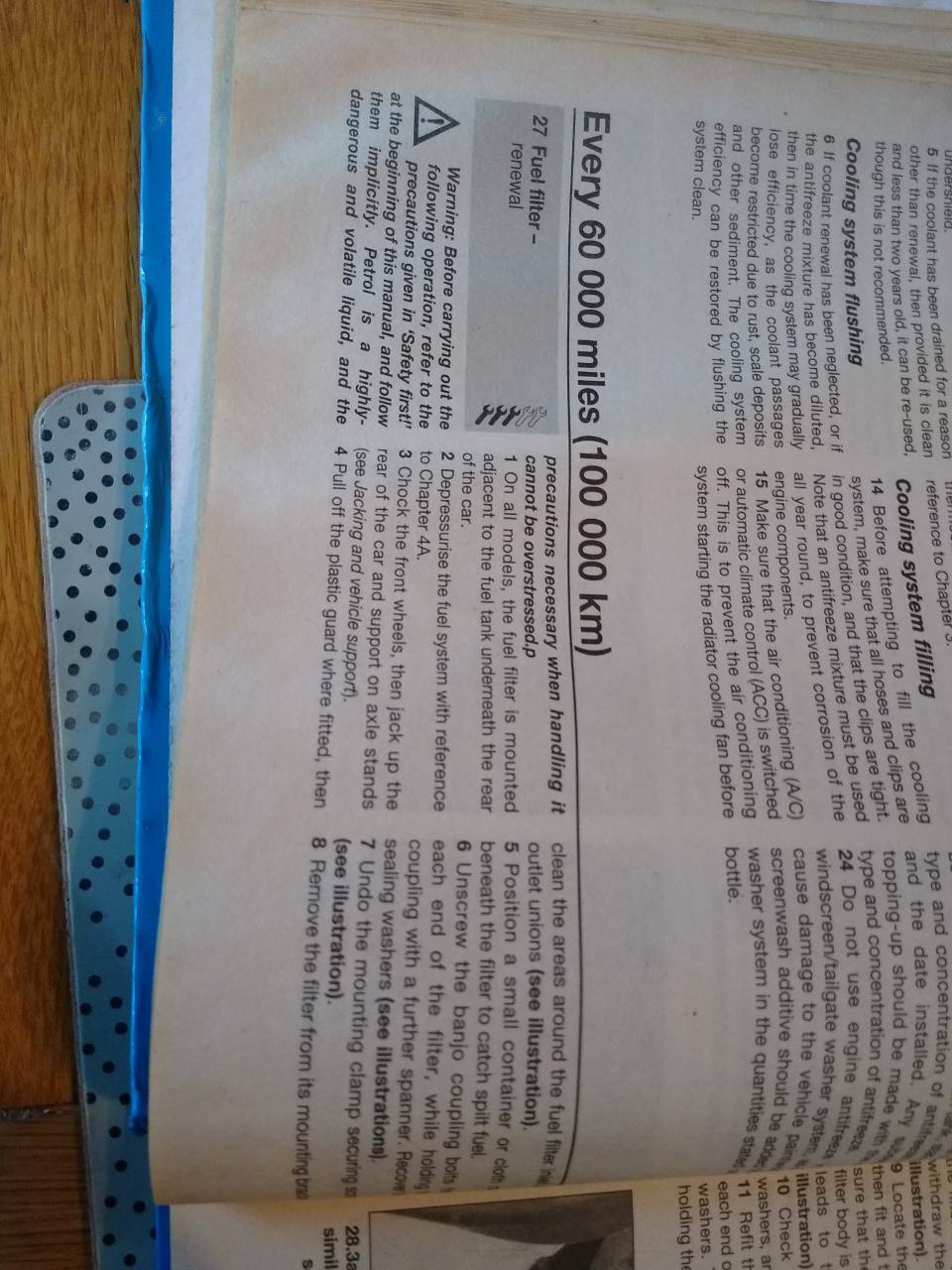

Well bought Sir. Just had mine serviced (full fat) at a cost of considerably more than the purchase price. But as it looks like a keeper I am gradually getting all the little niggles sorted. This time it was temperature control. I was surprised to see three fuel filters on the invoice, is this a thing or something I need to inquire about?
I believe you may want to have a word with the garage about the three fuel filters. HBoL says only one, which I would expect, and I've never seen anything with more than one (unless you count the gauze sock near the pump intake)
Thanks, I'll look into it - it may be that I simply misread or a typo. Stand by.
6 hours ago, DSdriver said:
It was me being daft, one filter and two filter seals. Duh!
Phew. Faith in garages: restored
I did this. It said, "0". Either it's not talking to me or that's zero faults.
I do have a cabin filter to go on. Twice the size of anything I've fitted before. Good old Saab.
