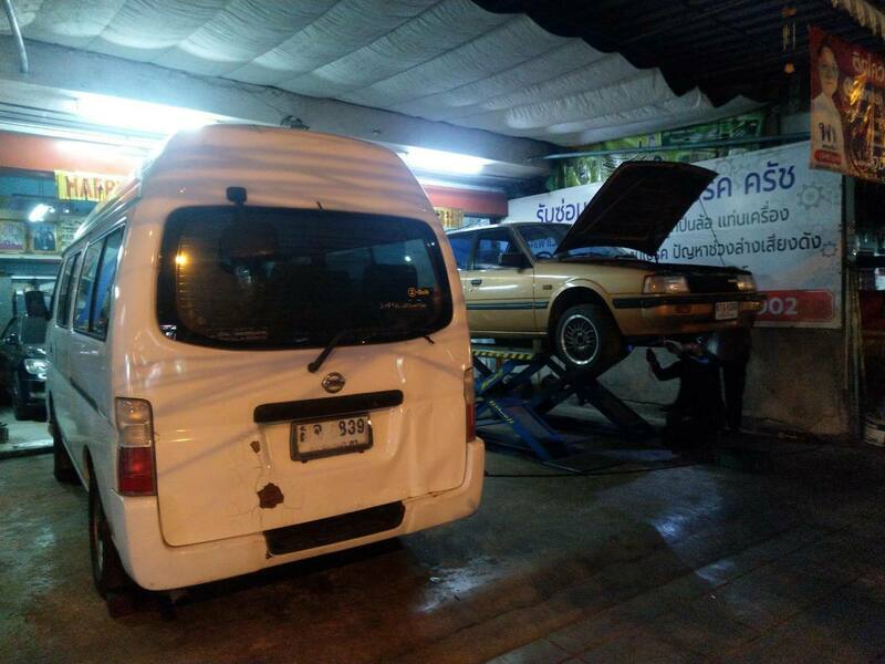

I called a local version of worldofceri with a flatbed. This was 15th November 2021. 11 months. I finally manage to get this bastard thing back to Bangkok. I decided to choose a shop well known for converting and fixing weird air-conditioning system to make sure not another bonehead is doing the conversion again. I'm done with trying to half arse it myself.
I cannot express how excited and glad I was when I took this picture. I'm ready to get hosed for whatever amount of money I have to spent to get this going again.
The car went into the shop for 2 months, the mechanic said this is the hardest fucking air-con system he ever had to convert. 1980's Hiroshima engineer decided to put 3 rows of belt on the air-con pulley, one connecting it to the engine, one to the power steering, and the outermost to the alternator, this means it has to be a certain size compressor. A bracket worthy of Bad Obsession Motorsport was made and depicted above.
