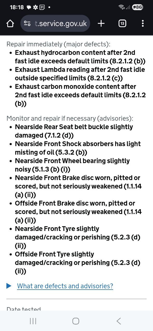

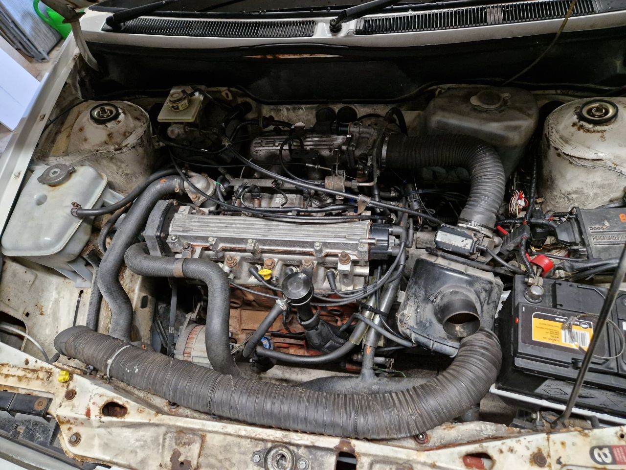

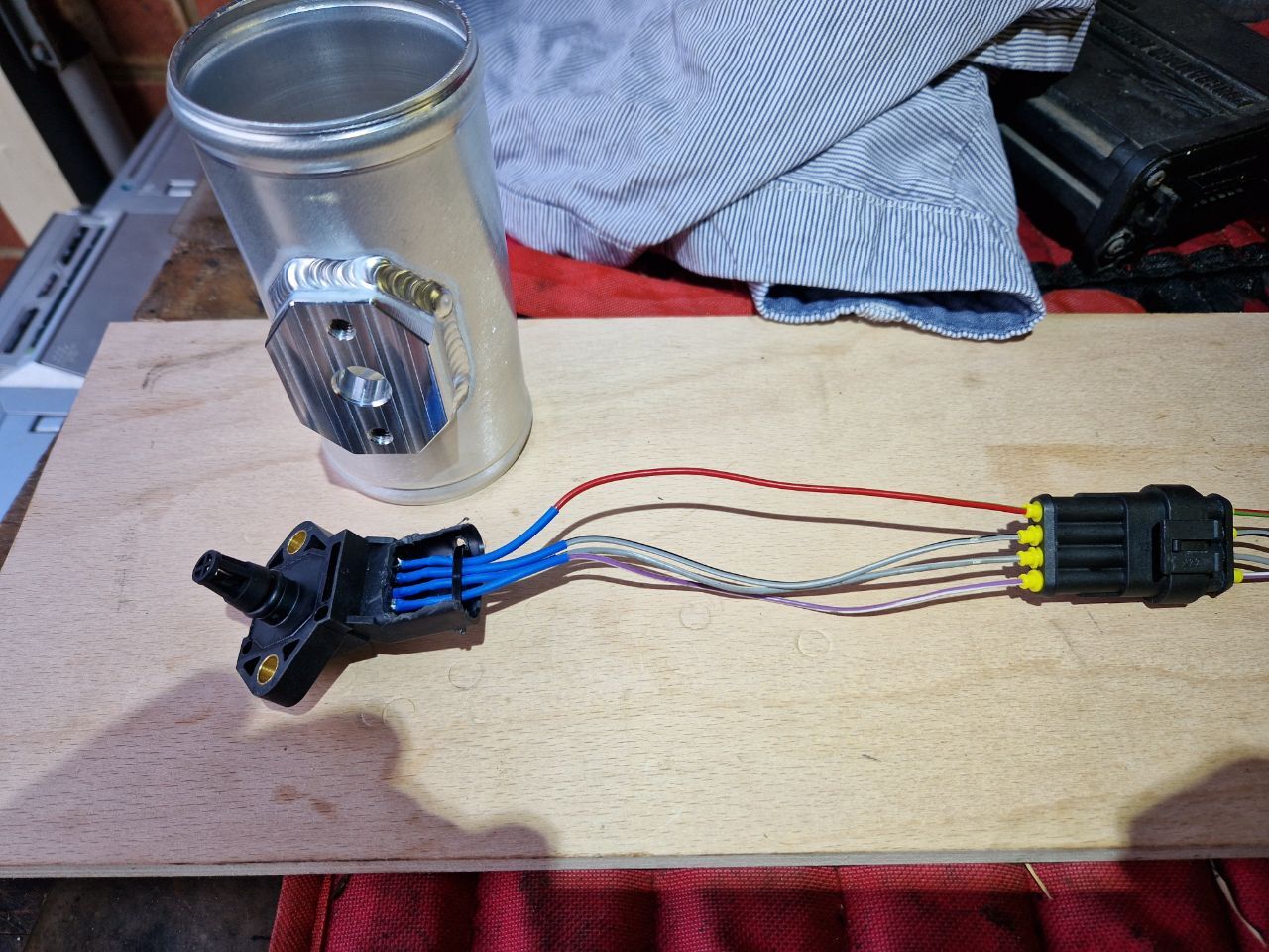

My theory for the rich running is that there is no MAF in the intake, so the ECU is defaulting to a 'safe' rich mixture.
I got to thinking how I'd install a MAF into my home-made intake, then
@JMotor@JMotor alerted me to the existence of this:Screenshot_20250830_072722_eBay.jpg.446892246bae0bf2a1d3c654bccb69c4.jpg
It should* then be a simple* case of buying a MAF then soldering on wires to the MAF terminals then wiring it into the ECU as per the electrical diagram.
Then I'll try it for one last MoT, more to get the emissions readings than anything else.
Either way, after this experiment it'll be Fur Shale, as I can't justify three cars any more.

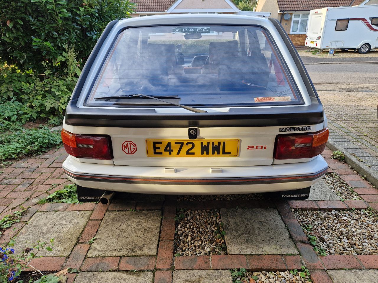

I managed to track down the correct decals for the rear of the Maestro, in the correct colour. There were a few variations on the badging through the production run but I've been using this stock image as a reference:s-l1200.jpg.3113eb3d65c210da39997d7297083f24.jpg
Used a China pencil to give myself some centering lines to get it straight-ish. 20250905_182608.jpg.3399df49cfb849613f43ede68f2b8212.jpg
I've also ordered a dealer sticker from a Mini spares place that was able to make a passable copy from my photo of the original 'Rowstocks' sticker.
Unfortunately this meant I had to remove the dealer sticker attached to the replacement tailgate I fitted early this year.
It was a brittle powdery mess and needed a Stanley blade and a lot of force to remove.

The Skoda is on life support now. My plan is to fit a MAF and wire it into the ECU, in the hope the engine will run less rich and allow it to pass emissions.
Of course I don't have any harness or connector so I've made this home-made effort to allow it to be fitted but also removed/changed if need be. 20250905_192216.jpg.16b907d0f196ec5a4d20530393441507.jpg
Then I'll throw it in for another test - of course I have no way of measuring the emissions myself, so it'll be yet another £50 MoT to find out if it's worked. 20250905_192811.jpg.ae03790025e0dbb67d7cfa154d5ed4a6.jpg
It all feels a bit 'sunk cost fallacy' but it's a gamble I can afford, if it fails though it's curtains for Sammy Skoda.

If you think the distance is doable (Stalybridge) drop me a PM. The guy I use is very sympathetic to cars I bring in, and works pretty fucking hard to get cars through emissions.
What kind of levels are we looking at at the moment?

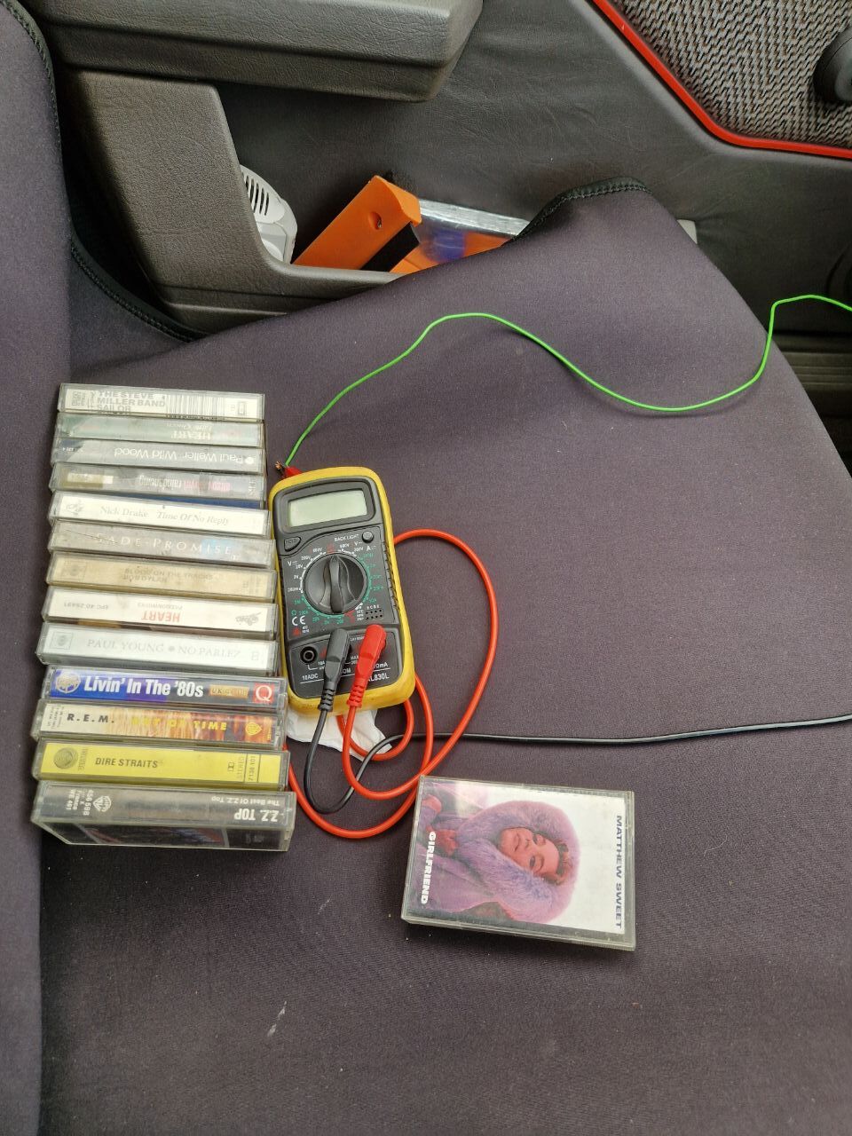

Because I'd like to make sure it's running reliably and not doing that thing where it cuts out, I've rigged up a multimeter to the fuel pump feed. Of course since I've done this it hasn't cut out at all so maybe I've disturbed some contacts or something that's fixed the issue?
Either way no issues and the Maestro got to the Black Country just fine.

I'll send pics when I get home. They're quite far out.
Annoyingly the two tests used different units for the emissions levels so it's not intuitive to compare - but both were hard fails.

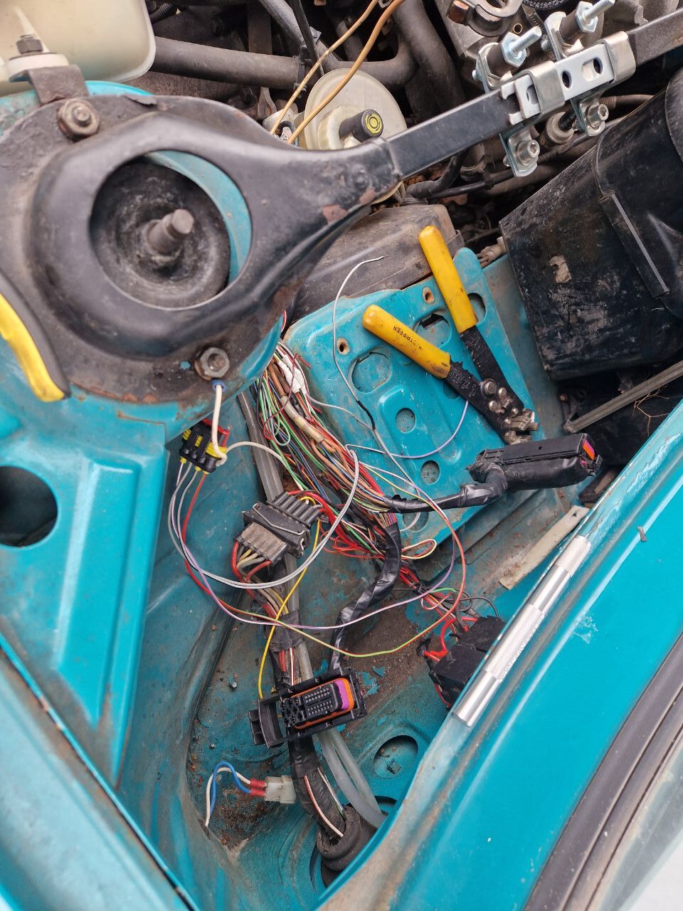

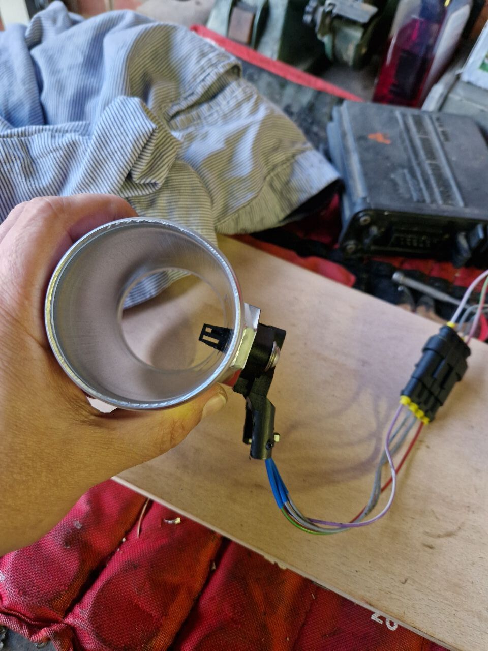

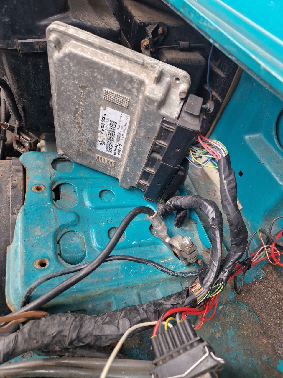

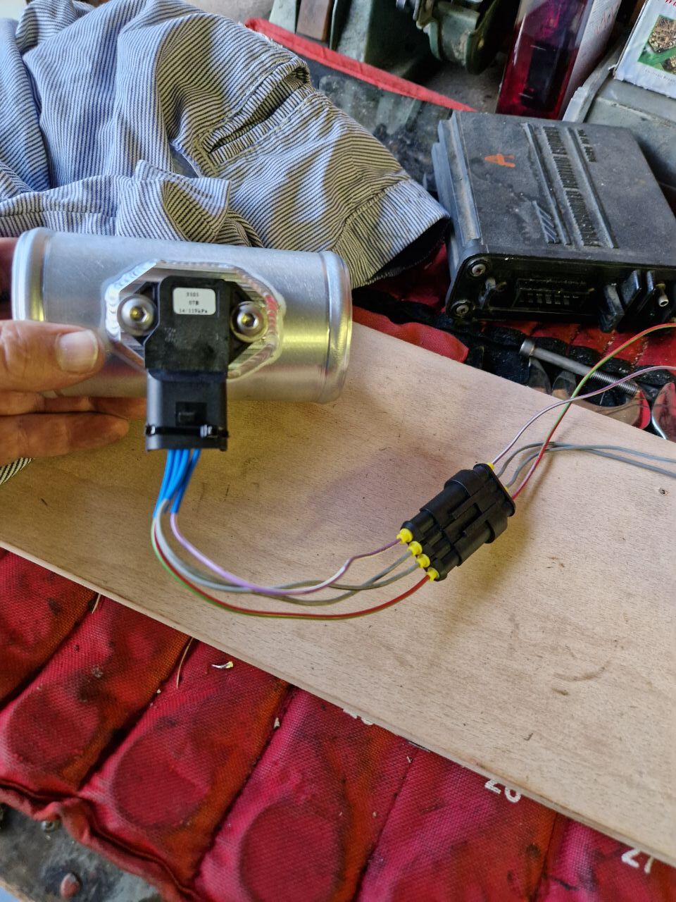

I've had the prepped MAF (and air temp) sensor in its tube for a while, with masterfully* soldered wiring.
Through a combination of VW Forum goodness (stored workshop manuals inc electrical diagrams) and Google-fu I managed to find the wires that connect the MAF and temp sensor to the ECU.
It was comforting to find the wire colours matched the diagram.

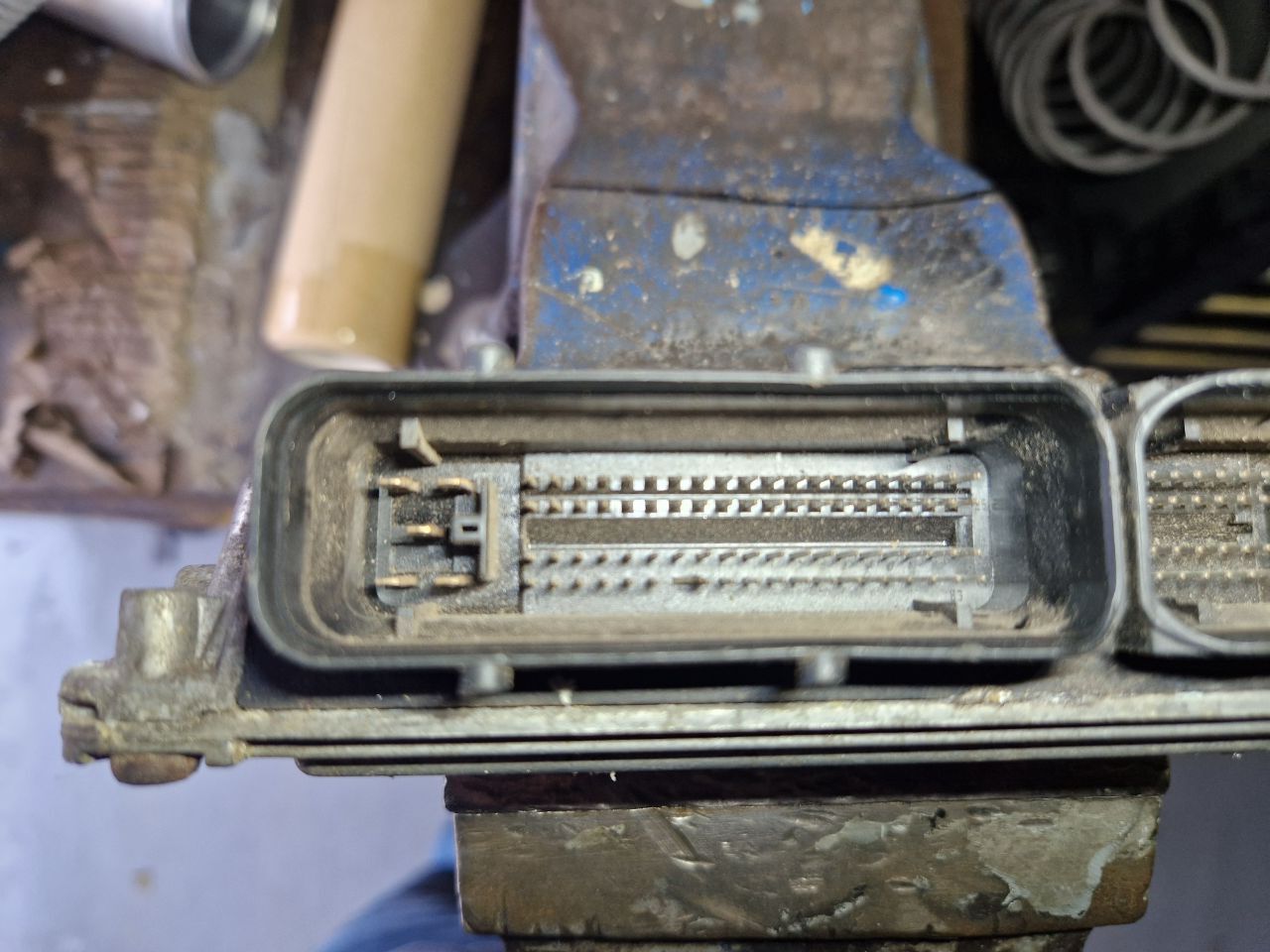

I had to use a jeweller's loupe to read the pin numbers on the ECU.
Basically two wires connect to the ECU, one goes to switched live and the other to earth.
Bit more soldering and connecting plus unwrapping looms, plus a short break to plaster my thumb after I stabbed it with a craft knife.
I need to get a bit creative holding the new pipe onto the strut brace but it should be easy enough.
Assuming it doesn't shit itself after my electronic surgery, I'll put it in for yet another test to see if the emissions have improved...
