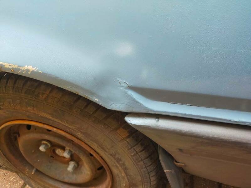

Today we had a look around. Tried to start it, but it seems to only fire when littlun tries, and then runs really roughly. Gave up once we noticed it spitting fuel everywhere out of one of the hoses! So that's on the shopping list!

Looks like it would live again with some patching to the sills.  The only thing I'd say is, because values are still very low, don't spend too much on it...  Having said that, parts are really cheap.  I bought a new brake master, wheel cylinders, hoses, rear shoes and front pads for under £70 by putting part numbers into ebay!

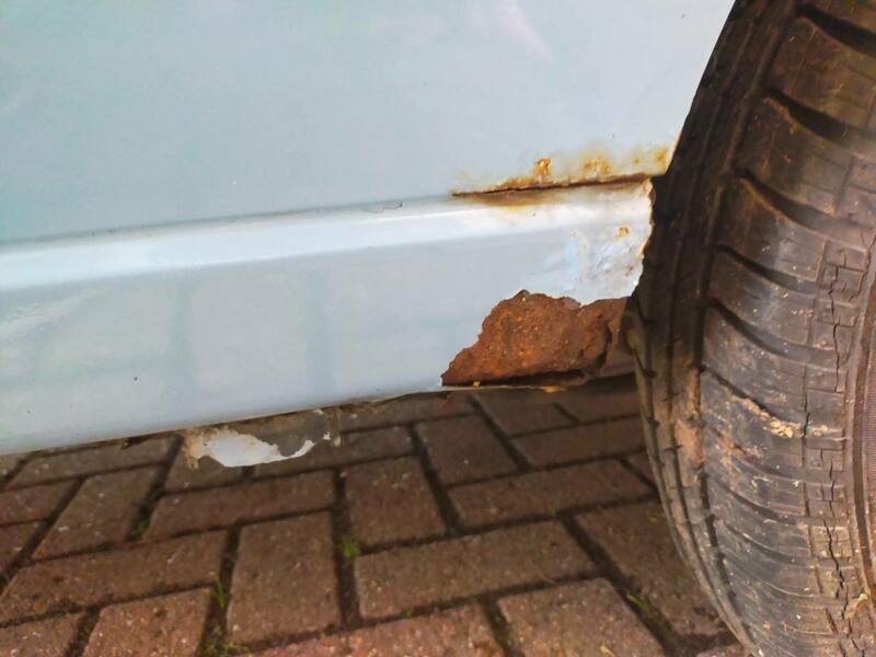

It's very pleasing to see this saved, but putting my "reality" hat on for a moment.. that rot in the jacking point is going to require a fairly advanced repair to be fabricated and welded in.  The rust *will* extend further than can be seen in that picture, and it's not going to be easy.  I'd want at least a full day to do that, and that's with a complete suite of grinders, die-grinders, nibbler, sheet steel, folder, joggler, etc.etc. and a decent MIG welder on Argoshield, not running on a long extension lead.  I'd also want the car up a bit higher (big axle-stands) to be able to see what is going on and actually get to the repair area.
You might find the best course of action to be to clean it thoroughly, do the bare minimum mechanical work needed to get it reliably running and stopping, shove some cheap/free better tyres on it (19 years old or otherwise) and offer it for sale just needing the bodywork sorting.

If space is that much of an issue just keep the welder in the boot of the car. That sill repair is going to be very similar to the one I had to do on my mates ZX, you'll end up doing the inner and outer, an evenings work if you know what you're doing.  Page 2 of that thread shows what'll need doing, iirc I used some 5mm flat bar as the vertical to replace the jacking point and just filled in the gaps?
That ZX is still in regular use now, my sister bought it off my mate and she loves it. That bit of rot was enough to see it fragged...

Vactan will probably sort the surface rust underneath but I’d sort the pissing fuel out bother then submit it for a test. Then make a decision. That sill looks like it’s going to want some serious tickling, I think your next step after the test if it’s not too serious is picking up a cheap MIG, or if you don’t want to completely fuck the other residents off, find a man who can locally.
