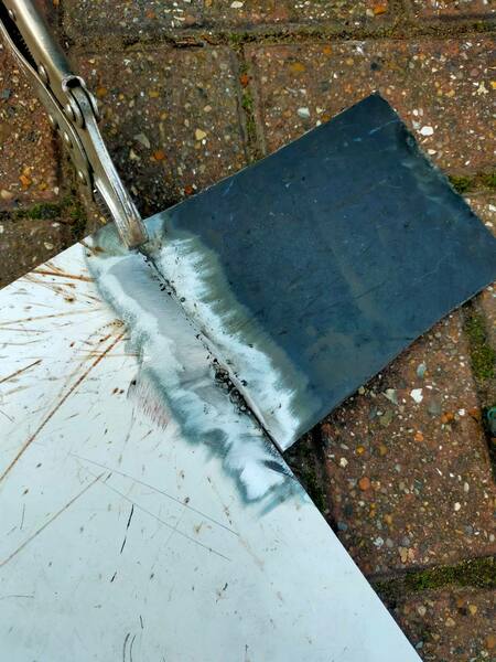

Had a little play with the welder, I literally have no idea how to actually weld/set it up.
8 pages of H&S advice is great, but not a clue how to use it 😂
Used flap wheel on it after to see which bits had actually joined.
The reverse.
From what I can see, none of that is an acceptable weld.
I'll have another play when I get chance.

If you have the settings right for the thickness of steel, try laying down one stationary blob on a clean flat area of steel (not a join) with the trigger held and the gun completely still, timing how long it takes to burn through.
Your ideal tack is going to be that length of time minus a bit to stop it blowing a hole.
Practice laying those down first, single tacks without blowing a hole.
Then move to your join and try doing the same. It might need a little bit less duration to avoid blowing holes.
Once you get the hang of laying down tacks, all you need to do to join two bits is to lay down a string of individual good tacks. That's pretty much the best way to weld thin metal.
See, I don't even know that...
😄 Good start.
Not sure what welder you have but there should be a chart, or someone will know.
It should sound like sizzling when you press the trigger, and take 1-2 seconds till it burns right through. From the looks of the photo it might be set way too high.
If you know the minimum and maximum outputs of the machine, you can use this calculator to work out the power setting.
https://www.mig-welding.co.uk/calculator.htm
Then once that's set, dial down the wire feed and then experiment slowly turning it up until it sounds "right".
I know that's impossible to gauge unless you've done it before, but basically you're looking for a nice calm stable arc, not much sputtering, popping etc. Some people say it sounds like frying bacon.
If it sounds like a machine gun it's too low. If you feel the wire tip smacking the metal repeatedly, it's too high.
You'll get the feel of it.
Don't bother trying to lay 'beads' of weld, zig zagging the torch or anything. Just focus on laying down a perfect single tack.

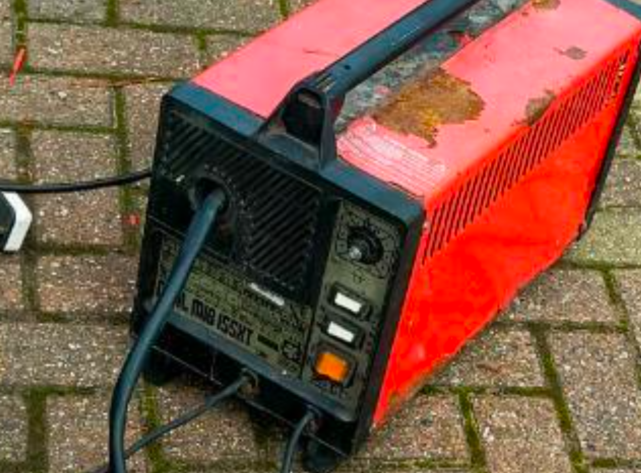

Big knob at one o'clock and power on 2 minimum is what I would run if it's anything like the Clarke 90 Captain70's had.
For a first go, that's not bad. I've spoken to the olds and they swear that they've not thrown the destructions away - but they weren't with it when i picked it up. If they surface, I'll get them to you.
@juular & @GingerNuttz cheers for replying, I'm no help as it's 15+ years since i've used the old beast! No idea on power etc, I only used it for welding corner plates on bangers (badly - pigeon shite) but I have full confidence in @DoctorRetro to get this done, with the help of experienced metal-stickers like yourself.
1 Max or 2 Low will do for power if its anything up to a 90amp unit which it looks to be. If the wire feed scale is 1-12 use about 7. If its 1-10 use about 5.5-6. That should get you going. You know youre close when it sounds like a nice clean sizzle and you see a nice heat colouration for at least half a cm around the area of weld, that should be reflected on the reverse side too although not as big a spread. If youre getting lots of spatter then your metal isnt clean enough or your wire speed is too high. Remember that steel bought from the merchant has an oil coating which means it isnt 'clean'.
Another thing to consider is your gas flow. I run about 10 litres per minute and ideally you need to be about 10-12lpm. If you dont have a gauge then adjust the knob to a very low setting then slowly increase until you hear a nice clean flow coming from the torch without it sounding weak or like its rushing out like an air leak from a tyre. This is actually easier to do with the welder turned off (the trigger will still release gas) so you dont have any background noise. Hold the torch to your ear and listen as you adjust the knob and the flow changes.
You may find once you get to the car that even 1 Max is too much power and will blow holes in the thinner metal so you may need to drop it to 1 Low and slow the wire speed down a little but the principle is still the same.
Post some pictures up of your welds without dressing them. It will be easier to assess them and provide feedback.
You're trying to butt weld, which is difficult at the best of times. Easier to weld with the repair piece on top of the part to be repaired, if you get my meaning. Just keep experimenting with different setting.Perhaps start in a midway position and work up or down. If you're getting a lot of blow holes, turn it down. If the weld is in blobs on the surface with little heat penetration, turn it up. Regarding wire speed, if the wire burns back into the tip, too slow. If it pushes into, or through the weld, too fast. It's all a balancing act, really. What wire are you using?. 6mm is fine for car bodywork. Gas? I use Argoshield, 85% argon, 15% Co2. You'll soon get the hang of it. Keep posting, and best of luck.
Another thing to keep in mind; If the welder has previously been set up for flux core wire then the polarity will need to be set differently for solid-core-gas-sheilded wire. (behind the flap, 2 chunky wires that can be unscrewed and swapped around)  With sheilding gas the torch should be + positive & the ground clamp will be - negative.
Edit: This probably all feels like an avalanche of information, the trick i've found to learning welding is just bashing your head against it repetedly until you fail better and better, before you know it you'll be welding up old bangers like its nothing. :D👍
If you do this, you'll create a double skin which is a rust magnet. If you do it to practice, please don't repair the actual car this way.
Honestly that's probably better than many first attempts. Turn up both power and wire a bit and weld in tacks/blobs. You can't really do continuous beads on car thickness steel.
^^^ all excellent advice.
A good weld looks a bit like a fat earthworm sunk into the metal you are welding. If it resembles a skinny centipede instead, turn up the amps a bit and try it again...
Also, not sure if you are aware of this already, you push the torch forwards and away from you as you weld, rather than pulling it towards you or moving it sideways. The pushing away movement helps to retain the shielding gas cloud around the welding wire. IIRC the gas excludes oxidising air from around the weld and also helps it cool, both of which help to give a better quality result.

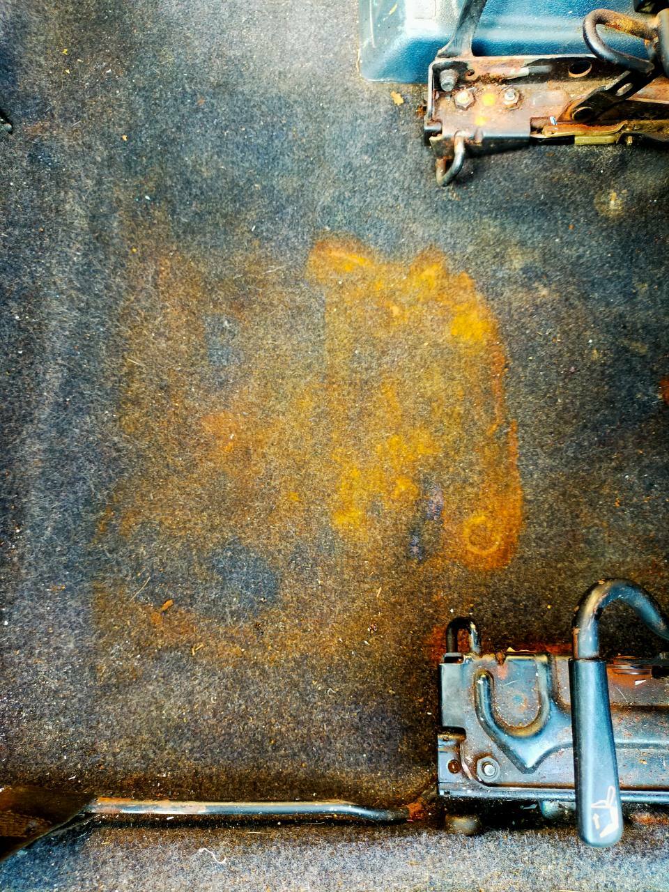

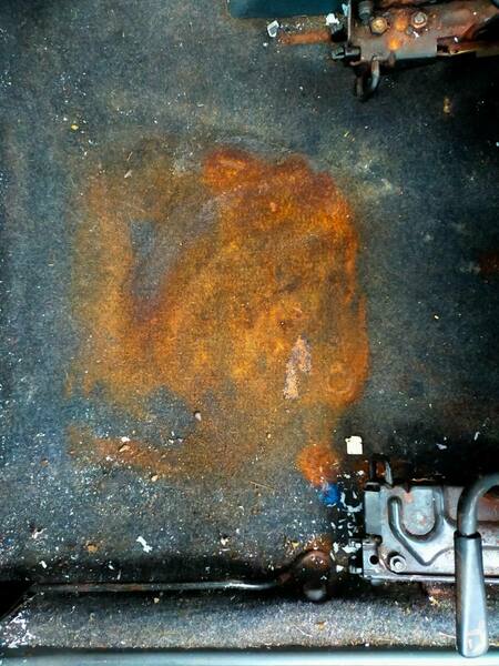

Found these before and after pics. Don't think I'll get the rust completely out of the carpet, but I'll probably spray the carpet and throw some mats in.
