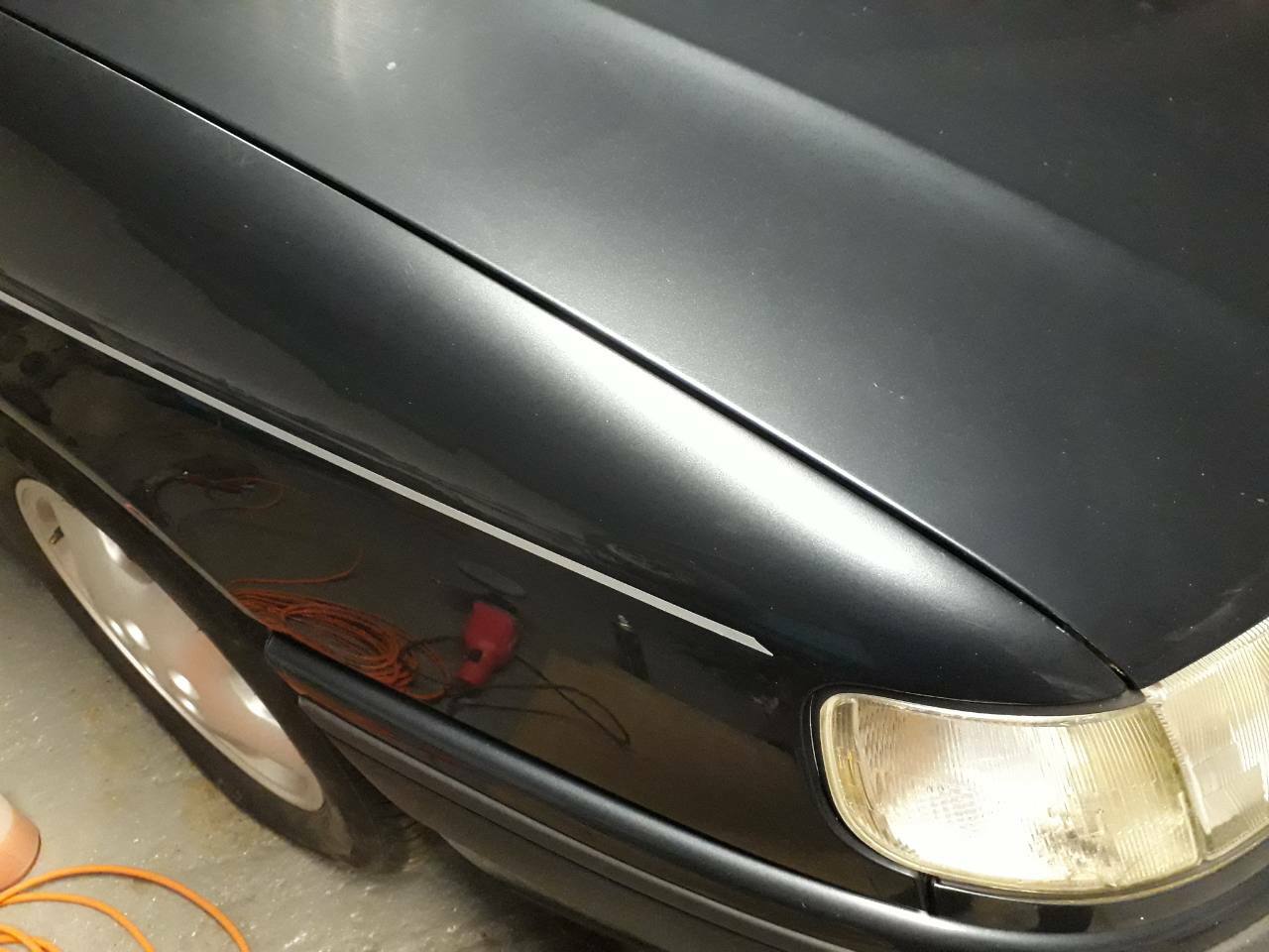

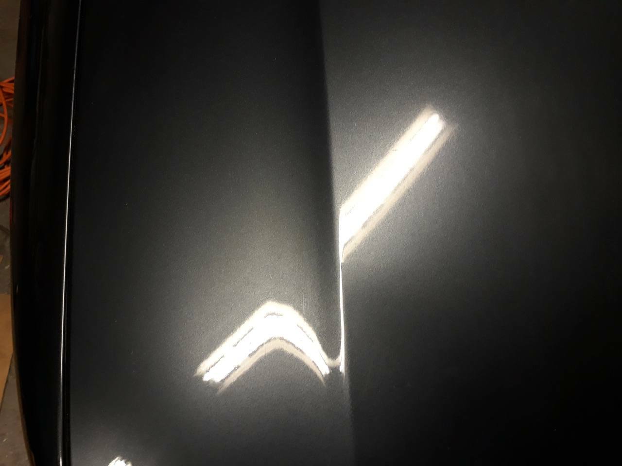

With DPD ballsing up my plan for the evening i had a quick measure of the brake discs for the rear so i can get them ordered up.
Curiosity got the better of me and a quick wizz with the mop shows some lusture is ready to come out in the slightly hazy paint.

Farecla stuff yellow and finishing black with g3 premium which is two stage depending on the pad, used on a 15 or so year old rotary polisher thats heavy as fook.
I recently purchased the g3 flexi backing pad which transformed how nice it it to use tho, with the thin flexi mop pads and backing it allows it to be used without worry or snagging and dragging along like your trying to use a floor buffer!
I change to a 75mm pad for smaller areas.
Id love a DA with but the cost just isnt justified for me when shining up an old shitter or some headlamps.
