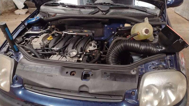

Today I decided to clean up the Clio's throttle body because why not?
Sum total effect: Eh, it still runs a tiny bit lumpy on idle. But hey, it's controlling its idle speed properly now thanks to the new ICV from yesterday.

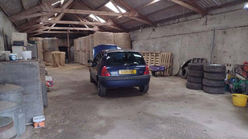

I'm not sure if I have enough space to work on it comfortably though:
