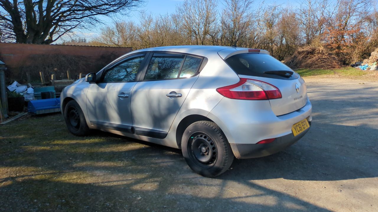

I just collected the Megane with a successfully regenerated DPF and a new strut top bearing.
No more suspension noises and it feels like it's gained about 30hp. Whoops.
I need to remember to kick its fucking face in every time I drive it, for its health. I'll also need to make a habit of taking it on a longer run every few weeks.
Having thought about it, I have basically been doing short journeys in it for a while. 7 miles here, 12 miles there, 18 miles there. All on back roads. No sustained 70mph or so at all.
That'll probably do it. Despite me driving it enthusiastically it's still not enough of a sustained load for long enough to regen it.
A fresh MOT on this nugget I helped my brother source from here.
It's still so fun to drive.

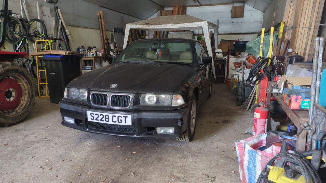

This magnificent bastard got a clean MOT pass with compliments from the tester (I saw it on the lift, you could eat your dinner off the underside of it) plus the chassis outriggers filled with cavity wax. I also replaced the clutch flexi hose last week, and after pressure bleeding the clutch system it feels absolutely amazing to drive. It was sorely needed as the fluid that came out was almost as black as the paintwork.

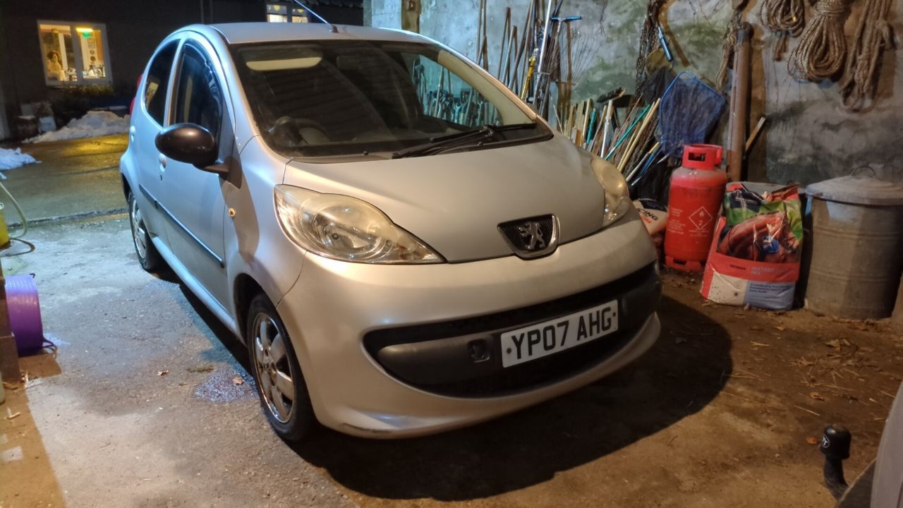

This one is a happy little baguette. In the past couple of days I replaced the oil, oil filter, fuel filter, and the front discs and pads. It also seems to be driving superbly now.
This one continues to drink all the petrol while making all the noise and almost none of the forward motion. Good for inspecting all the fences last week before our tenant started putting sheep in the fields for the season starting from the other day.
