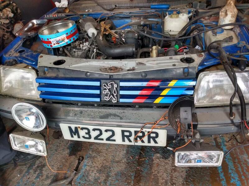

@Supernautcame along today and we did a little bit of work, the rad and fans are in place now along with the slam panel and grille. The coolant hose from the top of the rad to the thermostat is in place too. I should be able to get the rest of the coolant hoses in next time I'm along, but they'll need the car on stands again and we ran out of fucks today as despite being rainy it was quite warm. Once I've done that the list of things needing done is quite short actually! I might even get in on the road before the winter!
Can confirm I was there.
I even helped fit the radiator, slam panel and grille. Look, it has a face again!
I then ended up with a couple of sharp, bitey, knee warmers.

Today's progress involved connecting some more mysterious electrical connectors under the bonnet, and finishing assembling the cooling system.
We nipped into Kirkcaldy (shudder) and picked up gearbox oil in the vain hope we'd complete it today, but the clutch cable confused us. It's very close to running again, though, and all the parts and fluids needed are now sitting in the unit with it.

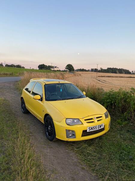

My car is looking slightly worse but is actually a billion times better under the beige and bonnet. It may actually generate slightly more POWAH than the 205...
