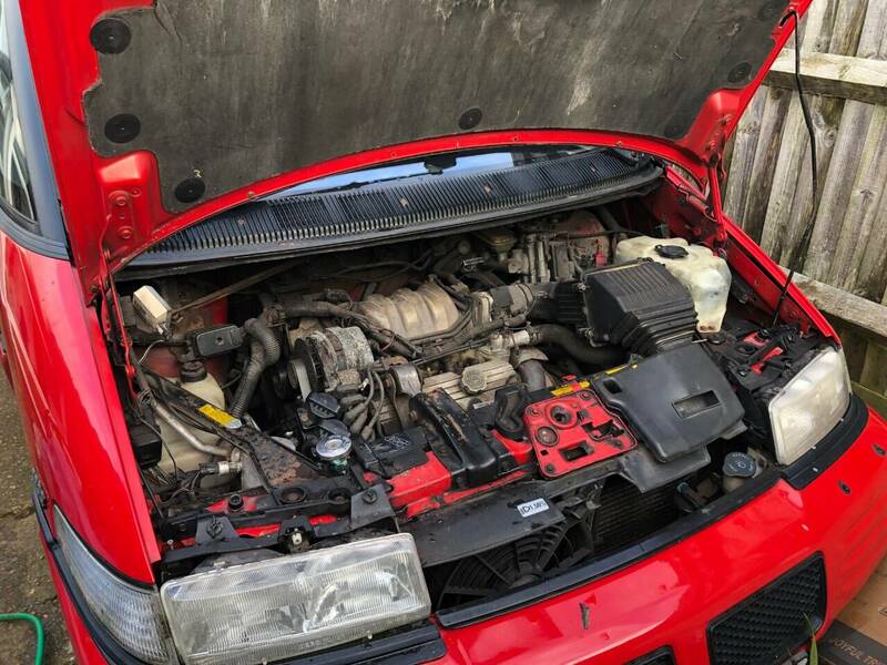

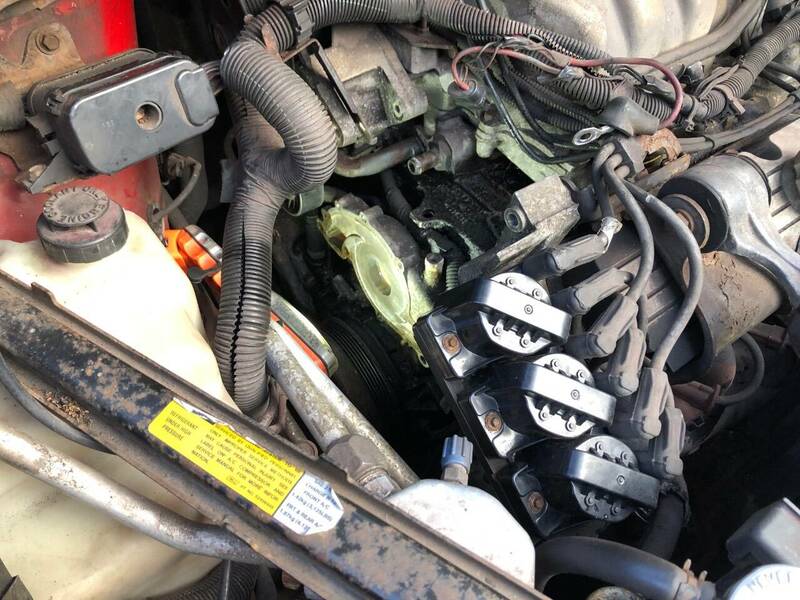

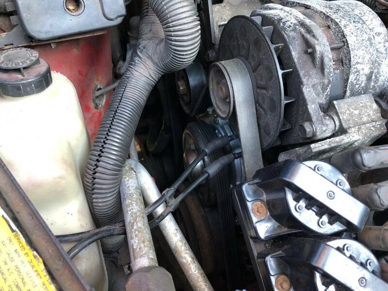

Update time: yesterday and today I’ve been tinkering with the Pontiac.

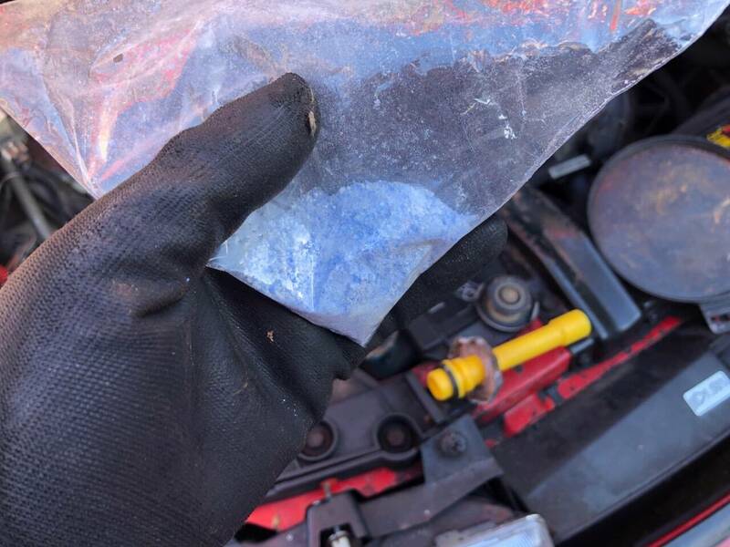

My UNC/UNF tap and die set finally arrived, and by arrived I mean wasn’t left in my safe place two days in a row and then I had to wait until Saturday morning to collect as the office is only open 2 hours a day… Cheers Royal Mail. It meant I could at least clean up the shitey threads.
I also bought some long bolts as the 5/16 threads were deep in the block - this was a good shout as the taps were too short so I made this beauty* using the angry grinder.
You can’t see the threads so this pic is pointless, you’ll have to take my word for it that they’re all sorted:
Next up, it all went back together:
I did as the shop manual instructed and used a smear of RTV on the mating surfaces, and torqued everything up.

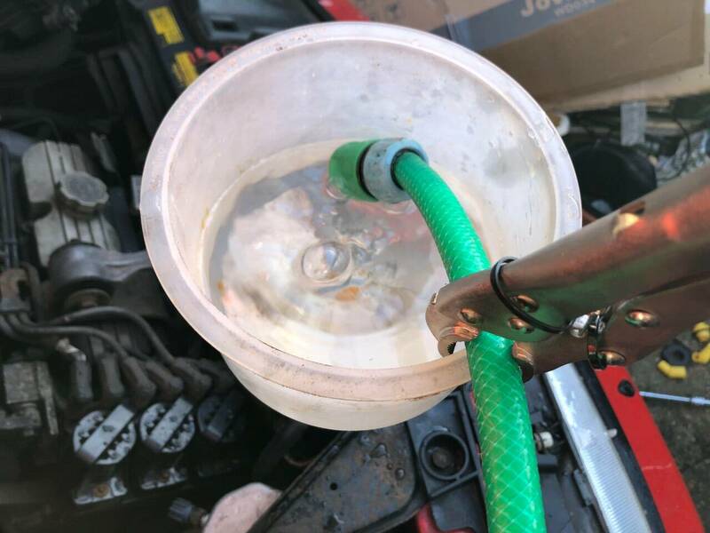

The coolant system was pretty grim:
So I treated it to a delicious dishwasher tablet.
Then I left it running on the driveway with the funnel attached. It’s getting tap water for now, as I’ll dump the coolant and put fresh stuff in after it’s been run for a bit.
It got up to temp, the thermostat opened, the bubbles slowed to a stop, no leaks were observed. It still doesn’t show as very warm on the dash, but with a new pump and thermostat I can only assume that either this is how it is normally or the sender is crap.
Either way, I chucked the coolant left in the funnel into the header tank and I’m calling it done for now, hopefully closing the lid on this for a while:
It’ll be interesting to see how it performs in service now that it actually has coolant in it.

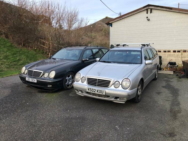

And to prove that as one hand gives, the other takes away; I’ve just driven the mrs’ merc to the tip aaaaand… It’s suddenly shit itself - don’t know if it is the rear diff, the driveshaft or a bearing at the back end but as you slow down on the brakes or by letting off the throttle there is a loud, cyclical knocking. Sounds like it’s in time with the drivetrain and not the engine.
Either way it’s not usable now, and my mrs is understandably fucked off that out of everything we own there isn’t anything that isn’t so broken that she can’t drive it currently.
This seems to happen every winter, so I’m fairly sure that the way to prevent this next year will be to procure a few WBOD’s to hedge my bets.
Seized up UJ on the prop shaft?
Interestingly the same issue occurred on my BMW after I'd done the gearbox but I investigated and discovered my exhaust heat shield was too close to the prop/diff so when slowing down it just rubbed on the shield and made a scary noise.
Hopefully yours is equally trivial - maybe aged shield has rusted through and fallen into path of prop?

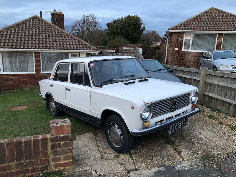

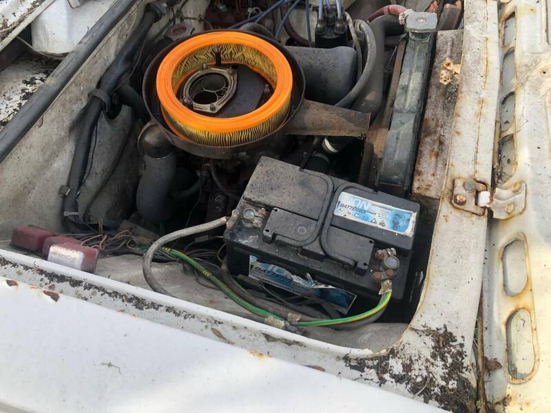

Today was Retrieve Lada From Field Day.
I’d like that one please:
Not pictured: The chain harrow that my Dad left upside down in undergrowth. I drove onto it in the Land Rover (how it didn’t burst the tyre I don’t know), and then when I got out to find out ‘what the fuck was that noise that sounded like a tyre popping’ I went foot first onto one of the spikes. I had my boots on but I still fucking felt it. Cheers Dad.
Using the power of swearing, I dragged the chain harrow out the undergrowth and relocated it into the hedge.
With that sorted, I turned my attention to starting the Lada. Surprisingly, it was happy to crank over despite the tired battery.
Unsurprisingly, it wouldn’t crank long enough to draw fuel and start.
Luckily*, the jump pack in the Land Rover had gone flat. It was fully charged last weekend and has just been sat in the boot. Noco stuff is absolute shite.
I went back home and grabbed the battery that I had previously charged for the XM and brought that back to the stables.
I ‘forgot’ my tools (they’re blocked in the garage by the leaning tower of crap) so I had to make do with what I could find in the boot of the Lada.
2 spanners, a pair of pliers and the pry bar I’ve been missing for months. Ok then.
Success! (You’ll have to take my word for it as there’s no rev counter)
It was absolutely filthy from being sat under a tree, so I gave it a quick jet wash before driving it home.
Green:
White*:
Time to drive it home then. None of us were very excited at that prospect:
However, once I got off the main road and I was rolling around the local roads along the seafront I felt a lot better. I’m sure my confidence will come back with this car.
Home safe:
