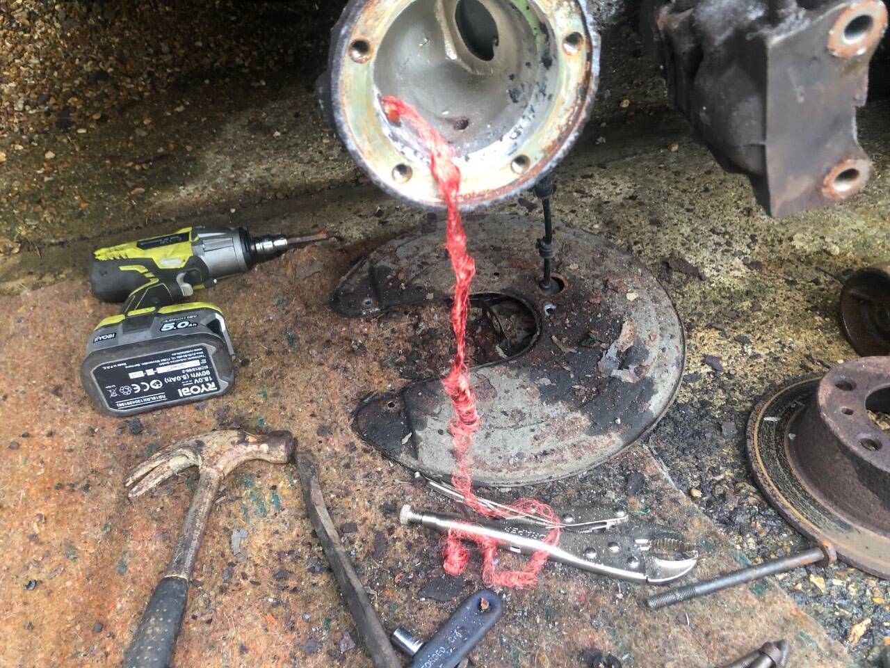

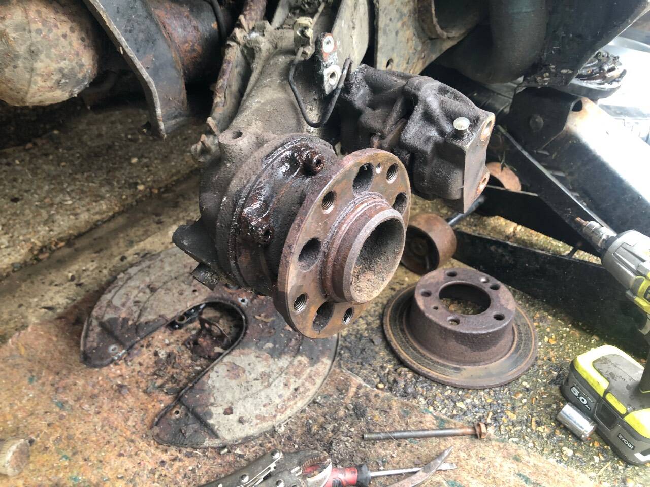

Amazingly, the rear shield came away without an any disasters.

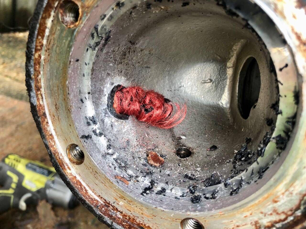

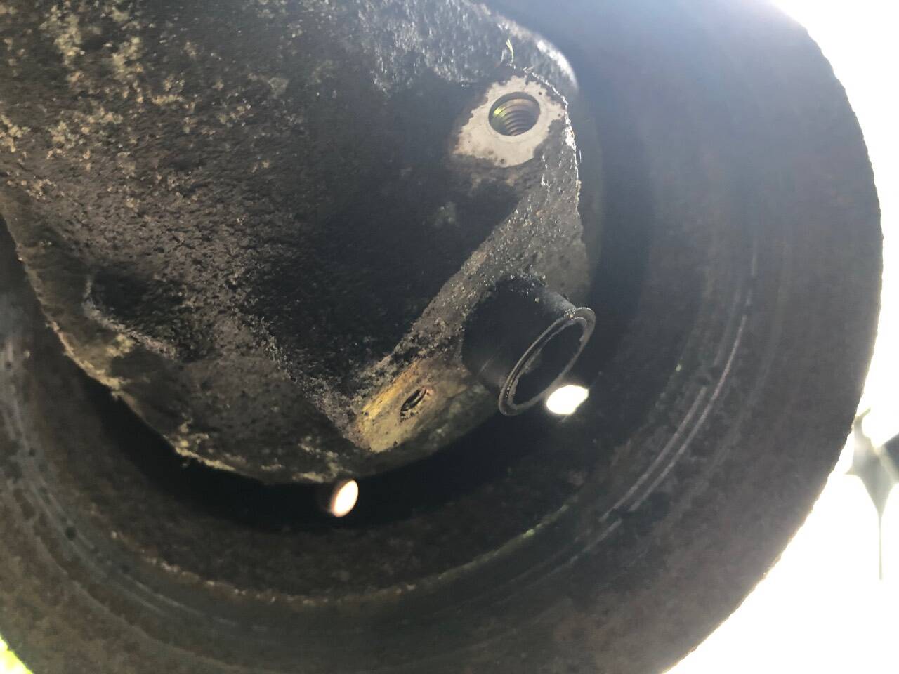

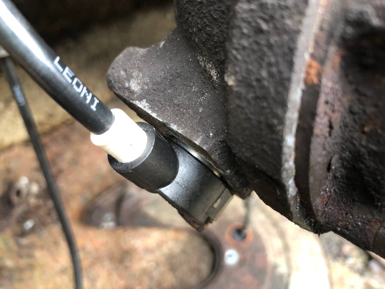

The sensor was well and truly stuck in there. With a bit of persuasion it snapped off and left the shaft in. Standard.
Disc off then.
That needed some proper testing with a nylon mallet to get it free.
Next up I needed to crack loose the hub.
Lots of teeth and lots of shiny bits.
Well, there’s your problem:
Release the STUFF!
I chiselled out the remains of the collar with a screwdriver, and I was left with all this shite.
It was fouling the new sensor and stopping it going in. I seem to recall this being mentioned on the XM forums as being a menace to clean out properly. Fortunately I’m a lazy bastard, so I realised that an 18mm drill bit and my laser guided eyeball would do it in two seconds.
I then fucked around measuring things to figure out if I was going to have any length issues when it came to going sloppy seconds on the freshly reamed hole.
The reluctor was in when I took that measurement initially.
Looks good to me.
I then spent some time fucking around looking for a suitable shim to get the clearance I needed, before realising the heat/dust shield that bolts under it is the perfect thickness. Here’s how it looked before I realised that, and I was using a washer:

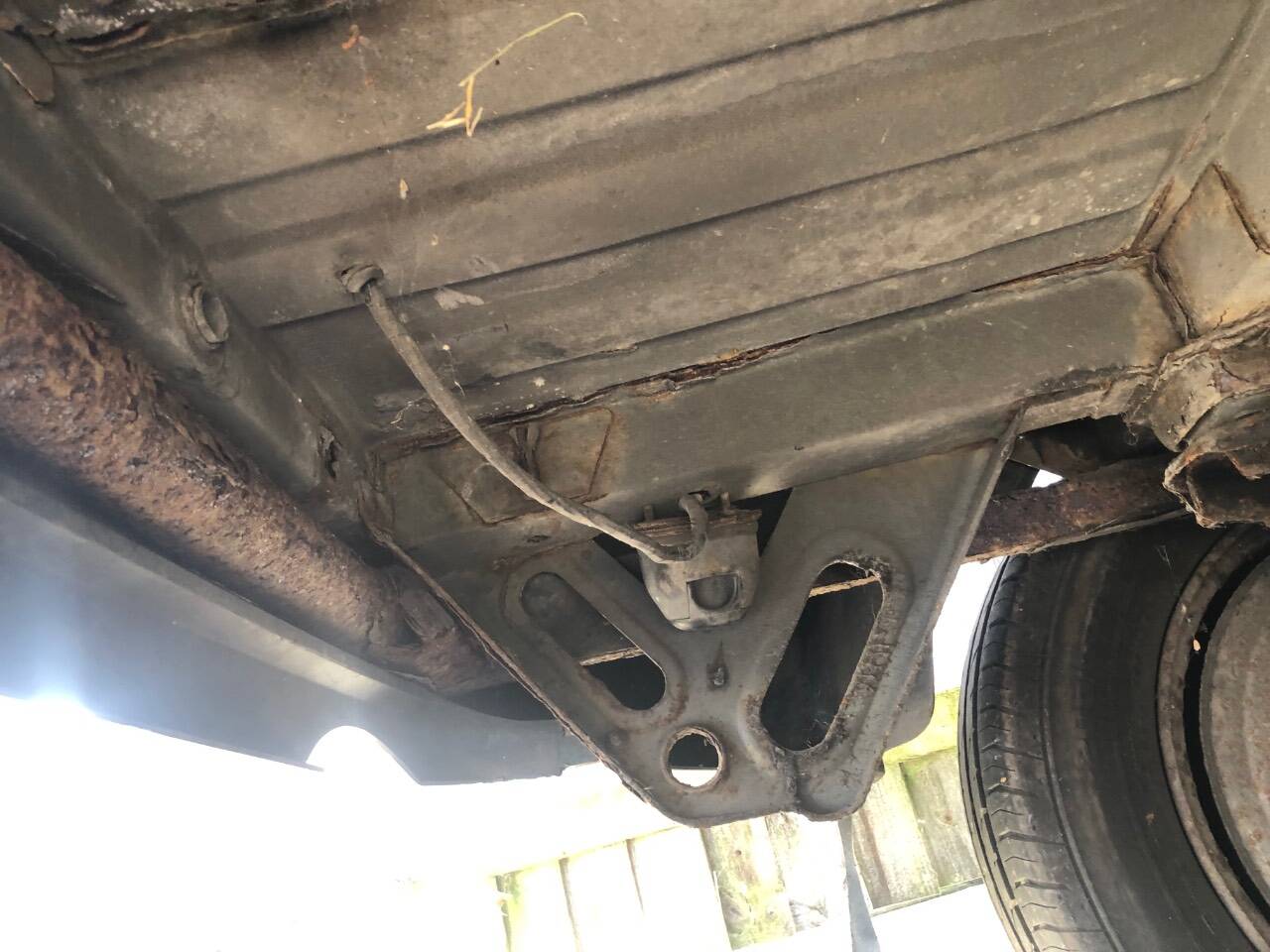

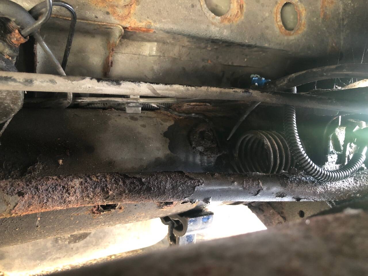

Reassembly is the reverse of removal. This is the absolute worst part in my opinion:
That connector is up between the top of the rear beam and floor pan. It’s best to get to it from under the car, popping up in alternate places under the subframe like a demented meerkat. It’s one of those things where you can either see it or you can touch it, but not both at once. Speaking of which, if you’re doing this job then it’s worth observing this:
Similar to the front, there’s a couple of types of sensor and if you’re lucky like me then you can use either impedance value which opens up some options. The green one is original to my car, the blue one is the replacement. The lugs are in different places, but a craft knife sorts that.

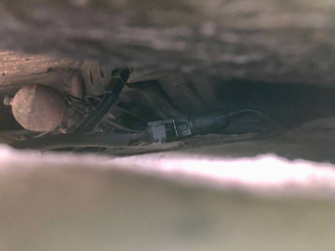

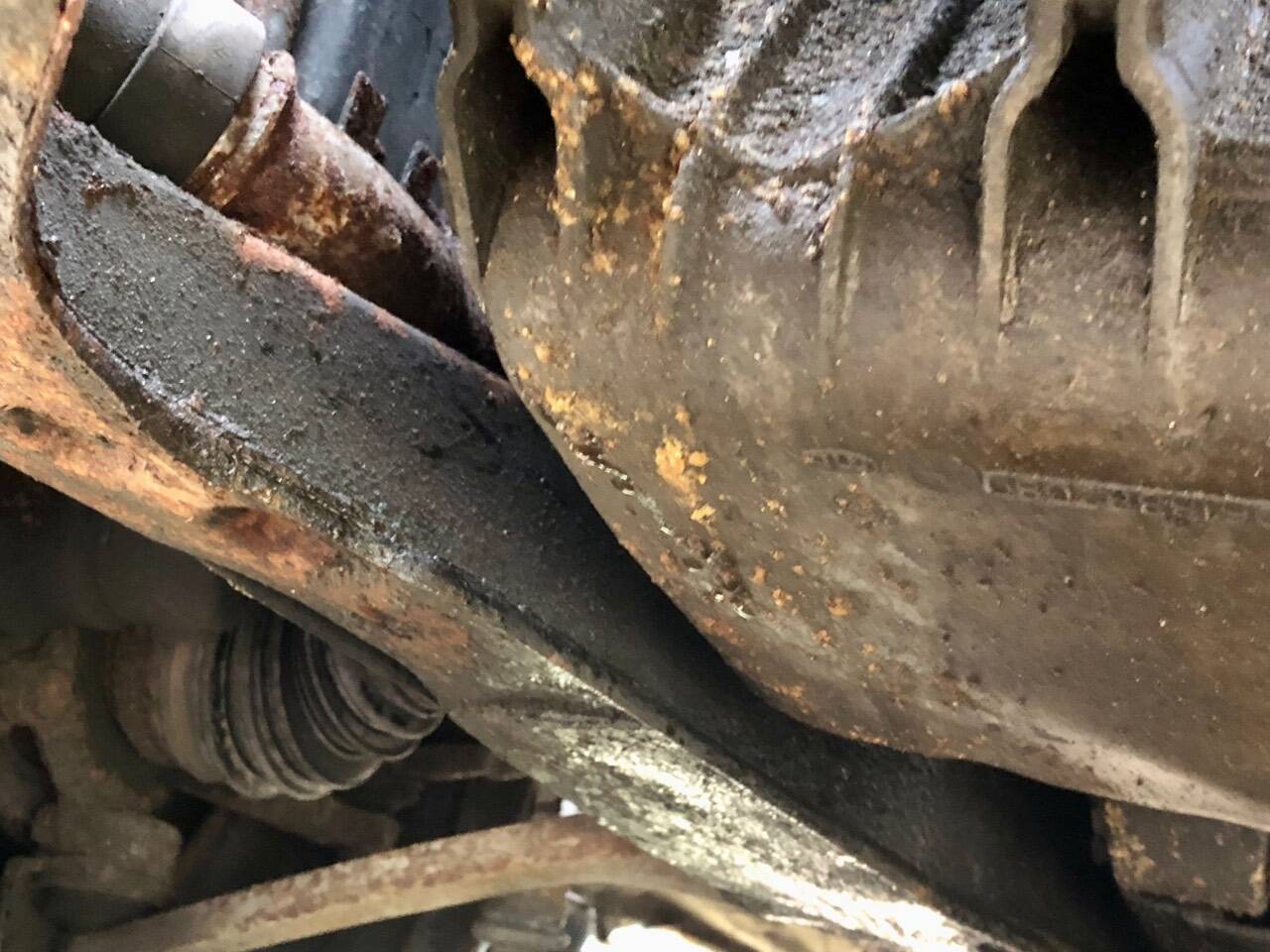

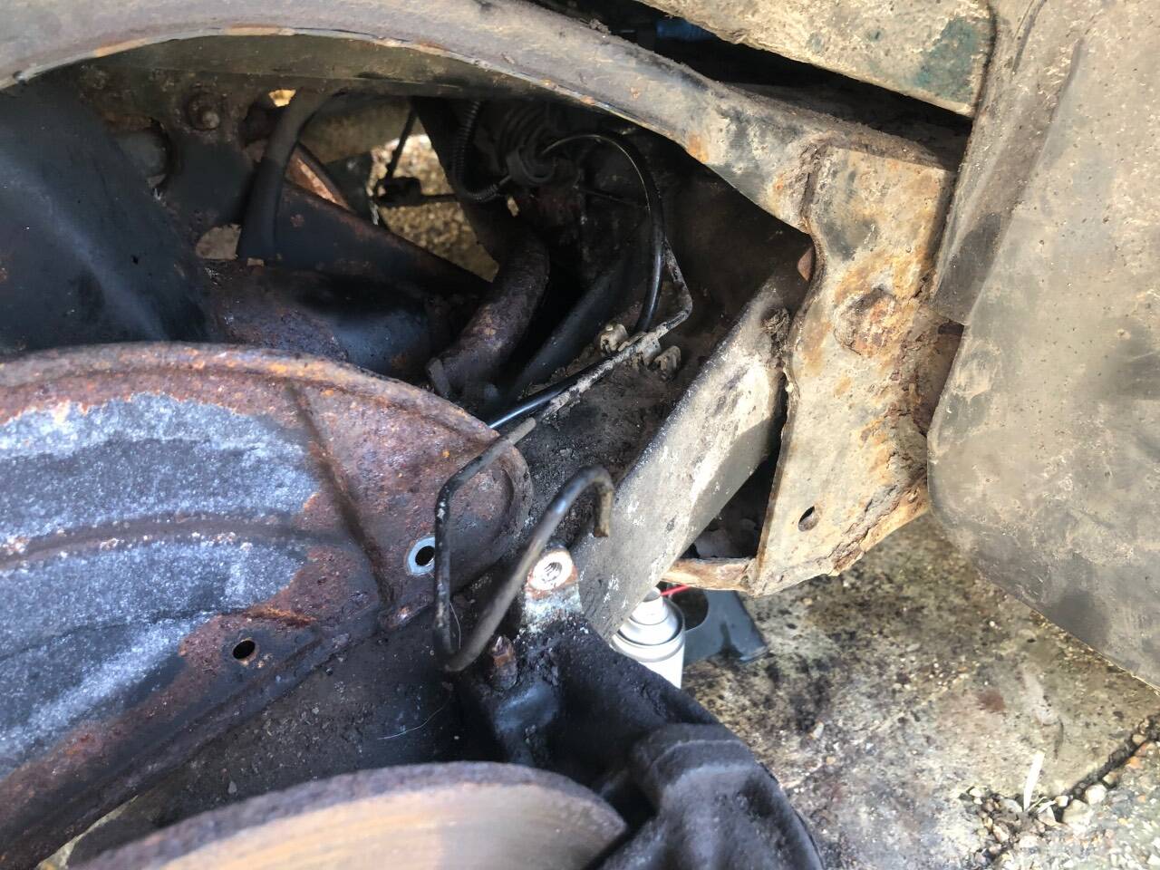

Aaaaand as I walked down the path to my house this evening I noticed a wet spot under the corner I was working on. Fingers crossed I’ve just disturbed a low pressure return or something, I’ll have a look once the kids are in bed.
  • Sad 3
Big sweaty ball bags.

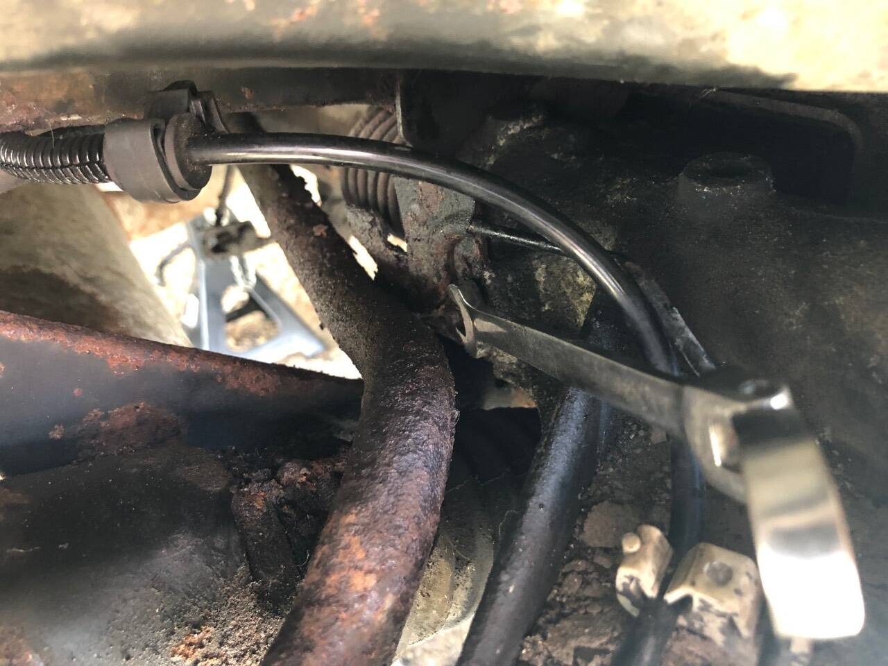

Looks like that line has burst where it squeaks past the anti roll bar. Must’ve been where I was jostling things about.
I reckon I need to drop the exhaust for access. Then need to make up some lines.

Well, sadly my replacement line didn’t arrive in time for weekend fun, but that didn’t mean I couldn’t still treat myself to half the enjoyment* by removing the old brake line ready for the replacement’s arrival.
It was pretty hot here, so it was important to keep hydrated by drinking plenty of thinking juice. This hit the spot, and was suitably themed:
I’ve been reliably informed that I need to drop the rear subframe in order to replace this line. I’ve been keeping an open mind as to whether I’ll do this, as it looks like a recipe for more damage and just a general ball ache.

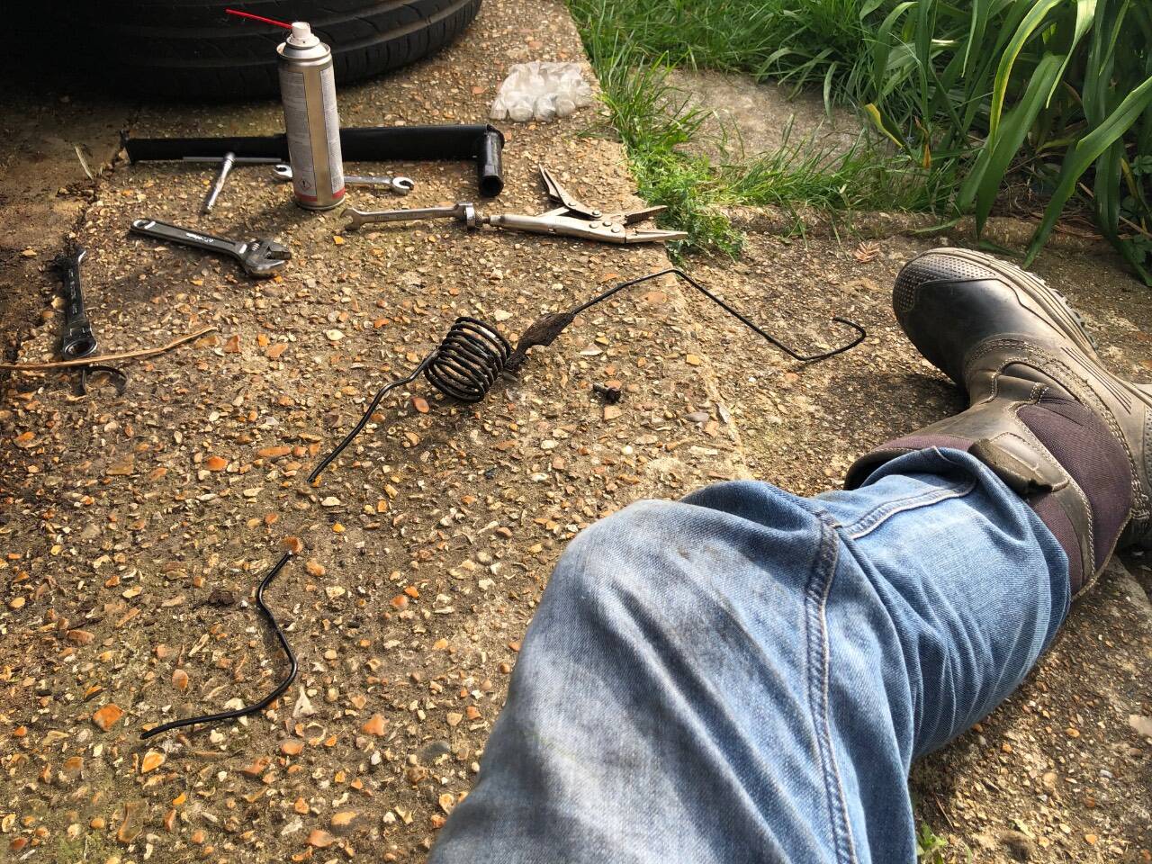

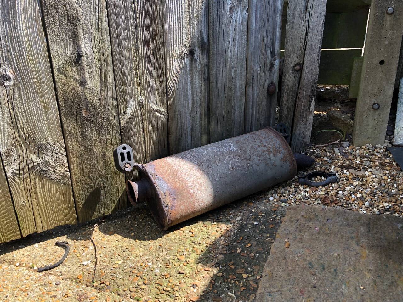

First off was to remove the rear silencer, which came off surprisingly easily.
The rear mid section; not so much.
It would’ve taken a real fight to get that out, it’s bonded into the mid section pretty well and some work with a hammer and various drifts and chisels didn’t shift it. I repositioned the stands for more height, and decided to save the subframe on. I did remove the spare wheel carrier as I was getting caught in that constantly like a hapless animal in a beer can holder.
I then laid in the shade for a while, whilst contemplating my life choices.
The tow bar electrics had made a bid for freedom some time ago, so I tucked those away and made a mental note to buy a new bracket for them.
I definitely* won’t forget that that there.

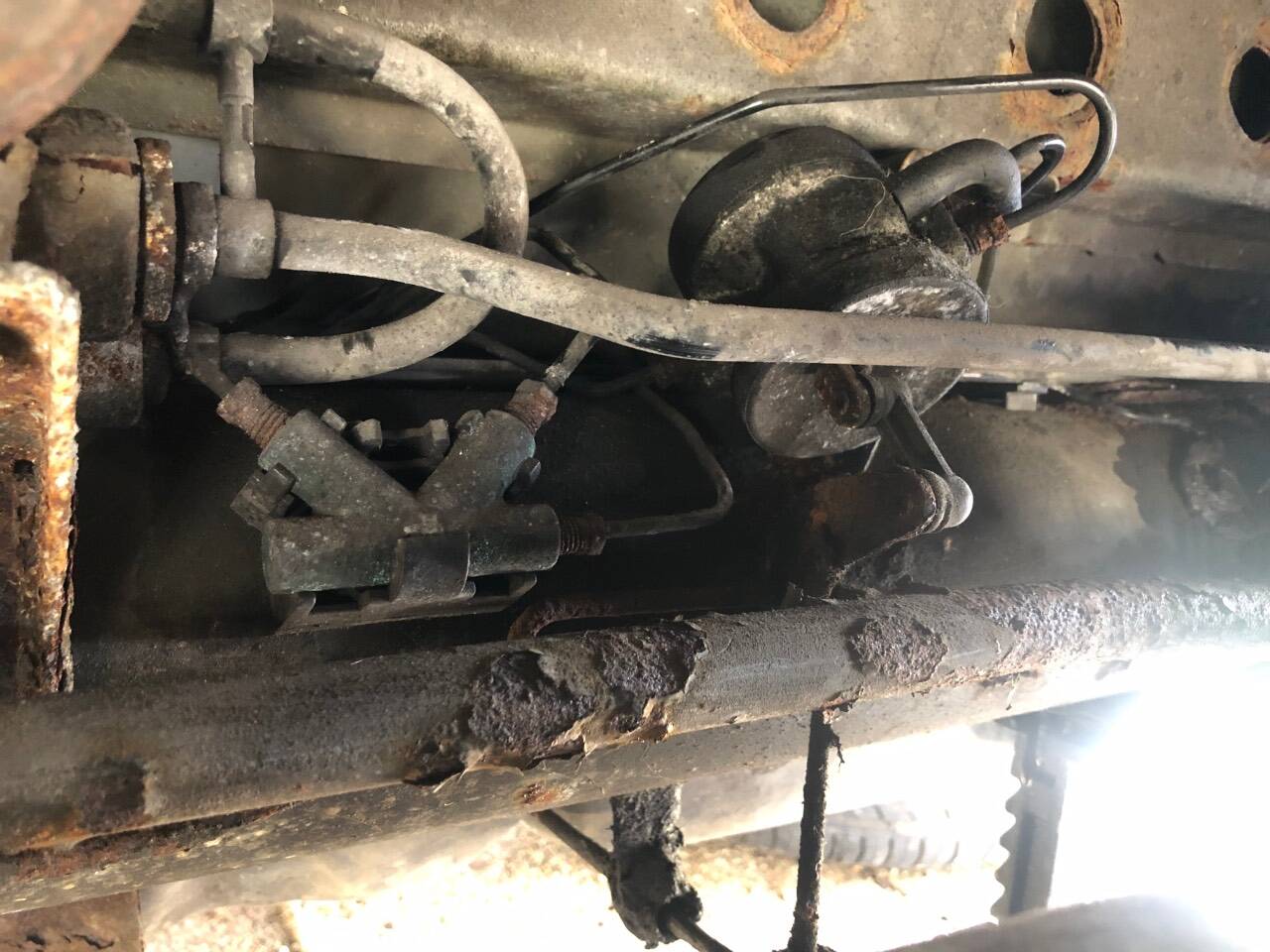

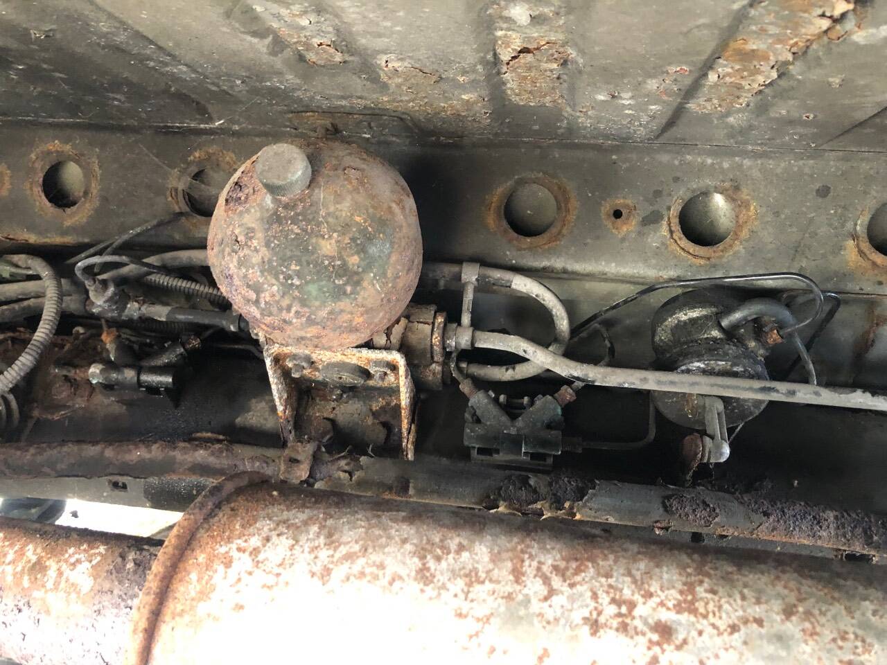

This is the clusterfuck that I could see on top of the rear beam.
Don't have nightmares, etc.
I couldn’t find any helpful pictures so I had to fumble around following the line where it dipped out of sight.
I reckoned it was the line that terminates on the furthest right side of this four way piece.
Luckily I was right. The two brackets that hold it are a bastard to remove though. Captive nut on the one closest to the beam so it just span, I managed to bend the tabs up to release the line. The bracket on the trailing arm uses a nut on a stud. It’s also in an absolute bastard of a location.
It ended up removing the stud too, space was right so I tapped it out at an angle in the end and I’ll replace it with a bolt and a p clip or something.
After that it was just a battle against plastic clips and I was free.
I did make a cut where I couldn’t get my fingers in to release a clip. The new line should hopefully push in though. I snipped the ends off so that I could put a socket over the tiny unions to crack them off - I found a 9/32 was perfect, provided you spanked it on with a hammer.
Line removed:

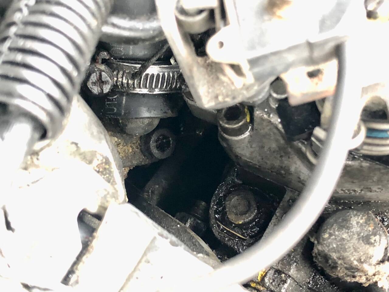

I topped the coolant up, left her running, and… nothing.
Eventually a little dribble came out.
Following it up the block…
Brought me to here:

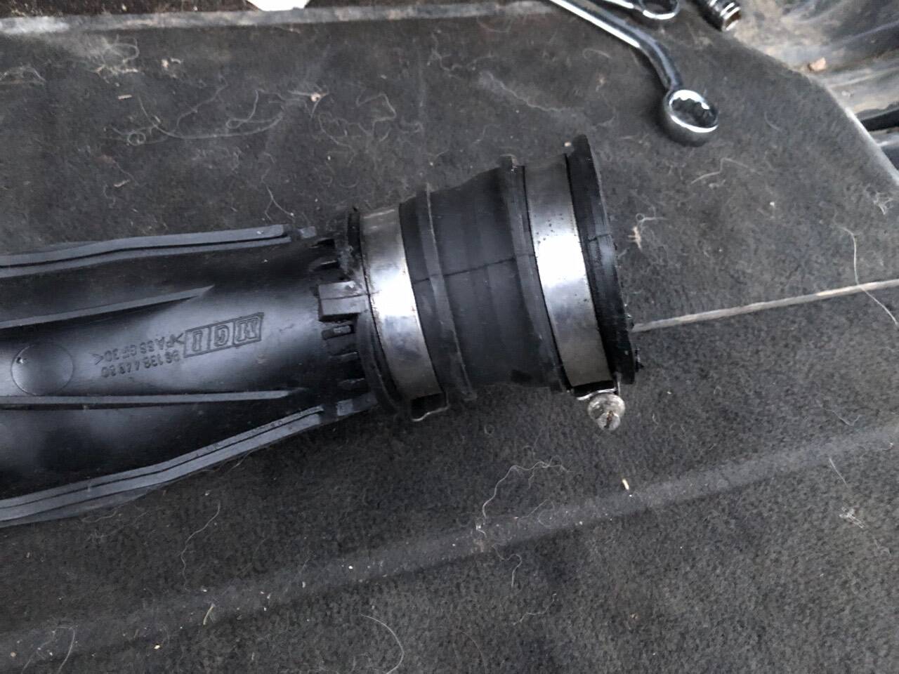

The hose to (or from, I’ve no idea to be fair) the cold start timing advance wankery enters the block here. It wasn’t visibly leaking though, just a tiny dribble down the block from that general area was present.
Being impatient, I adopted the poke it with a stick method.
That’ll be it then. It appears to have let go under the jubilee clip, and when disturbed and pressurised it pisses out coolant. If it settles into the right position then it doesn’t visibly leak. Having not got the car properly hot on the driveway, I hadn’t been able to observe this.
Funny* it made the 20 minute main road drive no bother, then immediately dumped the coolant out as the tester drove it into the bay.
