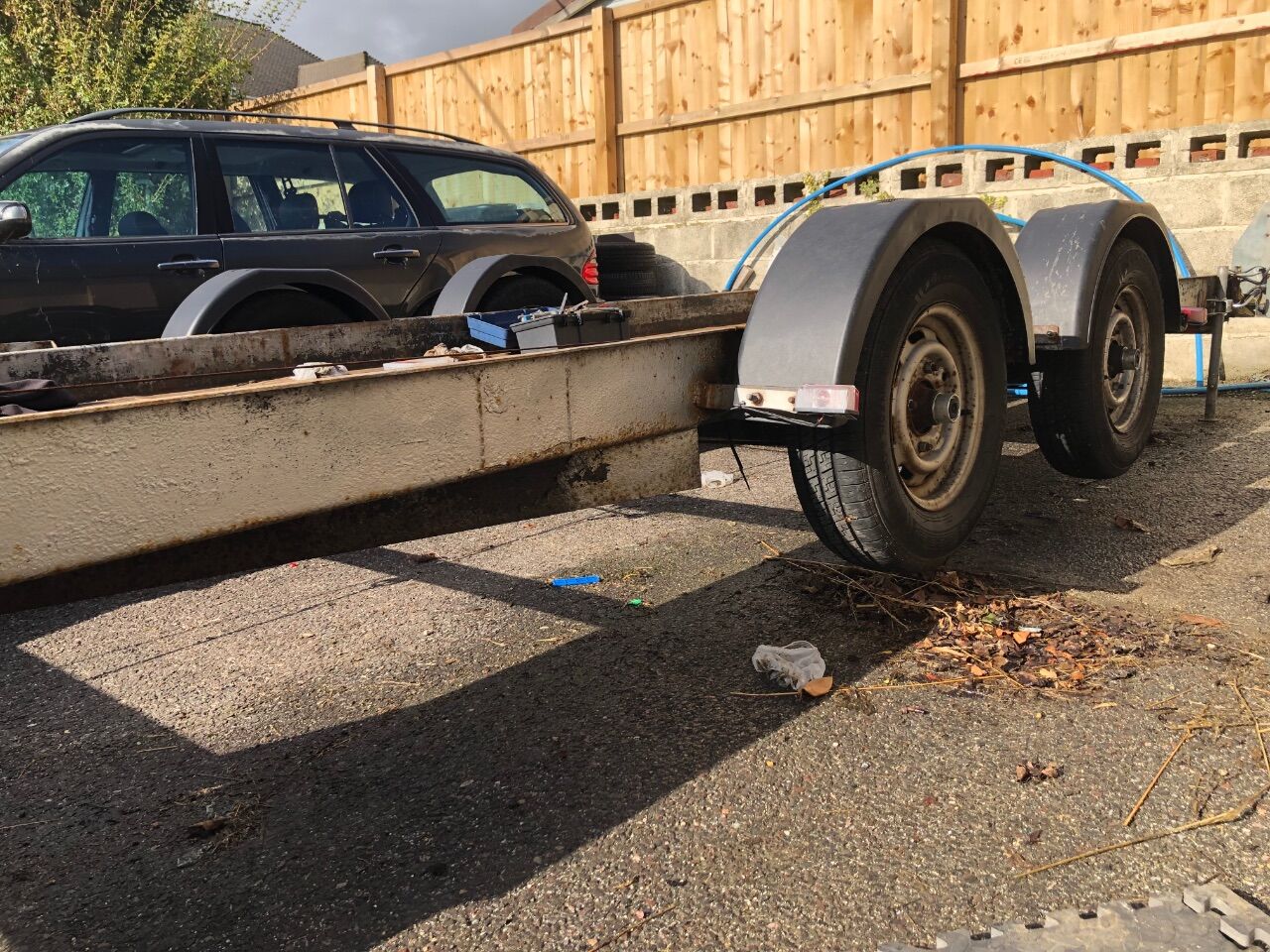

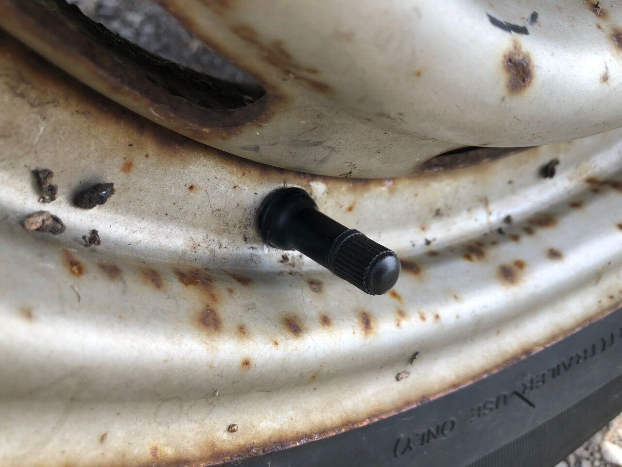

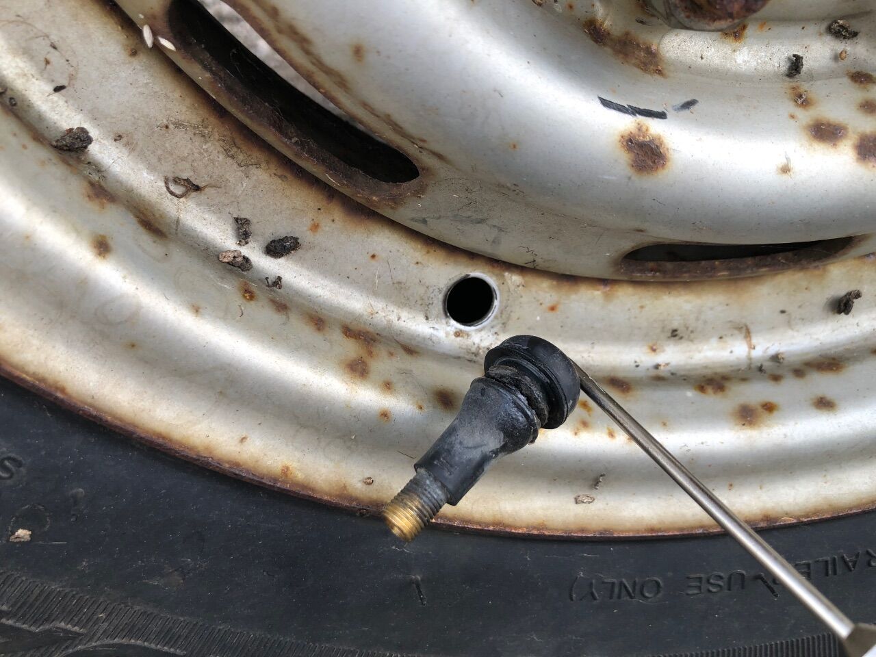

Once home, it was time to sort out some bits on the trailer. First up was a tyre valve that had split, which meant buying a new toy:
I was pleased with that - I had thought originally that I’d have to fuck around removing and refitting the tyre.
Seeing as this is a trailer, obviously all the lights were fucked despite being fixed last time. So let’s do it all over again.

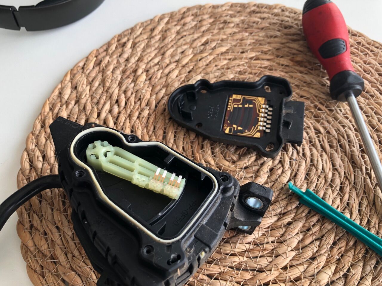

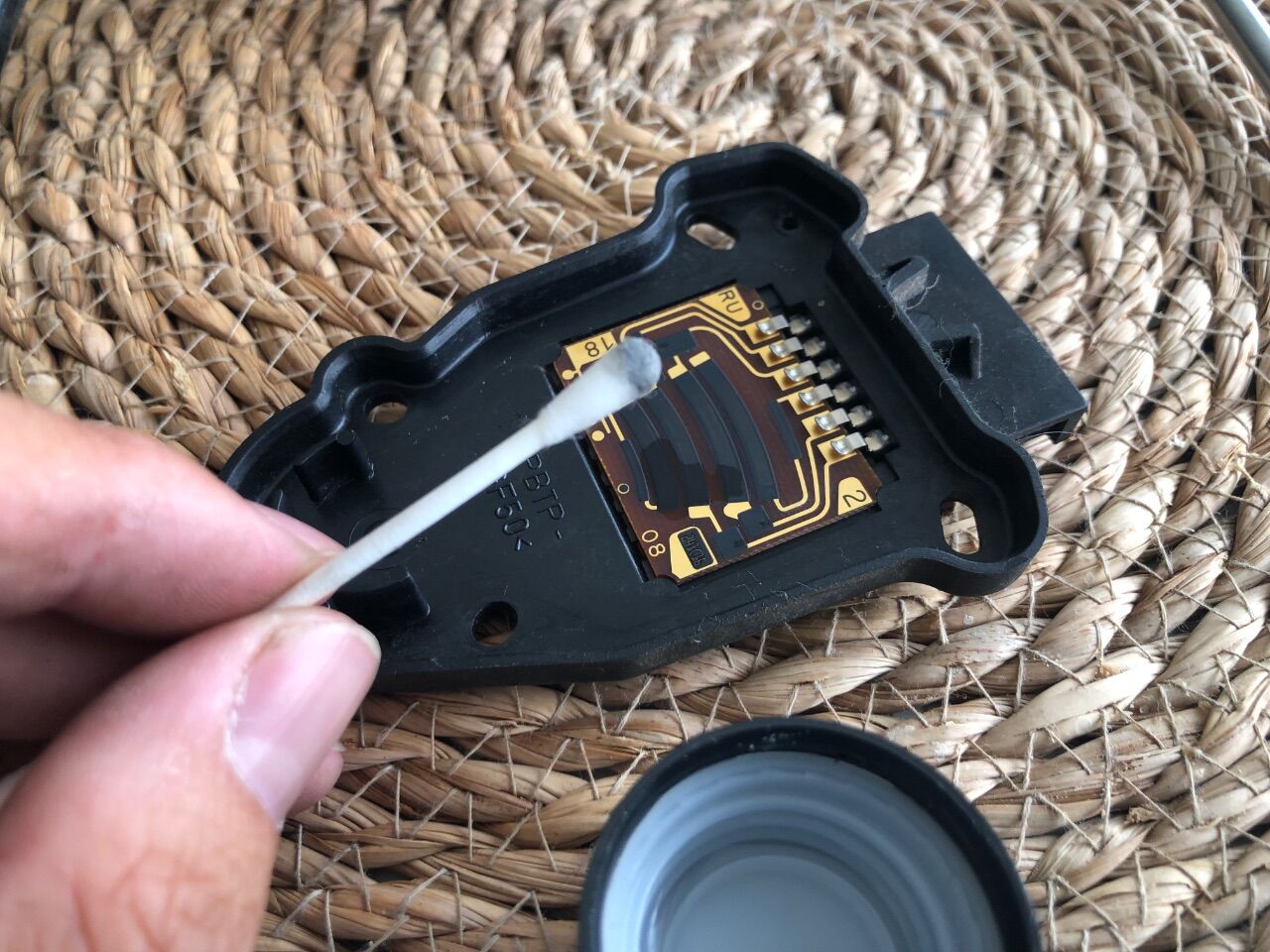

With that done, it was on to fixing the Clio, which had helpfully broken two days before we went on holiday. Anything more than a light pedal press would cause the fuelling to cut so hard it felt like you hit something. This was the culprit:
I couldn’t find anything obviously wrong, but cleaned it anyway:
I refitted the pedal with the help of my son and the problem has gone, so I’m calling that fixed.

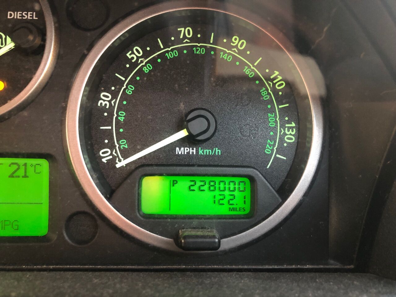

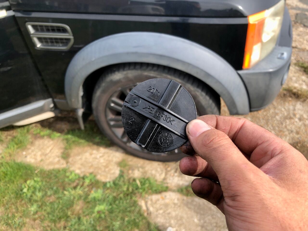

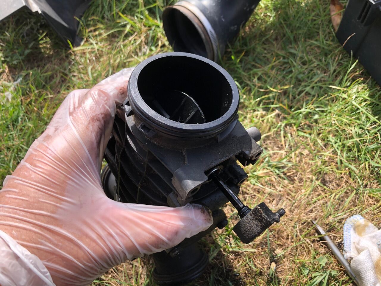

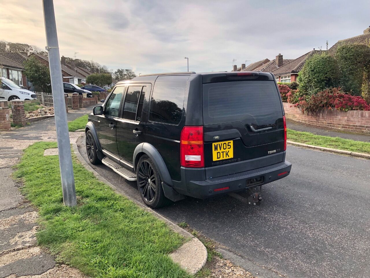

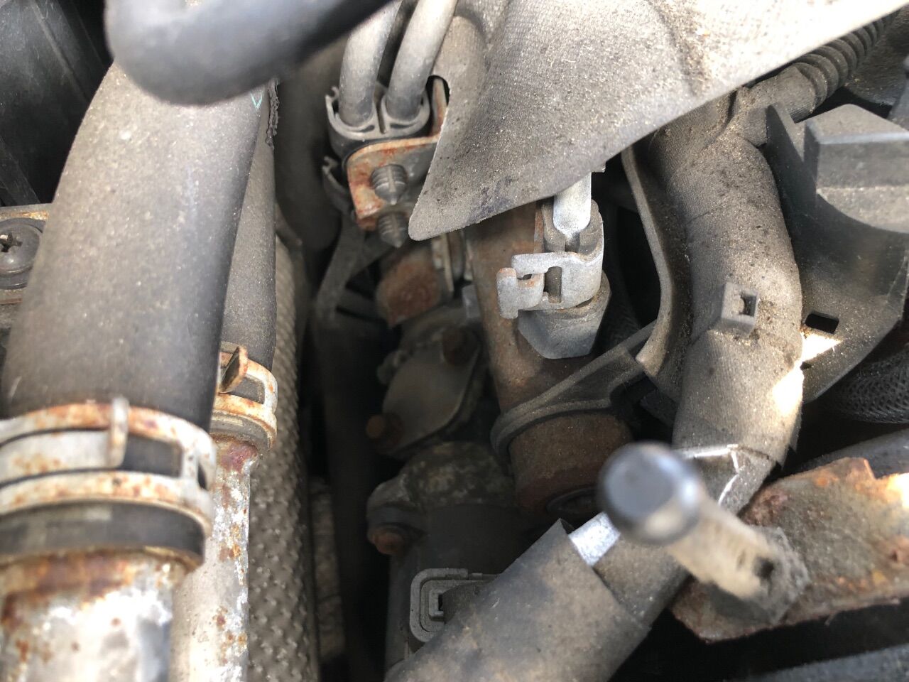

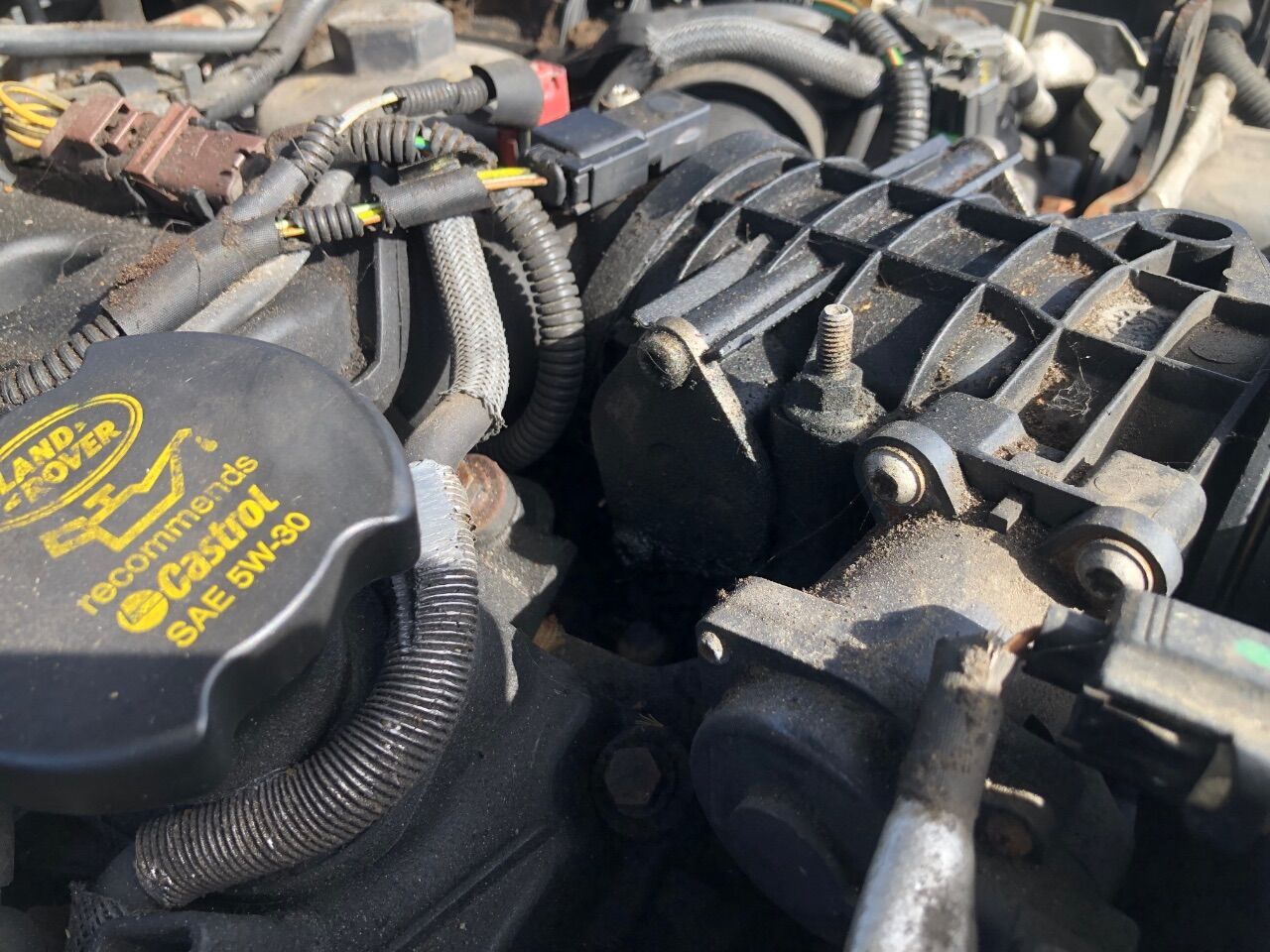

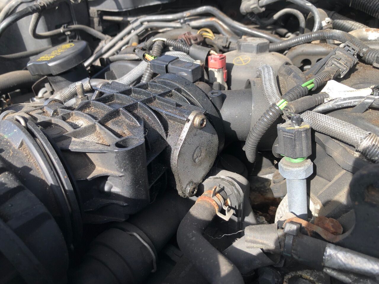

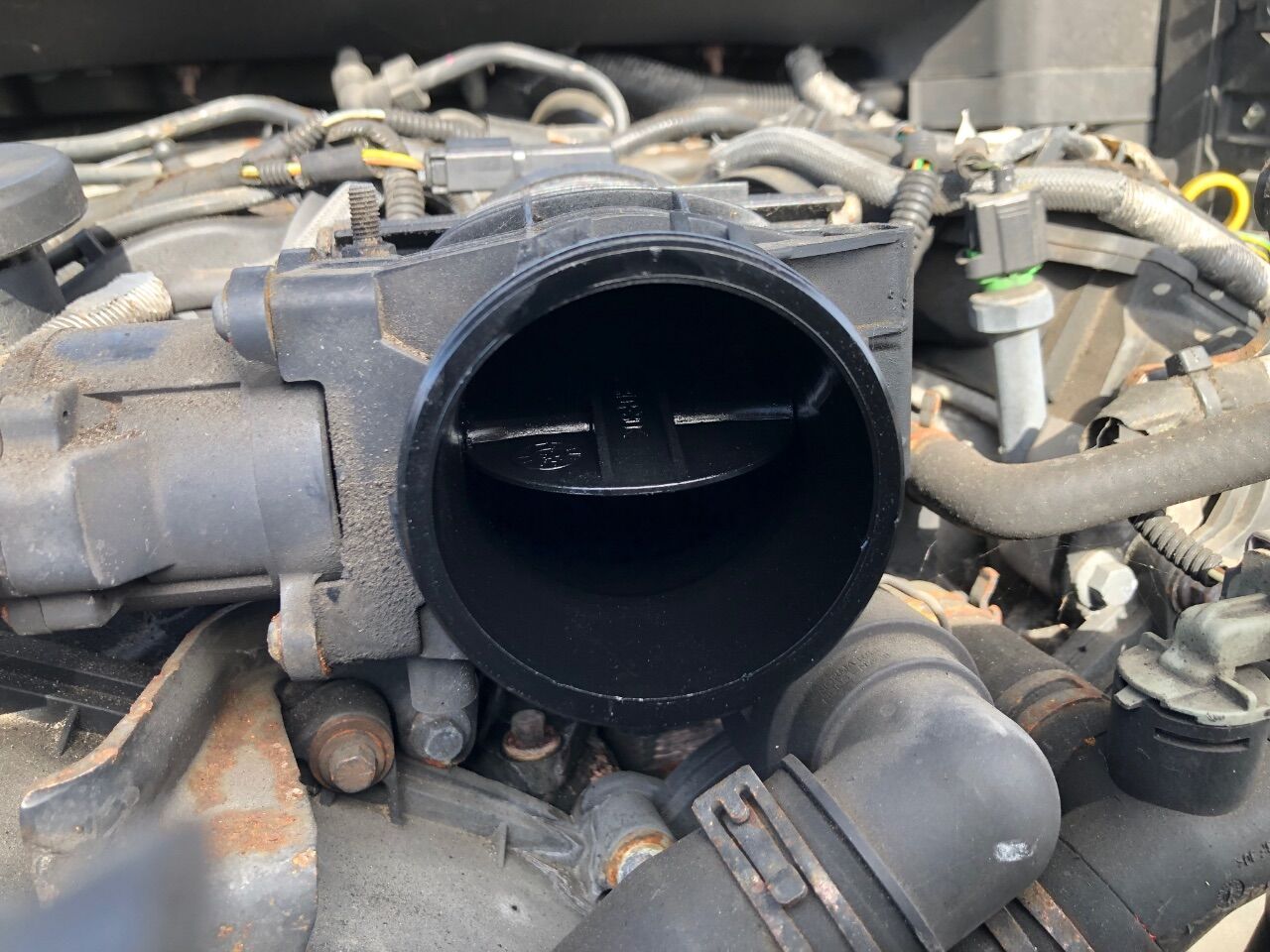

Next car problem was the Disco seeming a bit gutless and chucking out clag at full throttle. I thought I’d check the EGR, and look at blanking it. However:
Someone got there before me.
I wonder if they removed the butterfly valve?
Yeah, that won’t work.
Removing it took about 10 minutes, and the disco can now get out of its own way, which is good, because next I needed to do this:

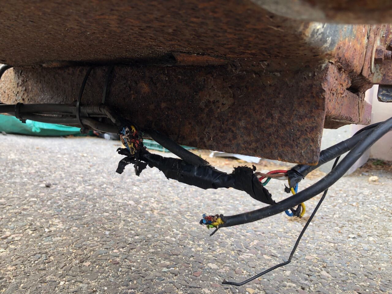

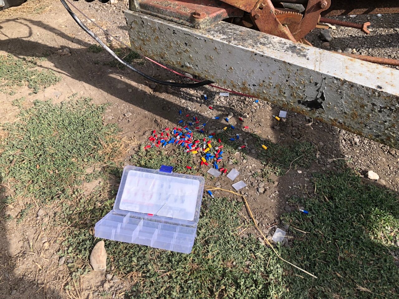

On the way back after fixing the bearing, this happened:

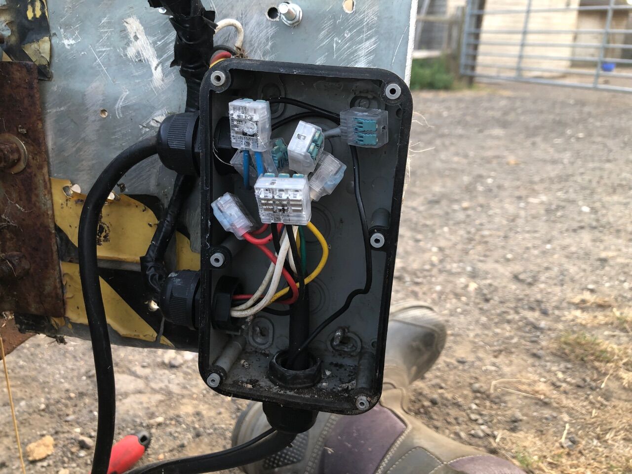

So I got to re-wire my trailer for the millionth time. This bit hadn’t been redone before, but at least this gave me a chance to route the cable in a more protected/less stupid location.

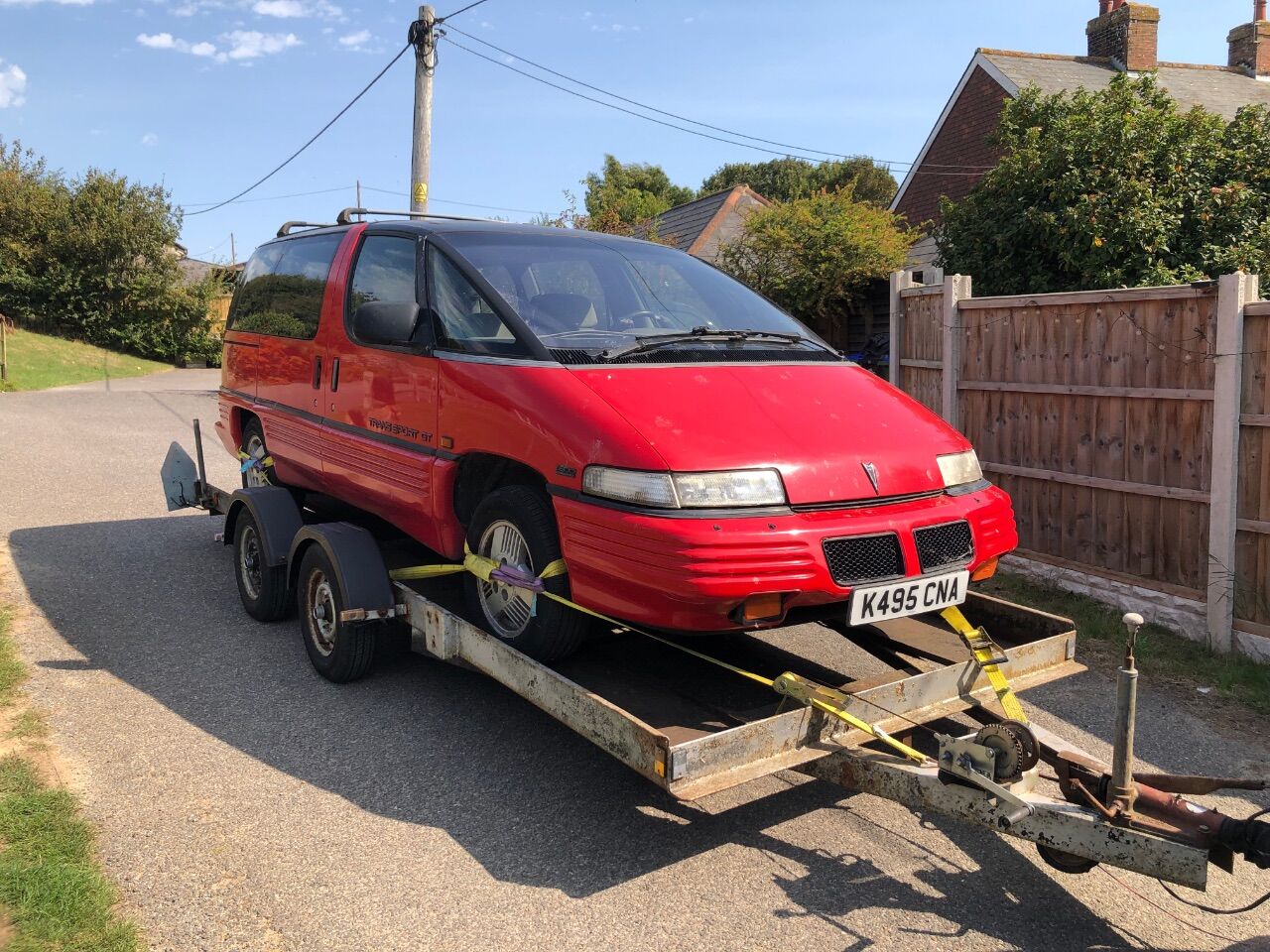

With working electrickery again, I moved this:
The Pontiac came back to my house, as it’s something I want to work on in the near future.

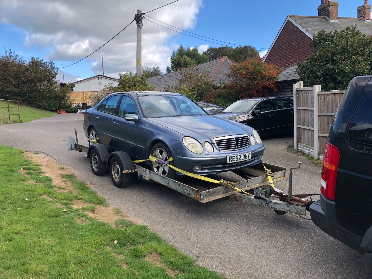

Anyone remember this thing?

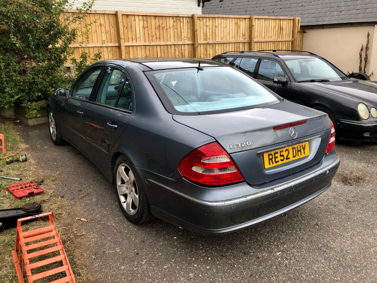

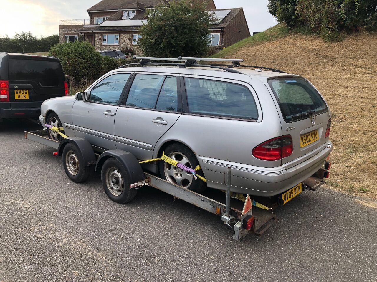

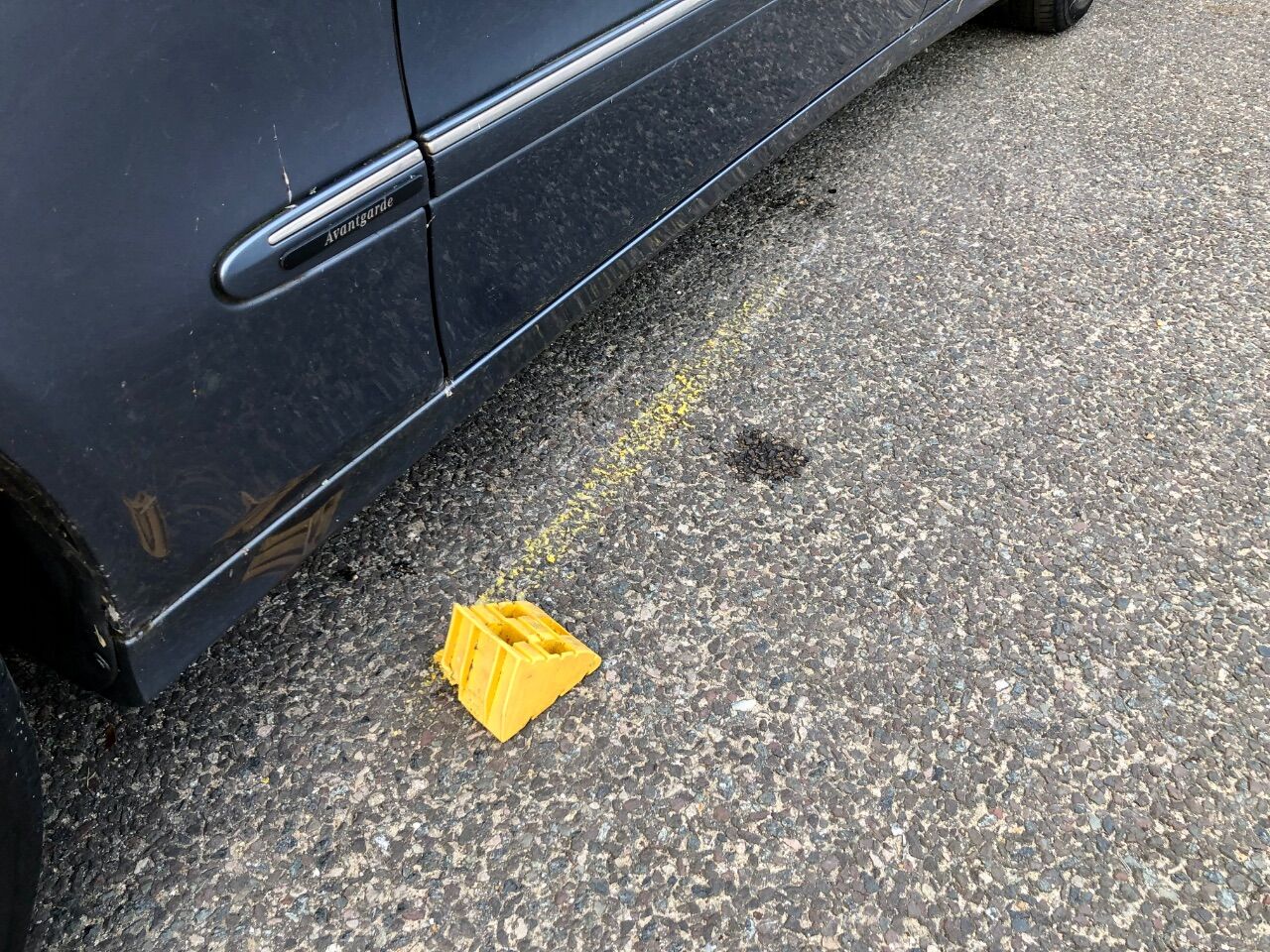

It’s my dad’s old W211. I did the MOT work on it a while back, but he replaced it with mix of cars borrowed from me and then a much newer E class, so it sat unloved for ages. He’s said I can have it as he only got offered £75 scrap for it locally, so I threw a battery on it and fired it up.
Result. It did light up like a Christmas tree, but clearing the codes stored from the low battery voltage got it back to a point where it was happy.

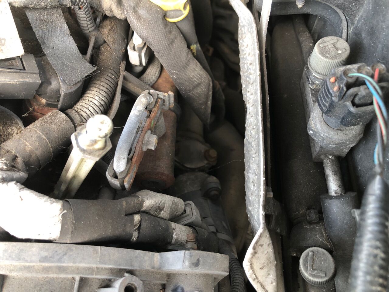

Whilst test driving it on the farm I did start to hear a metallic dragging sound, and then this fucker fell out from under the car:
I think it’s a leftover that I replaced, but I’ll have to go back to where I was working last and check it’s not something that was loose from the suspension work.

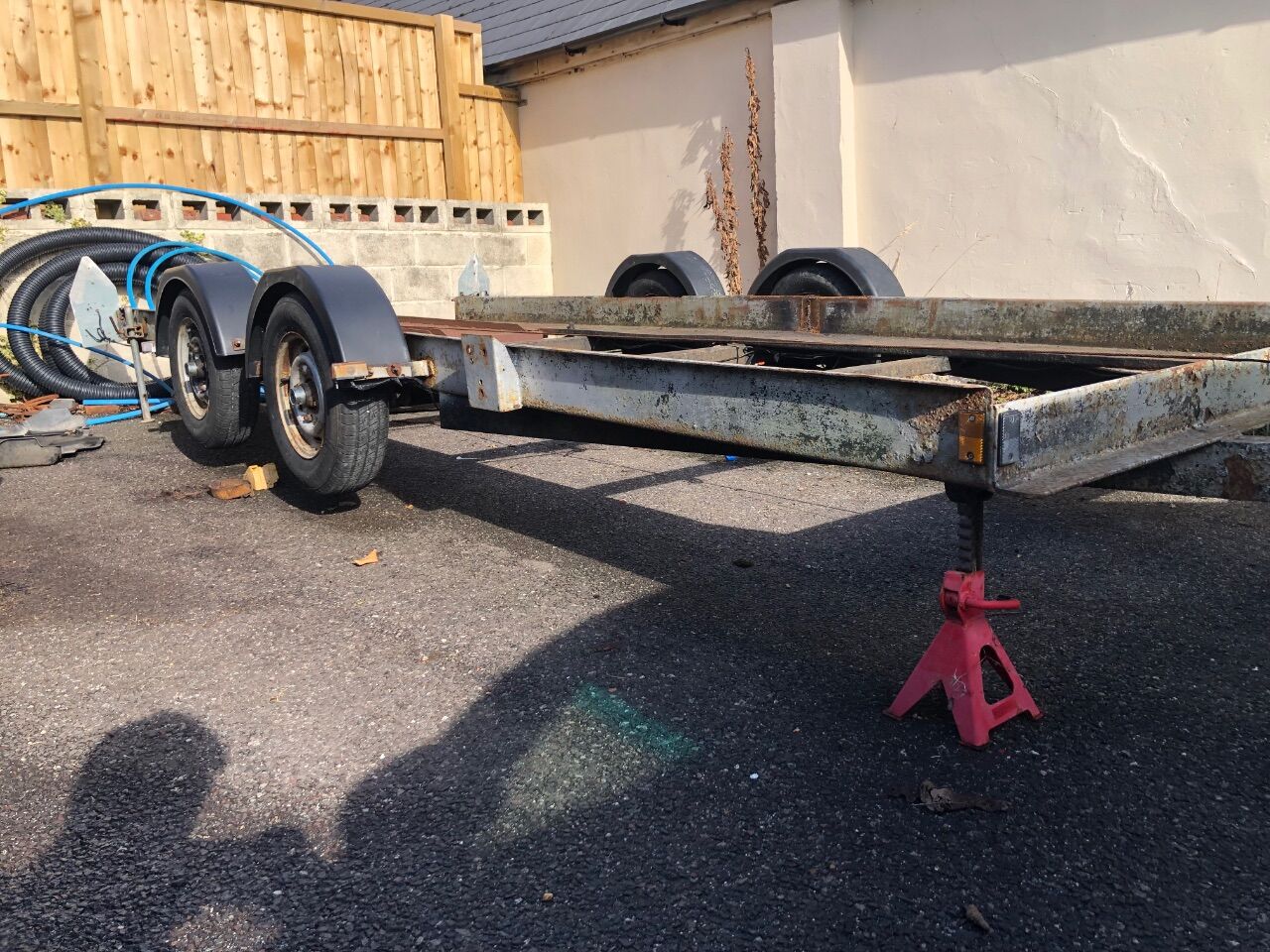

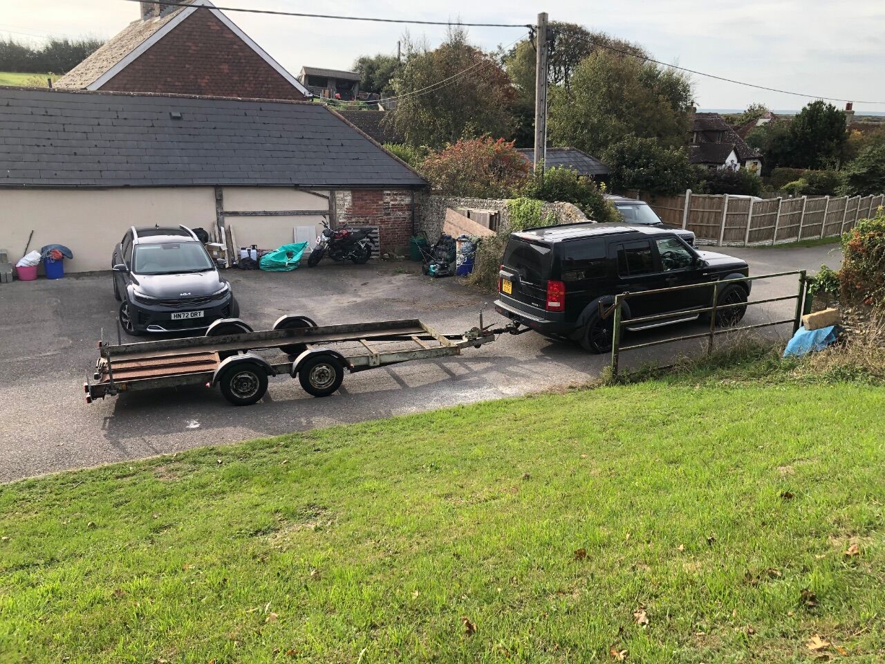

Lately my efforts have been focused on my Big Shite Trailer.
The trailer is believed to be a Peak trailer from the 1980’s, but it’s hard to tell. It’s built in the style of the Brian James race trailers, but it’s not galvanised and it uses rod brakes rather than cables.

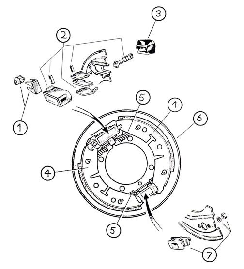

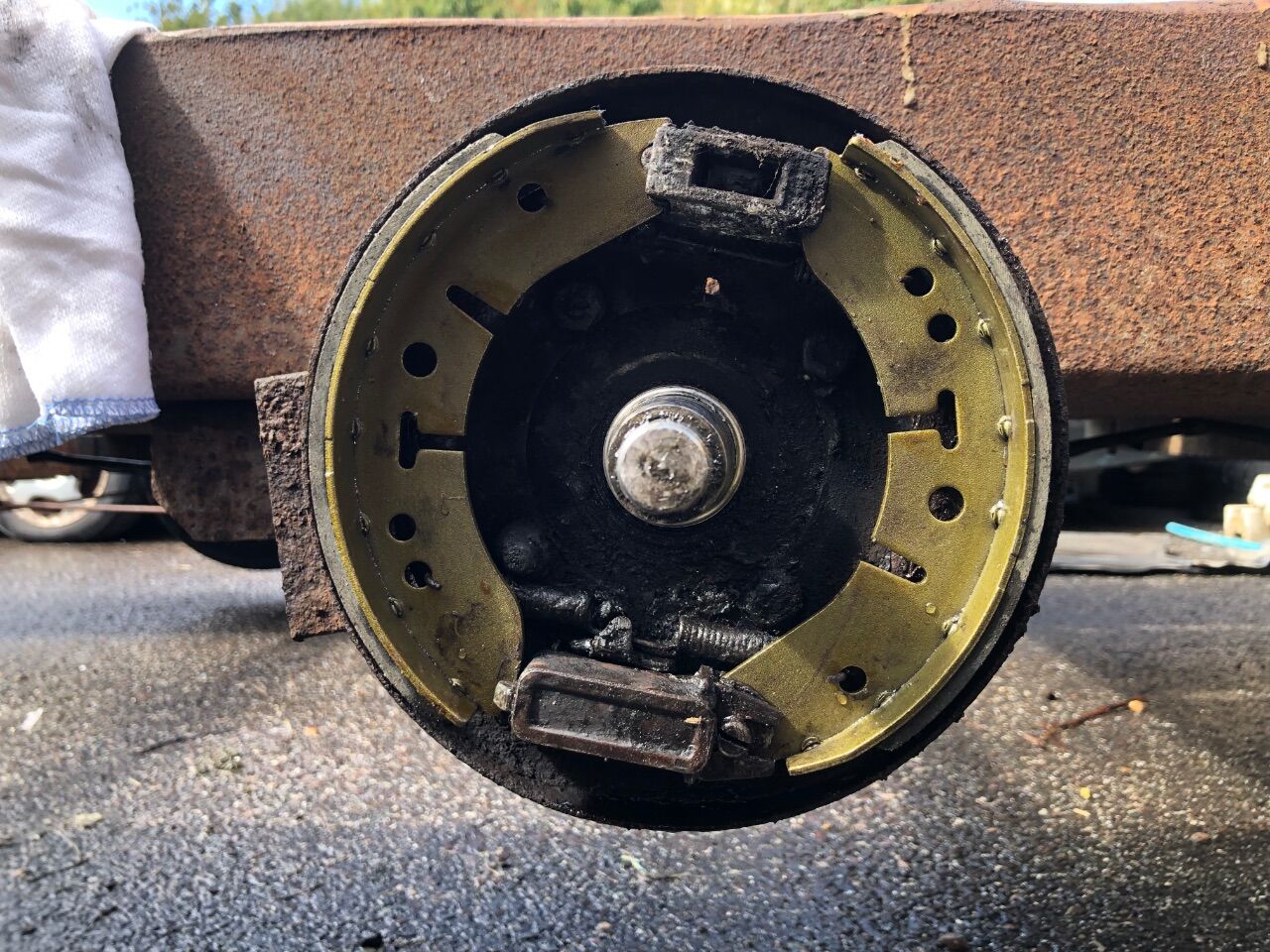

The brakes have always given me grief, they’re very needy and I was constantly having to tweak them. I had assumed they were 200mm x 40mm drum brakes, and I had no joy finding spares. I’m unsure how, but recently I was researching again and I had the revelation that the brakes were actually Lockheed 8” drums - very close to 200 x 40, but not the same.
You can buy new shoes for about £40 an axle, and seeing as all my rear shoes had failed recently I did just this.
On Wednesday I went up to fit them, and one side went together no bother.
The other side just wouldn’t retract enough to fit the drum. It looked right, but the expander was refusing to budge in any further.

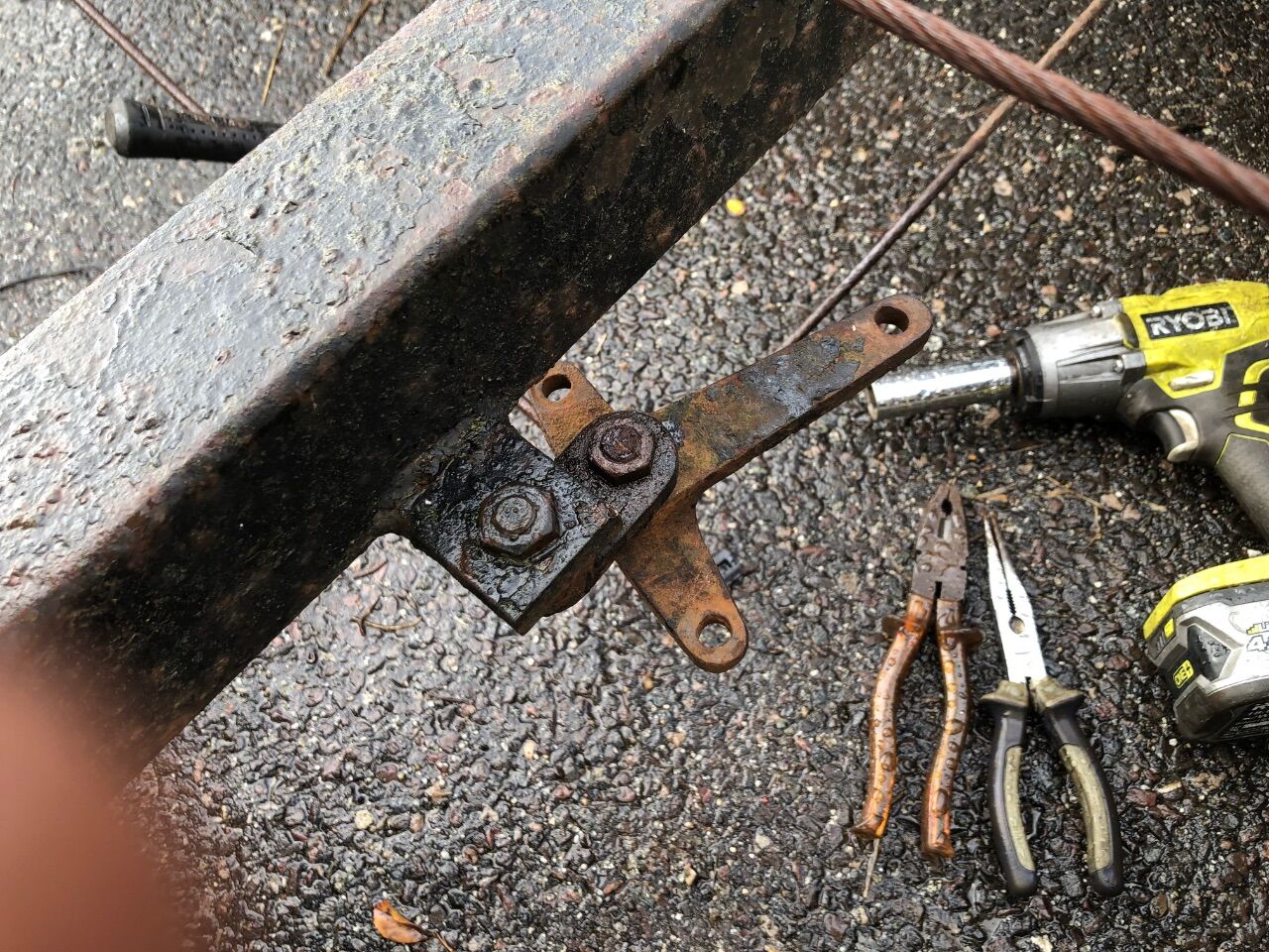

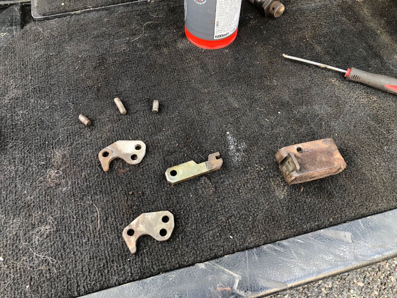

Today I decided to take a brave pill and start pulling the brake system apart.
It turns out you can completely strip the expander without any tools, although a drift helps.
I cleaned and greased this one (plus one sticky one on the front axle). It was handy to see how the rods join on the the expander, as it may give me options to replace the slightly bent rods at a later date.
With the rod off, I noticed the pivot arm that balances the brakes on that axle was seized. I didn’t feel great about taking it apart as I reckoned something would break, but the impact gun did remove it without issue. Picture taken before fighting the big bolts/nuts:
I cleaned and greased the pivots and the pins, and put that back together too.
It made quite a difference to the geometry of the rods, and it moves freely now.
I then put the shoes back on the back plate that I had been fighting with before. This time, I had a retracted set of shoes that now took a drum…  result!
Whilst the trailer was up in the air, I adjusted the brakes and the balance is now much improved and the brakes lock up evenly when applied and release smoothly afterwards.
Whilst the fronts still have some meat on them, one shoe is unevenly worn on the offside and so I expect I’ll be buying and fitting a set of shoes for the front axle this week.
All being well, I should be ready to start moving more cars and hopefully having less downtime - I’ve spent far more time fucking around with this trailer than I have moving anything 🤣

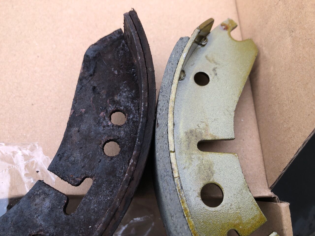

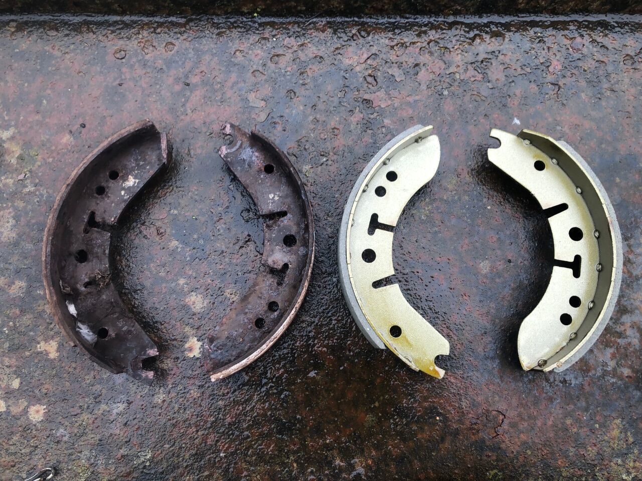

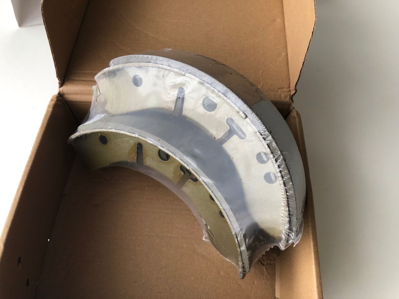

I was correct! I did end up buying new brake shoes. Also, a shout out to the sleuthing that @Mr_Bo11ox did on his trailer thread, where he was also faced with the same Lockheed 8” shoes - he spotted that they were also used on some Morris Minors, and it turns out that ESM are near to where my mrs work and could supply an axle set of shoes for £18, which makes the £40 I spent on the last set feel a bit salty.
On Friday afternoon I needed to pick my one year old daughter up from the childminder at lunch, so I pre-ordered the shoes from ESM and went to pick them up on the way back. They had some beautiful cars as well some other lovely projects there, although my daughter was most enamoured by the digger* (forklift) which she couldn’t stop talking about after we saw it. 14/10, would use ESM again for brake parts on my shite trailer.
This is the new shoes shown against the ‘best’ shoes from the trailer:
The second best are even worse:
Note the uneven wear - I’m hoping I’ve sorted this now I’ve rebuilt the expander in this drum and adjusted the rods.

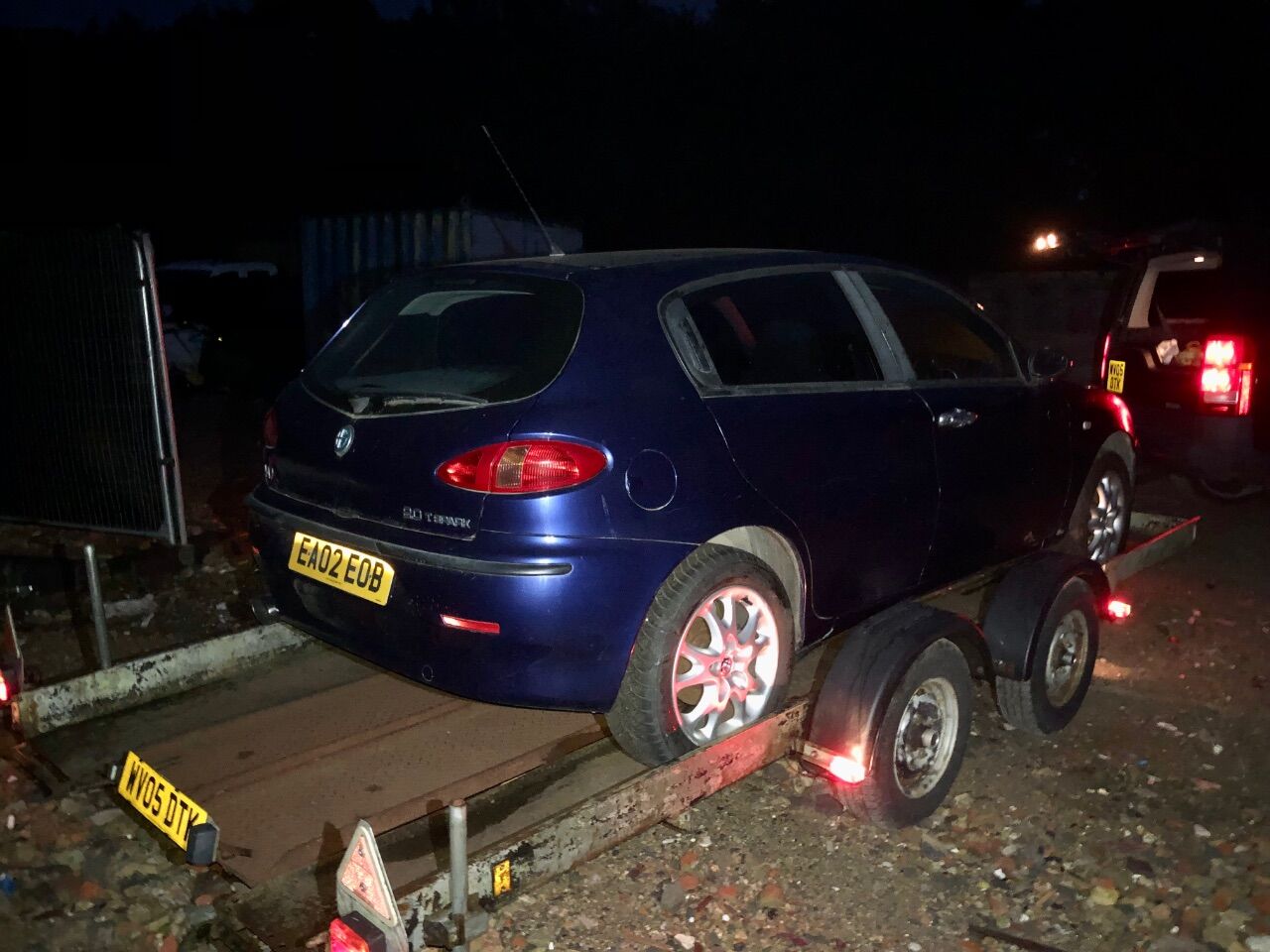

I’m finally home! What a day.
Big shout out to @DaveDorson, what an absolute gent - 11/10, would happily drag a project car off the driveway with him again!
It was dark when I finally got back to my yard - sat nav reckoned it was 2 hours or so from the collection, but it took me over 3 hours to get there even though I only stopped once to tighten the straps after a few miles.
It’s a really beautiful car, you can tell it’s been well loved. The spec is nice too, it looks like some optional extras were specified as it has heated seats and climate control.
I had originally suggested to my partner that she could run it when fixed, up until I sold it (the plan wasn’t for it to stick around). However, I’m pretty sure I won’t get it back from andie if I let her run it. This isn’t necessarily a bad thing, as she’s been asking to upgrade from the Clio for a bit, but it means I’ll possibly need to figure out something else to fix and sell afterwards.
I left the trailer at the yard, as I couldn’t deal with driving home at trailer speeds. It’s also feeling a bit sad, I cracked the bed again on the way up - I’m pretty sure I could pinpoint where that happened, there was a fucking massive rut in the M11 that I had to ride through, the trailer pretty much took off. I reckon its days could be numbered, or that I need to buy some fairly thick steel and make some repair sections for where the previous owner has notched the bed. Its getting a bit like triggers broom though.

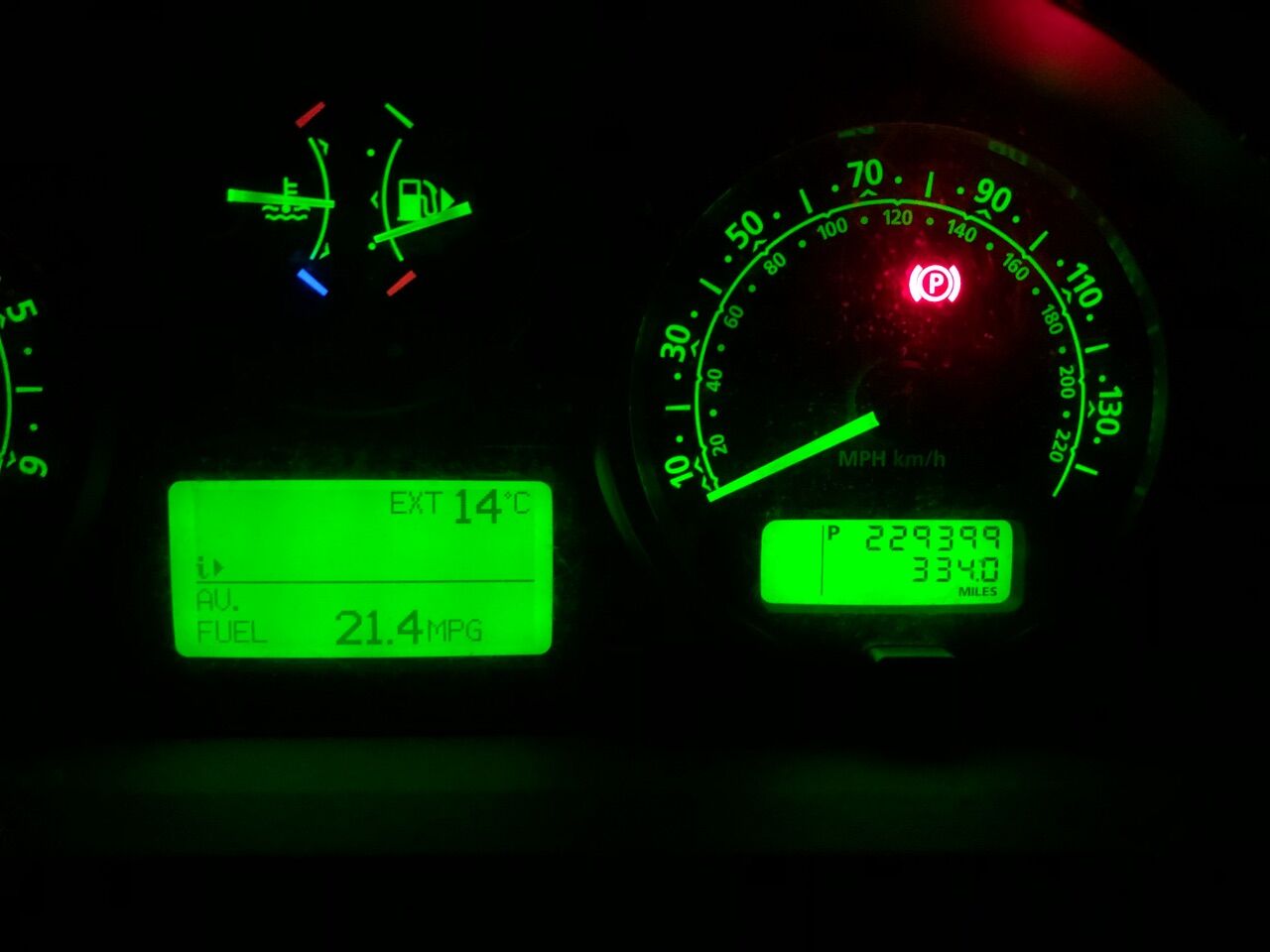

The disco did a good job, here’s the final scores on the door:
It’s a thirsty old beast, but it does tow really nicely. It also feels like a rocket ship when the trailer isn’t connected 🤣
