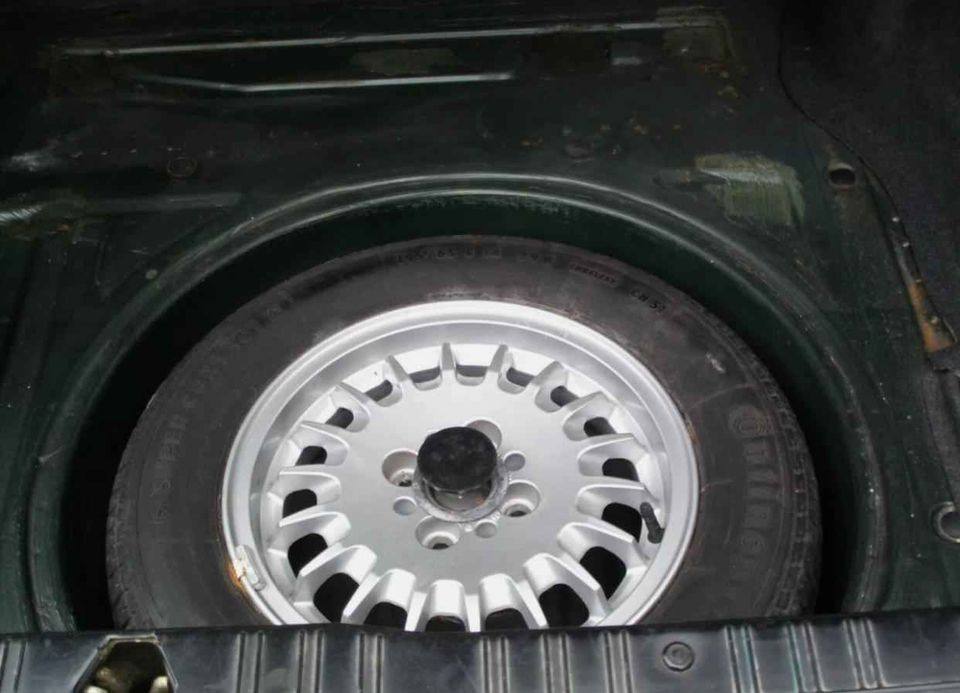

This is solid underneath fortunately - it has rust on the front valance or metal bumper, and rear valance, and the bit around the sunroof, which was allegedly bodged by the previous owner. I've seen much worse, sold for more money with more doors. Auto isn't a problem, it doesn't bother me but it's a day's work to swap for a manual. :)
191169655_10159122318290289_2454485327469954991_n.thumb.jpg.3c5407a40b3d640363f21e16e7af9b2a.jpg
I don't know what this is exactly (filler?), and I know they go around this area, but I know it'll need to be cut out. It doesn't leak though ...
