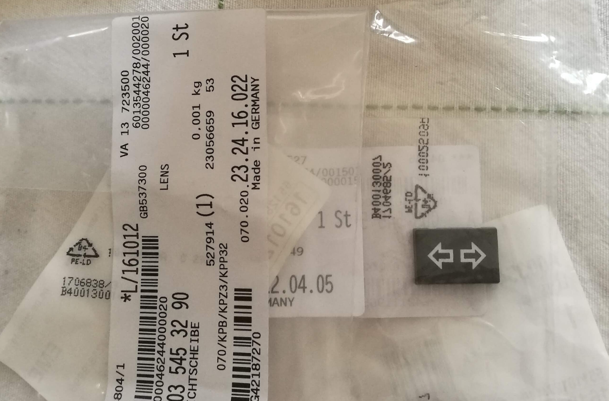

Have you tried Merc themselves for parts?
I was surprised both by the availability and in as many cases as not how reasonable the prices were when I have both the camper and the S123.  Obviously not as you can probably get stuff of Autodoc or eBay, but for the proper stuff that you know will fit and isn't made of cheese I always reckoned it was fair value.
This was the one that surprised me the most I think.
Replacement lens for the indicator light on the dash (mine had a crack in).
For a 30+ year old van.  Guy on the desk was hugely apologetic that they couldn't get it same day as it would have to come from Berlin.  Think it was something daft like £1.50.

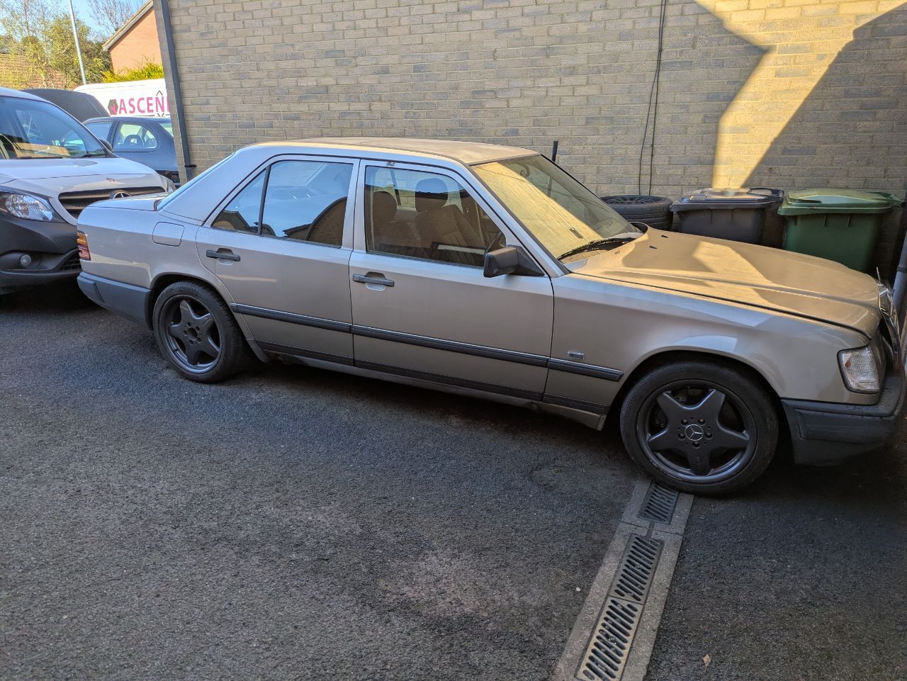

Found some new alloys. Some 17" 225 front 245 rear alloys off a w208. I think these are normally on a clk430.
Before:
And after:
The fronts seem to fit pretty much perfect the rears seem to be ever so slightly too wide. It's borderline legal. Might need to roll the arches to make them fit better.
I think although not standard they look a lot better then the ones that came on the car! They also fit absolutely perfectly around the w203 calipers.

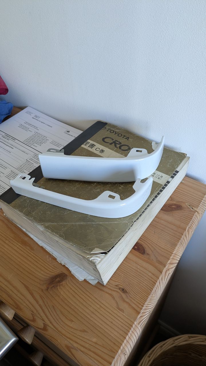

Another little fix while I wait for the water pump pulley.
New boot buffer alignment bits.what the old ones look like:
Boot is still miss aligned. Will need to do so messing about to sort it out.
Before:
And after:
They look like they fit fine...are they rubbing on the rear?
I imagine they will slightly, people have reported going from 245 to 235 helps a lot but I need to test them out. I'm waiting on a new waterpump pulley so I can get it through a mot. Hopefully that will be the final thing!

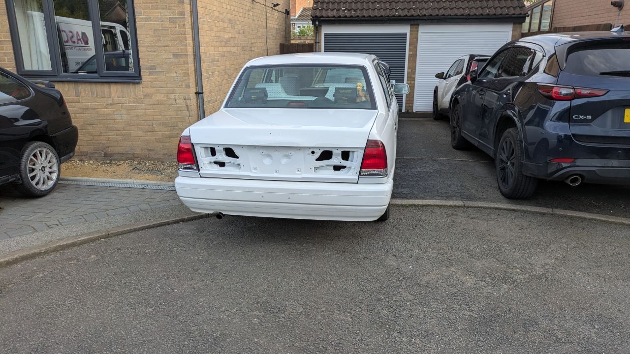

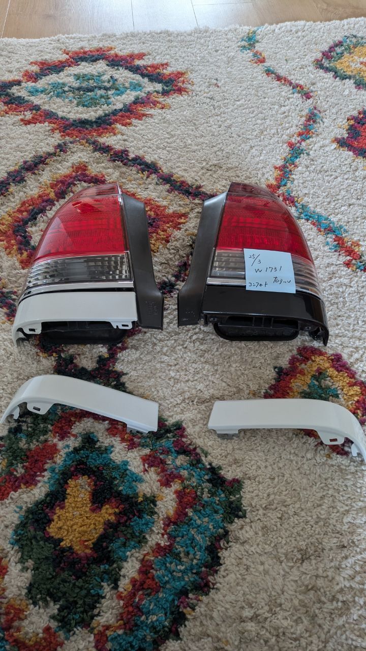

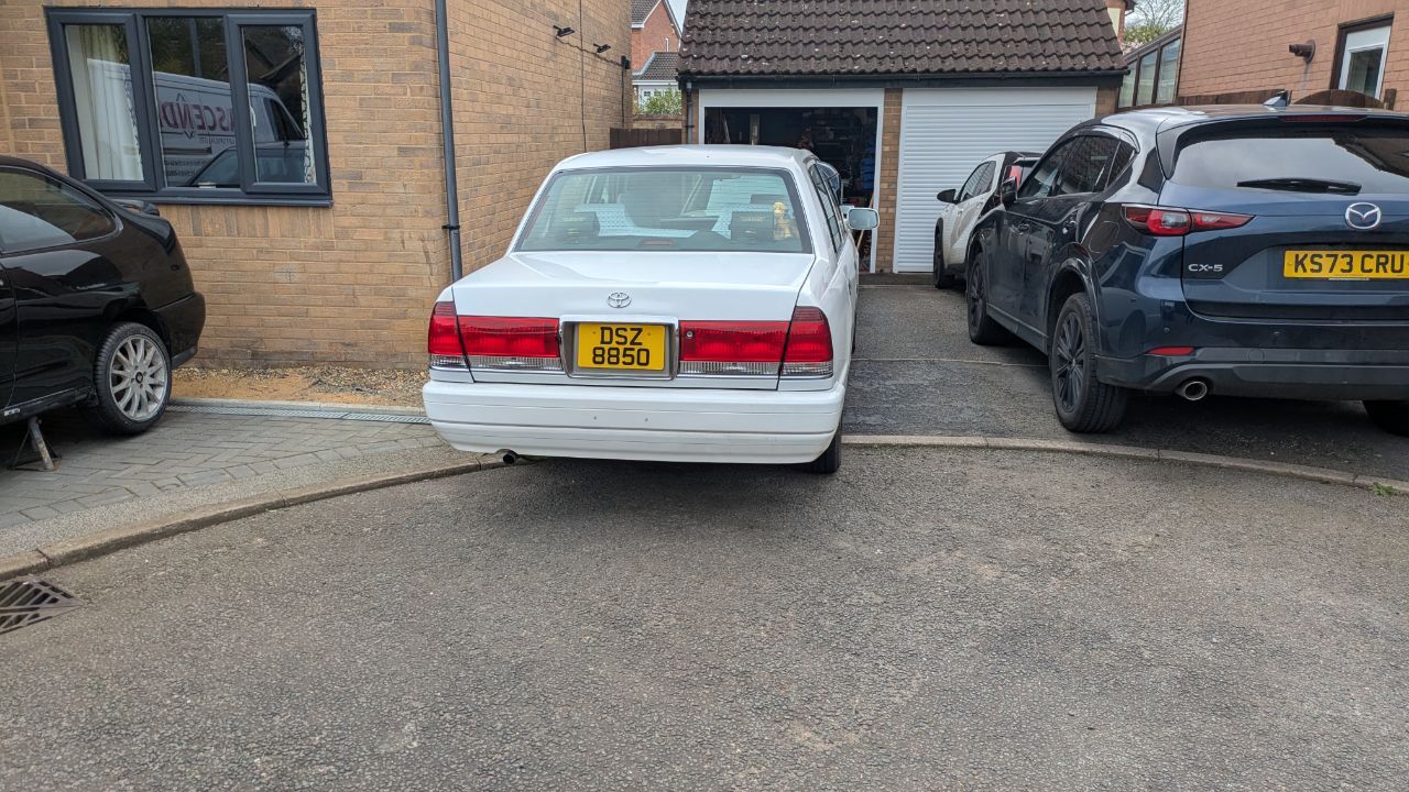

Did the rear end conversion on the Toyota after months. How It started:
After taking all the older parts off and fitting the new boot:
The new rear light clusters and painted body panels that go below them:
After fitting them:
Then I ran into a issue. I assumed the lock cylinders were the same but unfortunately they are not, I did not want to buy a entire lock set for the car as it would take ages to arrive. Maybe I will in the future. For now I took the cylinders apart and swapped all the pin things over:
It seemed to do the job but I should eventually just replace all the locks while I can still buy the set!
Then it was time just to assembly all the parts on the boot itself.PXL_20260404_095648214.jpg.5b6f49f24808fd4d05ca01cd93225d39.jpg
I have a couple missing light fittings so I will need to order some bits, but I got the lights working to a basic legal standard for now. As far as I know this rear end was never fitted to a short wheelbase comfort, I've seen one in Japan someone did a conversion on but it's got to be one of maybe a dozen! Looks like a little boxy American car!
  • Skcat changed the title to SKcats fleet. Toyota comfort rear end conversion.
A big improvement in my opinion. I still can't believe how much smaller it looks in the photos compared to seeing it in person.
