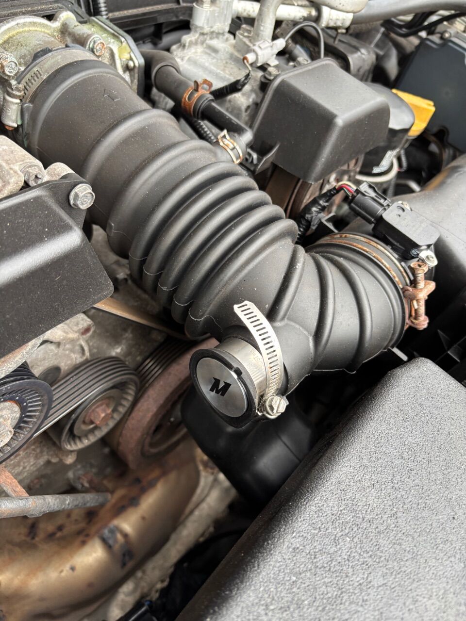

It’s a Mishimoto sound generator removal kit. A GT86 has a noise generator that throws engine noise into the cabin. That’s great when I’m driving it like I stole it on a track, however mine spends most of its time doing 15mph between Birmingham and Oldbury, so it gets grating. So I pulled it all out and fitted the CNC part:
Has made the jubilee clip look a bit unsightly but it’ll do for now until I can get a smaller one.
Pulled all the pipe work out and plugged the firewall side with the spare 12v cover as per @mintwth suggested. I do want a more elegant solution to that though so I’ll likely see if I can find something else e.g. a rear wiper bung from a base model Peugeot 106 and see if that fits (they look about the same size). Engine bay also has a bit more room for activities now:
Now I can enjoy the music of my teenage years, that time when I had hope and drive, in peace:

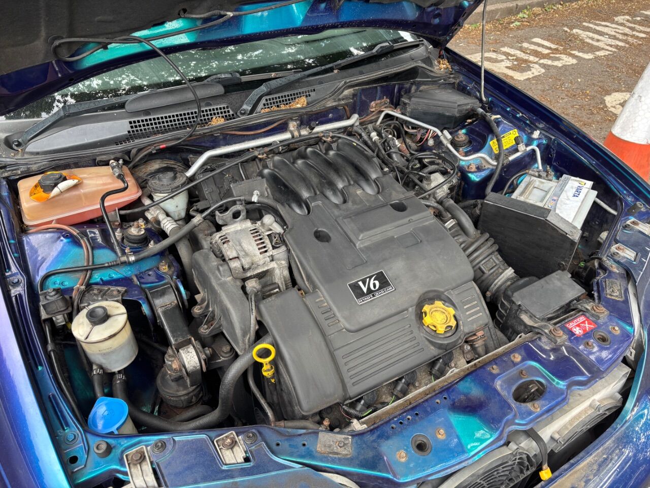

MG has had an unburnt fuel smell from the back for a while now. These do suffer with the tanks failing however mine had a brand new fuel tank a few years ago. I did check anyway and every joint is dry. No petrol anywhere.

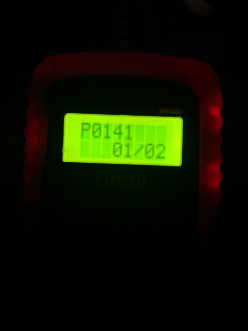

I did ask elsewhere if I was missing anything. It was suggested to me do a live data check to see what the car thinks the ambient air temperature is. Sadly, while my OBD reader can’t do this, it did show me it has a fault code:
P0141 should bring an EML on but it hasn’t in this case (EML works fine, the code reader even detects the EML is being off). That’s the post cat lambda sensor. This’ll explain two (maybe three) things, why my oil stank of fuel, and why the car stinks of fuel, and it may also explain why the car turns for two seconds or so before firing. £48 from DMGRS. Will get this sorted ASAP and see if the fuel economy improves.

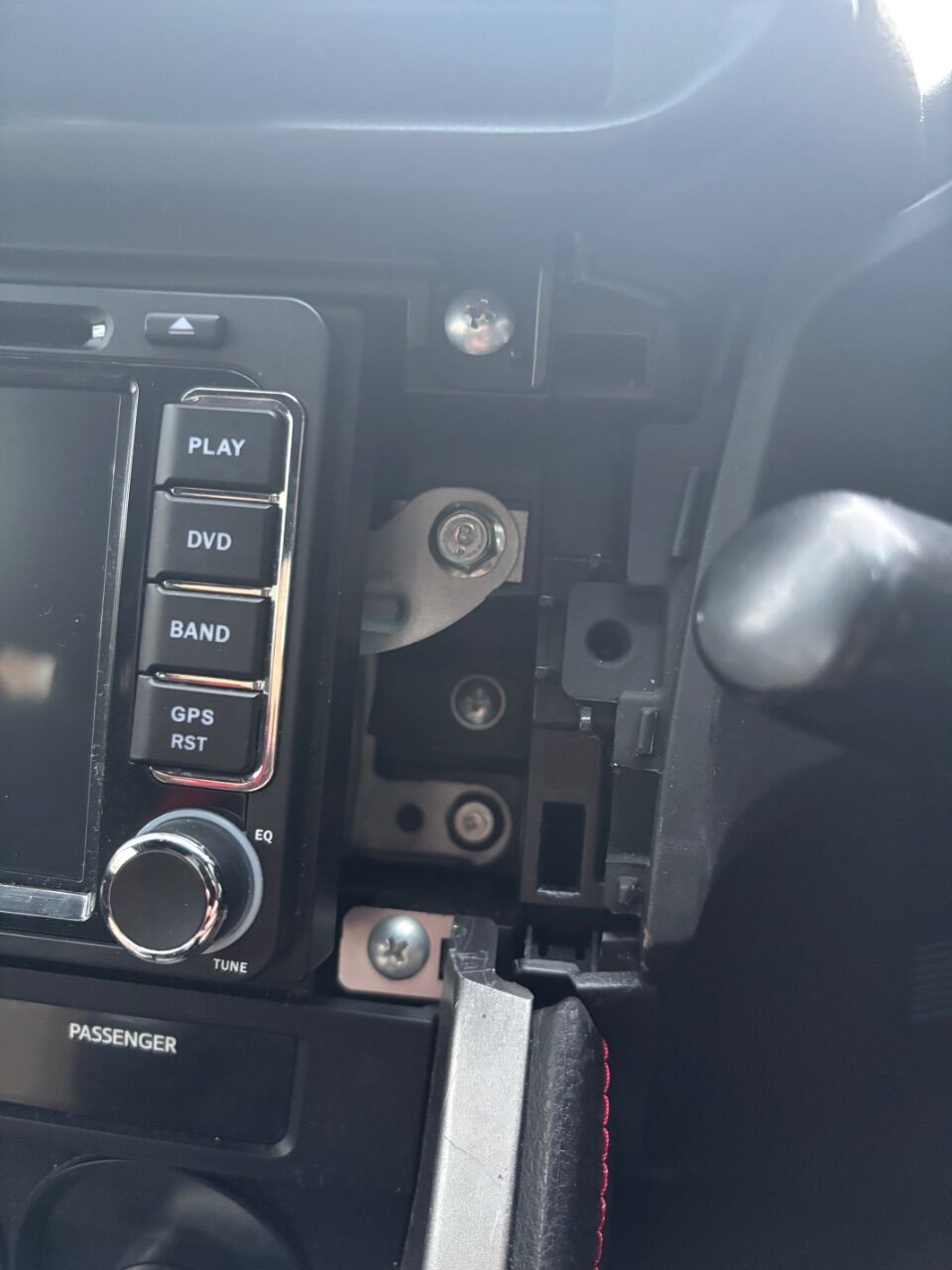

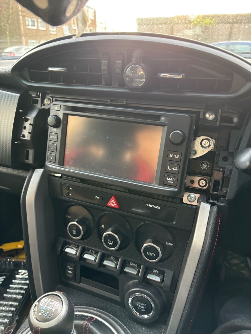

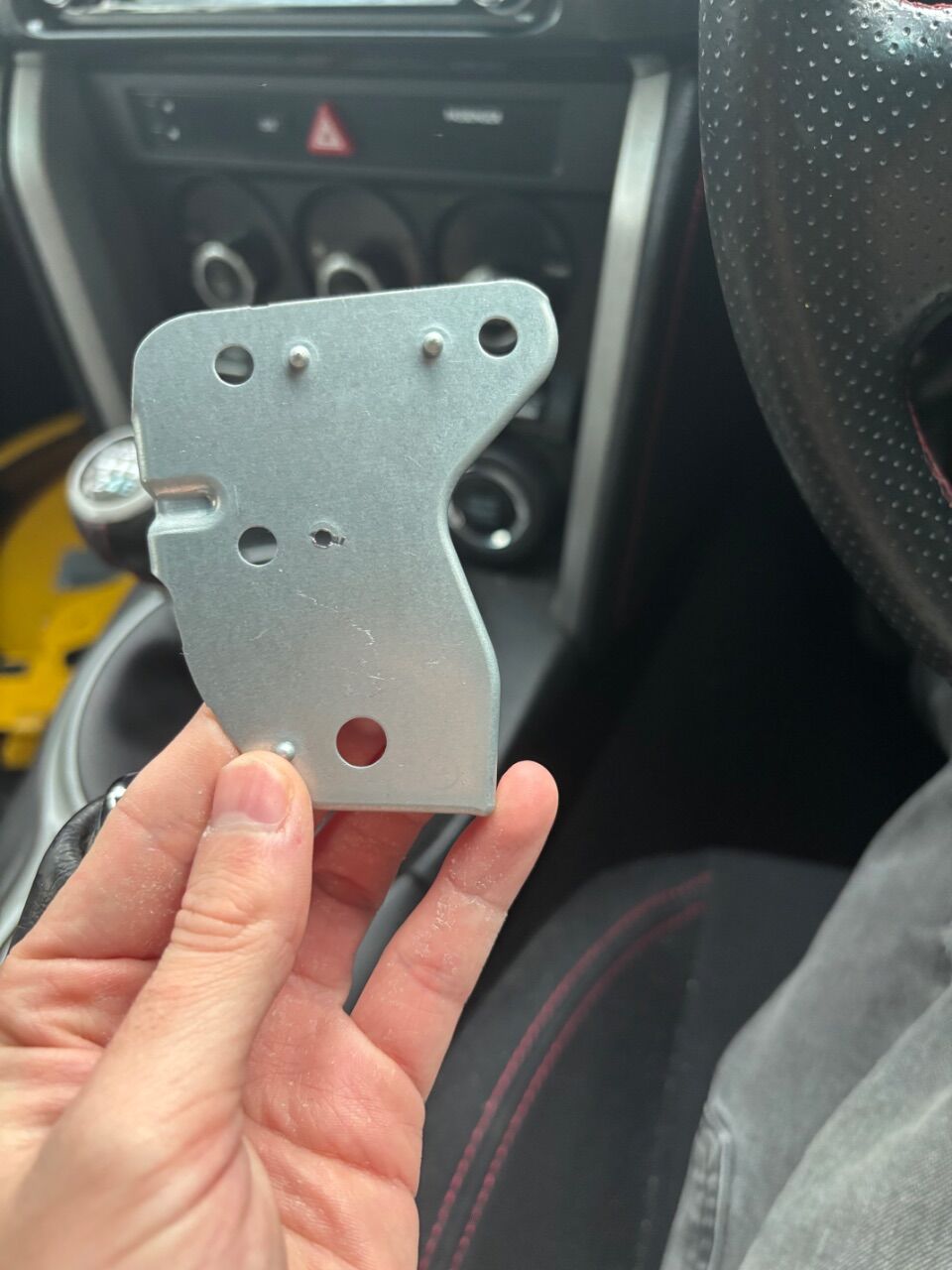

Now the Toyota. This HAS had some love as my mojo has been reignited for this car. I found a cheap XTrons unit on FB marketplace. It’s from a Toyota Vellfire but it’s mostly the same. Stock head unit looks like this:

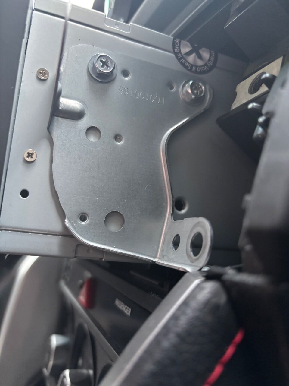

So I needed something similar and the XTrons is vaguely similar which is good enough. Anyhow I removed the old radio, but the radio in this car doesn’t have a cage. It sits quite far back and is bolted in:

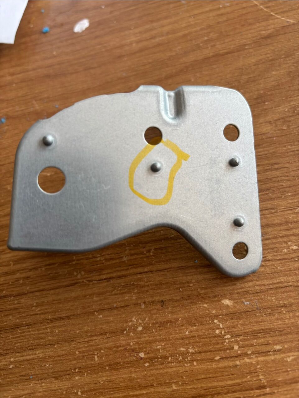

So I unbolted the brackets, however they do not fit on the XTrons as it has one mounting peg that doesn’t line up:
Mounts for aftermarket radios for the GT86 are (ready for this?) £80. For a bracket. No. Out come the tin snips:
Okay, so one of the bolts doesn’t fit in the side of the radio any more but honestly it’s sturdy, and still bolts to the car fine anyway:
And there we are, one stock looking Apple CarPlay compatible radio, with a CD player!

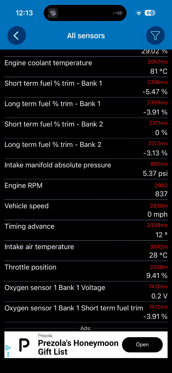

O2 sensor has been swapped on ZS. No noticeable difference but it does seem to be using slightly less fuel. However that brings me to the next point - it STILL reeks of unburned fuel around the back of the car. Everything is clean and dry, and it only smells when running. I’m wondering if there’s a breather blocked, or if the carbon canister is full. Answers on a postcard for that one please… Did a scan of the sensors to check everything was reading normal after the sensor was changed. Looks okay however I’ve been told the throttle position is a bit high for a warm engine, and to check for vac leaks or my IACV. As the latter doesn’t work properly anyway that’ll be my starting point:

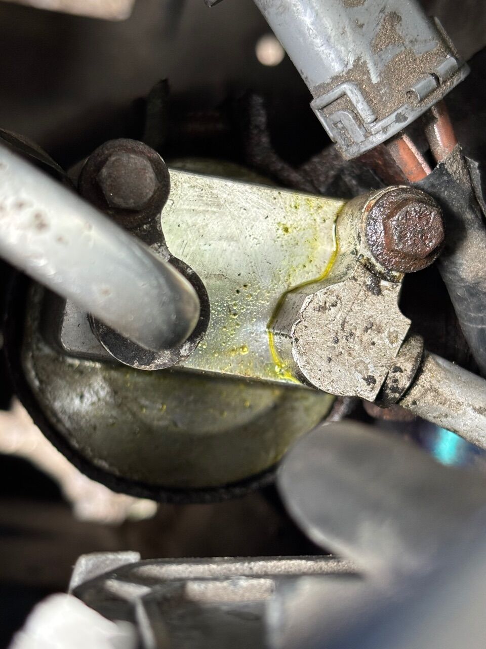

And speaking of air conditioning… The Toyota’s has failed again. Out comes the UV torch. This wasn’t very easy as the GT86 really doesn’t hold much AC gas. Had a look, and managed to find the high pressure line covered in oil and a bit of a UV reaction…
Fairly sure it’ll be that. So new high pressure line needed too, annoying as I had the low pressure one done as that had a hole in it!

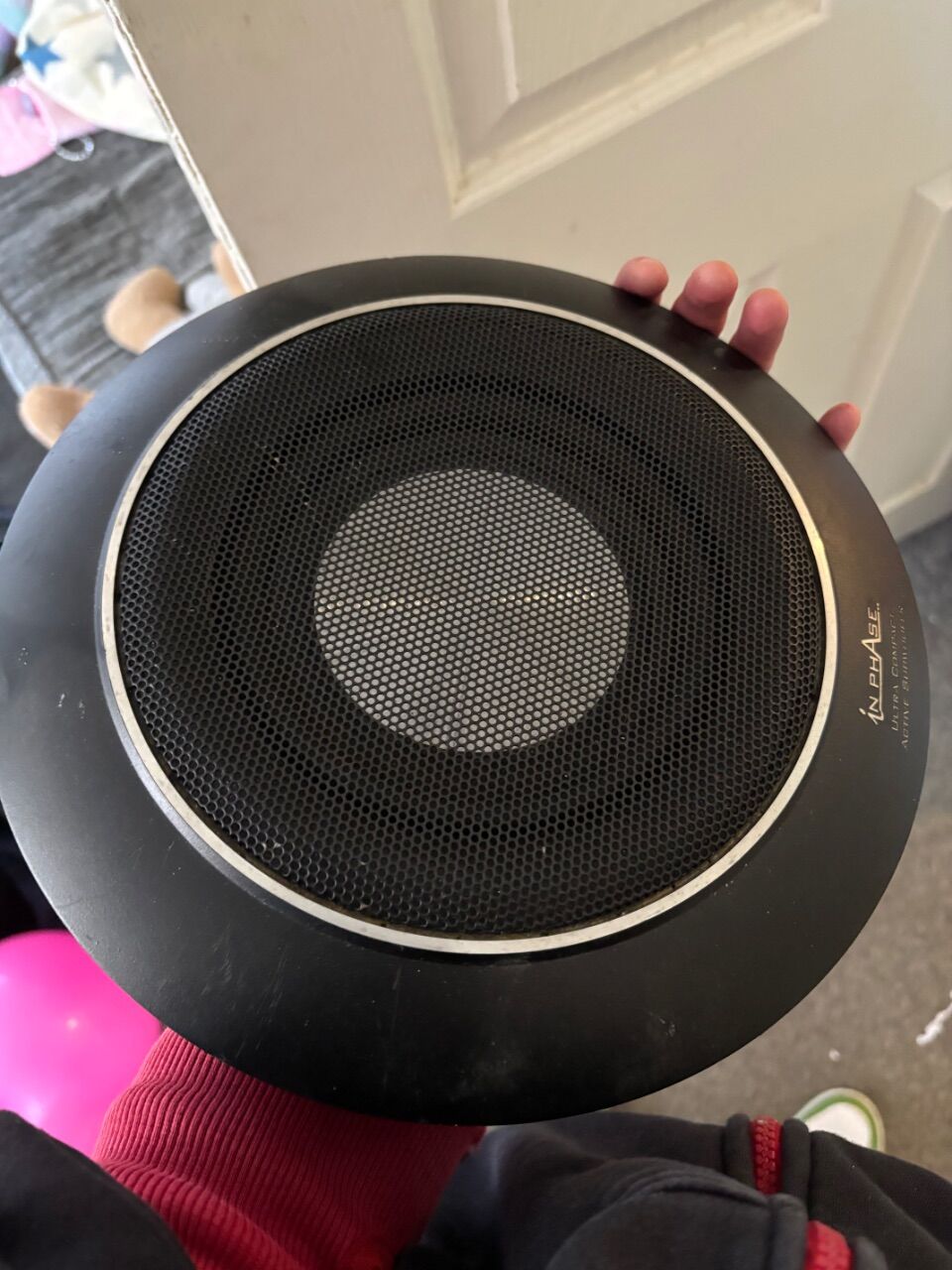

During said clearance I found an under seat subwoofer and all the associated wiring. I may sell this, I may fit into the MG if I can do it without cutting any wiring apart:

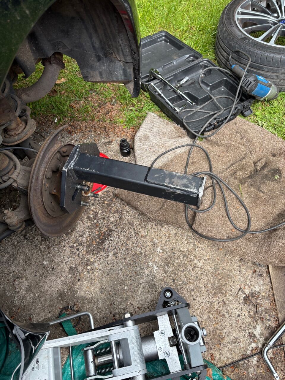

Decided to finally tackle the knackered wheel bearings on the GT86. One side was seized solid, and a miss with the hammer means I screwed up the disc backplate completely. Ended up needing a massive seized bearing tool to remove it. This is after trying an air chisel and a hammer to make it move:
So that side came out great after being left for a week.
Come to the other side and the bearing comes out nicely with the bearing tool:
Except this time we find the driveshaft is cross threaded and seized into the splines.
After 2 weeks on @Heidel_Kakao’s drive I’m sick of this car for a bit so we’re putting it back together and it can live in the car park for a bit until I can be arsed with it again. It’s just pissed me off.
