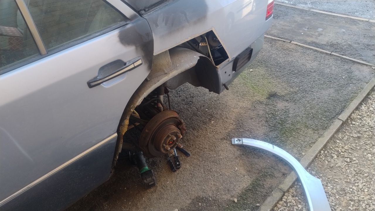

Finnaly decide to take the plunge and took off the rear wheel archs trims.
I did well on the drivers side! I do think it will need any welding (although the inner wheel arch needs a patch).
The passenger side was not nearly as good. I've already started on the c piller, never got any photos of the welds as I was in a rush. I've ordered a wheel arch so hopefully I can find the time to tackle it!

Fuck. Never seen a 124 get that bad. Stupid arch trims. You'll need to pop the Sacco panels off too ofc.

Yeah, if I take them off they won't go back on! I've seen a few as bad as this on ebay before, but they are normally deep in a hedge. The bad part of this is the inner well has some rot and Im not sure if I buy a panel for that or not!

New arch sorted! Been a busy couple of weeks so just been trying to sort it after work! I need to do some small patches on the other side. But no more trims!
