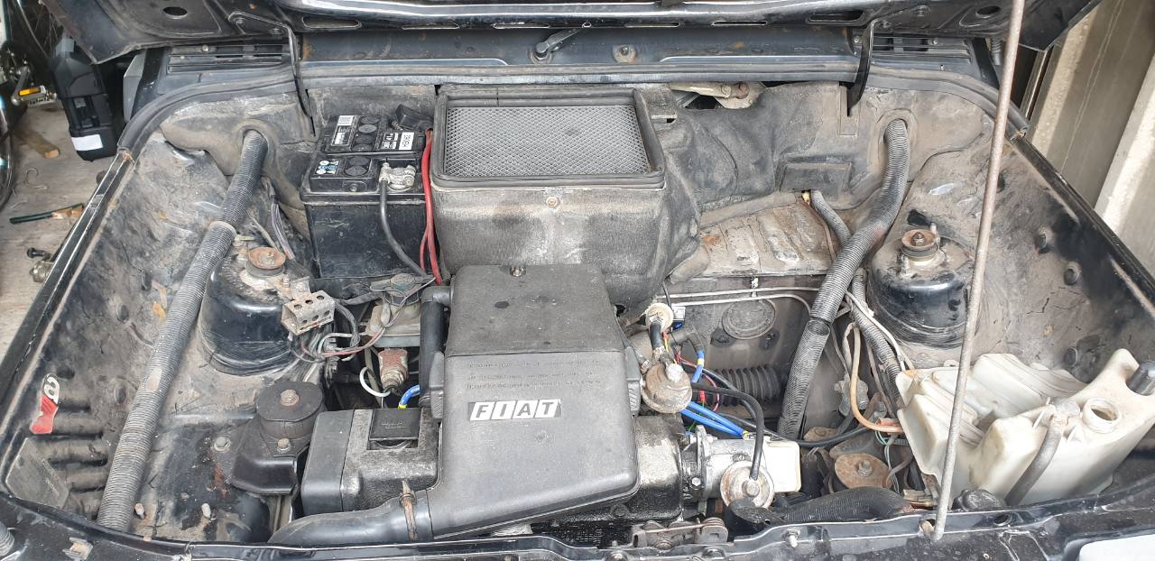

  Managed to charge up the battery and whilst the car seems to be trying to tick over its not starting...
Looks like there's no fuel in fuel pump?

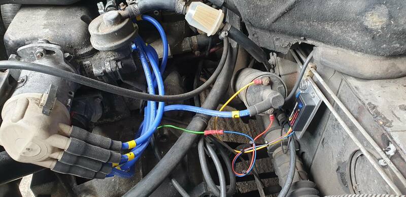

Looks like Giles was working on the electrics (new blue wires, as per photo).
Also found a carburettor and Haynes Manual.

As you say, it doesn't look like it's getting fuel - difficult to tell but I assume that clear fuel filter is empty? Someone will know if this is an in-tank pump etc. or if it's a case of turning over till the fuel pulls through?

It's a mechanical fuel pump, the circular thing just to the right of the airbox on the back of the head on your photos. Perfectly possible the membrane in there has failed so it's not pulling fuel, or sometimes the fuel lines perish inside, dropping bits of rubber in the carb jets. Even if it's fine it sometimes struggles to prime the system if it's sat for a while and the fuel has run back down the system to the tank. As I said I can have a quick look if you like, not that far up the road and it would be nice to have a go at something I know about instead of swearing at flipping fault codes which I've been doing here recently.

Is it me or is that fuel filter on back to front?
Not sure where that pipe goes but looks like it's to the bulkhead area and the other to the intake area (i.e. carb). Unlikely to be causing no fuel to draw through but won't help things.
Those pumps can take a bit to draw fuel up if it's all drained back to the tank.

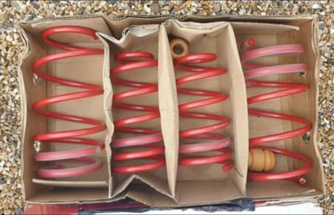

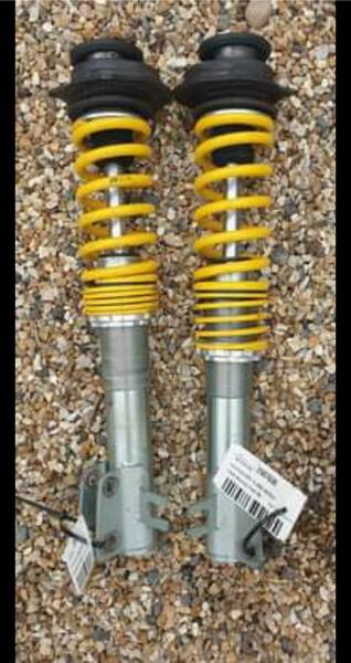

  Also, I'm debating what to do with his yellow 2004 1.2 Fiat Punto Active Sport 8V with 5 months MOT on it plus found some bits and pieces to go with it (as per photo). Really don't need this car and admittedly the funds from this would go toward fixing the BMW... Sell it? Roffle it?
Admittedly need it sold (in one form or another) for the BMW to be fixed... Got the V5 documents now for both the Fiat Panda and the Fiat Punto. Will get some photos of the Punto but any advice would be appreciated... These vehicles are giving me a slight headache.
