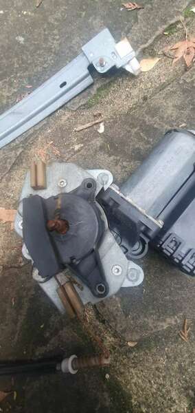

wesacosa Posted November 19, 2022 Author Posted November 19, 2022 oh, and I found out why the electric window never worked too 😂

wesacosa Posted November 19, 2022 Author Posted November 19, 2022 pump availability doesn't look great from the quick look I had. I think the seals can be replaced but probably not by a ham fisted oaf like me, and not sure if the parts are still available. Will pose the question on the XM forums Electric window never worked but it dropped into the door as I was driving yesterday so it provoked me into investigation. Seems the cable snapped due to rust (common problem) but someone decided to keep pressing the switch until the cable wrapped itself into the winding mechanisms and presumably seized the motor . Finding replacement drivers side on the later XMs is like rocking horse shit as they all break .
jamescarruthers Posted November 19, 2022 Posted November 19, 2022 20 minutes ago, wesacosa said: Electric window never worked but it dropped into the door as I was driving yesterday so it provoked me into investigation. Seems the cable snapped due to rust (common problem) but someone decided to keep pressing the switch until the cable wrapped itself into the winding mechanisms and presumably seized the motor . Finding replacement drivers side on the later XMs is like rocking horse shit as they all break . I seem to remember the Citroen dealer sold me a repair kit a few years ago for mine. However, this might not have been a snapped cable but the cable ripped out of its plastic blocks. https://www.club-xm.co.uk/forum/viewtopic.php?f=10&t=8938&p=108820&hilit=Window#p108820 wesacosa 1
wesacosa Posted November 19, 2022 Author Posted November 19, 2022 1 minute ago, jamescarruthers said: I seem to remember the Citroen dealer sold me a repair kit a few years ago for mine. However, this might not have been a snapped cable but the cable ripped out of its plastic blocks. https://www.club-xm.co.uk/forum/viewtopic.php?f=10&t=8938&p=108820&hilit=Window#p108820 I think the cables are replaceable its just if its burnt out the motor
