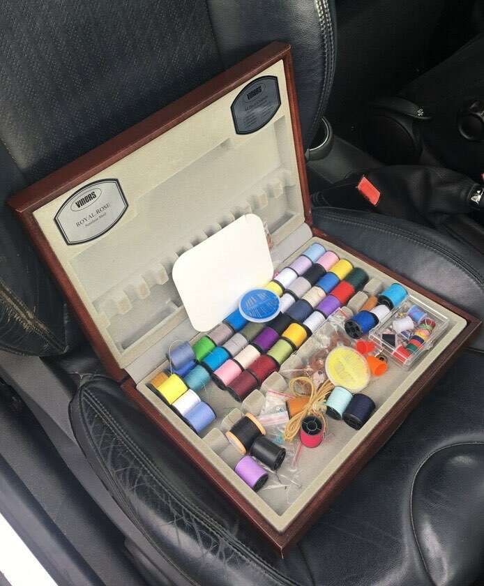

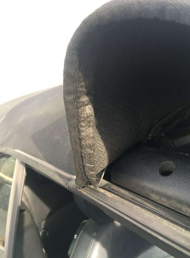

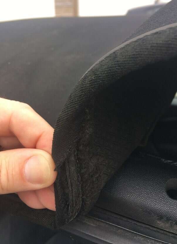

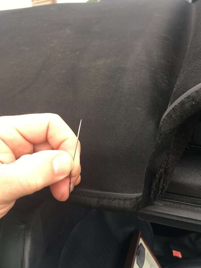

This things been dependable.  I did notice some fraying at the edge of the roof above the drivers window:
So decided to have a go at repairing it,
Pretty happy with that.
