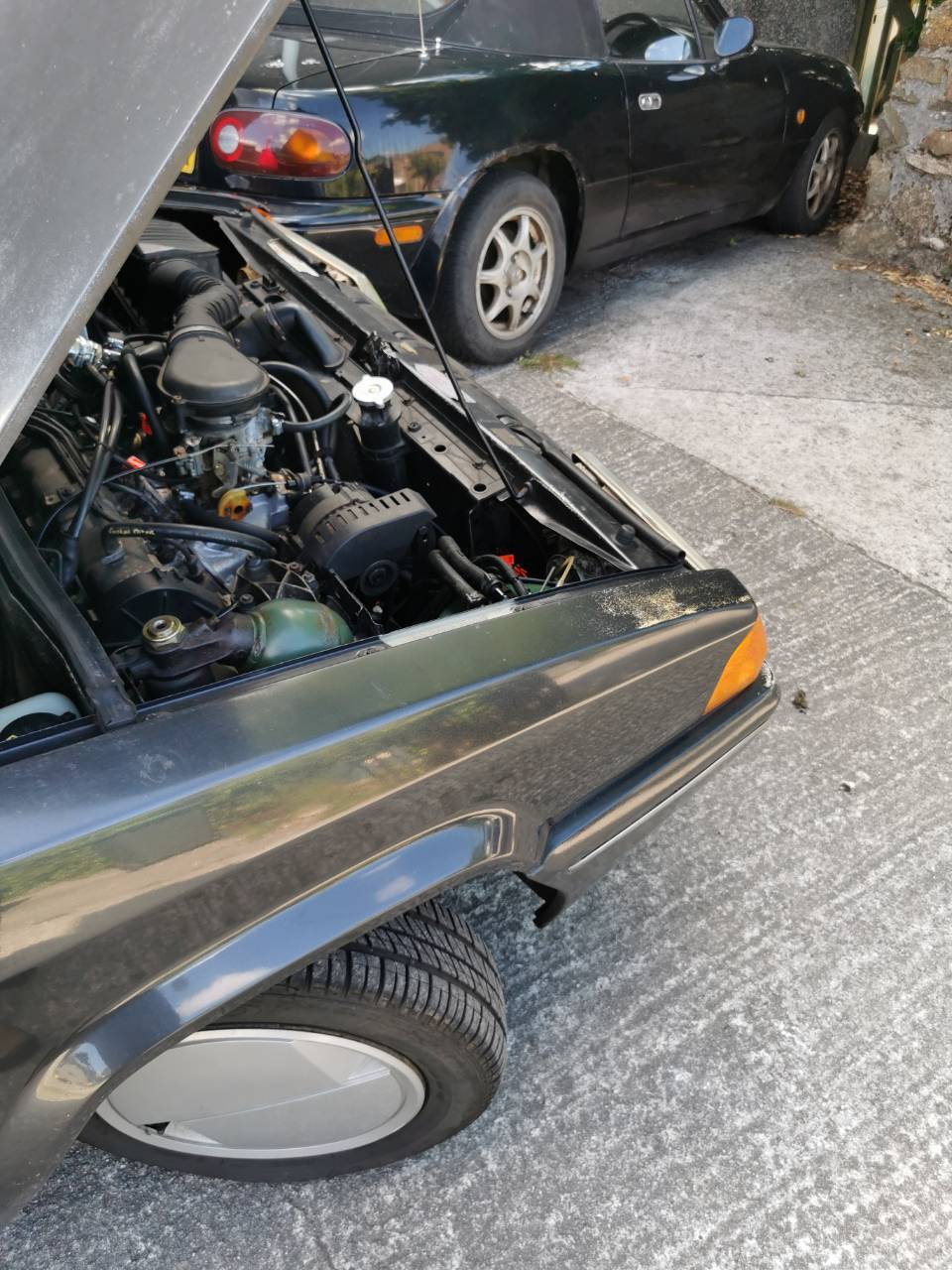

And the important one - the coolant line between the thermostat block and the hard-line behind the head was weeping. Phill was kind enough to gift a scrap heating hose manifold set that I could cannibalise a solution from.
Once I found an appropriate section I could use, I removed the old hose, which was clearly not long for this world:
And fitted the new section.
The engine was fired up and ran to temperature, and the system bled. There were some moisture movement visible on the outer face of the top hose, so I've let the engine cool back down and re-secured the jubilee clip a little squarer.
Hopefully that should be the end of the cooling system SNAFUs!

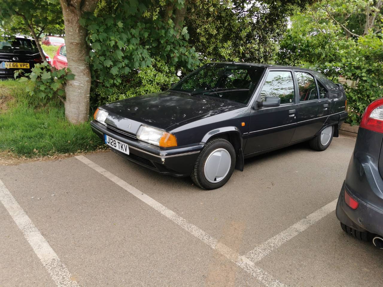

Today, we went out as a family to a local cars and coffee meet in an adjacent town. Unfortunately, the impending poor weather and half the carpark being lost to scaffolding must have put a lot of people off as the turnout was really not at their usual level.
The BX was a nice talking point to a few people and broke up the wave of Porsches that were there.

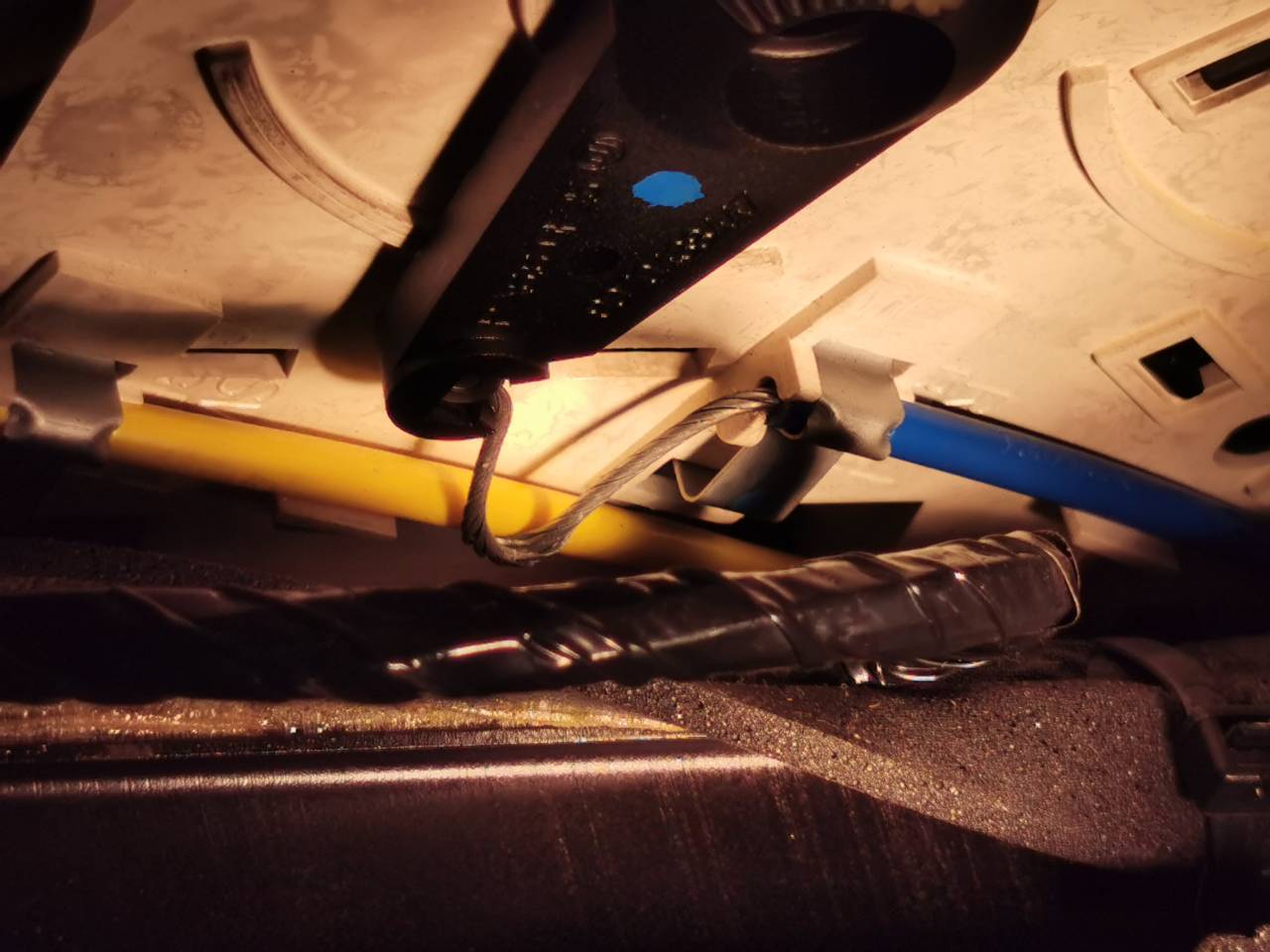

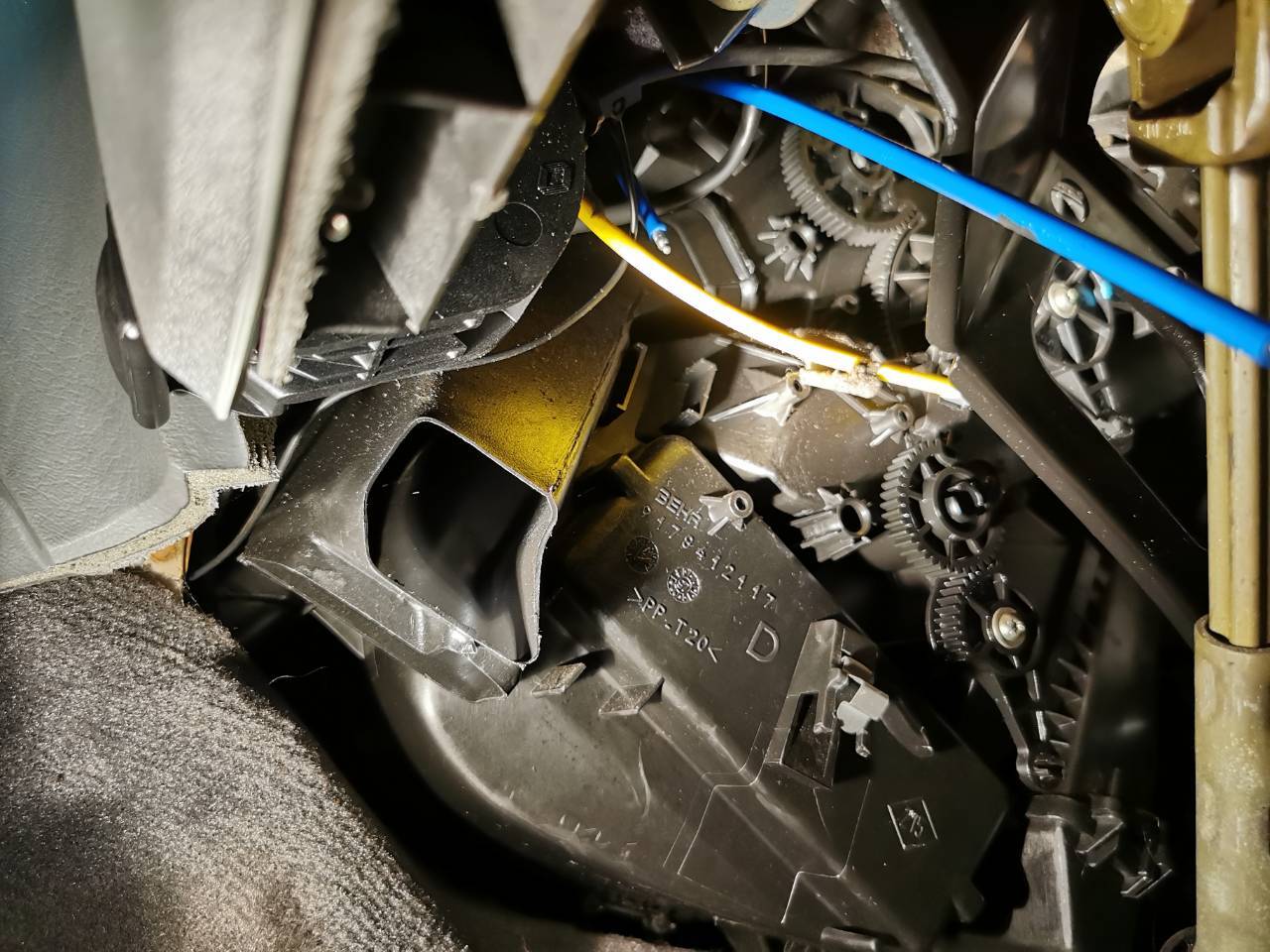

This morning, having been up for hours with a bad back, I decided to get into the garage and crack on with the Laguna.
To get access to the heater control panel, the interest console and stereo cubby had to be removed.
A clearer look of the cable at fault.
I bought the new cables (for a RHD car) from a Dutch seller, who delivered to @chatsharris house, where we collected it during the family holiday back in April.
It was a bit of a faff to get the new cable to match the old ones routing but it got there in the end - the cable was given a dousing in silicone lubricant to hopefully see this cable for the rest of the cars days!
All fitted! It was checked and found to be fully working once again, to the relief of MrsH who has had the heaters stuck on max heat since we found the fault 😅
When removed, the fault with the cable was even more obvious 😅

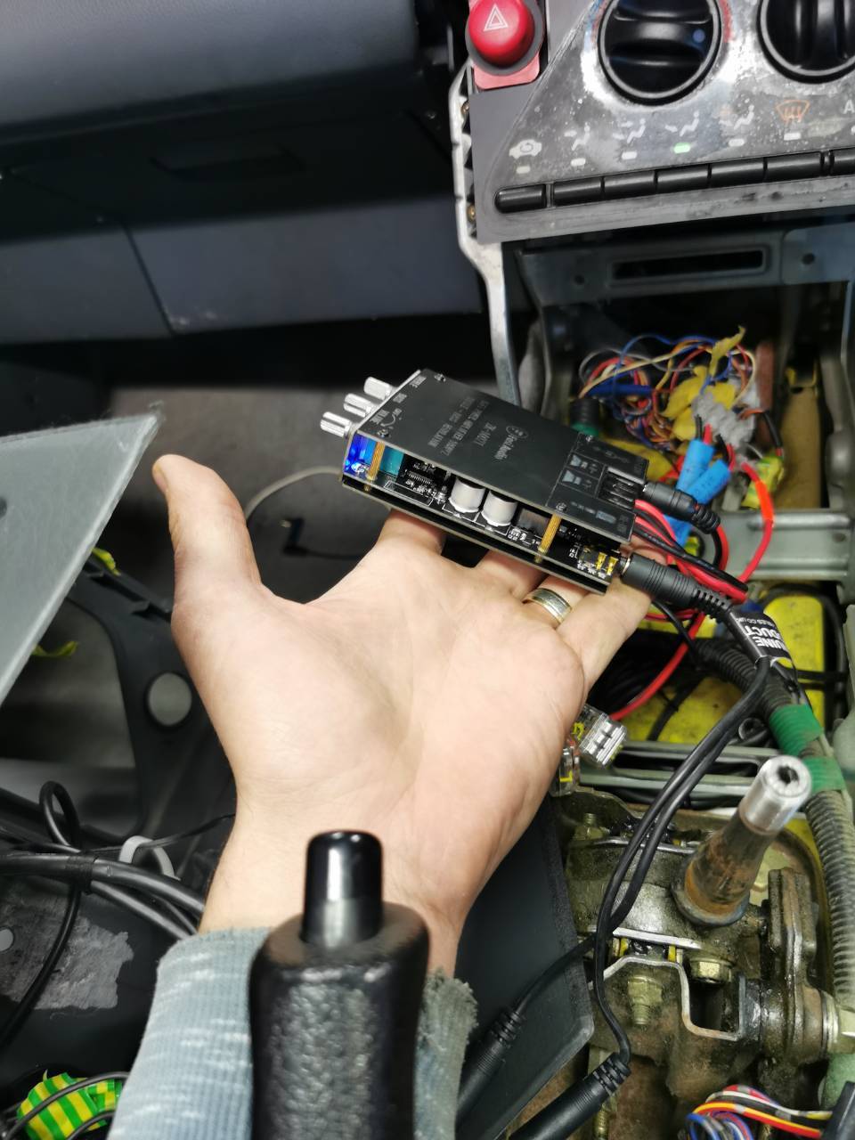

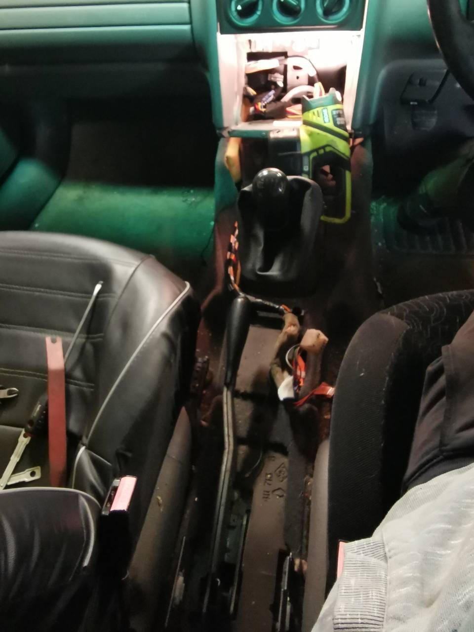

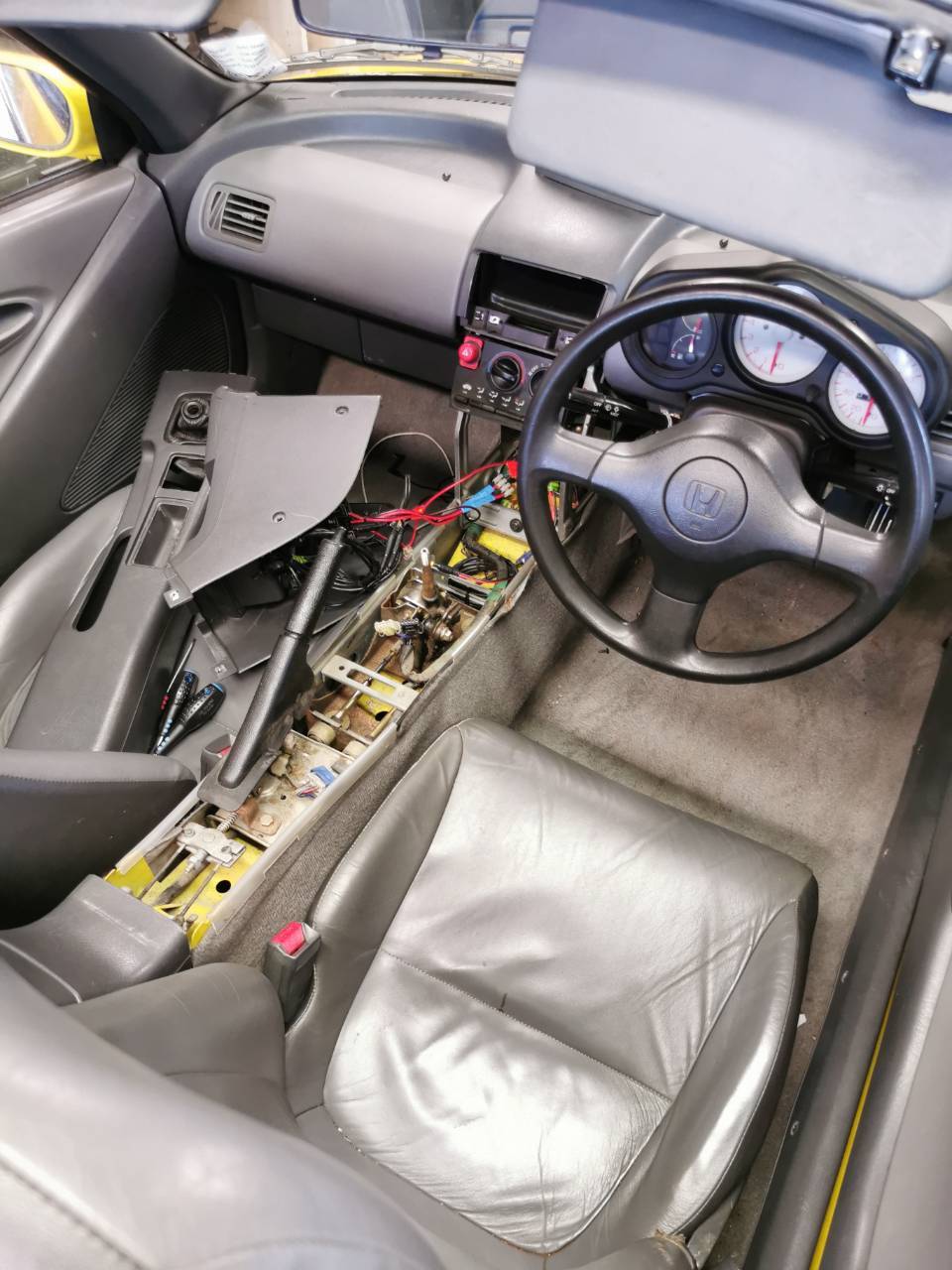

Since I brought the Beat out of the winter lay-up, the stereo wasn't working, so now I had the time, I started to investigate, which means getting access to the back of the stereo.
Initial voltage checks showed 24v at the power socket (I ran a 24v converter a year or so ago to try and resolve the stereo cutting out problem at high volume - this turned out to be wet speaker connections) and the earth point was good.
Luckily, I had a spare stereo board in the cupboard and plugging this in proved the power supply was working, so the board itself was at fault.
Whilst I was there, I removed the 24v converter and associated wiring. As the  power to the converter was supplied by the cigarette lighter power lead, I was able to have a cigarette lighter socket again!
In the meantime, I transposed the board components over. The top cover etc had to be trimmed during the initial install to allow it to fit flush, so it made sense to carry them over instead of filing new ones to fit.
I chopped and resoldered the ends of the speaker cables and finished assembling what I could on the bench.
And brought it into the car for the last bits of installation. The blue light is the sign that everything was working correctly this time!
Nothing left to do but reassemble everything and give it another check - all is well!

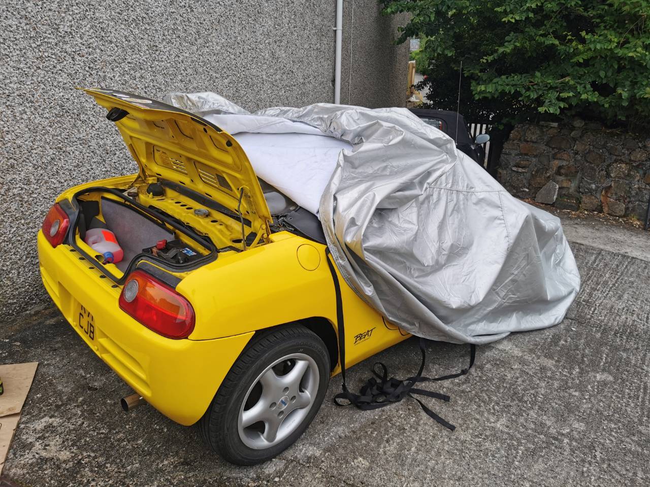

The Best is going to go back to living in the garage again, the roof is still letting in water, so being dry is the best thing for it.

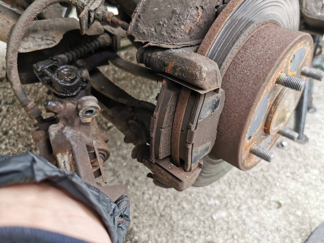

The ABS sensor on the NSR end was found to be out of limits last month, and today was the first opportunity to change it.
Herman didn't let me down, and the bolt and sensor came out with no fuss at all!
New one slotted in nicely and was bolted down.

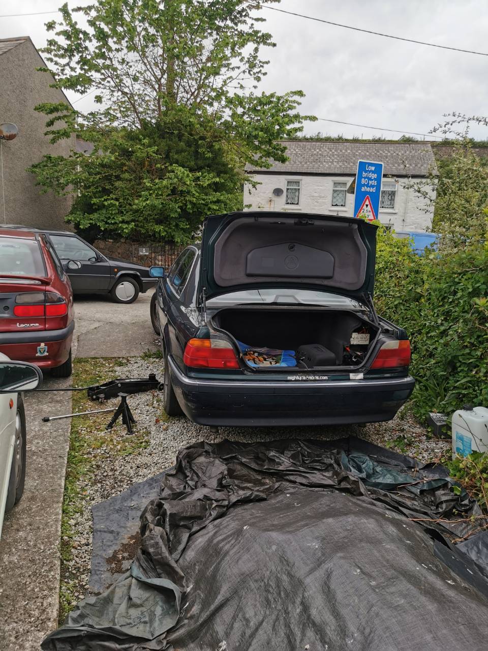

Somewhat shockingly, the fuel tank is starting to get a bit grotty, with rust evident under flaking paint. This was cleaned up, and a coating of lanoguard applied.
At the next available maintenance opportunity, it'll be going into the garage for a rusting and dusting session.

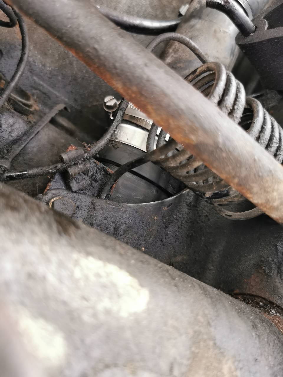

A very slow drip was visible when I came back from paying, so I came home, got it back on the ramps:
And assumed the position.
The leak was found at the main filler pipe where it connects to the fuel tank, it's a bit of a daft design - being oval, a jubilee clip can struggle to seal all the way round.
The solution?
Two jubilee clips.
This has stopped the leak on its tracks but I'll be keeping a beady eye on it in future fillups. Gave some missed areas another spray with Lanoguard to really make sure it's protected.

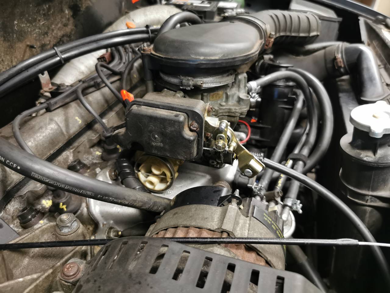

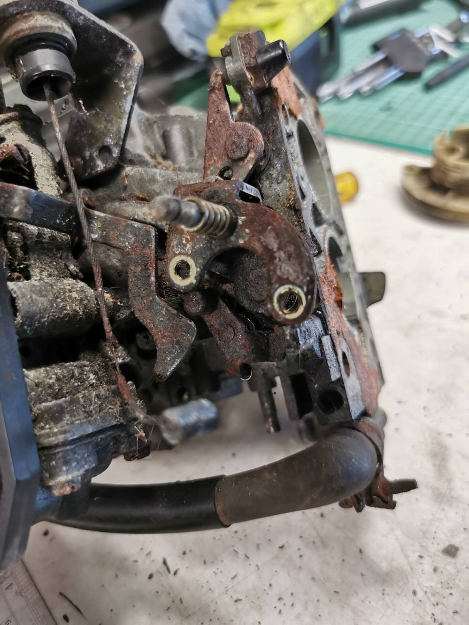

I've been rattling more miles onto the BX in the past week or so and all is well.
The only thing I've had to do is adjust the throttle cable - the position it was previously in meant the pedal was sat way, way too high, so I had the boy in the car pressing the throttle when required and now it's much lower, but still gives the full range of movement for the throttle.

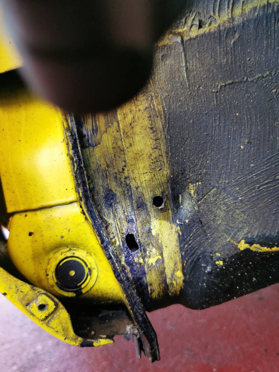

When I was rust proofing the wheel arches before the MOT, I noticed a scabby bit at the front drivers side inner arch, which turned into a hole when further prodded with a screwdriver. As it was behind the plastic wheel arch trim, I elected to get the MOT sorted first, and resolve the hole when I had the time.
The hole on the right is for the plastic trim clip.
Chopped the old section out - the metalwork behind it was given a drowning in lanoguard as it wasn't in the finest of health and well beyond my skillset to sort.
With the removed section on the bench
I got the new patch made up and welded in. I didn't bother redrilling the hole for the arch trim clip as that's just asking for water ingress.
This was then primed, seam sealed, primed again, painted and lanoguarded. IR heater helping shorten the time between coats.

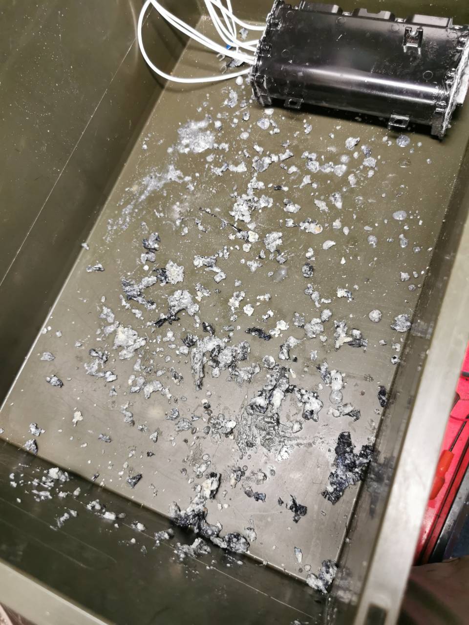

The old unit was stripped of as many useable spares as possible, and curiosity got the better of me, so I thought I'd see how bad the heater unit was for scale.
Turns out, it was pretty bad.
And that's just what I could be arsed to get out! Naturally, that went into the bin.
Once I stripped off anything of use, the remaining carcass was chucked in the bin.

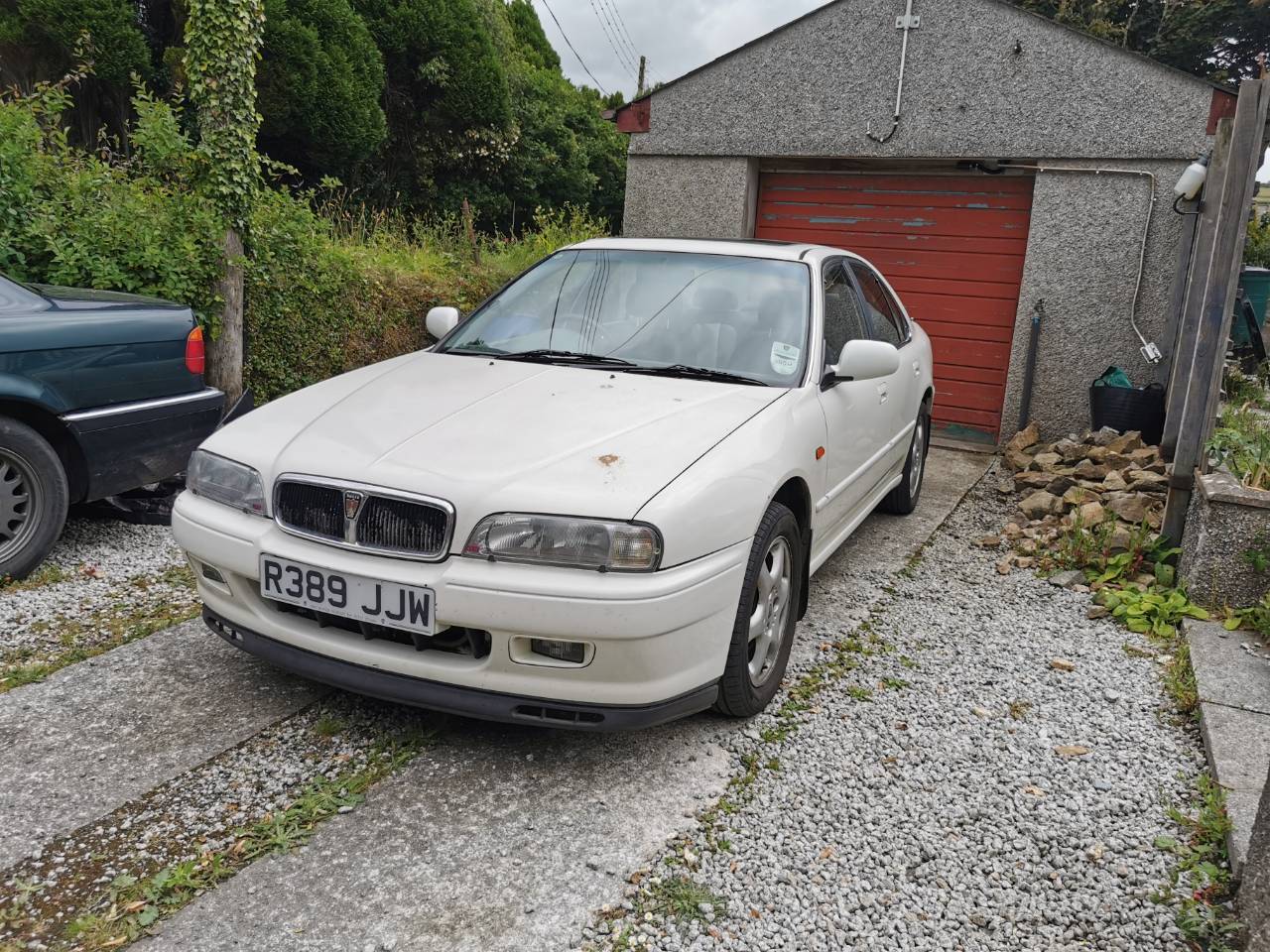

The Rover hasn't done a lot of mileage since the BX returned to the road, but a friend was in dire need of a set of wheels whilst his Jag XE needed some remedial MOT work. Checked the levels and pressures and cleaned the windscreen of bird shit before letting him take it away for a week or so.

Keen to enjoy the rare burst of uninterrupted sunshine, I fired up the Beat and dragged it out for a wash in preparation for a local car meet 12 miles away.
There was a bit of Lanoguard overspray on the paintwork, but it all cleaned up nicely.
And I added some AS recognition on the rear.
The meet was all right, highlight was seeing a Nissan 300ZX turbo from the late 80s.

Early finish at work so a chance to look over the car, to see how 530 miles has fared.
That bloody coolant bleed point was found to be weeping AGAIN. This time, I've slipped a length of fuel hose over and jubilee clamped it too - hopefully this will have done the job. Certainly seems to have stopped so far.
An oil change on this car is a breeze - no jacks or axle stands required, just set it on high, and crack on!
New filter, sump plug and copper washer went with the new filter, the areas were cleaned up, oil filled and level re-established. Went for 10W40 Semi synthetic this time. All went well with the change.
I took a small sample of the oil from the drain point whilst I could and this was what came out.
Messenger_creation_ac1c2ce9-1a6b-4c85-8cf4-df477cb5923d.png.aabfefef4b671f1fc2cfe4776b15eae8.png
That's.... unusually dark. It had a stronger than usual fuel smell too, so I think the carb is running rich.
This would also explain the 33MPG tank of fuel too.
So, now I'm on the hunt for a solution, but before I knocked it on the head for the day, I changed the rear wiper blade because the old one was worse than useless.
Oh yeah, speaking of awkward spares, I tried sourcing a K&N air filter for the Beat, but got an email back saying they're no longer made so I have  been given a refund. Balls.
Cheers 😎

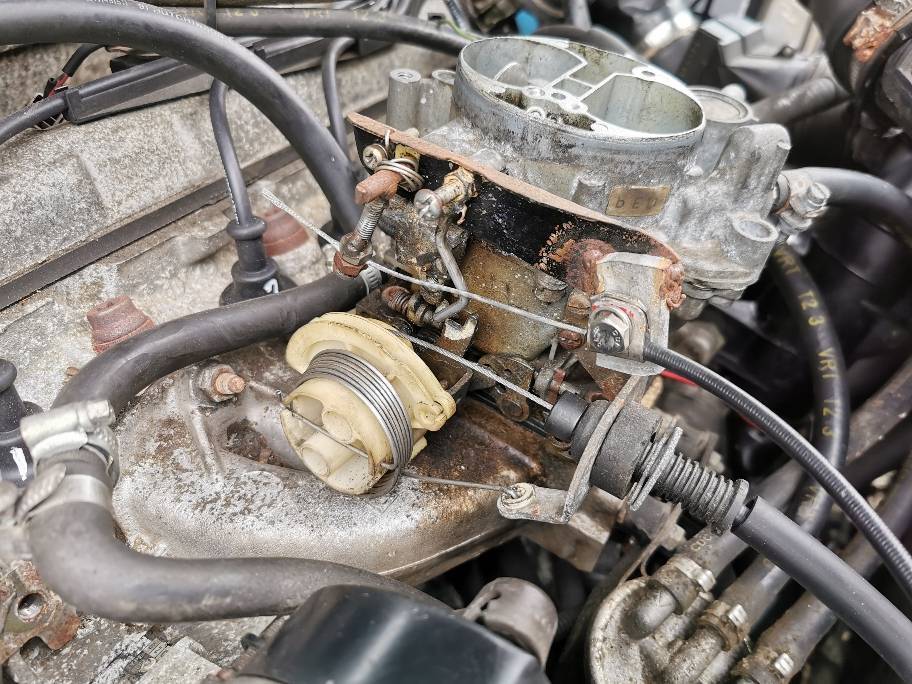

The carb was definitely overfuelling - the BX was taken out of service whilst this was investigated.
The carb itself was replaced back in 2020 with a second hand unit, because the original unit had a botched manual choke conversion - when operated, this would only close the flap, and had zero interaction with the throttle (Picture from when it was fitted to the car)
Thankfully, I kept this in my spares pile, as I figured it could yield some useful spares one day.
This is the carb that was fitted in it's place.
As it was overfuelling, I wanted to check the size of the jets and the emulsifier tubes - if they were more restrictive then I could fit these instead to try and balance the fuelling.
The bits were taken off both carbs and compared:
The figures of each were noted - it looked like the old carb jets and emulsifiers would drop the fuelling a bit.
To add to the stress, removing the throttle cable highlighted a weakness in the throttle quadrant, which snapped a small section off. Super glue to the rescue for that one!

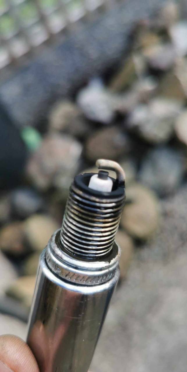

I went for a test drive and checked the plugs - they were now too lean according to expert opinions!
Some more investigating occured and it eventually transpired that this carb, despite the sellers assertions, wasn't the correct one for the engine. The outlet bores are only 30mm each instead of the correct 32/34mm combination.
Eventually, I worked out it was for a 1.4 BX which would also explain the overfuelling - it wasn't getting enough air!

Unfortunately, parking it on the driveway highlighted one of the rear calipers was binding slightly, so the Rover was jacked up and the rear brakes cleaned and greased up.
This has highlighted a crusty brake pipe that will need attention very soon - I'll whip it off once I get Herman back on the road and get a new one made up. Lanoguarded to hopefully stem the deterioration.

I now had three carbs, the original, the small one, and the seized one.
The throttle quadrant was removed to show just how corroded the linkages were.
I had a manual choke conversion kit from several years ago, but as I didn't have the auto choke system on the original carb, I couldn't use it.
I decided to attempt to convert the auto choke to a manual system.
The inside of this was just as funky.
Thankfully, it cleaned up and the conversion was carried out (forgot to get photos).
With that done, onto the next phase - debodge the original carb.
Turns out the choke flap was also a bodge - someone had made it out of aluminium 😅
The manual choke conversion was removed from the seized carb.
And transposed onto the original carburettor.
The small carb was removed and the jets/emulsifiers taken out and returned to the original carb.
The repaired carb was fitted.
The choke cable was too short to fit, so I employed MrsH for the cockpit whilst I held the choke lever open.
Good news, it starts and the choke allowed a fast idle at 1500. It warmed up and held an idle. The base adjustments have been carried out and I'll give it a proper run out when I get a new choke cable.
For now, everything was reassembled as far as possible:
And a set of fresh plugs popped in. I'll be watching  them closely.

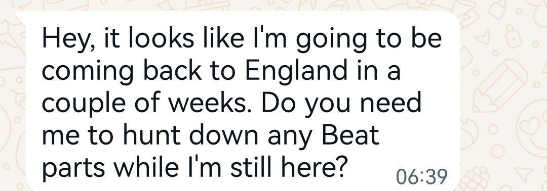

One of my best mates has lived in Japan for just over a year, and his visa has come to an end. I was looking forward to having him back when I got this message:
Screenshot_20240623_074240_com.whatsapp_edit_395731812963573.jpg.c9dc458c3244dbb79b82d13e13e0ea68.jpg
Why yes, yes I did. I sent him £LOTS and a list of part numbers and left him to it.
Got this in the group chat today.
Whoops 🤭
That *might* be a pain to bring home!
Don't worry, he's getting rewarded handsomely, as he'll be having a lend of the Mazda when he gets back until he gets himself sorted 😁

I was very close to booking the BMW in for an MOT when I remembered the washer jets weren't working, instead pissing loads of fluid through the bonnet vent.
Didn't take long to identify the culprit when the vents were removed.
The tubing had cracked in several places - presumably weakened by UV light from the sun. It would easily snap in my hand so it was clearly in need of replacement.
Popped to Halfords and bought a length of 4.7mm washer tube. This did the trick and the jets were working once again.

Onto the Beat then. The oil pressure light hasn't been working for a few days, I handily had a new oil pressure switch from when it stopped working for a few days 18 months ago.
Unfortunately, I couldn't fit under it without raising the car which ain't happening where it is at the moment. It sprung back into life this morning and it's due a service and another work package soon so I'll change it then.
The BX was next on the list, with the new carb fitted, it was time for a test drive! Because I'm still waiting on a new choke cable, I had to operate the lever by hand until the car would hold an idle, then set off.
It drove rather nicely, pulling over occasionally to twiddle screws with a long screwdriver. The result is a car that now pulls cleanly with plenty of power, although the idle is ever so slightly higher than expected. Acceptable enough though, and the plugs were checked on completion of the 10 miles.
To be honest, it's a bit too early to tell, but once the choke cable is here I'll run it again - it's meant to be covering 1200 miles over the course of 2 weekends, Shitefest being one of them, so I need to iron out the kinks where I can!

Small job today.
New choke cable was plumbed in, but it's a lot stiffer to operate than the old one, which kept resulting in the choke panel popping out.
Couple of drill holes:
More holes marked up for drilling.
And secured, thankfully I had some black screws 🤣. Worked a treat and doesn't move at all now.
The end of the cable was tinned with solder to stop it from fraying.
A quick test drive has shown that it's all driving lovely now. The carb only needs a little bit of choke for a couple of minutes before it can go off. The idle is still a little high but not too far out of limits.
