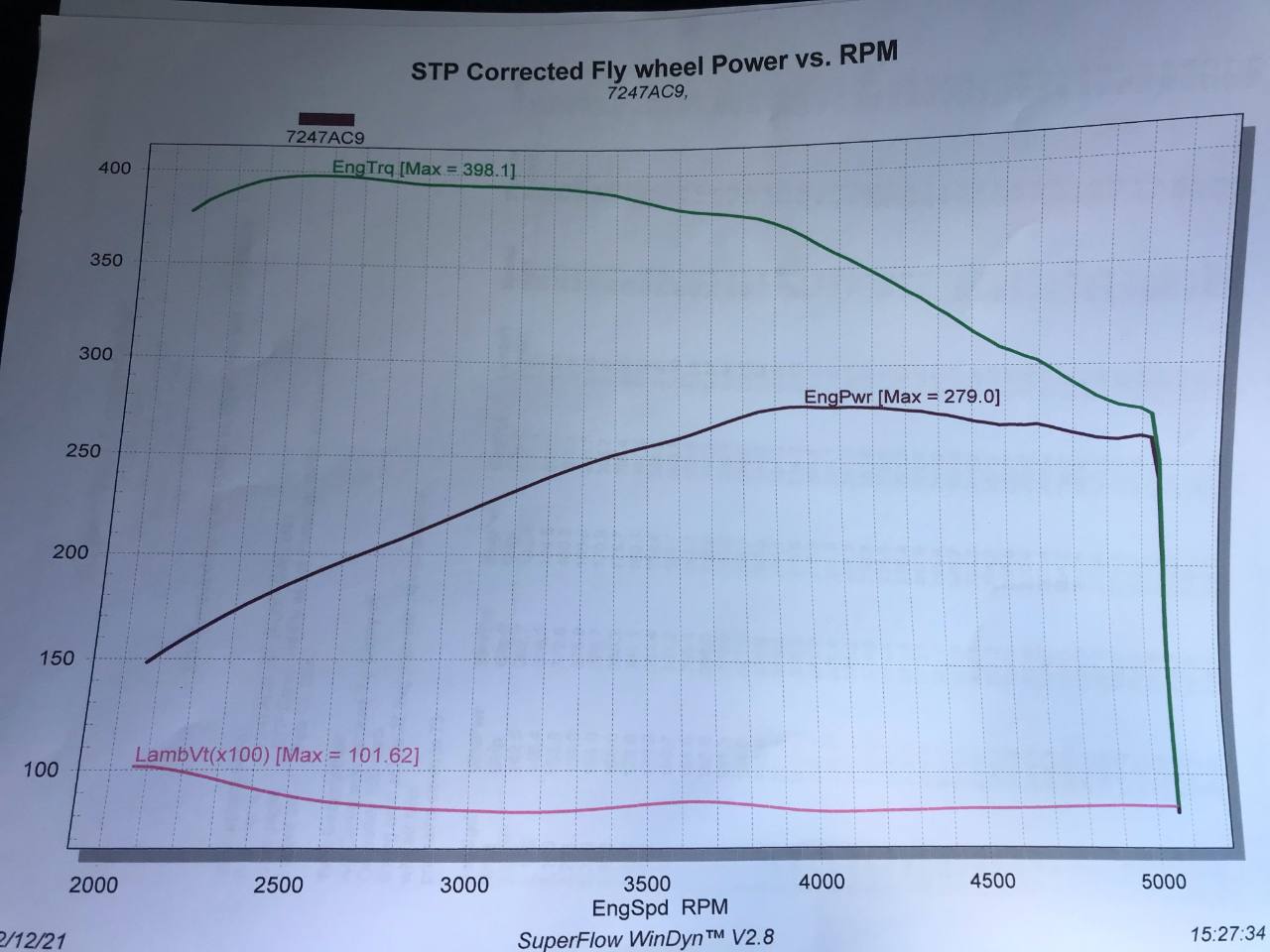

Anyway, the results are in. I am still awaiting confirmation of the weight but believed to be 1075kg. Very happy with the torque, a little disappointed with the power output.

I R disapoint. Still, as you say it should be docile and civilised to drive with curves like that; there's some constriction in there as it gives up at 3700 and starts twiddling its thumbs.
Just spoken to my friend who took it down. First he reminded me that it was wheel HP so add 20-30% ??? for transmission losses. The printout shows losses as 19HP but I am unsure of what these things mean. He said that to increase HP we would reduce Torque, especially at low revs. He said it drives superbly and would not change a thing! Coming home at 85mph it was sat at 1800 rpm and just lolloped along!

The printout:
You might already know this but:
BHP = Torque * RPM / 5252
A lot of low down torque that eases off with revs will give a max bhp that appears disappointing. Modern engines with turbos and fuel injection can give a flat torque curve, so give good bhp and still low down performance.
Low down torque is the head snapping umpfh and responsive feel that people likes.

Looking at the first graph the house looks to have been already adjusted* to  flywheel figures?
Must admit to also having been disappointed with the figures produced, I would have been expecting somewhere around 400 flywheel figure?
