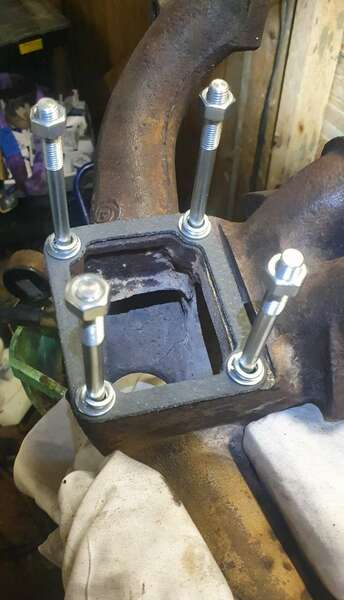

My used manifold arrived, and the studs which join it to the inlet manifold were (accurately) described as showing signs of wear, but the seller included a new set of studs. I took that to mean they didn't want to risk shearing one off before selling it! Two came out reasonably easily, but they had necked down quite considerably to I was very wary of snapping them off, especially as the last two appeared at one with the manifold.
I could have just left them, but with a packet of new studs in my hand the temptation was too strong. With plenty of heat and gentle persuasion they came out intact...phew!
New studs were screwed in with the aid of copper grease, but I'm under no illusion that future removal will still be equally stubborn!
The downpipe studs had already been replaced with stainless, although I've added brass nuts rather than stainless. I've had experience of stainless on stainless fasteners galling before, albeit at higher temperatures than I'd expect on an exhaust, so I'm playing it safe.
I only hope that the manifold to head fixings all come out, as I don't really want to be taking the head off (even though it looks to be about as simple as they come).

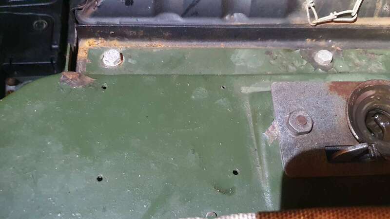

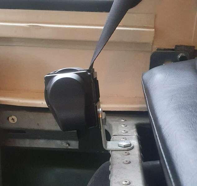

One more minor job I've sorted is the seatbelt mountings. I'd assumed these were standard fixings, athough I was concerned they wouldn't be up to much in a crash.
But @Talbotpointed out the proper mounts were fitted by the B pillar, which is a stronger area, as well as putting the belt in the correct orientation relative to the upper mount. The part number I required was MRC4692, which I found for sale at a mere £220 a pair! I made my own up with a pair of universal plates, at around £3 a side. You can see that the reel is now in a more natural position compared to the other side.

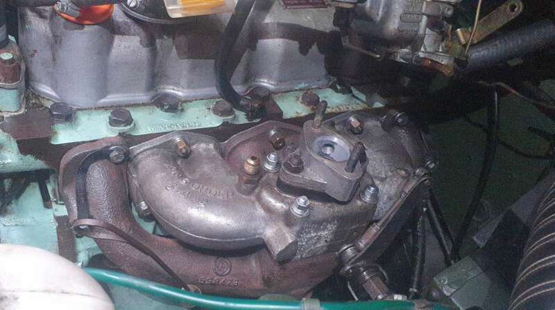

As I keep mentioning, I was worried I'd snap another stud, especially this one:
But in the end it came undone in a bit of an anticlimactic way! I just gave it a testing tap with a spanner, and it cracked loose straight away. So I figured I may as well start the job. A few minutes later it was all off, and new studs in.
Then manifold back on, which took a bit of jiggling.

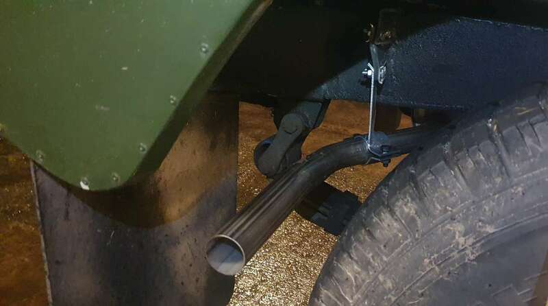

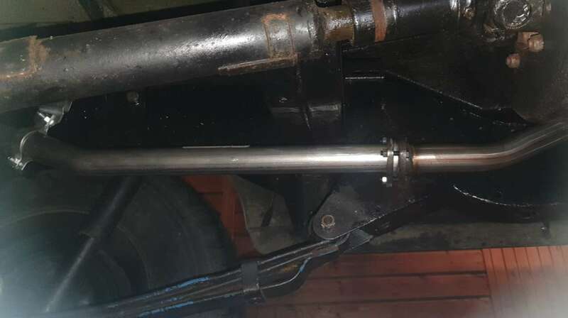

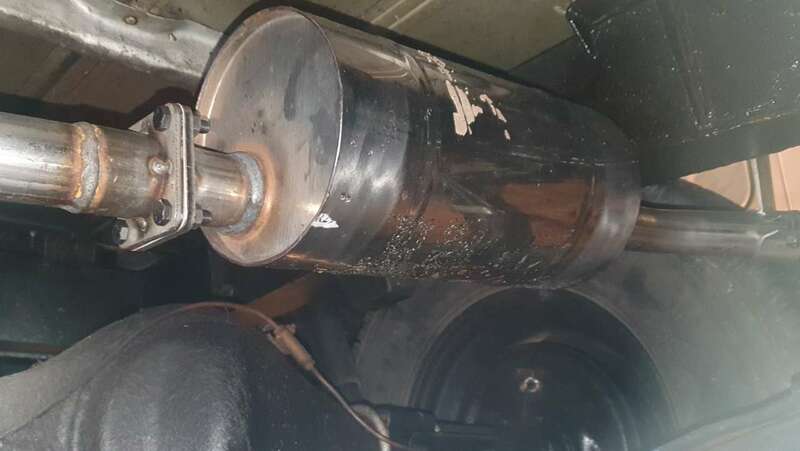

I could then move on to the exhaust. Quality seems OK, not top notch but better than the old one. That didn't even fit particularly well, as the tailpipe was very close to the rear tyre.
And the PO had to make up an additional bracket to fit it to the chassis mounts!
But it still knocked on the chassis on startup and switching off, as I realised when taking the gearbox out.
The new one went on pretty easily, with more clearance all round...
...and attached to the new manifold.

Oh. Aside from the engine sounding rather clattery on video, the new exhaust does sound different, in real life too. Gone is that A Series-esque fruity rasp, to be replaced by a deeper tone. I'm not immediately taken with it, but will wait to see what it's like whilst driving, if I can hear it at all over the wind noise. There does seem to be a bit of resonance at idle, which disappears when you raise the revs.
Good call. Did all the same to my Series 3 a year or so ago, having had the previous Shitpart exhaust rot faster than a tuna sarnie.
I like the sharper sound the stainless exhaust gives it, although sadly it's no faster :sad:
I did notice that the carb gasket was around 3mm smaller all the way around the opening, so that can't have helped! Should be doing 50 or so miles in it tomorrow, so will be interesting to see.
No difference in performance, or noise behind the wheel TBH. It was put to use in the sunshine this morning shifting a small trailer.

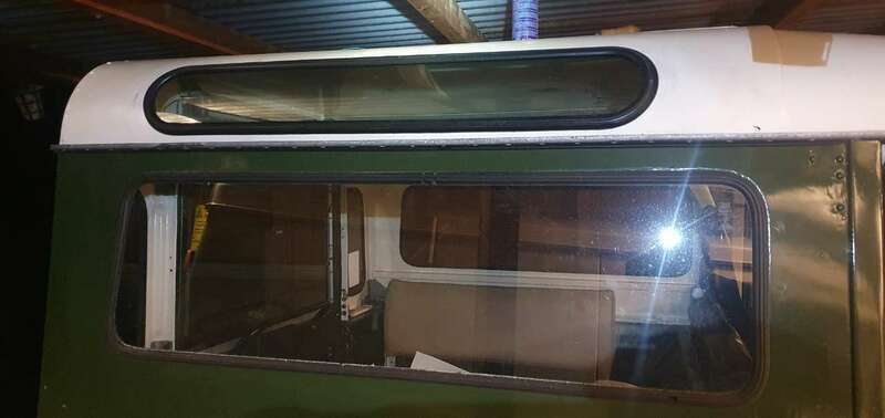

I've had a birthday recently, and got some alpine windows for this as a present :-) Something I'd been thinking about but never bitten the bullet.
Trouble is, I've now got to cut two holes in the roof! And I'm not sure exactly where. To me, the position they are in on an 88" Series doesn't look quite right:
On a 90" Defender, they look better to my eyes:
So I could just go for where looks right. But then if I ever decide to get a headlining, it will probably mean they're in the wrong place! I probably won't (as they're a lot of money), but I just don't want to regret it later...
Is it just me? Do the 90s look better positioned?

I defo think the 90's positioning looks much better!
on the 88 the way it sits behind main rear windows bug the crap out of me, looks like someones set it too far back, and that it should be lined up with the main window when its not!
I'd say there's a reason why it's like that on the 88. Maybe to do with the sloping roofline? Looking at yours though, the roof is more like the profile of the 90?
As you haven't changed the thread title I logged on thinking, oh no, his new exhaust has failed!
Great birthday present, another vote for the 90's position for the alpine windows here.

Or where it fits between strengthening spars maybe ?
Give that man a doughnut! Hopefully I'd have had the foresight to check before actually cutting, but I wouldn't have put it past me to make an expensive mistake :oops:
I'd made made up my mind I wasn't keen on the standard 88" position - it might be the 'correct' way to do it but I'm not doing this for resale value, just how I want it. However it looks like the 90" position will cut into a support strut, which stops me centring it perfectly on the lower window. But I think I can still locate it so it looks better...
Fit the alpine windows where you want them and then move the ribs. Like this guy.

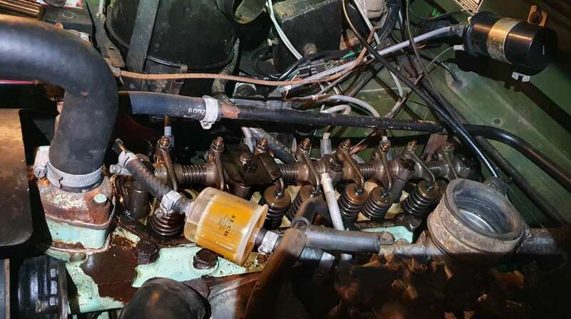

There's a job I've been meaning to do for a while, but had never got round to it, which was this:
Rocker cover is dead easy to remove, just 3 screws, and I was pleased that the top end of the engine seemed pretty clean.
They were mostly slightly wide, with a couple noticeably wider which may explain the faint valve clatter I could hear. Easy to sort, and the rocker cover was replaced with a new gasket. Self-adhesive on one side which made it easier to install.
The engine seems a touch quieter, although I now notice the exhaust to manifold joint is chuffing slightly. so another job on the list! Then on to a more minor job. I'd noticed a few holes in the slam panel...

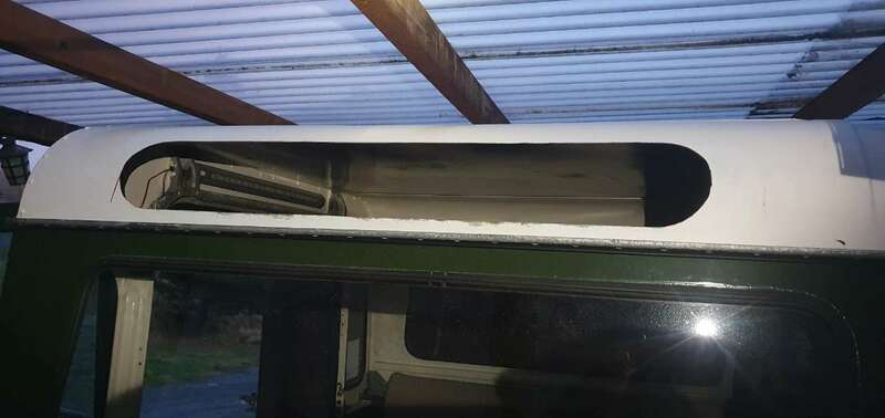

I didn't fancy moving the roof strut, as it was spot welded to the roof. So I decided to line up the alpine window with the rear edge of the lower window. All marked out 4mm larger than the glass:
No going back now!
With a fair bit of force and soapy water I got the glass into the seal, then it was a case of fitting the locking strip into the seal. I've done these before with just a screwdriver and thumb, but this time have bought the proper tool.
You have a loop which teases open the slot in the seal, then a roller which pushes the strip into the slot. Much easier, although the ends were still tricky!
First side took around an hour to fit to the hole, and I'll hopefully do the other side tomorrow (actually today). But pleased with the way it looks.
