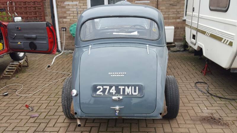

I want to get Boris up the end of my garden onto the hard standing outside my big shed but there are a couple of obstacles in the way...

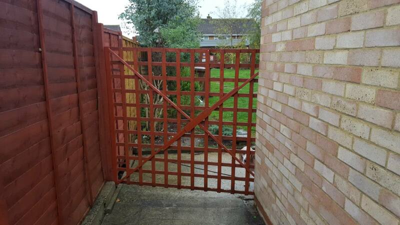

Firstly the 80% welded Subaru is still up on stands and blocking the side gate and secondly the side access narrows down to 60.5 inches at the entrance to the garden.
Wikipedia says a Moggy is bang on 60 inches wide but the factory manual that came with Boris lists his width at 61 inches so it may end in tears.

How well do you get on with your neighbours, can you take fence panels out to make some room?
The panels aren't the problem it's their wooden posts that are concreted in that are the bummer.

Just wedge a wooden beam across the top of one of the poles to the wall and push them sideways temporarily. Should be high enough to fit under.
Now that aint a bad idea.

Surely the widest part of a Mog would be the wings, and they bolt on? Then all you would scrape would be the tyres.
I know the doors have a bulge too but it would give you some wiggle room
I think this is the way to go as the wings need to come off to sort the rot out.

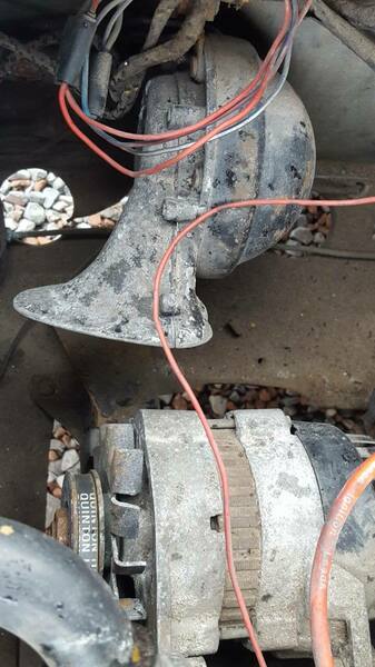

In the meantime i was nosing under the bonnet and spied a couple of things.
Firstly the size of the horn it's bigger than the Alternator.

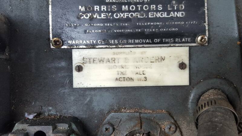

Then there's this suppliers plate on the bulkhead anyone know it they or the garage still survive ?
Now Tesco (what else?) The building is called Issigonis House, situated on the corner of Cowley Road. A memorial of what was once the main  agent for Morris.
Thankyou Sir.
Well that's put pay to revisiting Boris's supplying garage for a photo.
I've just had a quick google and it looks like Stewart and Ardern were a massive supplier of Morris vehicles back in the post war and pre war era.
My mate came round the other day and had to do a double take at the cars reg number.
His father in the late 1970's had a black 2 door with a TMU plate attatched so it too probably also came from Stewart and Ardern in Acton
And the funny thing is back then my mate lived two roads away from here.

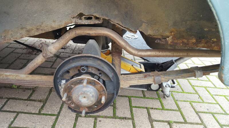

The drivers side brake was binding badly so much so that Boris was about 90% one wheel drive and so had no chance of traversing the damp grass to get to the shed.
I backed the adjuster off and cleaned the crud out of the drum and all was good while it was on the jack i had a look at the n/s back brake which  was free but smothered in gear oil from a failed hub seal so thats a job to add to the list.
The n/s rear wing although rusty on it's  lower extremities (will go again if i can't find a better one at a sensible price) unbolted easily enough revealing some scary holes and grottiness.
Oily shoes.
And many holes / weakness.
