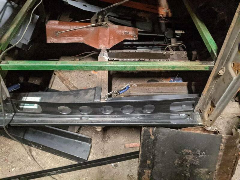

Joey spud Posted December 27, 2020 Author Posted December 27, 2020 All my panels have come from Andy Eggleton down Bristol way and in the Moggy bothering world they are regarded as better than most. I don't doubt for a minute that there will the need for the odd adjustment and much cussing to get them to fit how i want but its got to be the preferable route to go down. I don't have the tools or skill to make my own. I have been collecting images of how it all goes together (as it's nothing like a more modern vehicles sill structure) and these panels seem to do the job just fine. SiC, Somerset Suffolk, Minimad5 and 4 others 7

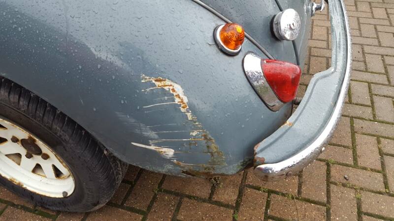

Joey spud Posted December 27, 2020 Author Posted December 27, 2020 The rear indicators need some thought too it looked like this which is what they did back in the day but its like an orange tit. I am keeping the early rear light and have been thinking of squeezing another bulb in it as i'm sure you can have red rear indicators on a pre '65 car but i guess it would attract attn. Otherwise i have seen these rubber plinths that would set a lamp at a more pleasing angle but they're £12 each for a bit of rubber. https://www.morrisminorspares.com/electrical-c54/rear-lights-saloon-c62/pair-of-rubber-mounting-plinth-for-additional-rear-indicators-takes-lmp101-lmp725-with-screws-p1238276 The plinth and one of these lamps (less titty shaped) in orange (or red) would look ok in my eyes. https://www.morrisminorspares.com/electrical-c54/front-sidelight-flasher-c57/flasher-indicator-light-complete-flat-amber-lens-l488-type-p829763 Banger Kenny and GrumpiusMaximus 2

junkyarddog Posted December 27, 2020 Posted December 27, 2020 A green bulb behind the red lens should* show as Orange. Joey spud 1
Joey spud Posted December 27, 2020 Author Posted December 27, 2020 2 minutes ago, junkyarddog said: A green bulb behind the red lens should* show as Orange. I read that the other day but it was on an Audi forum so i didn't know how true it was also where do you get green bulbs from ?
bunglebus Posted December 27, 2020 Posted December 27, 2020 As you say, red rear/white front is legal on pre-65. How about a small side repeater and suitable resistor, Fiat/Vauxhall had some small round units Joey spud 1

junkyarddog Posted December 27, 2020 Posted December 27, 2020 9 minutes ago, Joey spud said: I read that the other day but it was on an Audi forum so i didn't know how true it was also where do you get green bulbs from ? Squirt of cheap aerosol paint. Twiggy 1

PhilA Posted December 27, 2020 Posted December 27, 2020 I know white front indicators is a pre-'65 thing but I thought flashing brake lights was pre-'58? I'm guessing it doesn't have the correct indicator switch to do blinking brake lights though.

Squire_Dawson Posted December 27, 2020 Posted December 27, 2020 No, Morris were one of the last to abandon trafficators in 1961 and henceforth used white front red rear indicators until 1964 on the Minor. To operate the indicators with brake lights (using the same 21w filament) a Lucas DB10 relay is needed which complicates the wiring if planning to retrofit. The indicator stalk with green end is the same. My 1962 station wagon uses this system and nobody following has ever failed to understand which way I want to turn. LightBulbFun and Joey spud 1 1
Joey spud Posted December 27, 2020 Author Posted December 27, 2020 I never knew that thankyou. I have what looks like a 70's Mini indicator stalk and a big red warning light.
PhilA Posted December 27, 2020 Posted December 27, 2020 Love the way they complicated it with a relay. Got a standard blinker relay in mine, the switch is complex- it has power input from the blinker unit, input from the brake switch then 4 wires out, for each light. Did Morris ever use a switch like that or was it always via the relay?
Squire_Dawson Posted December 27, 2020 Posted December 27, 2020 Always via the relay. It was a late 1940's car upgraded gradually over the years. The 1000 model we are concerned with employed two types of indicator switches. The first from the 1000's introduction in 1956 until 1959 was a combined horn and trafficator switch which received a lot of criticism, so it was replaced with the now familiar green (or early orange) illuminated stalk operating trafficators/indicators only, and the horn push was moved to the centre of the steering wheel. Then the trafficators were dispensed with and the American system adopted (already used for many years on export Minors). The Home wiring loom changed to accommodate the DB10 relay which works very well. Finally, in 1964 the American system was replaced with amber indicators front and rear along with many other detail changes to the car. A 1959 model would originally have employed trafficators but knowing what switch it had originally is harder to tell as owners changed things over the years. If there is an Indicator tell-tale light on the speedometer, or the horn push is not in the centre of the steering wheel it would have had the early type. TBH it's academic now unless you're going full-on back to standard. LightBulbFun and PhilA 2
