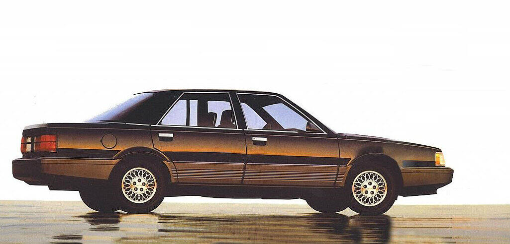

Don’t forget the Eagle Premier Wasn’t that basically a 25 saloon?
Yes and no.

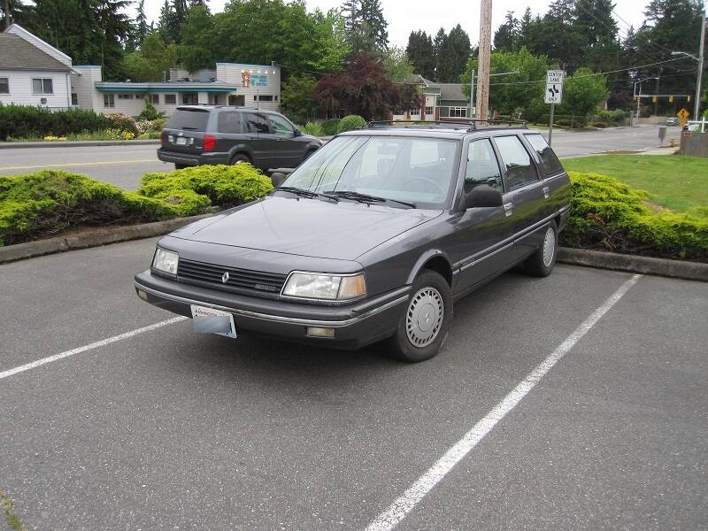

They look like 25 saloons, but we’re apparently styled by Guigario , keeping 25 doors 623499CB-ADDE-4F3E-8584-C85EACB48262.jpeg.dcdcff5d498b101424c31176661c053a.jpegand have the US built Renault Medallion ( 21) platforms fitted with the PRV V6. The first 172 were badged as Renault Premiers, then Renault sold AMC to Chrysler who created the Eagle brand to compete with Merkur. They even sold some Premiers as Dodge Monacos. Chrysler continued to sell Medallions as Renaults, just to confuse things further.DAEECC11-752A-4A15-967B-0FE81B5B610B.thumb.jpeg.02783d9a7a28eb850c4b1655813ff98b.jpeg
I know there are still quite a few smoking around Hamilton Ontario. Built just up the road from there. From certain angles they really do have the R25 look. Doors do that I guess.
