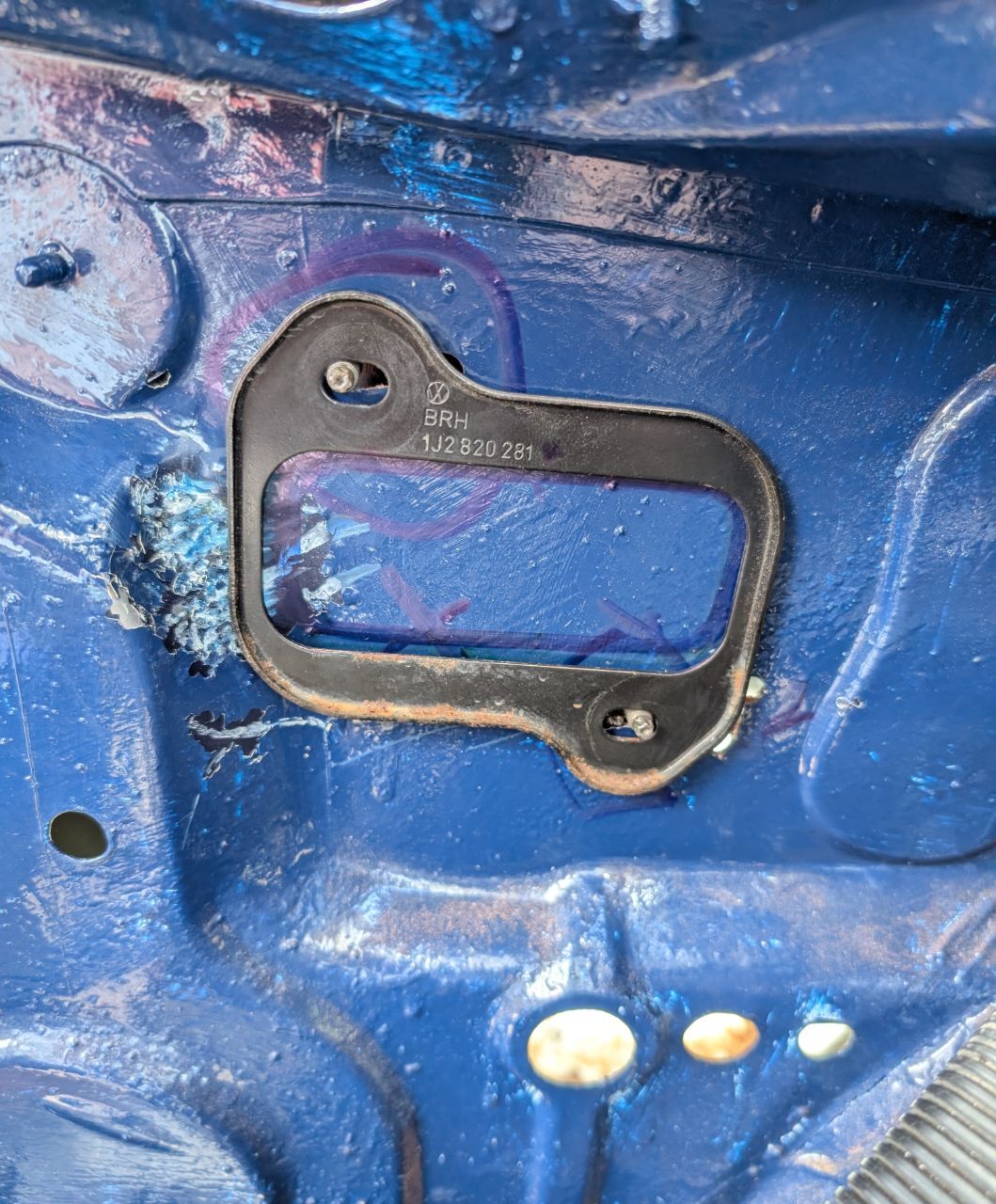

Bit more progress made on the Corrado today, I got the MK4 Golf heater box installed. It's quite similar to the MK3 unit but some of the mounting holes were different and I obviously had to cut a hole in the bulkhead for the Aircon evaporator and I used the support bracket as a template for that.
Hole cut and unit mounted 🙂
How it looks inside. I only have a few more jobs to do before I can think about putting the engine back in and that will be a big motivation boost and after that it's just refitting the interior and new suspension etc.
  • Like 11

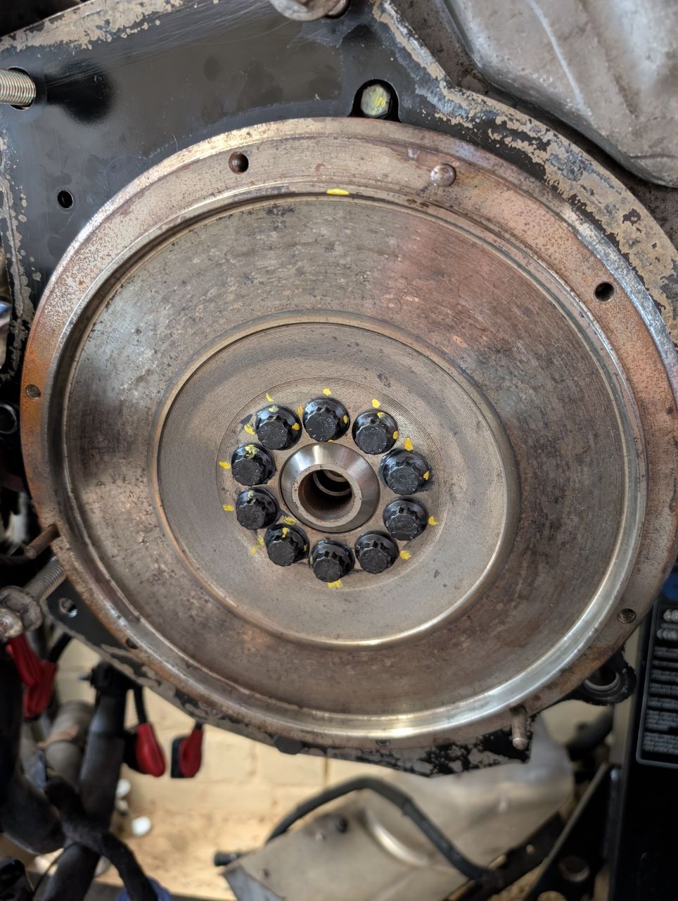

Installed the 12 valve flywheel today with new ARP bolts. I had been putting off fitting the new timing chains as it was a bit daunting considering the most complicated timing setup I have done previously was on a Ford Pinto. However I watched a couple of good YouTube videos detailing the process and following those it wasn't too bad.

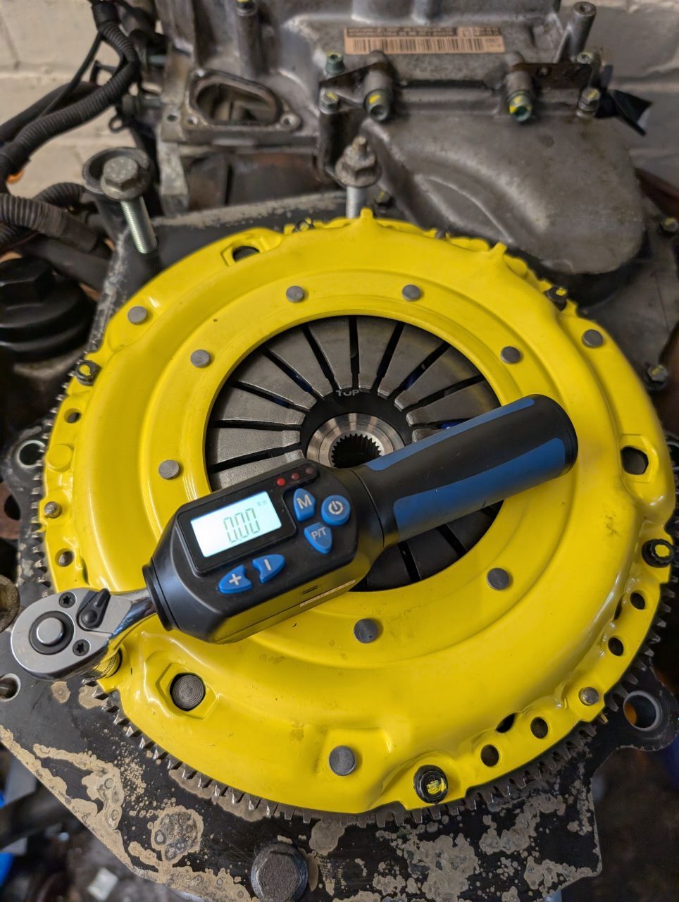

Also fitted a new uprated clutch today, it's supposed to be good for 385lb/ft so a stock 3.2 will be fine. I have been doing everything "properly" and tourqeing all bolts to spec and marking them with a paint pen when done so I don't miss any.
