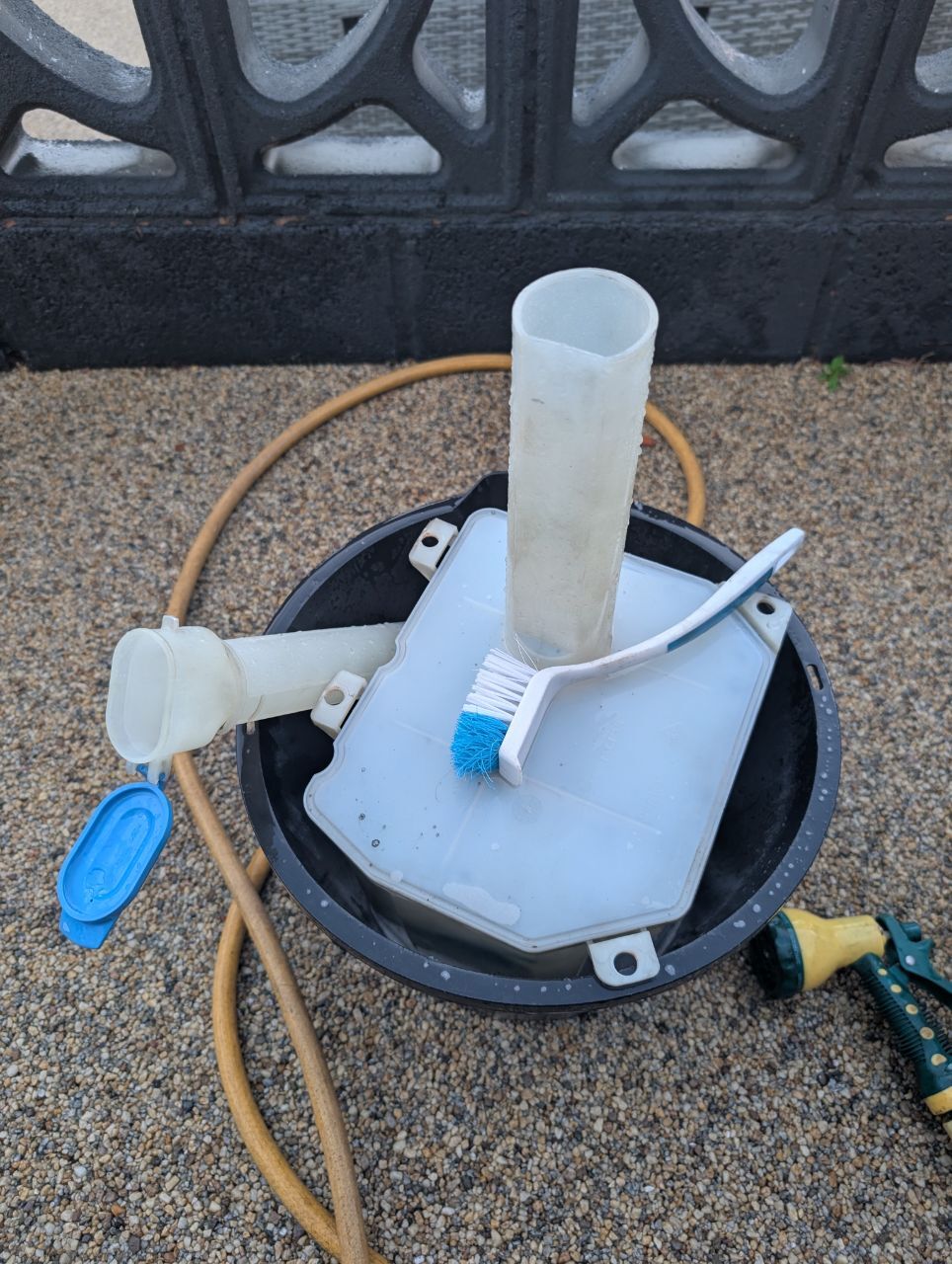

Bumper off for more rust proofing and also so I can properly clean the washer fluid bottle as I don't want any gunk going through my brand new pump!

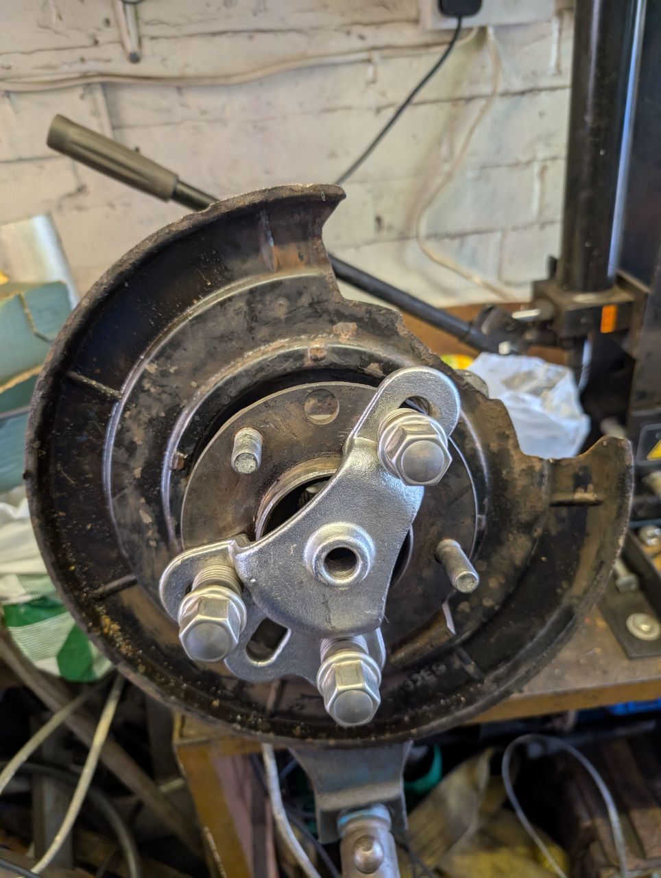

So I decided it would be easier to remove the whole hub carrier and then put the whole lot in the hydraulic press and remove the driveshaft that way but that's a job for tomorrow.

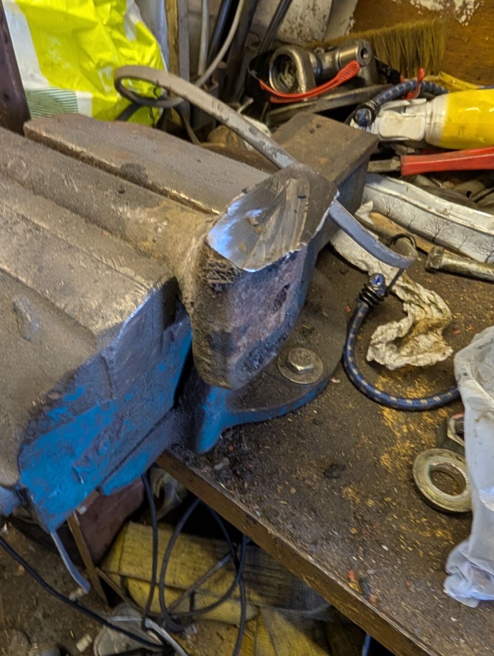

Removing rusty split rings is "fun", the proper tool had no chance so I found this old screw and a hammer to work best. At some point during this driveshaft refurbishment I am going to wonder why I didn't just buy ones already done but they are a lot more expensive and I have already ordered the UJ's.

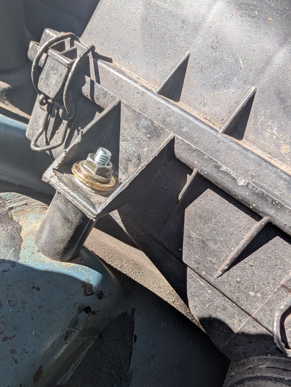

I noticed the air box rubber mounting had disintegrated and the correct replacement is £40 which I wasn't prepared to pay so I purchased a generic M6 threaded bobbin mount for £2 and that works fine.

So with my new plan decided I cut off the old driveshaft from the one I had trouble removing to make room for it to fit in the press then I pressed out the remains.
Then the slide hammer worked to remove the hub from the hub carrier as it was evidently the rust between the splines of the driveshaft and hub that was making it difficult to remove.

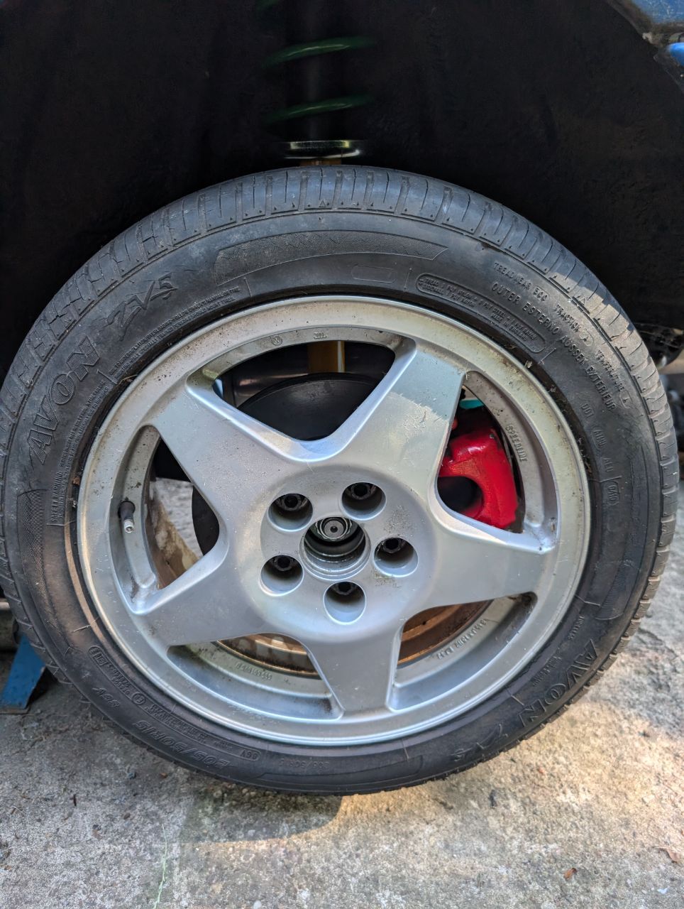

Bolted a few more new parts to the Corrado, for the rear brakes I am using some brake adaptor plates which allows you to use Polo 9N stub axles and hubs which have pre fitted roller bearings that are superior to the MK3 tapered bearings and no need to faff about setting preload etc.
It also gives you an upgrade to 256mm vented discs instead of 230mm solid ones and I am using the rear calipers from the TT which again are an upgrade with a superior handbrake mechanism which doesn't seize up like the MK3 ones tend to, I popped on a wheel just to double check I could still use the OEM 15" Speedlines and yeah no clearance issues at all. The calipers won't be staying red as I prefer boring black and have some caliper paint to spray them with.
