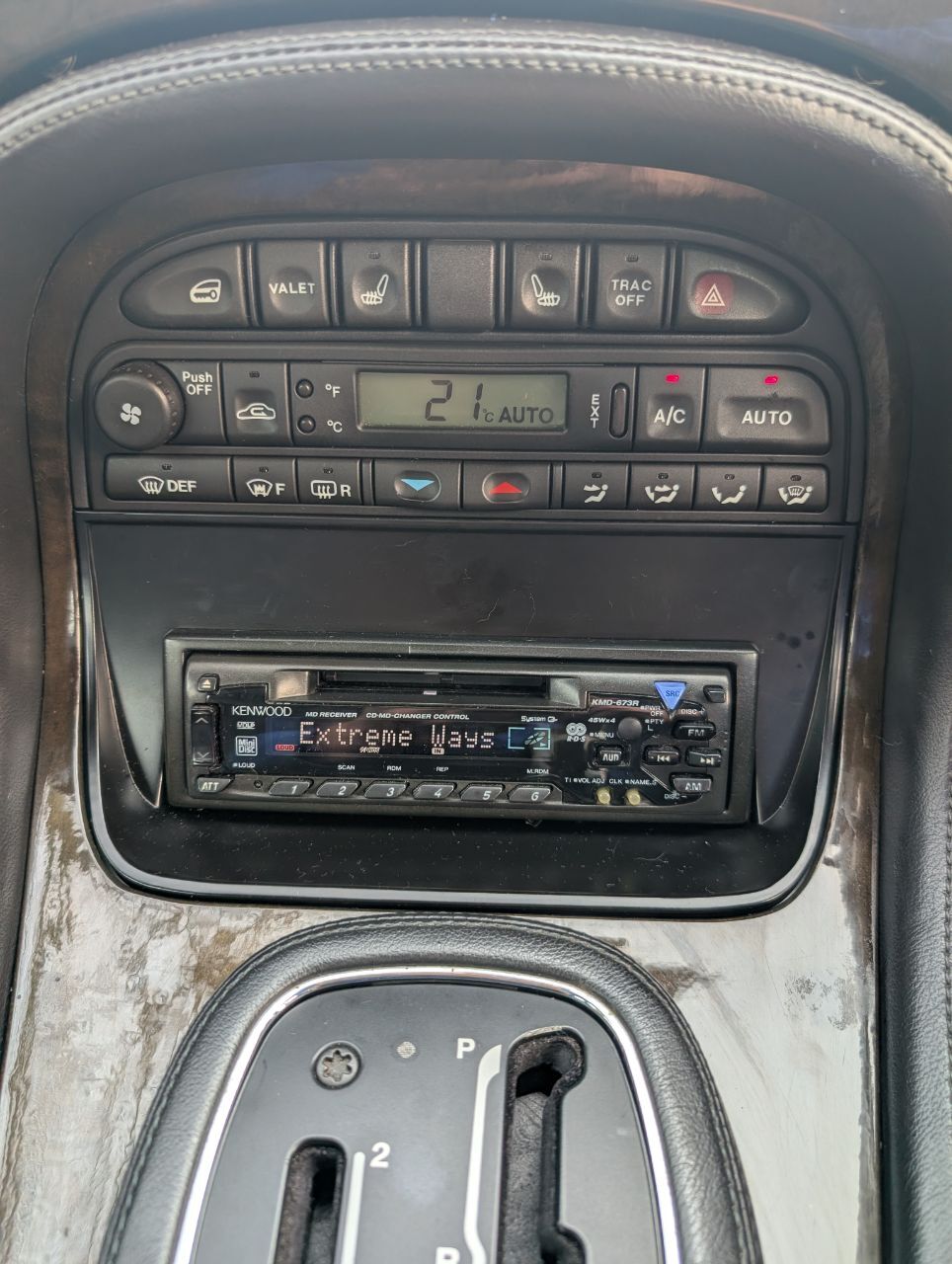

And finally the most important improvement the Minidisc head unit. I went with a Kenwood KMD-673R as I think it suits the car well and I didn't want a garish Sony unit in this particular car. Fitment was pretty straightforward using a harness adaptor from @philibusmoand a fascia from AliExpress. Oh and I also put in the heated seat buttons while I was in there.

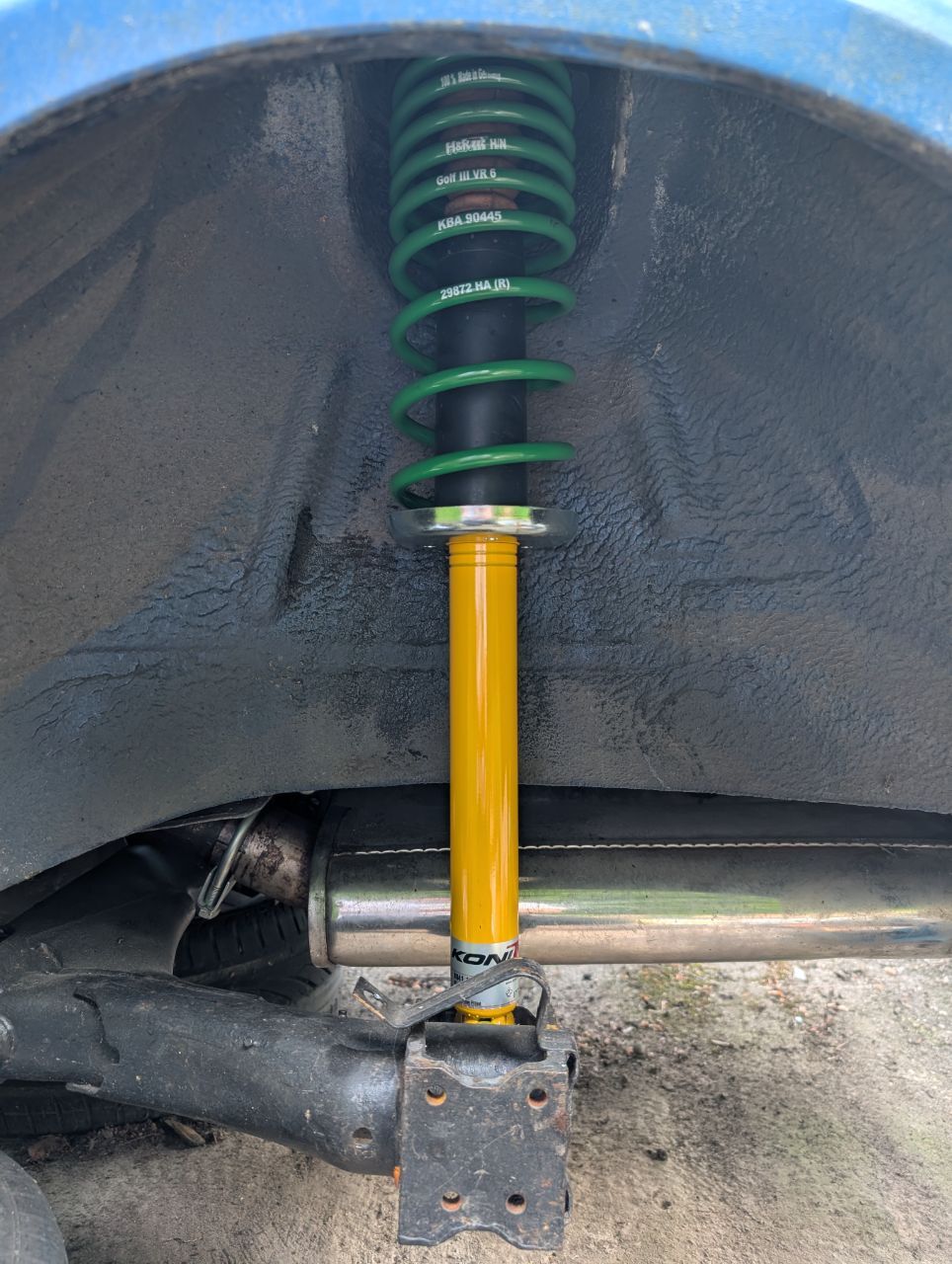

I actually did some work on the Corrado today and started fitting the new suspension, I am looking forward to seeing how it rides and handles with these on.

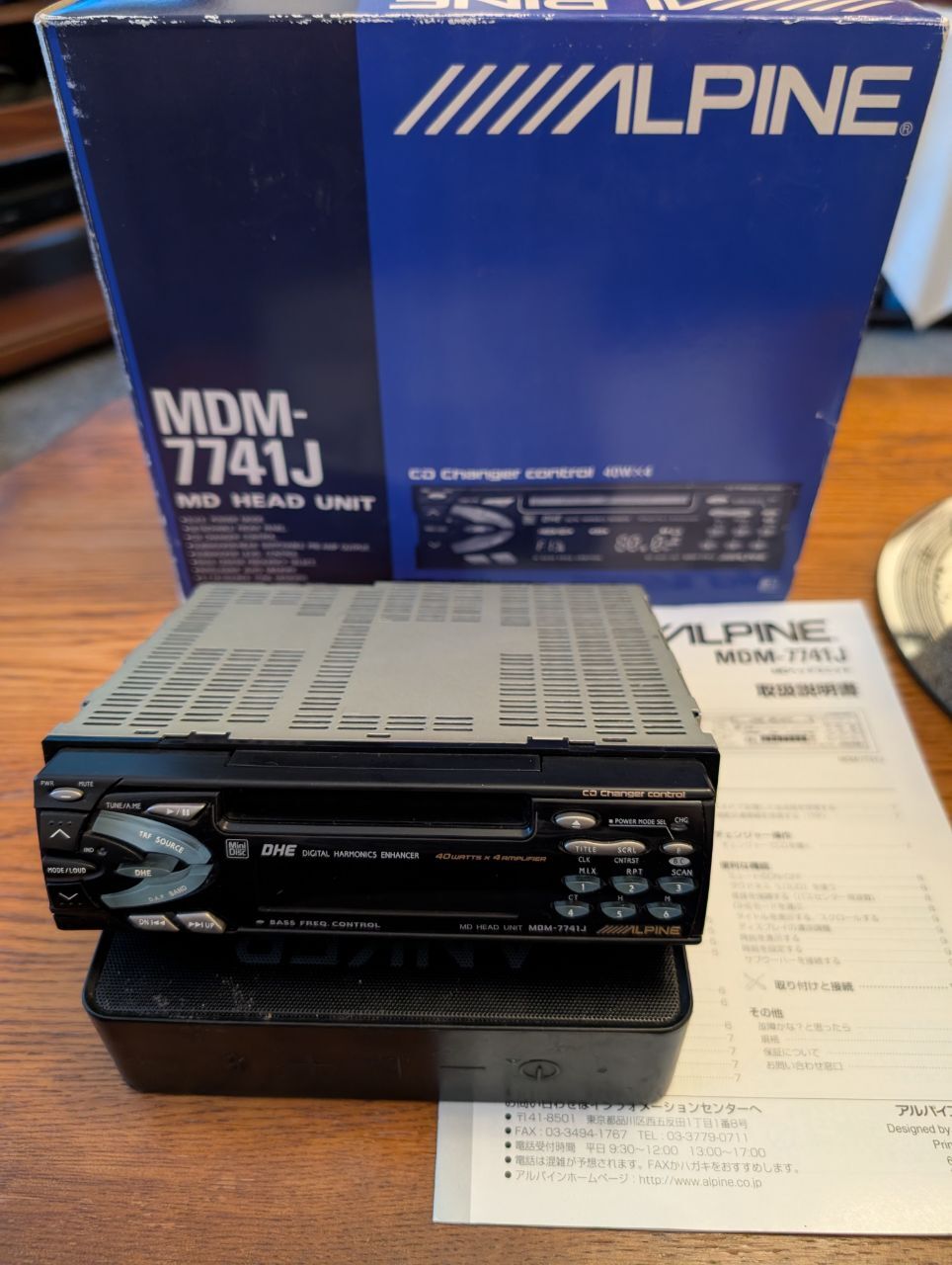

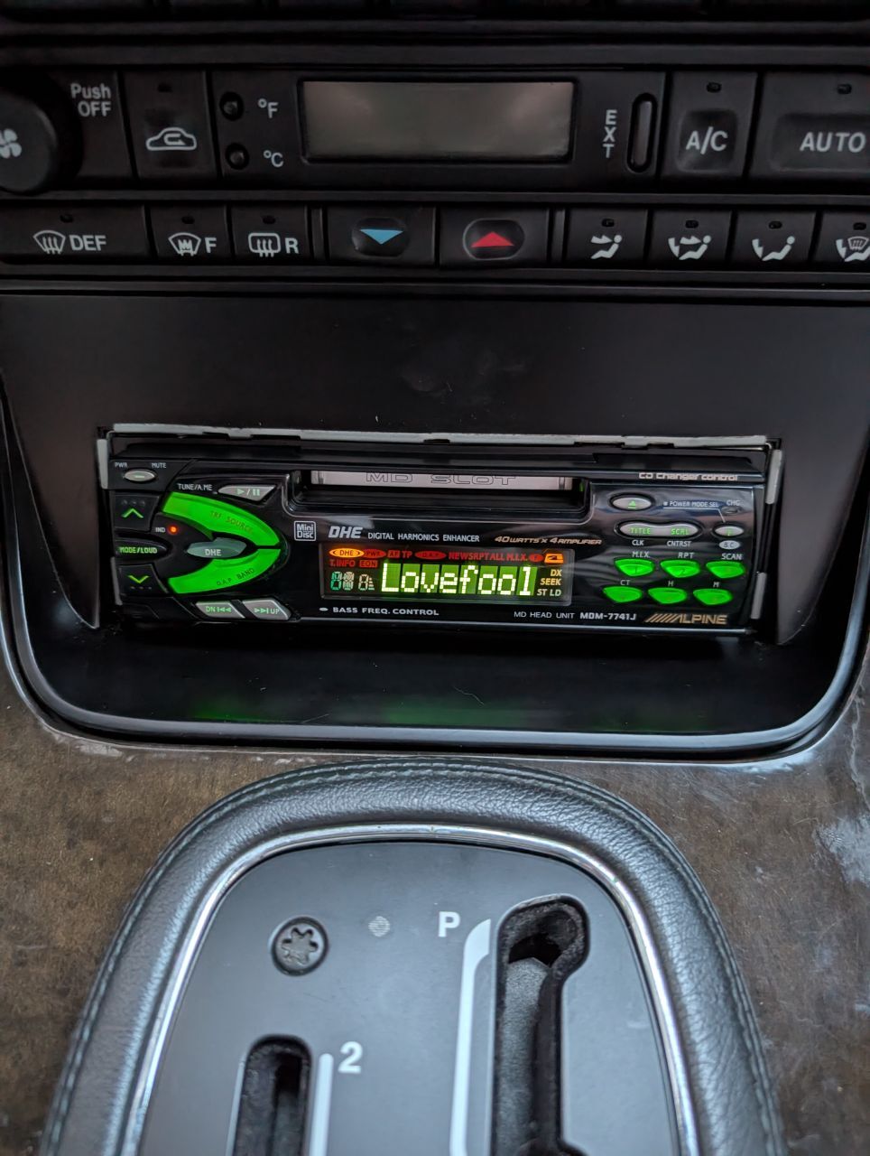

I got bored of the Kenwood in the Jag so swapped in this Alpine unit that I imported from Japan. It has the Japanese frequency range of 76-90 MHz but I never listen to the radio and I can still get BBC Radio 2 on 88.3 if I want to listen to the news and find out if I am about to be nuked or something. I should have a surround bezel at home as that was the only thing missing from the box.

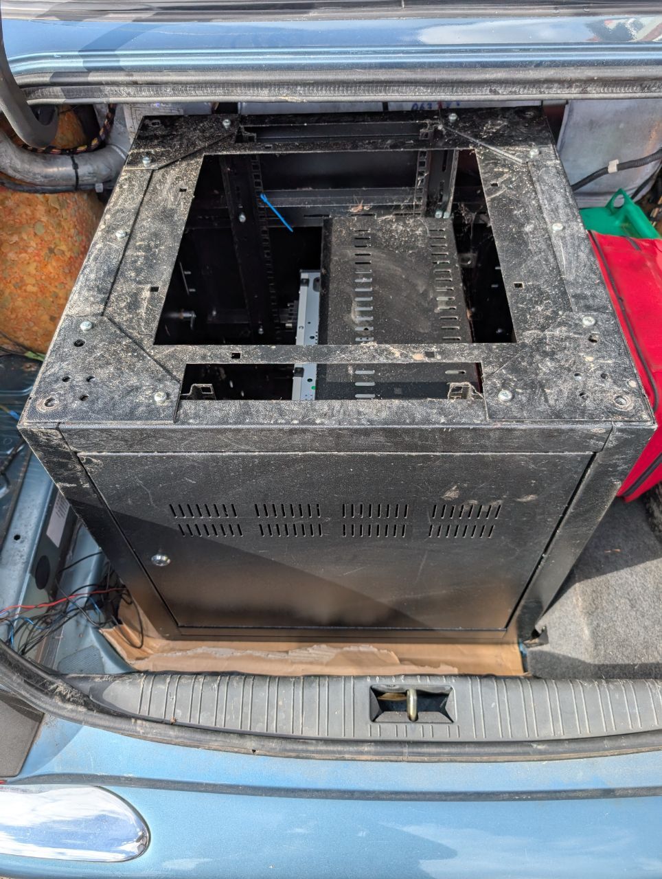

Who said a Jag can't be practical? Turns out if you remove the spare wheel you can fit a one metre square server cabinet in the boot!
