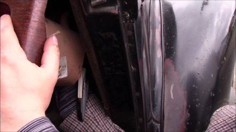

First task is to identify the fixings for the door cards so we can reinstall them.  In theory, this should be a simple case of slotting the keyhole brackets on to the screws that are in the wooden frame of the door.  There's two of these screws for each door card.  They're the silver headed screws on the leading edge of the door frame in the following shot.  The upper one was missing on the passenger front door and the lower one not in great shape.
Then it's simply a case of slotting the brackets over the screw heads to hold the door card in place so you can put the other fixings in.  Only, we'd made a mistake.  You see, even when the eyes of the whole internet are on your project, you've taken lots of reference photos, and you've been really picky about making sure things are correct, sometimes you miss the obvious.  The obvious we'd missed was that every single keyhole bracket was on upside down.  Unfortunately, the rivets holding them in do an incredibly good job and are very difficult to remove without damaging the plywood.
To fix that issue, we had to remove half the tacks and peel back some of the rexine to get access.  We also found on the trial fit - we could still get a couple of the other fixings home to at least put the cards in the correct place - that the front passenger door card was catching on the leading edge.  The rear driver's door card was also catching on the trailing edge.  The other more annoying problem was that the escutcheons for the window winders could not physically be compressed far enough to get access to the locking pin hole... all in all it meant partially dismantling all of the door cards to correct these minor issues.  The hole for the window winder escutcheon was increased such that the escutcheon could recess slightly into the door card, 6 of the 8 keyhole brackets were removed and reinstalled the correct way up, and the two slightly oversized door cards were retrimmed accordingly.  A little time with hammers and tacks later and we had the door cards ready to go again.
Refitting wasn't too bad though it did end up being a two person job.  It's easier for you to see the struggle in the video, but essentially you need one person to hold the handle and drive the pin home, while the other pushes against the spring inside the escutcheon to keep it out of the way of the pin.  On attempting to do this job we understood why when we got the car the escutcheon and pin were missing on the driver's door and had been replaced with a piece of twisted wire.  To fit the door cards, there's the two screws that go in the keyhole brackets, two screws that go on the B pillar side through the door frame and into a bracket on the door card, one screw at each top corner that is hidden by the wooden trim, and two to four screws along the bottom edge through the carpet.  Once you've done all those, you can put the wooden capping back on, being sure that the screw holes are lined up with the holes in the metal tongues on the capping, and then screw in the door pull handle.  It was a far more involved process rebuilding these doors than expected and we hope nothing goes wrong inside them as a result.

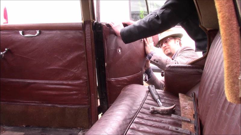

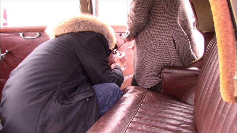

The first job was refitting the rear door card that we hadn't yet.  The video really highlights what this job is like, it involved making a lot of these sorts of faces.
Once all the edge screws were in to hold the door card in place, Pat fitted the wooden capping since he seems to be better at that than I am and we made sure nothing was binding on the door frame.  Happily, everything was good so we moved on to the next bit.
Fitting the pull handle was easy, that's just two large screws, fitting the window winder was another matter.  As previously mentioned, the window winders almost seem to have too short a post on them meaning it very difficult to get the escutcheon compressed enough (even on the original plywood cards) to get the pin to go in the locating hole that holds everything together.  We found it impossible to do solo, instead it usually takes three screwdrivers, a lot of huffing and puffing, and a dash of luck.

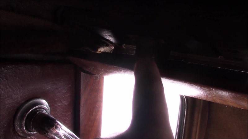

Visibility for the four screws that hold the rail in place is poor, opening the fresh air vent did help a bit, with the side effect that any dust and detritus you didn't want in your face got blown straight into it.  The screws go through metal brackets on the car's wooden body frame and into the rail itself, the first attempt we misaligned and screwed into thin air.  This turned out to be another two person job since I had to see where it was aligned and then Pat had to hold the rail to prevent it from moving until we got a couple of screws located.
You can make out where they're supposed to go in this next picture, spot the silver coloured crosshead screws.

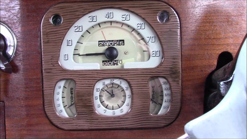

Then it was the turn of the temperature gauge and its fragile capillary line.  The wire on the back of the gauge is actually a very fine tube, sealed at both ends, that cannot be removed from the guage or the sender that goes into the water pump.  It works so we're happy to reinstall it and it keeps things nicely original.
It's held into the back of the instrument cluster with two stubby little flathead screws, like the rest.
It was nice to finally see the instrument cluster complete again.  The speedometer cable was reattached too.  We didn't attach the starter cable to the starter because the starter motor needs to come off for a service or repair and to do that it looks like we need to remove the exhaust to get access to at least one of the starter's bolts so that's going to be another fairly involved job.

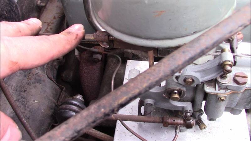

We also learned that either one of the hose connectors or the non-return valve for the washer pump is leaking a bit.  We know it's not the heater matrix as that hasn't been used or disturbed this time, and you can trace the water to the washer pump connections.  That one at least is an easy fix using generic parts.
