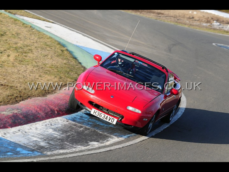

1990 1.6 eunos roadster AVO
D232CE51-BE68-42D9-8B94-23E0470C0F85-4727-00000BDF998B0D63_zpsb985b177.jpg.ac1a609ae4115208e343cabd057cf4e0.jpg
so much fun was had with this car, definitely my favourite - as I now had a sensible daily driver, this one got quite a bit of work done : roll bar, bucket seats, harnesses, suspension, brakes, exhaust etc. and plenty of laps of knockhill. sometimes getting a little carried away

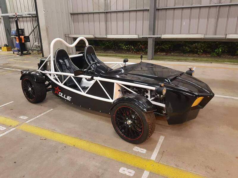

fast forward ten years and I find myself once again contemplating the idea of an mx5 based kit car.
there are two obvious contenders :
the MEV Exocet
and the GBS Zero
both based on mx5 running gear, not a massive difference in cost or complexity, so which one should I go for ?

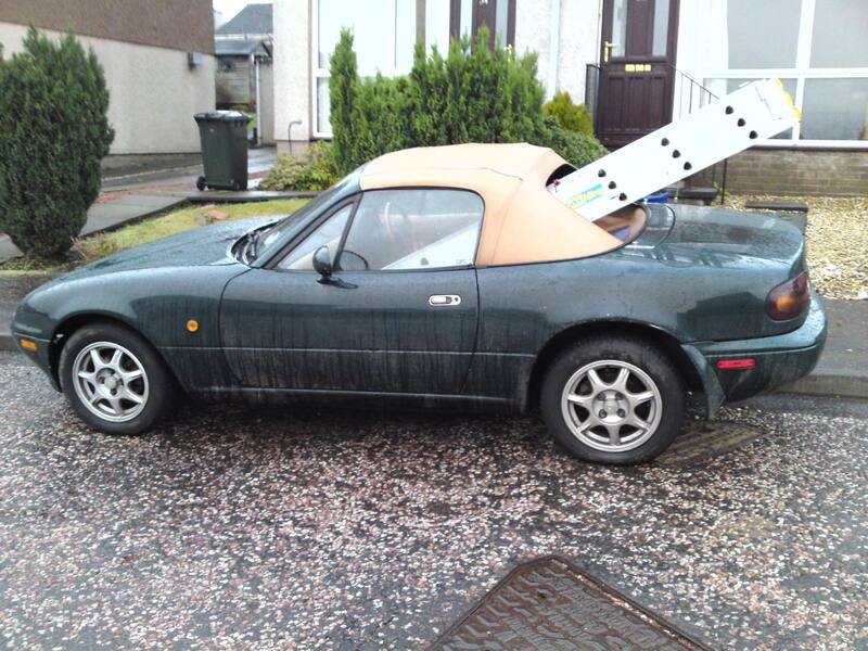

"so which one. should I go for ?" remained a hypothetical question for quite some time. but then last week, I spotted this on the facebook marketplace
95379505_170061307644312_7168922079180357632_n.thumb.jpg.ba3a8bb407e032e1590bd7cf01be03b2.jpg
now cheap mk1s are becoming thin on the ground, even scruffy examples are into four figures so I had to go take a look.
quite presentable up top but needing a whack of welding underneath. it had a fancy set of alloys on that the seller wanted to keep, we hummed and harred and came to a deal. he asked what we should do about the wheels, how fortunate that I had a spare set of steelies with me in the boot :)
I flung a bucket of water over it and thought about what I'd done :)
95598217_10158459315979529_8691399646725013504_o.thumb.jpg.6791d2facfcf7b5e09446a3a09b75e34.jpg
95285434_10158459315769529_9104625382350389248_o.thumb.jpg.0e5f5ee3803184fee2391722bca1aca9.jpg
95257513_10158459316319529_1980380811408441344_o.thumb.jpg.0f278b9d52e18b22ffc44d214d5e85a2.jpg
95339983_10158459316214529_1528182237596483584_o.thumb.jpg.f6a330d002f83f6f5da1156372f1d025.jpg
not so bad, really
mechanically it appears to be fine - I drove it up and down the street a couple of times and stuffed it away out of sight
I think we can refer to this as day zero

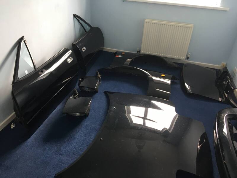

well, I had a wee poke about the car and made a mental list of what could be stripped and sold on - it's worth more in parts than I paid for it so other than time, I've got nothing to lose. and I'm not short of time right now.
let's get the tools out and see what's what :
most of the interior removed but still running and almost still drivable at this point.
by the end of day two, my spare room (that I was supposed to be decorating this week) looked like
and the poor little mazda was looking quite distressed
my back was in bits after that but I was pleased with progress so far.

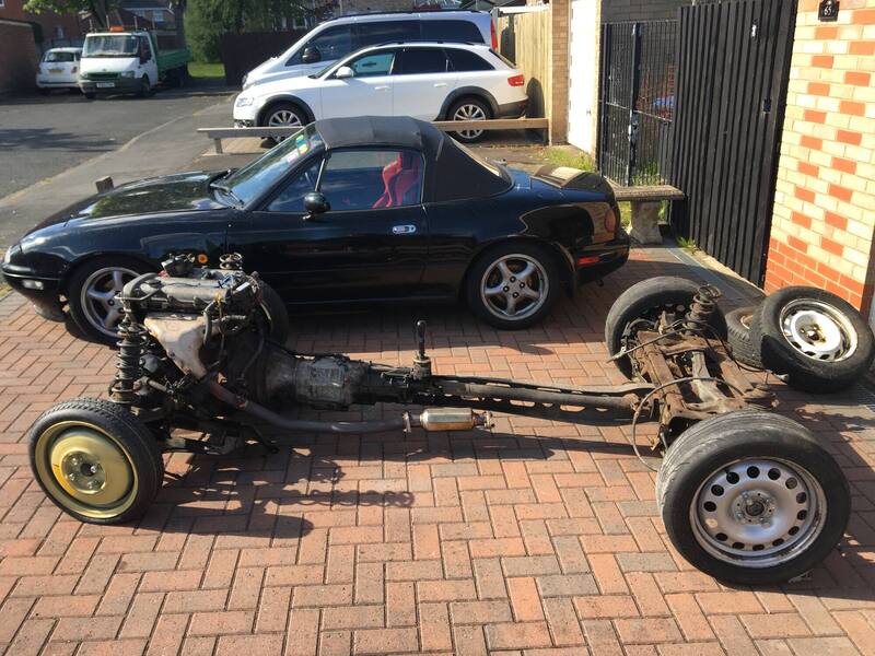

lots more stuff to disconnect, unbolt, cut, bend, hit, kick and swear at but at the end of a hard days toil we had two distinct parts of a car
the running gear is on the floor and the shell up high on axle stands, but not quite high enough to roll the chassis (not a chassis) out from underneath
we need another plan......

there are many write-ups on the Exocet forum that all say the same thing - removing the body from your donor car IS NOT A ONE MAN JOB !
but we're in the middle of lockdown and I am but one man.
so what to do ?
get your finger out of your arse and get this job jobbed !
I'd been out to toolstation and bought a pack of ratchet straps which I thought might come in handy, how pleased I was to notice later on in the day that they are NOT SUITABLE FOR LIFTING. well, I guess I proved them wrong there then !
the hardest part of splitting the halves is trying to keep the shell level as it swings ever upwards. I think it was on my fourth time re-roping that I had sufficient confidence to pull that lever more than a few times. an extra strap fixed to the ceiling was ideal to keep the wayward carcass from banging me in the nuts/face/shins etc and we gained some clearance
note the front wheels are now space savers as the full size ones were on standby incase I needed to drop the shell in a hurry, the chances of it landing back on the axle stands were laughably low ( when I was collecting the gallows, I'd brought back a set of peugeot steelies for @loserone, they may* have also been on emergency standby duty)
that sweet chariot was not swinging low enough for my liking, that's a quarter of a ton hanging a metre above the ground and my arse was making buttons.
but obviously I still had time to take photos :)

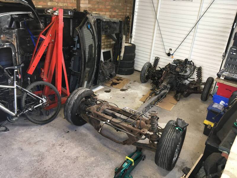

so to recap, we have a shell swinging around in the garage and a chassis not chassis out in the street, obviously delighting the neighbours who had ALL chosen that moment to take their daily exercise
the phrase "you haven't really thought this through" sprang to mind - that garage, although a generous size, does not have Tardis like qualities and I really don't want to have to break the chassis not chassis today
right, time for some 'lateral' thinking
wheels were stacked up to form makeshift axle stands while I whipped the fuel tank out then the ropes were refitted at a different angle.
more arse clenching manoeuvres with the crane and we can call that game of garage Tetris done !

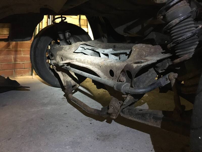

now I get to have a good look at what I've got to work with
subframes will need a session or two with the wire wheel and a lick of paint
the engine is manky, lots of seals to replace and a serious amount of degreaser needed
but plenty to get on with.
most of the body panels are already sold on to other mx5 nutters, once the roof and seats go, I'll have covered most of the purchase price and I've got myself a summer project to get stuck into.

Let's hope they don't go out of business before your order is ready.
