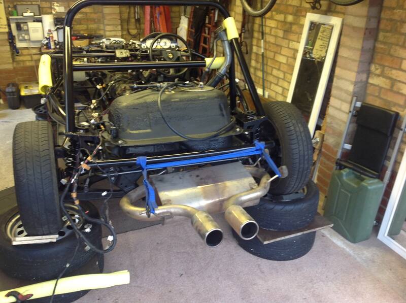

to say I'm impressed is the understatement of the year - I'm absolutely thrilled to have got it running, without much in the way of faffing about.  It sounds angry as fuck with no exhaust but in the interests of neighbourhood harmony, I fitted* a "silencer"
and it still sounds good and angry :)
can't wait to get it out on the road and kick it's arse round the twisties, there's still a fair bit of work to go before the man from the ministry casts his beadies over it. I should probably fit some brakes too !

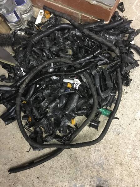

c u l8r mr immobiliser (was quite a messy install and only had one fob, I'll probably replace later on)
The pile of scrap wires has grown
and the pile of manky old black tape is sizeable too
but there's still a way to go with this lot - I should probably get a wiring diagram before going much further
Remarkably, it does still run :)

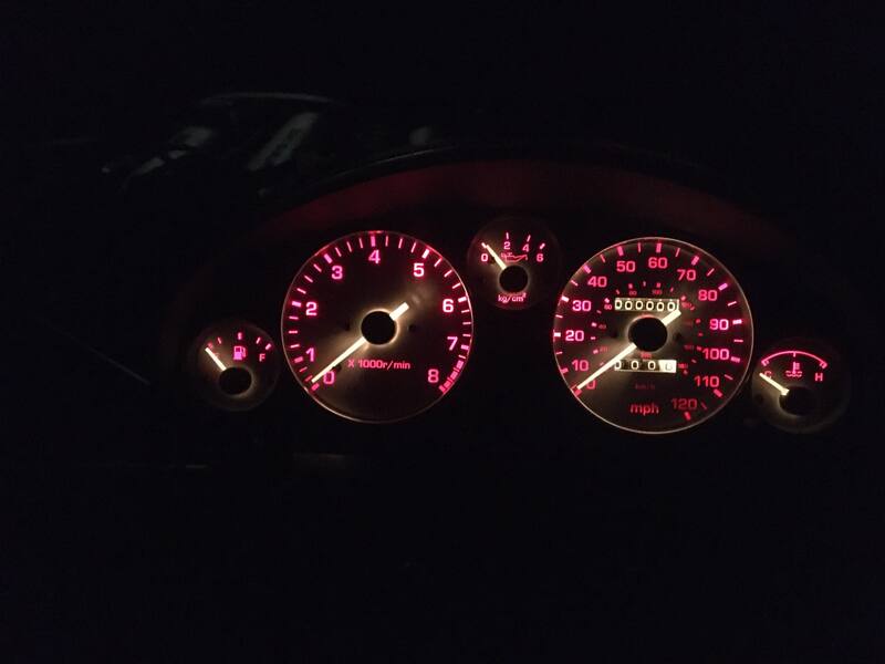

I'll bung this in the dash at night thread too - looks less pink in real life

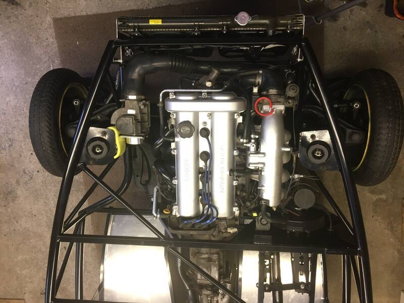

I know... I am getting saucy thoughts
I stared at this for ages wondering what you had circled in red on the right there.......

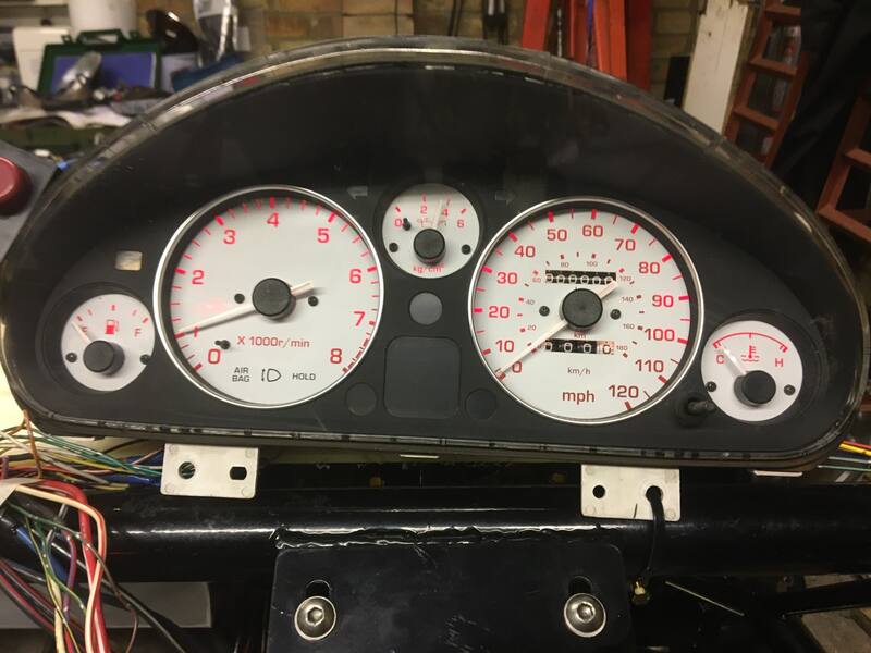

I've got a week off work coming up, my mission is to make this
look a bit more like this

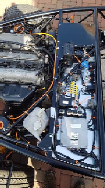

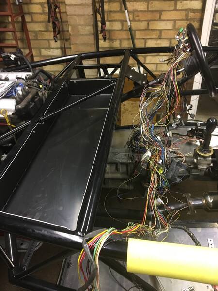

Today's mission was to get that wiring sorted out. Still lacking a wiring diagram, I very carefully chopped away more redundant sections and got fairly close to the bare minimum needed.
I bought the wiring tray with the kit but it needed a fair bit of fettling to make fit, I'll need to take it out to cut holes for the loom but for now, it's looking pretty good.
but what about all that shit hanging down next to it ?
job's a good 'un !
just don't look under that handy piece of Perspex I had lying around :)
oh my, that still needs work
but still, it's coming together nicely
but does it still run ?
yes, it flipping well does :)

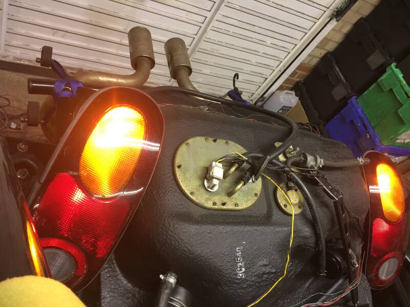

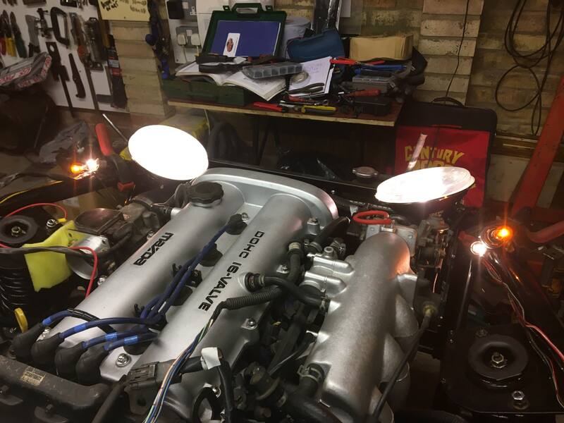

One more thing to check, are the lights working ?
great, super, smashing.

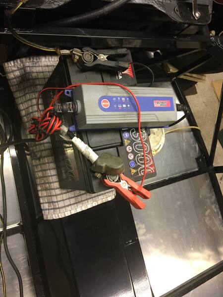

i bunged the battery on charged and tucked it away for the night
in theory, all I need is brakes and this could be driven (illegally) up and down the street.
might not be the best idea as I have a serving and a retired traffic cop as neighbours !
Might need to adjust the headlight aim

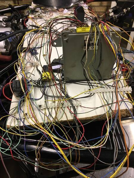

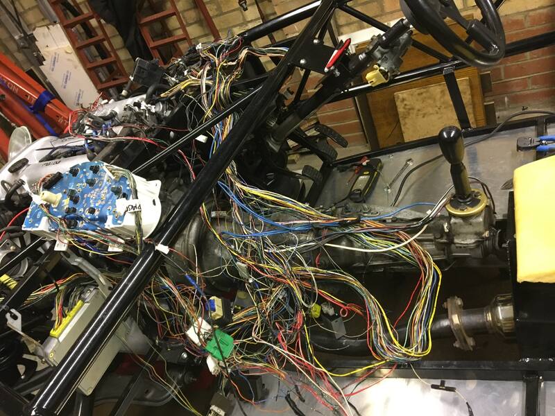

but I got back in the garage today and had a go at this horror show

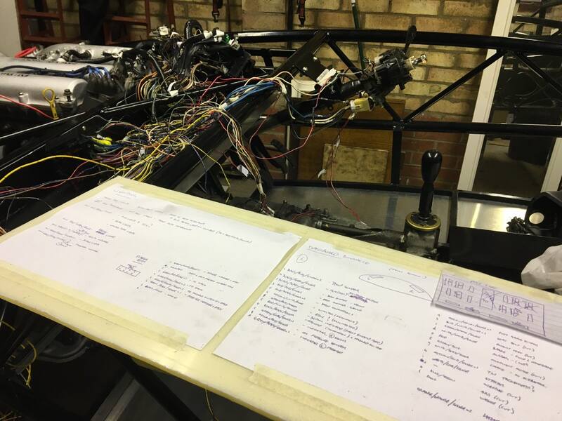

i'd been mulling over how best to approach this whole wiring thing, various build threads talk about having a good wiring diagram - the ones I managed to download made no sense whatsoever so an alternative approach was needed
i started off labelling the wires I did 'know'
then the postie dropped off a tiny air filter so I enjoyed a nice easy job instead :)

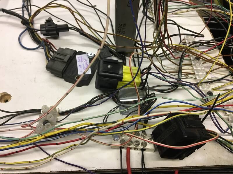

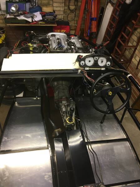

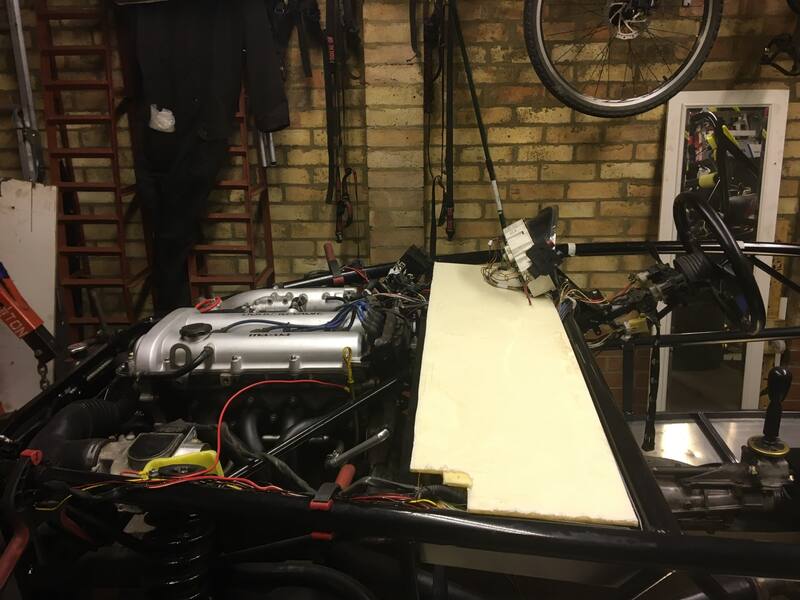

back to that wiring - I dug out an old wardrobe door which fitted over the wiring tray, this proved an ideal base to fix the various components to while I figured out what goes where
as the wires gave away their secrets, I wrote it down on the base
I'd picked up some earth blocks from screwfix which came in very handy
slowly I unpicked that mess of wires and got them into some semblance of order

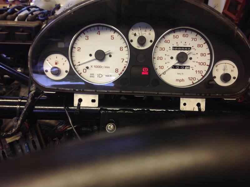

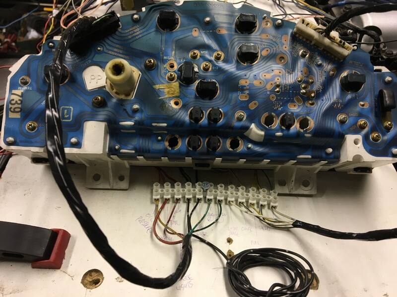

the dashboard binnacle was particularly satisfying
so tomorrow, I'll be doing a whole load of soldering, testing and (hopefully) wrapping it all up in tape
observed from above, there's not really much left
so now I know what all some a small number of those wires do
