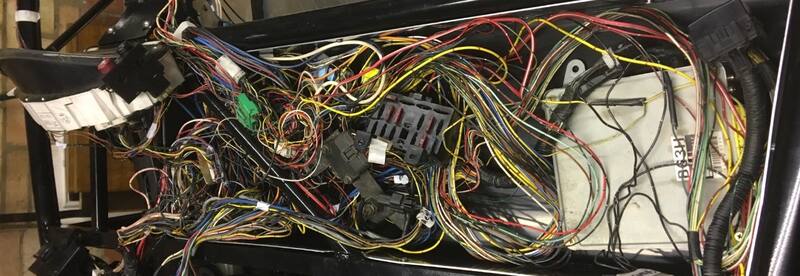

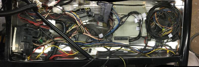

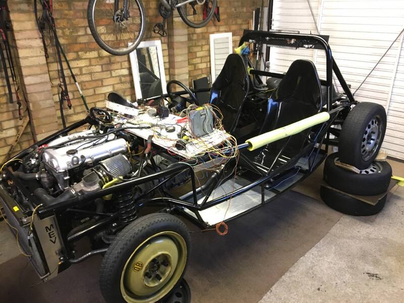

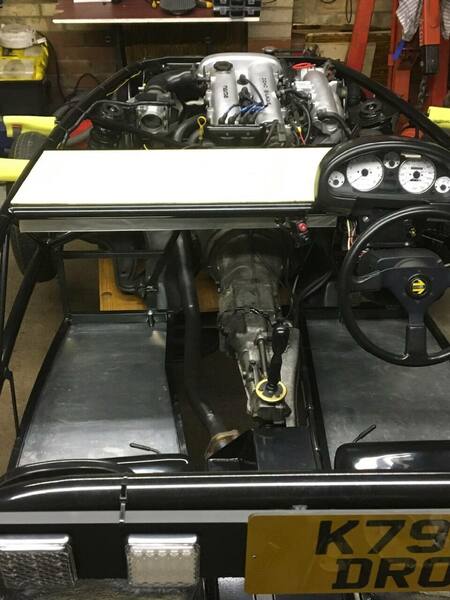

Right, I've just about had enough of sodding wiring for a lifetime :(

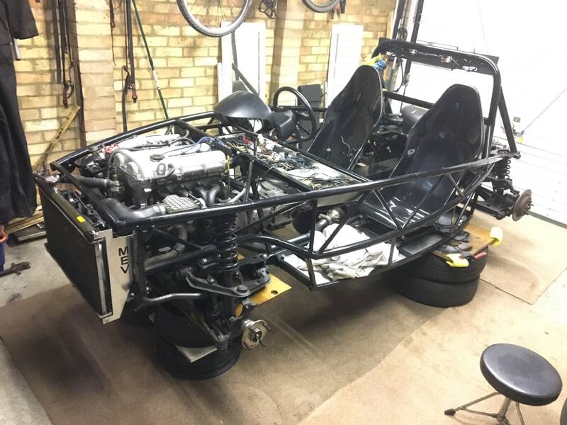

this is what we started with
this is what we were aiming for
and this is what we've ended up with
it all still works so I'll be leaving it alone for a good while
i want this thing moving SOON

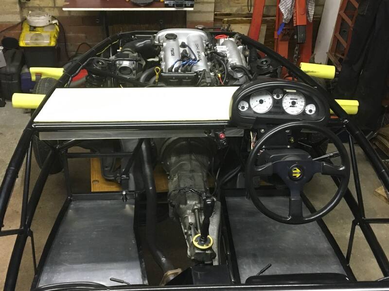

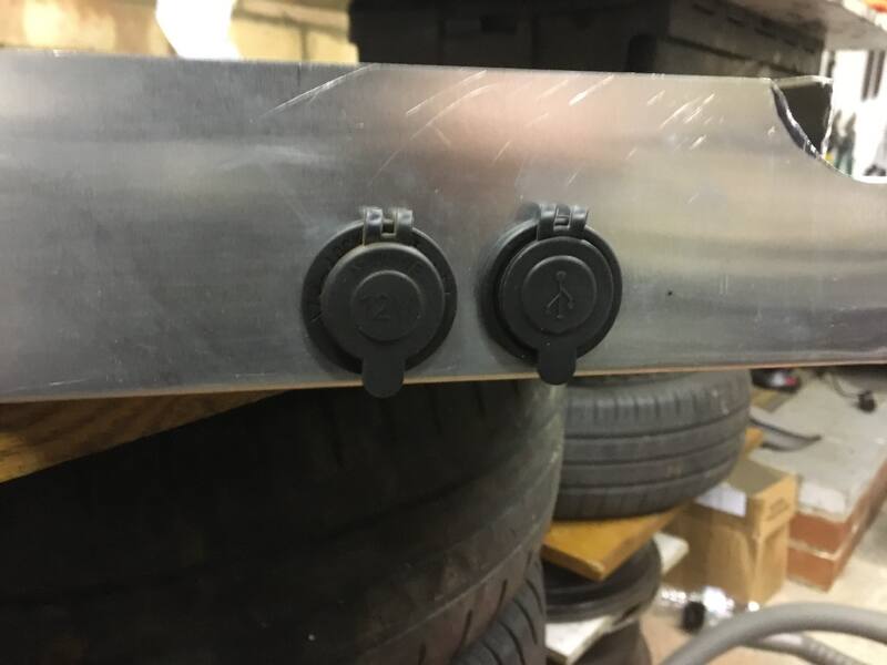

I fitted a couple of sockets for phone charging and the tyre pump
even did nice trimmed edges

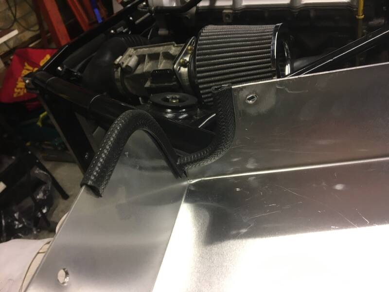

then made a 'bracket' to hold the afm (not quite up to binky standards :) )

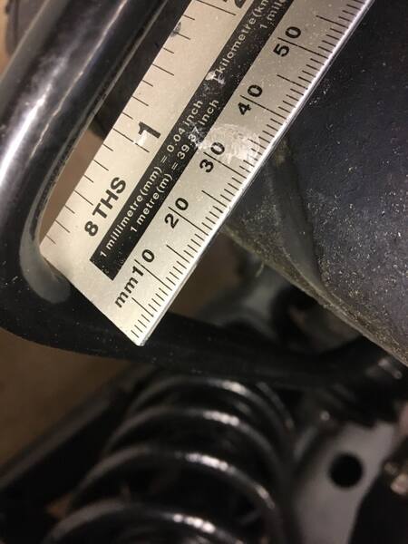

but there is a problem - the air filter is too fat to fit between the strut and the manifold - time to hit that ebay
Could you fit an elbow and keep the airfilter in the position you're holding it?
yep, that's the plan - got one coming from ebay - I'll cobble together some kind of bracket for the filter to hang off away from the manifold.

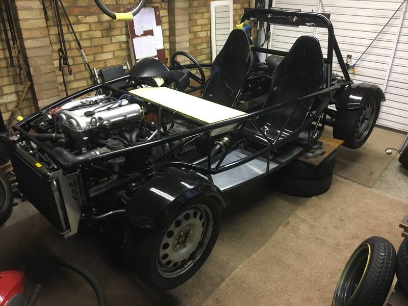

the exo has been sitting "up on blocks" for a good long time but today I need those wheels off
which took a ridiculous amount of fannying about with jacks, but now it's hovering nicely

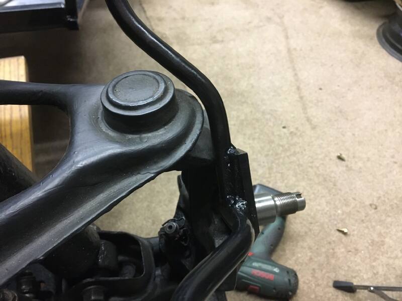

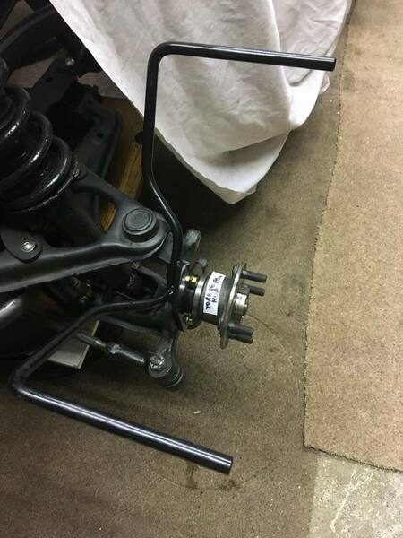

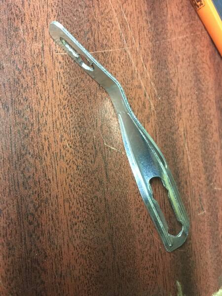

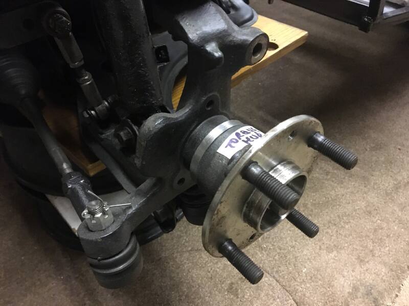

and the reason for this apparent backwards step is this little sod
which needs to fit behind the hub (which I thankfully hadn't torqued to 170nm as per my handy reminder)

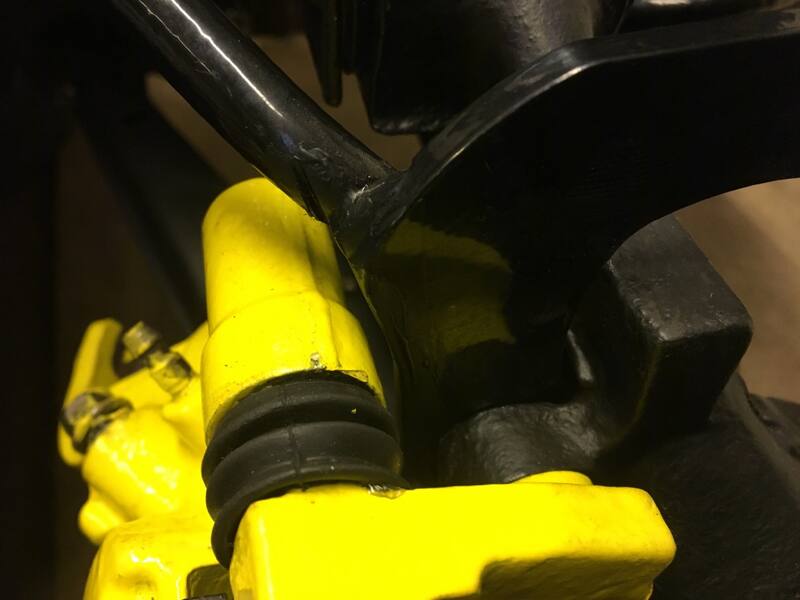

obviously nothing is ever straightforward and I had to re-drill the holes to get them to line up but eventually it was on

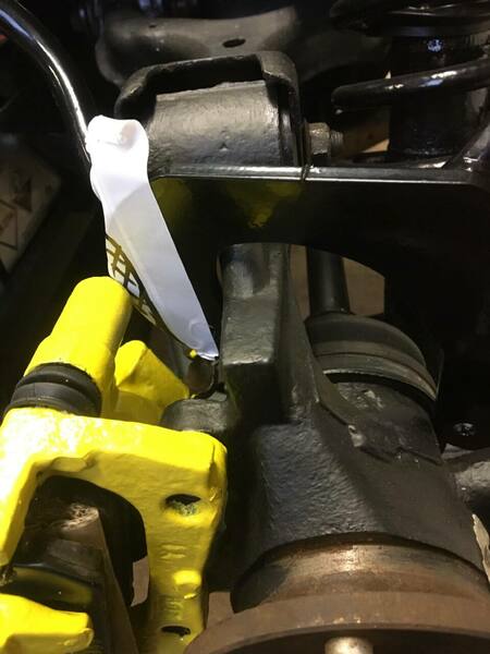

and alarmingly close to the upper wishbone :( time for a wee tickle with the grinder
that's better :)
I did remember to torque the hub nut to 170nm :)
the other side was slightly less fiddly, only holes to re-drill, wishbone clearance was better on that side

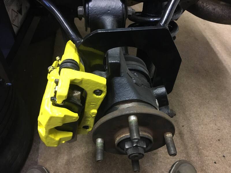

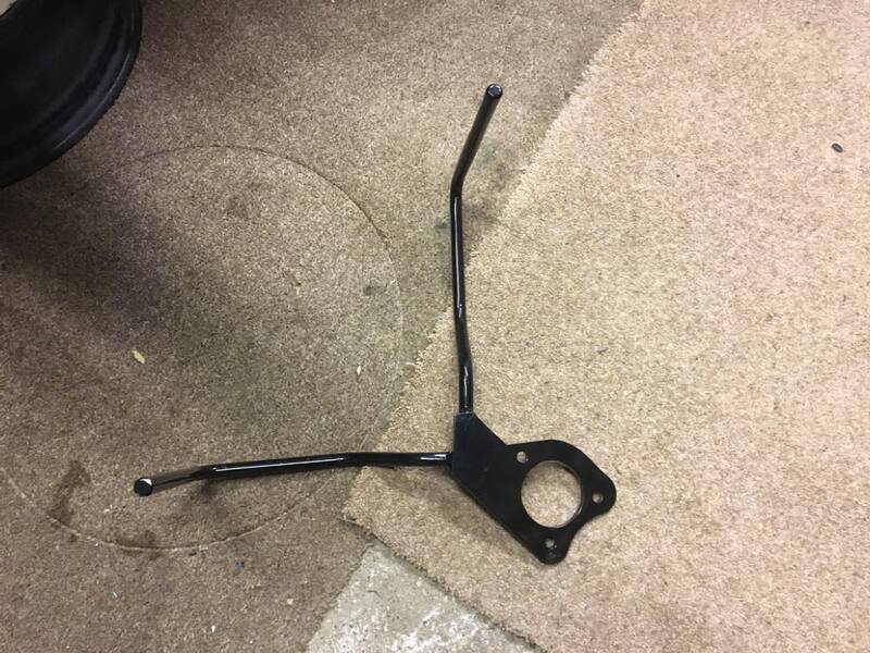

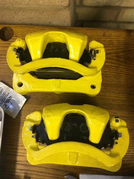

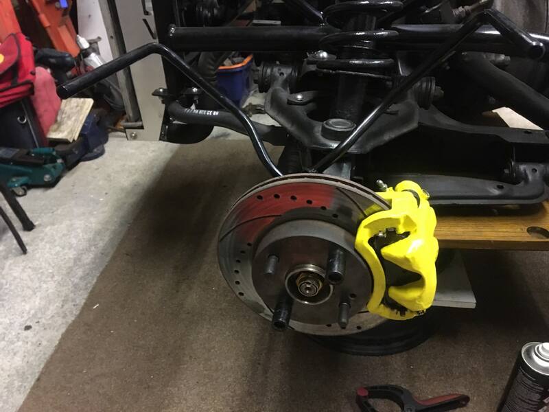

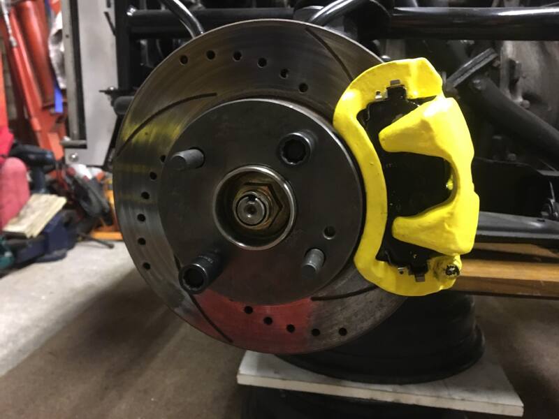

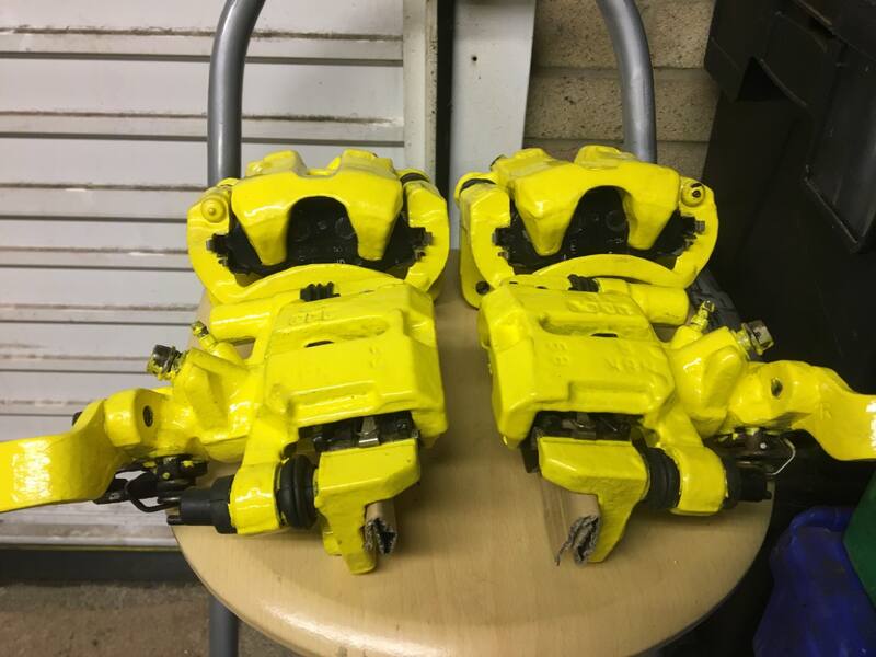

the reason for fitting the mudguard brackets is so I can finally get some brakes on this thing
the discs and pads that came off the donner were pretty recent so I'll reuse them for now, everything got a good clean up and was reassembled ready to fit
still regretting yellow but it's too late now :(
but they do look pretty good fitted
I know they'll be minging by the time i even get to the test centre, obviously i'll have to bed them in  :)

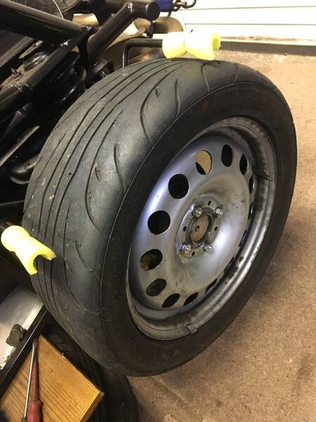

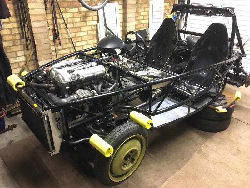

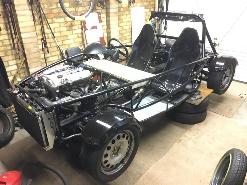

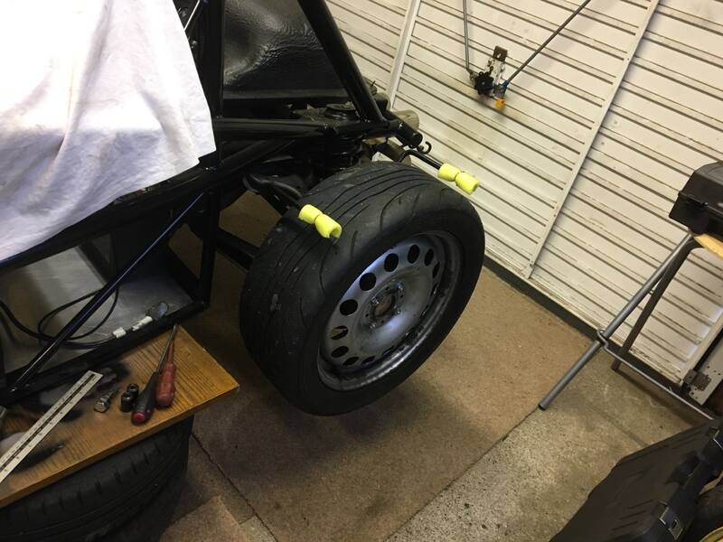

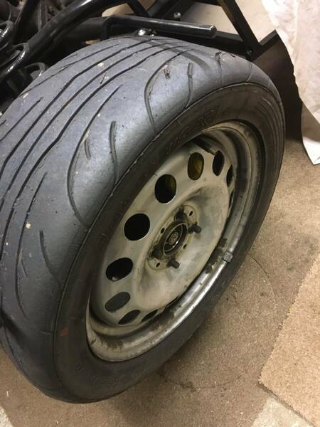

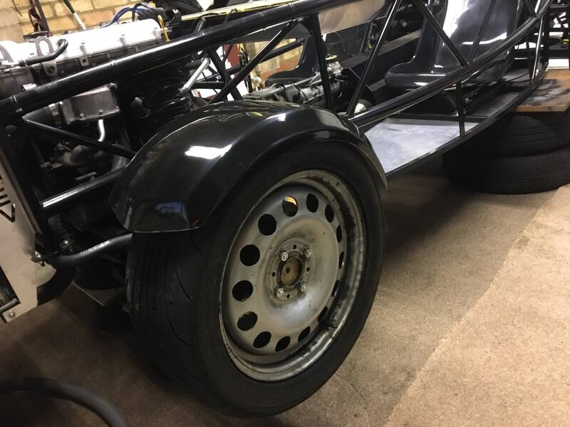

so lets bung the wheels on and see how she looks
hmm, something not right here
oh for cocks sake
curse you, stupid high offset wheels - more £££ needing spent on spacers :(
perhaps my maiden voyage is doomed to be made on Timmy wheels
(note : yellow foam padding preventing those mudguard brackets from stabbing me in the 'nads (again))

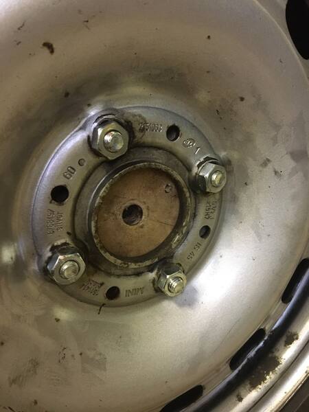

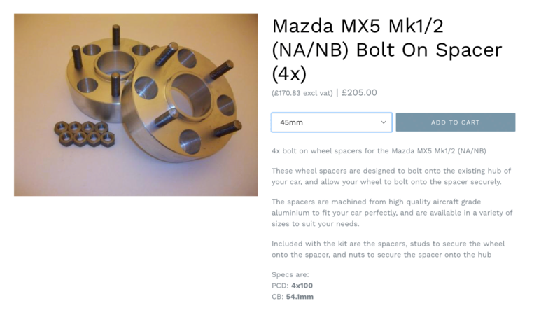

I've been planning to use bini steelies on the exo to keep costs down (and I like the look of them)
but it would appear that I need to fit wheel spacers
^&^*^%^&^*^ing how much ?
1091569165_ScreenShot2020-11-13at22_53_16.thumb.png.3288d4aaec51c7153f57b9d57ad3c31f.png
might be time for a plan B :(

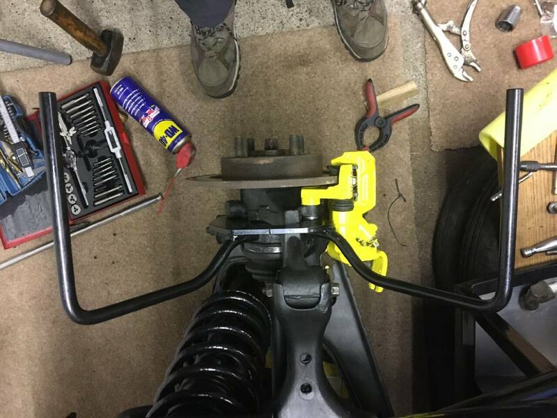

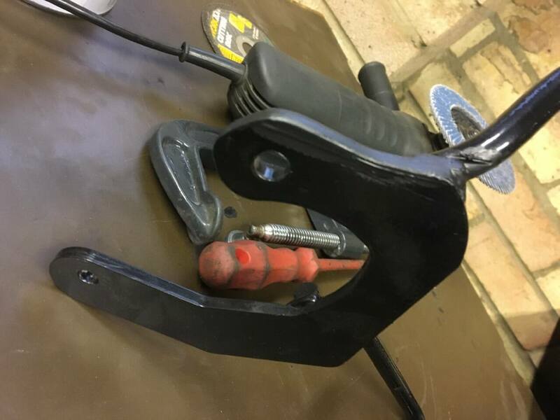

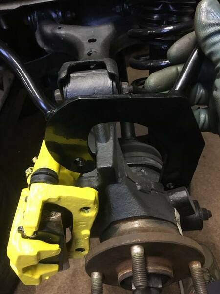

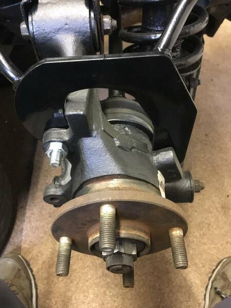

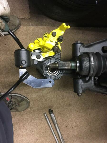

time for a look at the back brakes - let's see if this is any easier ?
as with the front, the mudguard brackets need to be fitted at the same time as they share a mounting point with the calliper frame. the other side needs a hole drilling in a handy bit of casting on the the hub
easy enough so far but bring the calliper into the equation and they are fighting for space
time for the grinder again
a quick dab of chassis paint and you'd never know :)
that'll do (none of this would be necessary if I'd upgraded to the larger 1.8 callipers but the build fund is currently low and there is nothing wrong with these 1.6 brakes)

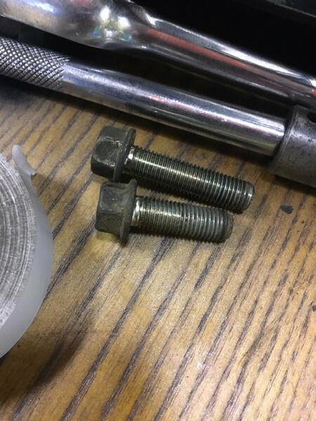

we're also going to need a longer bolt, my policy of not chucking anything away paid dividends here as the former power steering pump bolt is the perfect size)

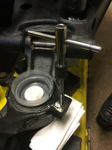

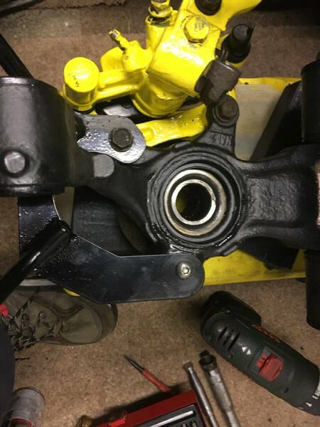

so that's one end of the bracket fixed, how about the other
I need to drill a hole through that random lump sticking out the side - the hub is in the way to the front and the shock at the rear :(
thankfully, I hadn't torqued these hub nuts yet
now a hole for a nut and bolt would be adequate but I'm feeling ambitious today - let's have a go with that tap & die set I got for Christmas ten years ago and haven't used
with a good bit of wd40 in lieu of cutting oil I cut my first thread (plastic tub is to protect the bearing from swarf)
nice and straight, very satisfying

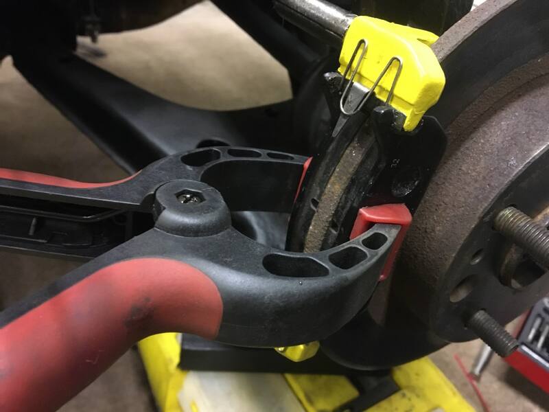

and after years of fighting with those stupid pad springs, I discovered an oh so simple solution - just clamp the pads in place and you no longer need four hands :)
just the other side to do and we've another job ticked off the list

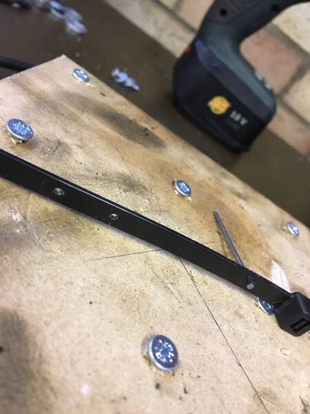

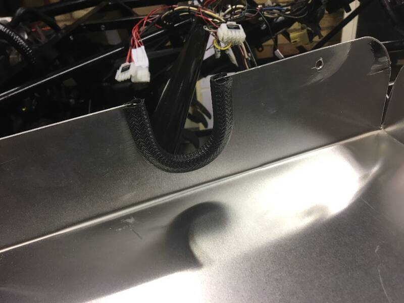

I had an offset of perspex lying around so made a lid for the wiring tray - it certainly tidies everything up but might need a lick of paint (can you paint perspex?)
the bonnet will cover it once fitted anyway
Managed to dig the spacers out this afternoon...they’re 20mm thick.
Any use?
They might work with the alloys off the mx5, I’ll check what the offset is and get back to you, thankyou
apparently I need to have between 0 and 10 offset to clear the mudguards so if the alloys are 30 or less, they would be ideal
I think we have few sets of 14 inch daisy wheels, a steel Bini wheels and I have got the white enkeis on the turbo if any of them work?
The daisies are about the lightest you can get, no?
there is a set of 14" enkeis that came on a few limited edition imports that are even lighter than daisies - I used to have a set on my current mx5 but sold them when I fitted the mk2 alloys :( ideally I'll stick with 15"ers as the tyre choice is a bit better, if I do go for spacers then I can swap road & track wheels between the two cars (although I can't imagine I'll be taking the mx5 on track much once the exo is finished)
https://www.miata.net/faq/wheel_weights.html
(edit) it looks like 40-45 is fairly standard for a Mazda offset so unless I go for aftermarket wheels, I'll be on spacers anyway

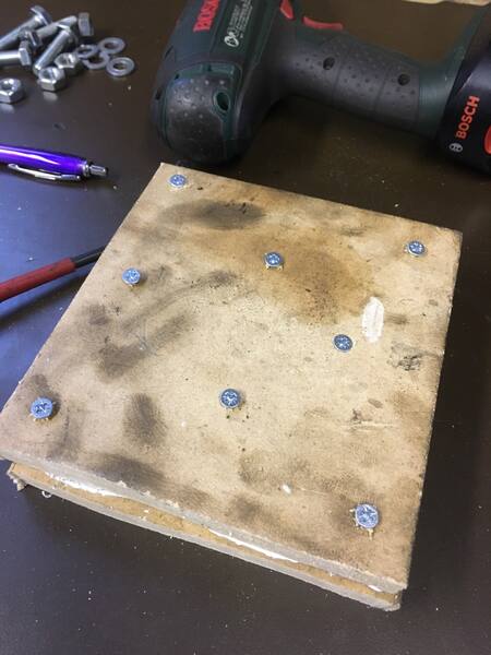

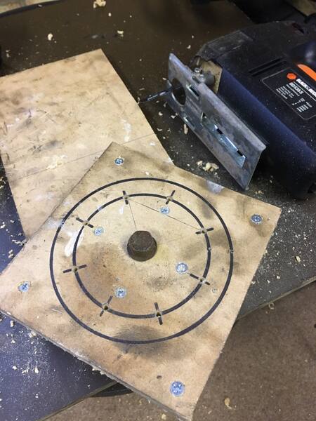

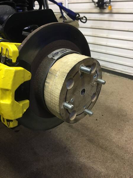

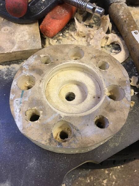

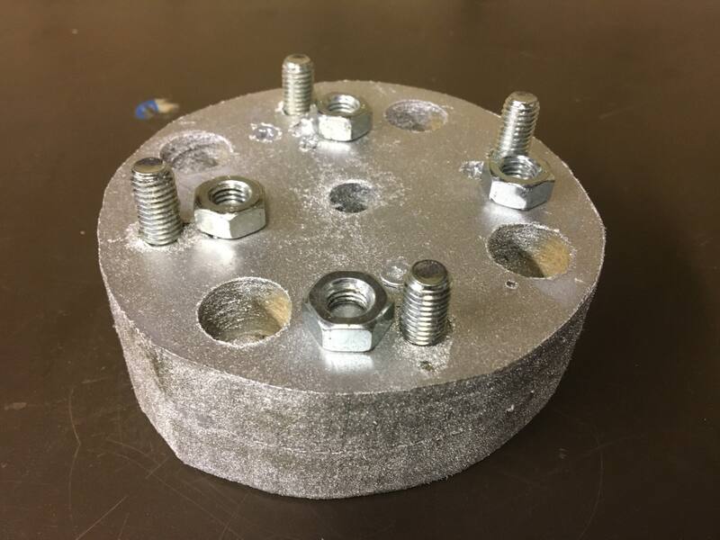

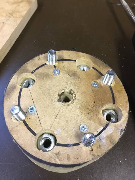

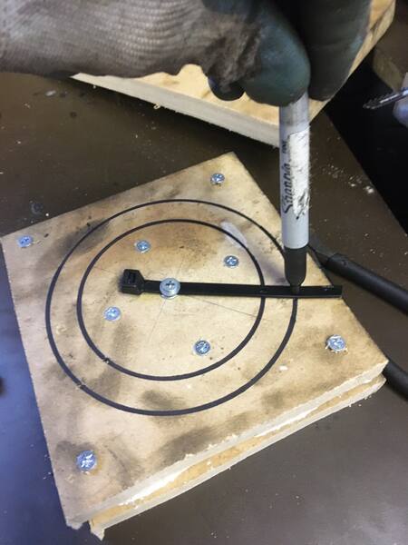

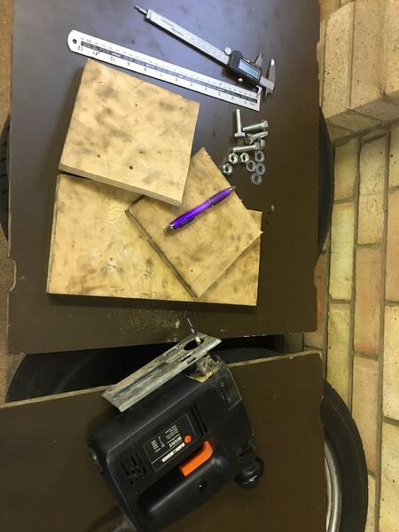

Right then, time for a bit of problem solving :
It would appear that in order to fit my wheels of choice, some sort of spacer is required. But how big ? Rough calculations guesswork suggests 40mm might be appropriate - let's have a look and see if it will work out
I'm sure I could have just done a bit of careful measuring but where's the fun in that when you've got POWATOOLZ :)
No need for a commentary here, enjoy !
So 40mm is ideal, I might even get away with 35mm - the smaller, the better as it's  all additional unsprung weight

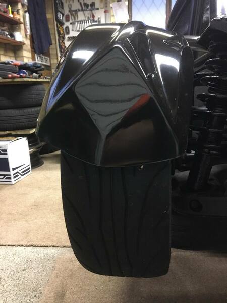

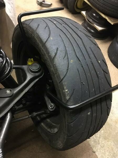

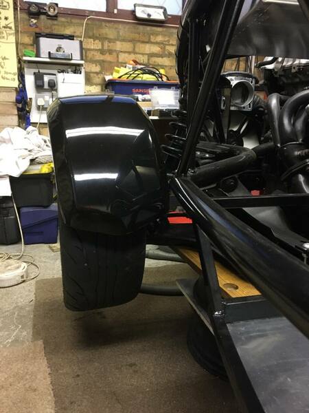

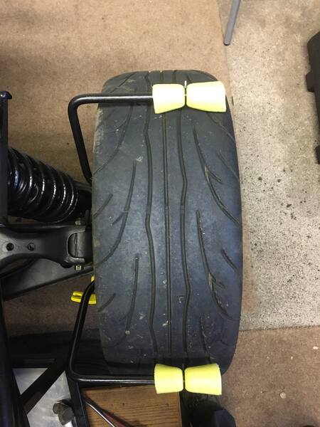

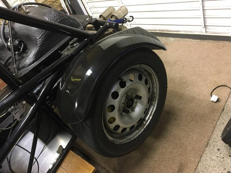

a quick trial fit of the mudguards - how dreadfully shit do these look :(
they’ll be getting shoved back in the spare room until it’s absolutely necessary to fit them
They do look nasty to be fair.
Could you take a glass fibre mould off an old tyre?
Or shape some alloy sheet ?
Maybe some funky graphics cut in vinyl ? Not really too much of a concern just now as it’s still miles away from being finished :(
All of the panels are in black gel coat so I can add graphics and / or colour easily t any time - I had a random thought about a yellow camo design ? we’ll see how it looks when it’s done :)
