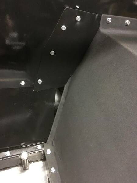

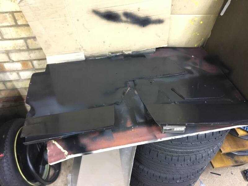

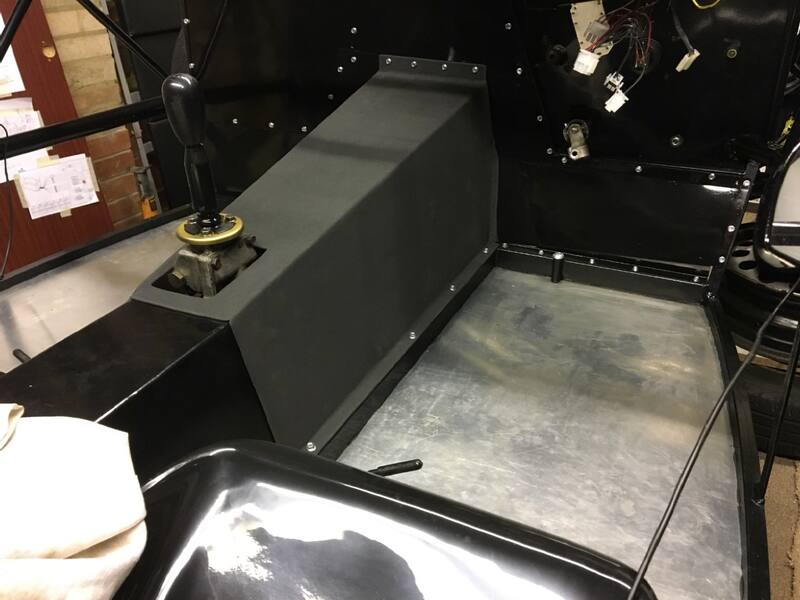

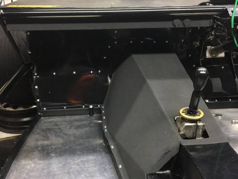

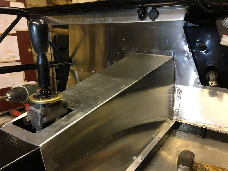

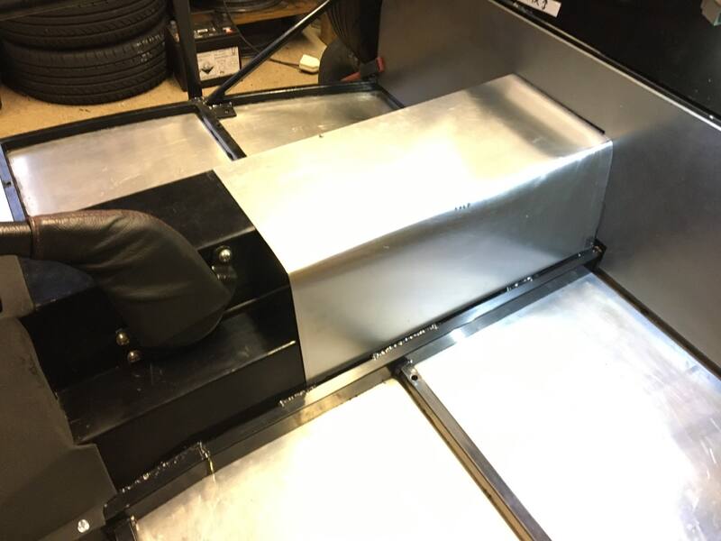

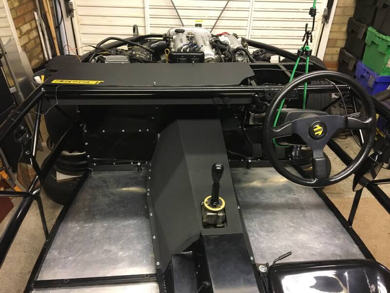

the centre tunnel was a piggy to fit, lots of chopping and bending required but it eventually was almost in the right place
shame about these little gaps
I made up a patch of that corner then got busy with the rattle cans

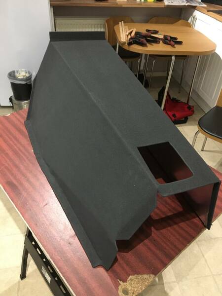

plain paint will never do for the centre tunnel, I opted for a sheet of neoprene rubber off that ebay
the kitchen is perhaps not the best place to be using spray on contact adhesive but it was too windy outside and the garage is a mess
turned out pretty smart though
everything fitted back in place
wait a minute, how did that gap get there ?
looks like some fanny trimmed the wrong edge :(
time for another patch panel
but overall, I'm pleased with how that turned out
I'm in two minds about doing the floor with textured rubber mat, might be too dark ?
need some sort of gear shift gaiter too, the original one is too short as the stick sticks up higher than in the mx5 centre tunnel

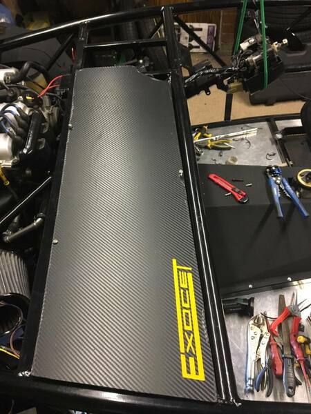

that plain jane wiring tray needed a bit of a make over too
"this is glue, strong stuff"
I made an absolute balls of my first attempt - put a big crease right along the middle of the facia - so tried to gently peel the foam off
this did not go well. tempers were lost. much swearing was involved.
the rubber tore in shreds, using a sharp scraper and copious amounts of pain thinners I eventually got it all off - but with all the glue and thinners, I was high as a kite :(
a very careful second attempt was made
got me usb's fitted
and trimmed the edges to keep mr iva happy
looks pretty smart

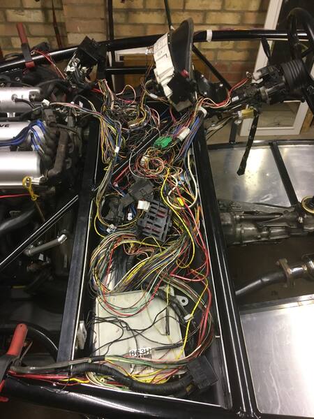

but an empty wiring tray is no good to anyone
way back in November, there was this nightmare of a mess
by December things had 'improved'
but it was finally time to get the loom tape out and finish this
not the neatest but (and this is a very big butt) everything still works :)
bung the lid on and call it job done !

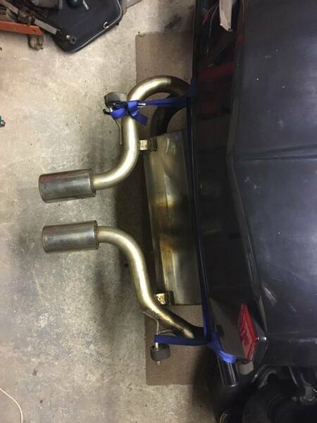

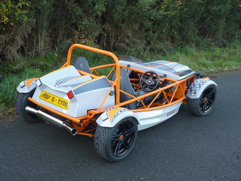

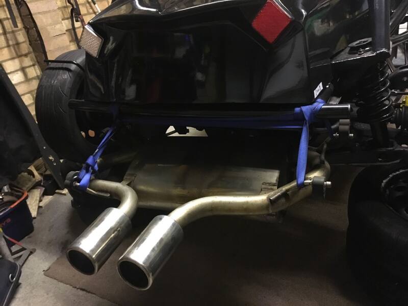

it's time to start thinking about exhaust options
the official Exocet (iva compliant) one looks like this...
i.e.. a bit shit :(
my current set up looks like this...
a bit mental :)
but not a chance of an iva . shame, it sounds great
the official exhaust isn't cheap at £250 -  I do not want to spend £££ on something I don't like - I'm hoping someone on the owners forum might have one on a shelf in a shed somewhere I can buy cheap or borrow for a few weeks.
this - or find a second hand something that fits in the space and mounts easy sos you can take it off then put the mahoosive fart cannon on it :D

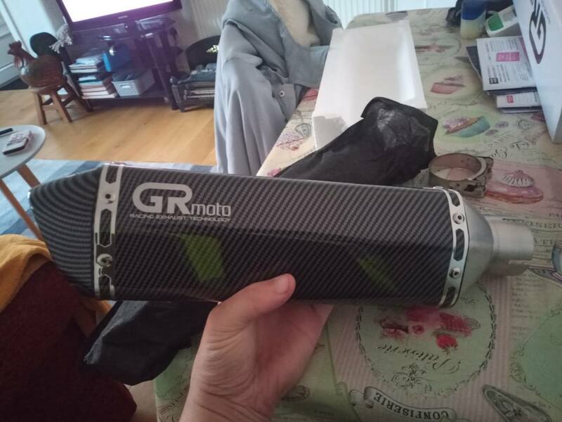

would it fit ? presumably off some sort of fancy bike - needs to be under the noise limit for iva too :(
fancy bike - lmfaooooooo
it has a baffle in it (not took it out not fitted it yet)

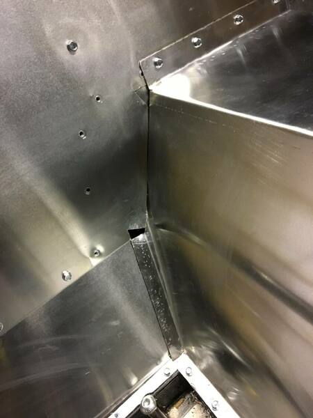

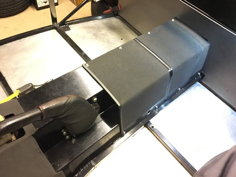

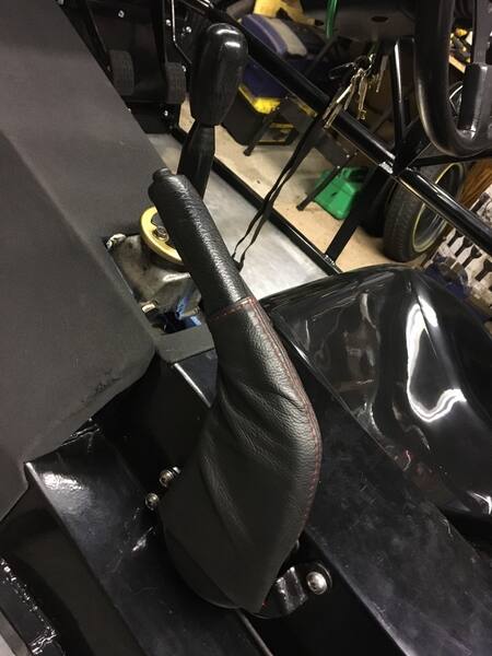

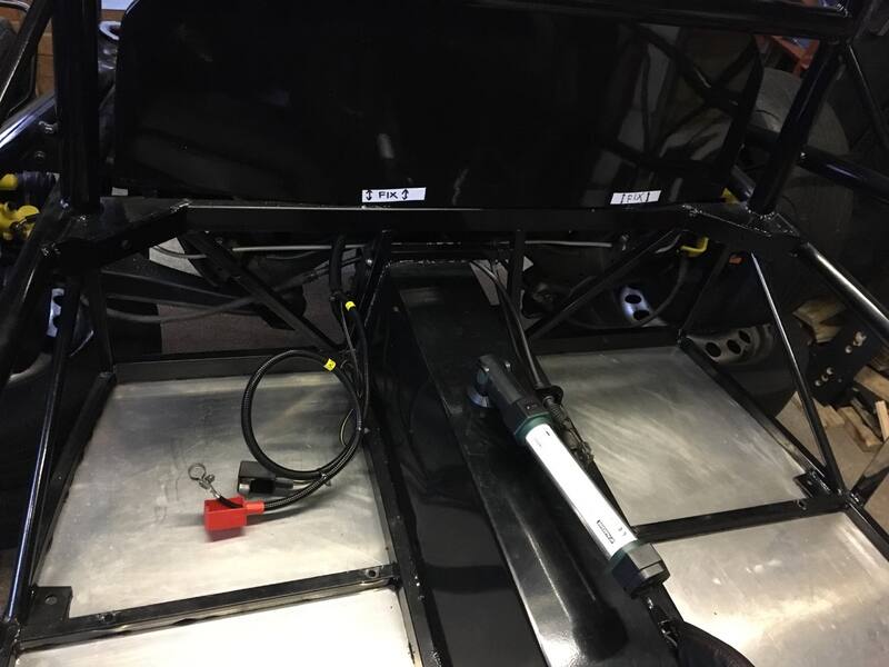

Handbrake re-fitted and adjusted
not the easiest to tighten the nuts under the centre tunnel but got there in the end.

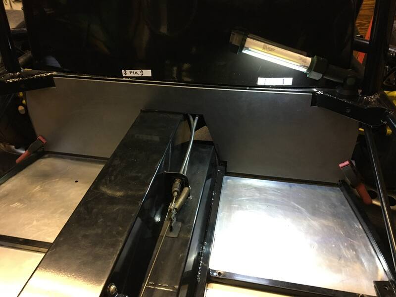

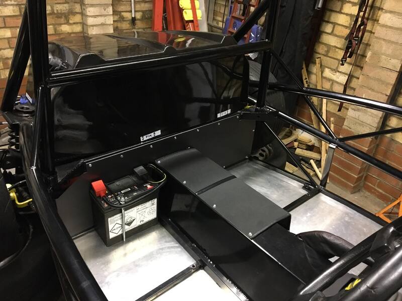

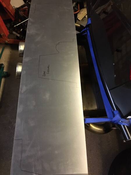

Rear panel next - this is the "template" provided with the kit, I might just check those measurements before cutting  :)
needs cut to fit round the centre tunnel, cut outs for battery cables and handbrake required
not too bad, but those handbrake cables are looking very exposed there

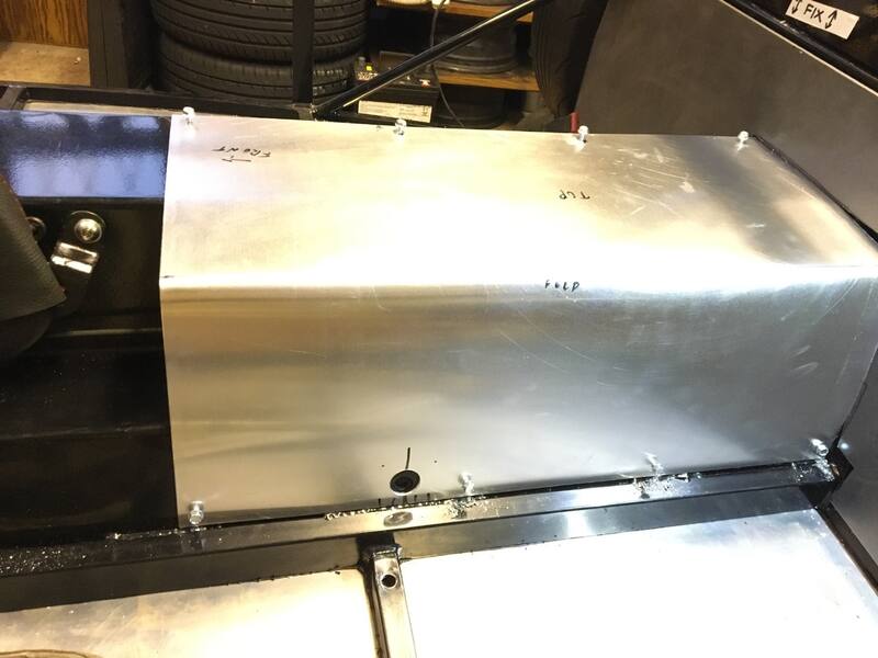

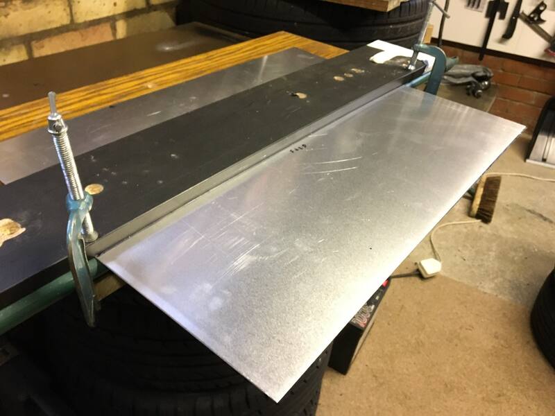

The kit doesn't include a handbrake cover so it's time to get creative
broom handle employed to get a nice smooth bend
quick test fit
quite happy with that, even remembered to make wee hole for the seatbelt mount
with a bit of luck, I might just have an off cut of that neoprene sheet left
hmm, two small bits or wait another week and order a new sheet ?
Wait a week ? I don't think so :)
battery cables shortened, battery reinstalled
rear panel screwed in place, things are really coming together now

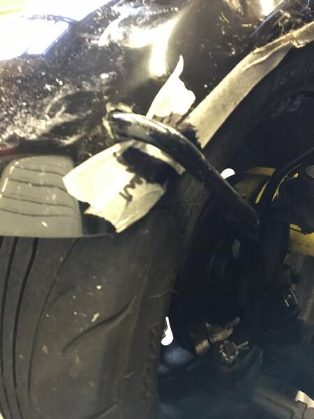

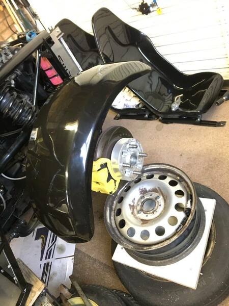

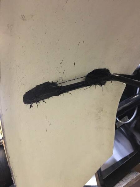

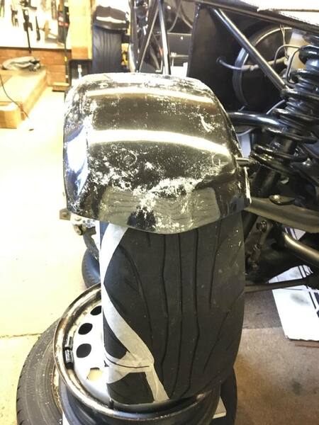

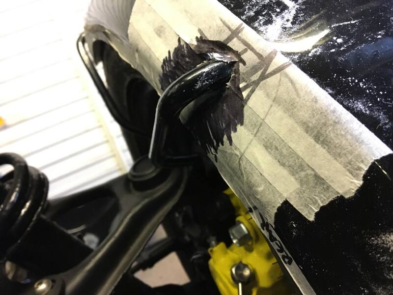

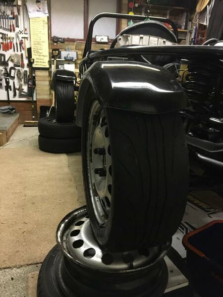

time to get those mudguards fitted
the regs are quite specific :
how in spuds name am I supposed to measure those angles ? I haven't used a protractor since I left school :(
once again, time to get creative
which led to
100% compliance assured :)

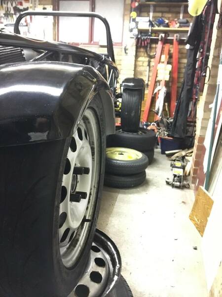

holes were drilled
but that wheel is horribly off centre
 tickled with the jigsaw
and a couple of drops of clag
that'll do
four corners all done
and an up to date plan view

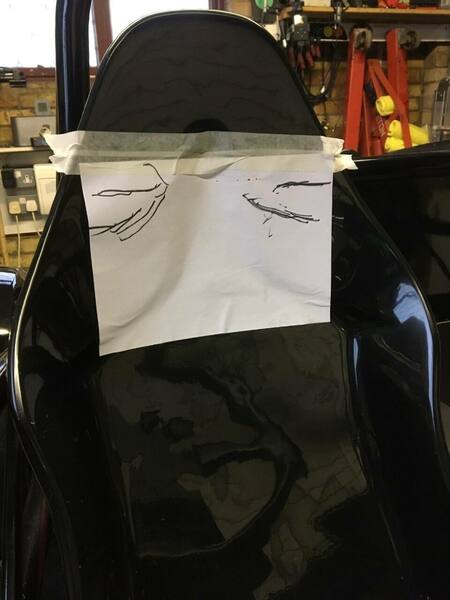

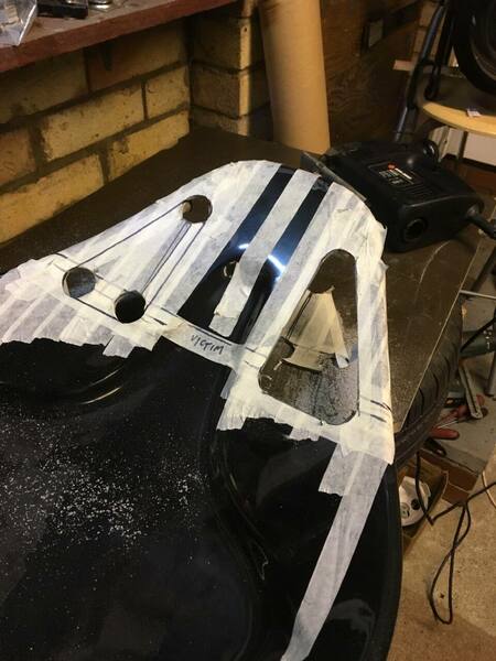

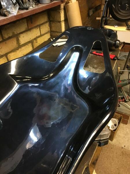

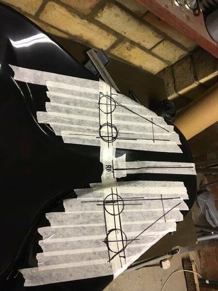

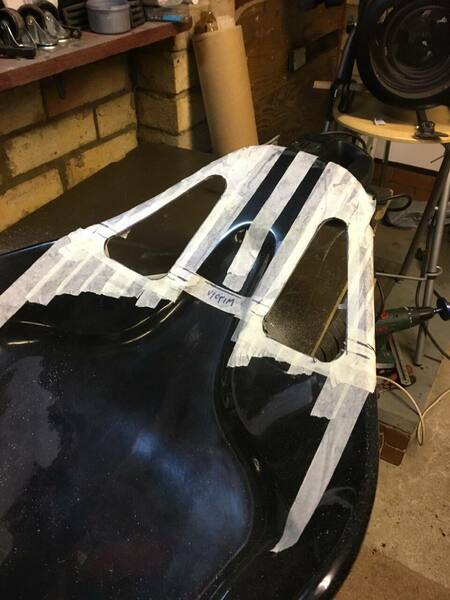

a bit of work on the seats today
first off - what the hell is all this about ?
'tis the result of this nonsense

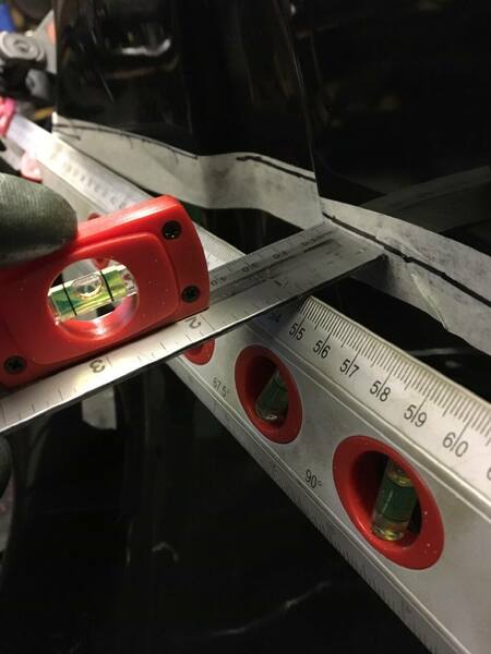

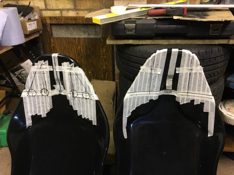

I needed to figure out where to cut the holes for the harnesses
an unbelievable amount of fannying on with spirit levels, rulers, bits of tape, more spirit levels, more bits of tape etc. was required.
got there eventually
I drove myself crackers trying to get both seats marked up the same, it turns out the passenger seat is 2cm wider than the drivers - very confusing :(

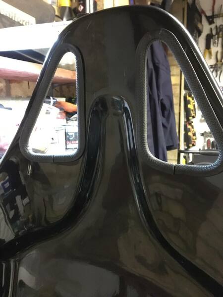

time to drill some holes
then get the trusty jigsaw out
repeat as necessary
off with the tape and let's see
hmm, a bit rough
no matter, that's what edge trim is for :)
back in the car and looking good
