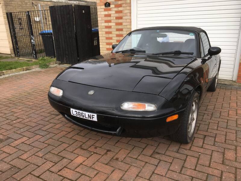

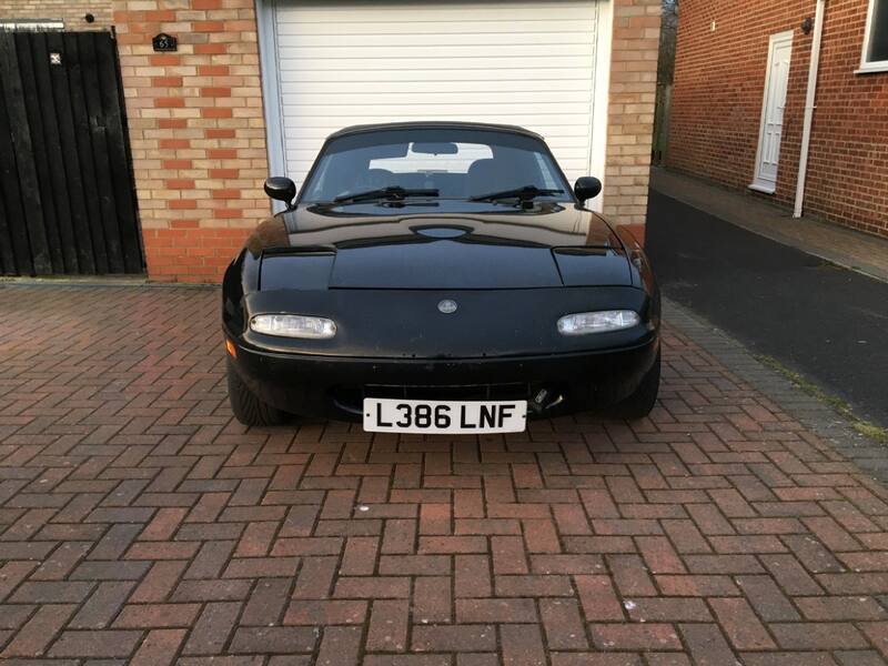

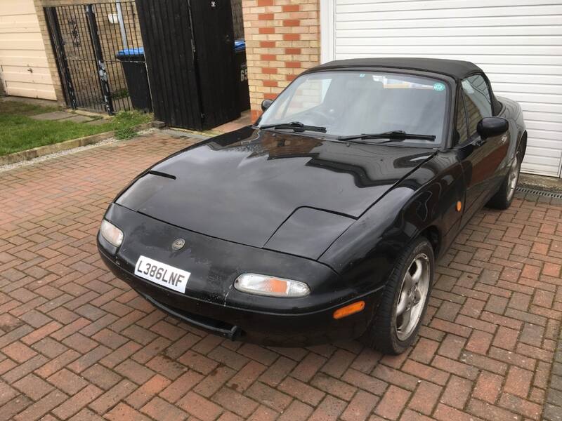

As the cracked number plate had been flagged up on the mot, I thought I would do something about it.
I replaced it with an illegal stick on plate  :)
looked a bit crap on the 'nose'
looks better on the front
but definitely too wee - I'll probably order a full size sticker, this one is taking the piss for sure !
(how empty does that drive look :( )
least you can read it
not like its in the window like a fkin audi :)
you might get a tug but i doubt it
cos import techincally the back isnt correct either :D :P

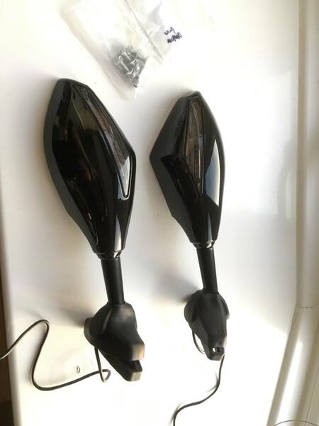

for far too long, the wing mirrors have been held on with cable ties - the reason being that I really don't want to be drilling into the (structural) side tubes to bolt them on
so a bit of ebaying occurred and I now have the same type of mirrors but with a threaded fitting plus brackets to clamp to the frame.
much better
I am clearly pleased with my new mirrors (although it may look like I am straining for a dump in a bucket)

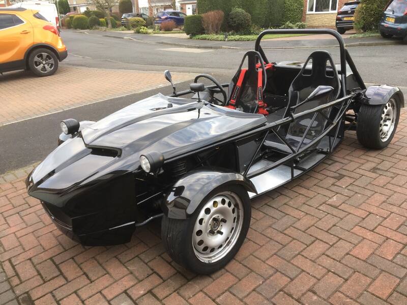

took it outside for photies
that one in the middle really is pish though

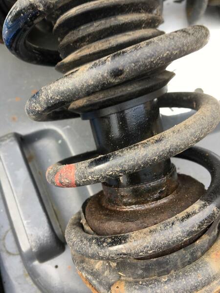

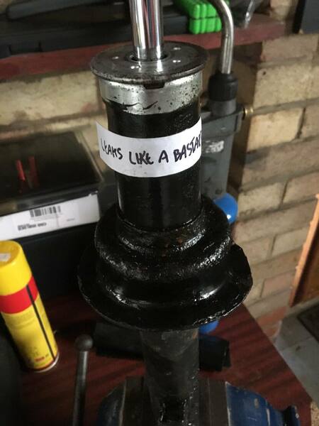

The leaky shock reported on the mx5 was found to be rather leaky indeed.
I swapped both sides over just in case.

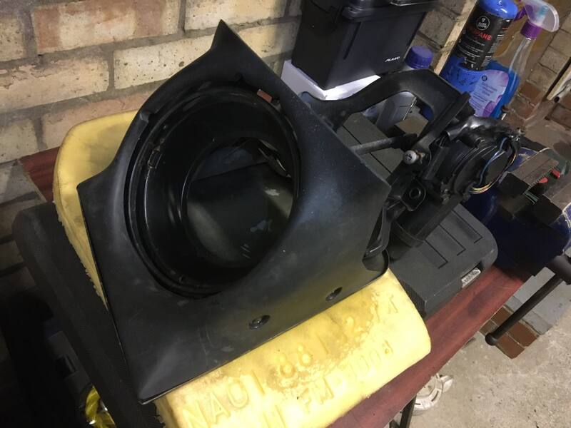

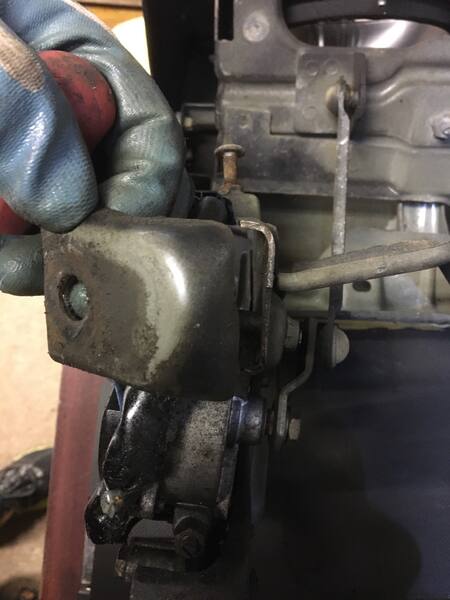

then turned my attention to something that had been bugging me for a long time - the passenger side headlight had a bit of a wobble, no matter how tight I fastened the bolts.
A little investigation found the issue - one of the brackets had sheared right through so the whole headlight assembly was only fixed in two places.

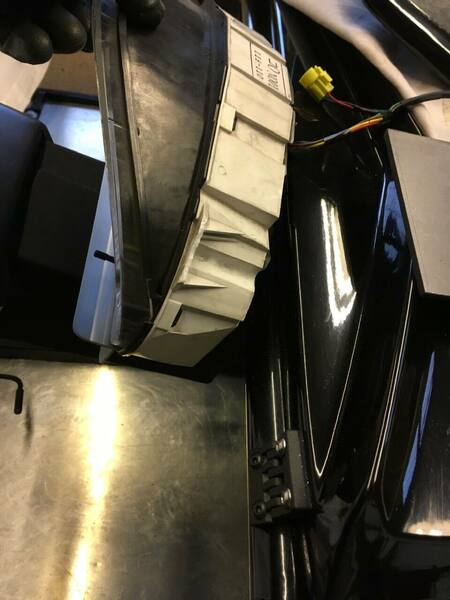

fortunately, when I stripped the donor car, the headlights did not sell.
so it was a fairly easy job to whip the old one out
and bung a new one in.
I made a half arsed attempt at aligning the beam by marking the old one on the garage door before removing it, would probably have been easier if I’d parked further away.
All sorted, only been broken for about four years !

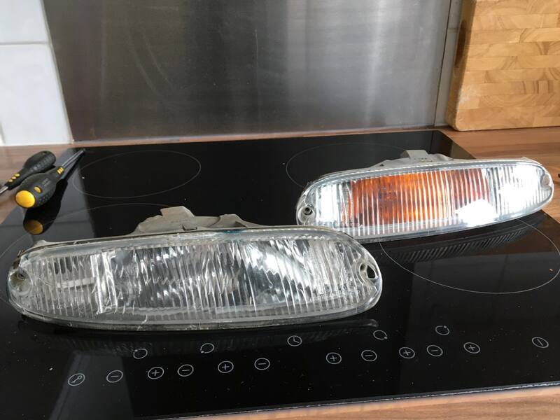

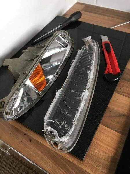

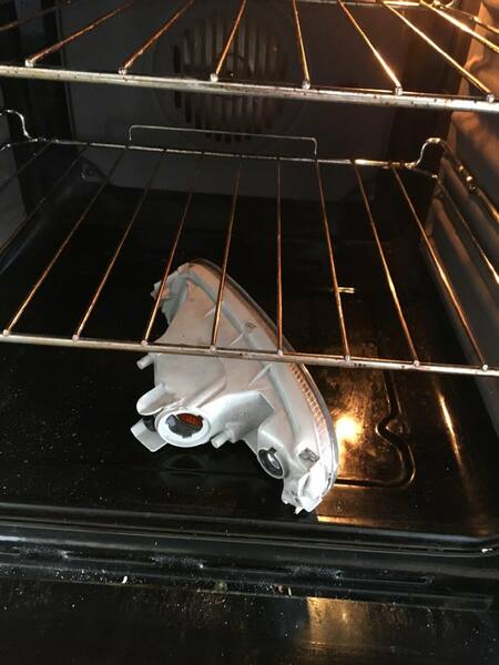

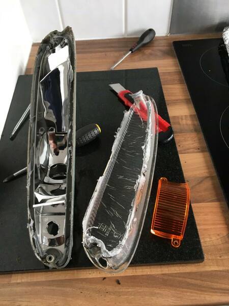

then whipped out the sidelights and bunged them in the oven
which softened the gluey stuff enough to prise them apart
ping out the orange lens
reheat and stick back together
silver (orange) bulbs fitted - looks pretty smart

remember last week when I swapped over this leaky shock absorber on the mx5 ?
now guess what I swapped it for ?
yep, a different, even more leaky, shock absorber
ha ! won't make that mistake again :)

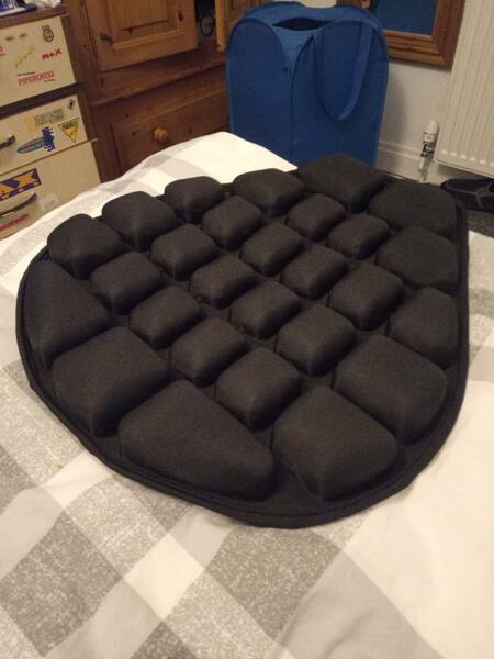

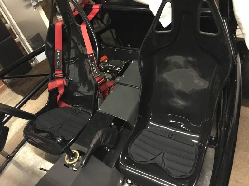

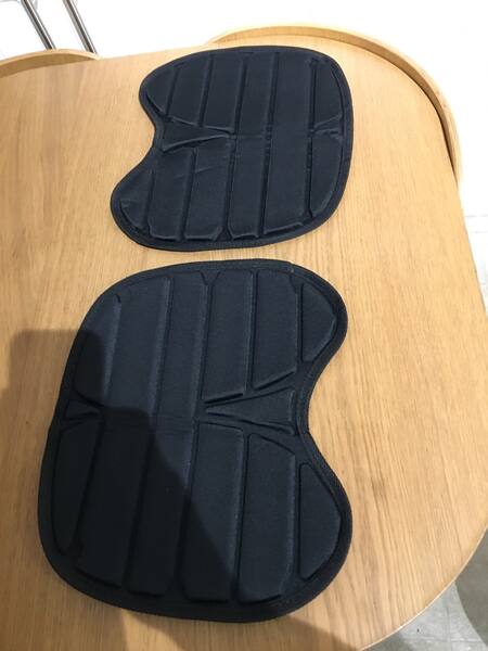

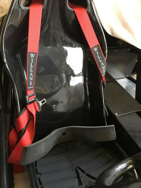

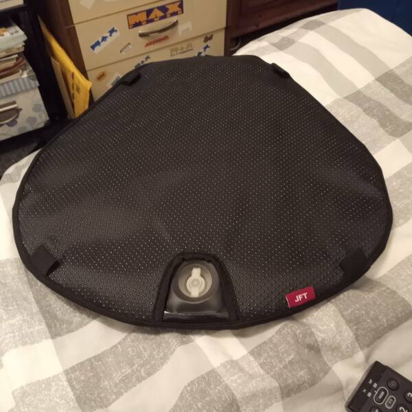

You need one of these
Real airhawk can be hundreds
Knock off one from wish 14 delivered can fill with water (reewww) or blow it up
Comes with strap so you could put holes in seat and strap it down

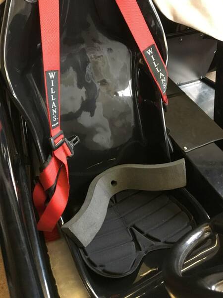

1 hour ago, gm said:
foam padding -
it occurred to me where I'd seen this before - at a go kart track in San Antonio, Ibiza (I was young once, honest) where they provided such protection for the drivers, presumably as they were all pissed / hungover / off their box on disco biscuits ! (I was pissed / hungover before you ask)
there was a bar at the track and no one seemed to care if you had a few beers between karting sessions :)

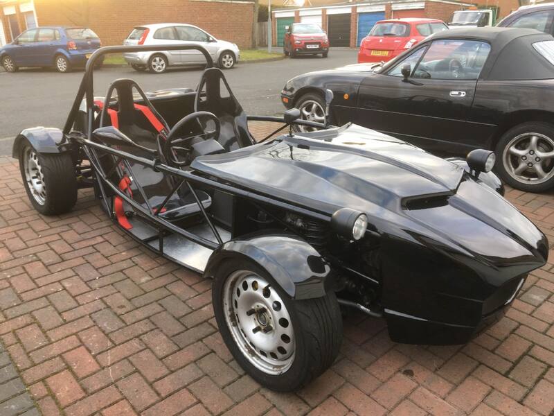

Great to finally meet up with Mark today and see the Exocet in the flesh.  To  be honest the pictures and build story on here do not do justice to the job that Mark has done on this car. The build quality and attention to detail is second to none. The cut down wiring loom (usually a mess on kit cars) is a work of art. Hope to see this out and about soon.
I'm really impressed with the work you've done

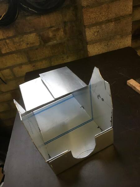

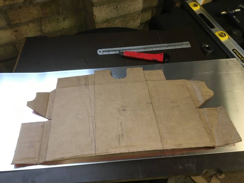

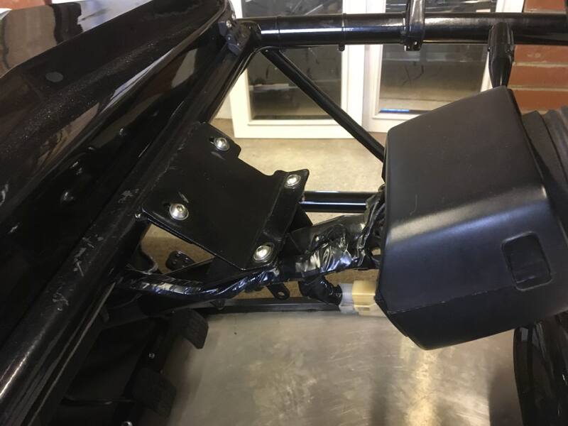

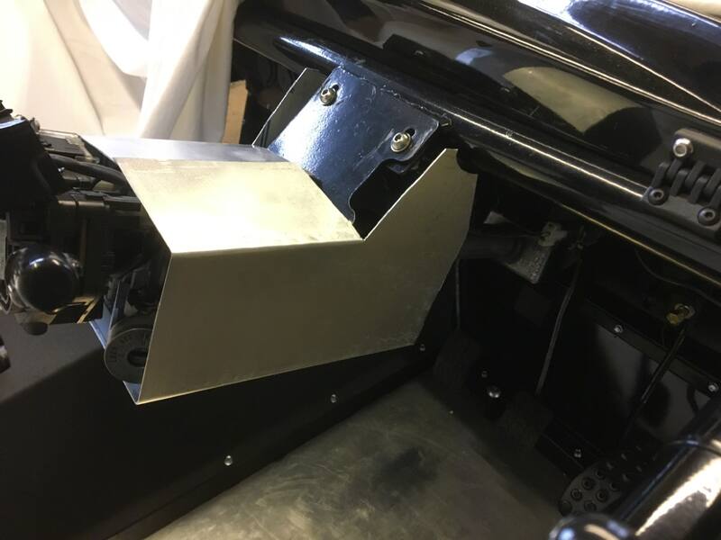

way back in February, I pondered what to do about covering the rather exposed ignition wiring ?
a solution was found :)
but was deemed to be a bit too much of a bodge
then I saw what another exo builder had done
169976450_4204393256289299_3485971493146845884_n.thumb.jpg.1fcbec699d2d0b14ea9fbf392a329cc0.jpg

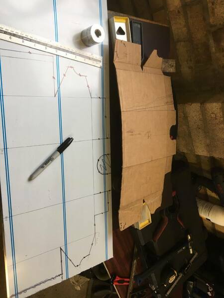

that looks just the job - I'll have a go at making the same

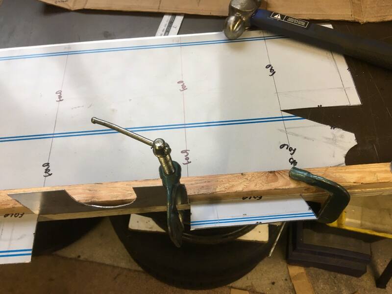

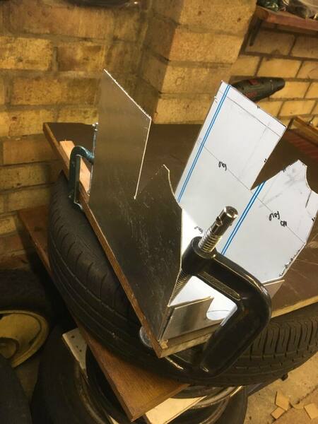

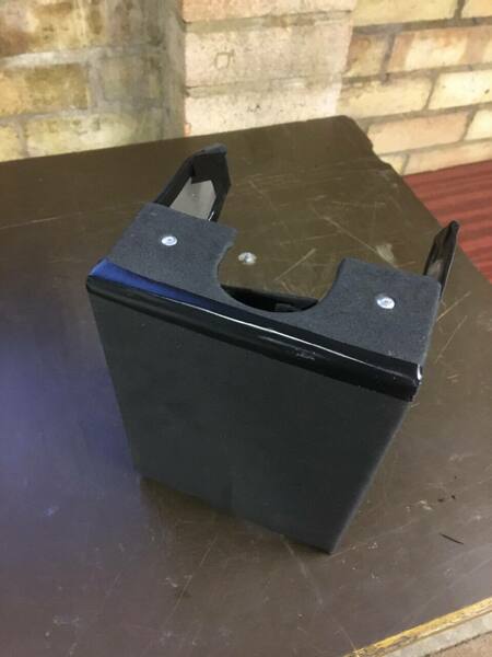

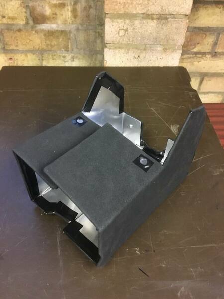

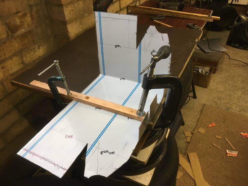

cardboard was fettled
transferred to 1mm aluminium
cut out with me granda's old jigsaw
and bending commenced
at which point, I discovered I should have paid more attention at Bending School
as I quickly realised that I was bending in the wrong direction :(
the shape is almost symmetrical so I just chopped a bit off the other side and carried on
glad I was only using thin aluminium
test fit
not bad, just needs a bit* of a trim
(I'll spare you the hours of trimming and refitting, not to mention the increasingly bad language - I had to switch from Pink Floyd to Metallica to drown out my frustration)

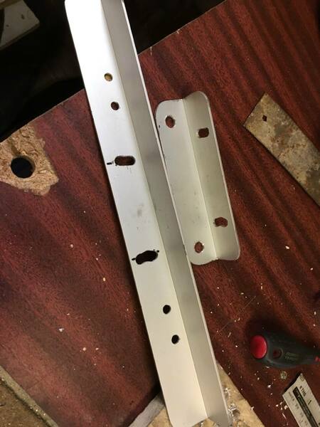

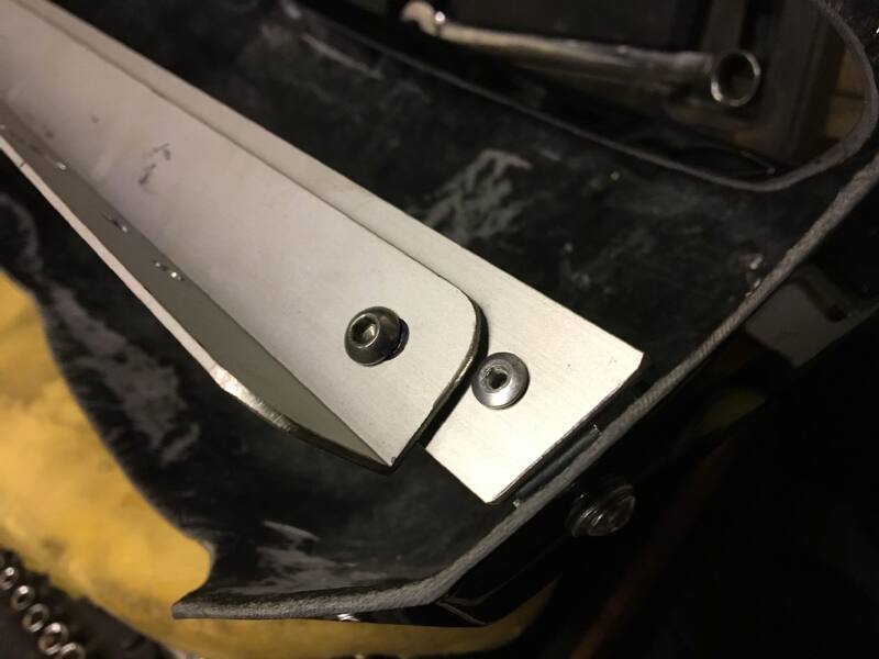

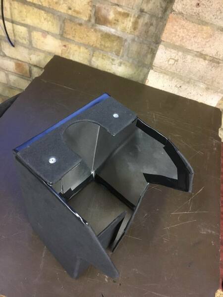

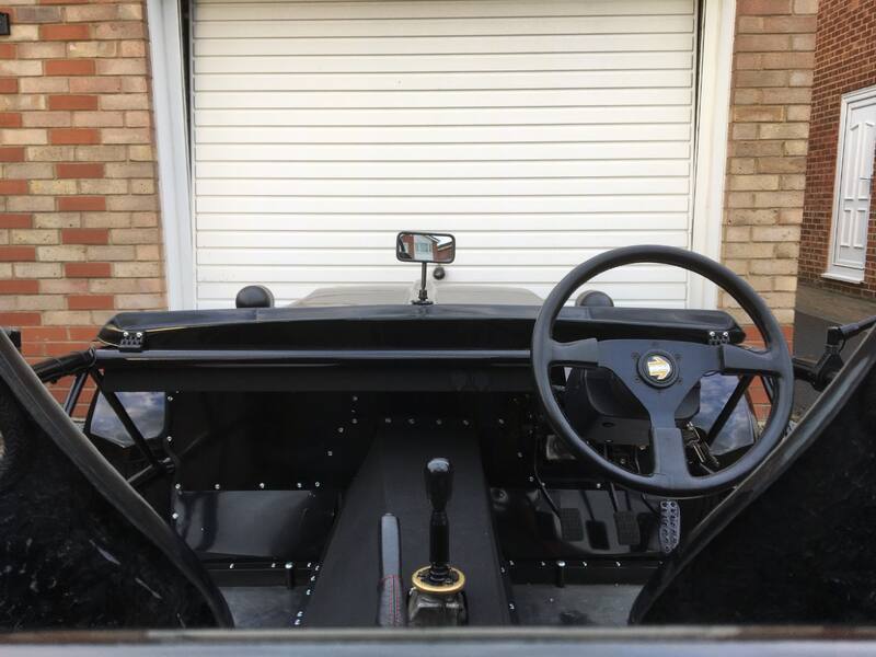

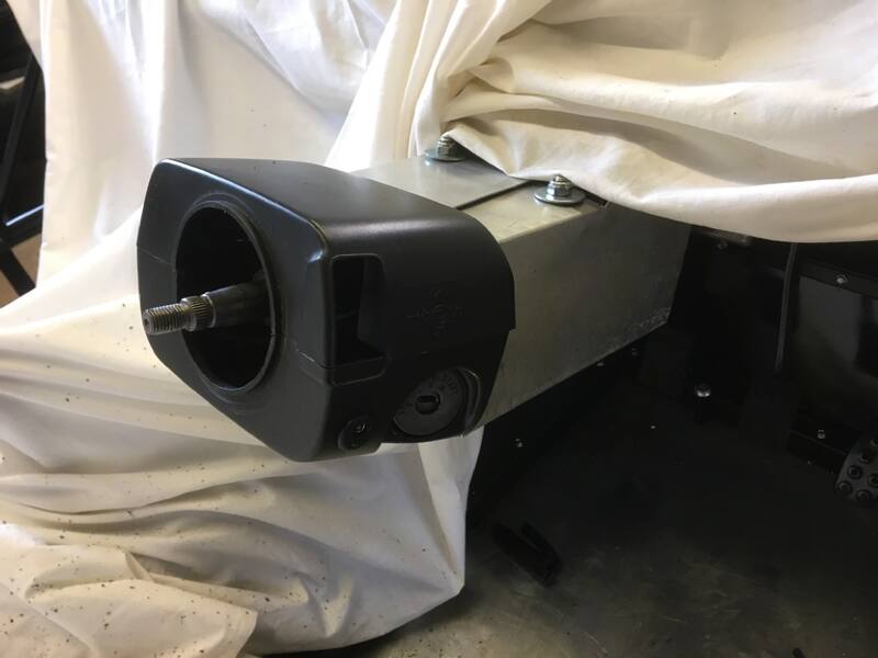

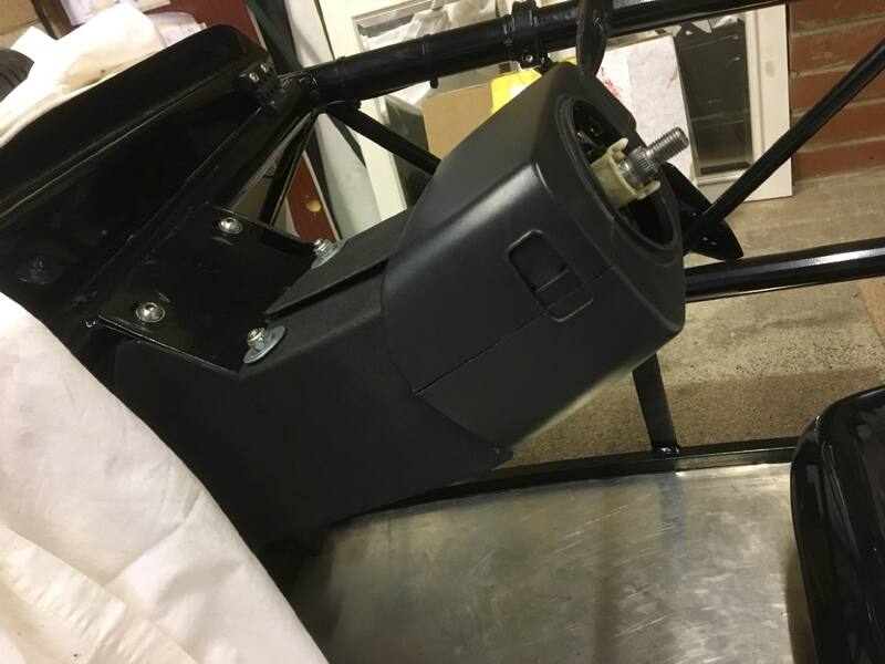

the bolts it will fit to will also hold the speedo cluster so longer bolts or thinner nuts were needed - a tickle with the grinder had that sorted
then the plastic shroud needed chopping to fit
again, took a while but turned out ok
time to cover up the rough finish with my favourite neoprene foam sheet
that actually looks pretty smart now :)
still a small gap at the join but the instrument pod will cover that no problem
another job ticked off the list - everything seems to take so long at this stage

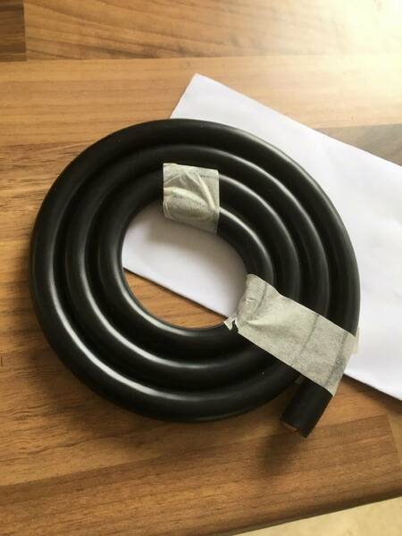

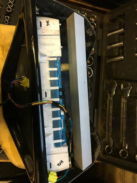

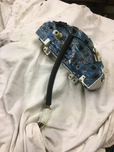

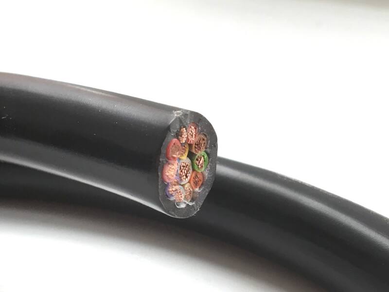

todays job is to extend the instrument cluster cable which I cut too short :(
in preparation, I ordered up a metre of fancy cable
hellfire - that's going to be fun to work on ! 13 cores :(

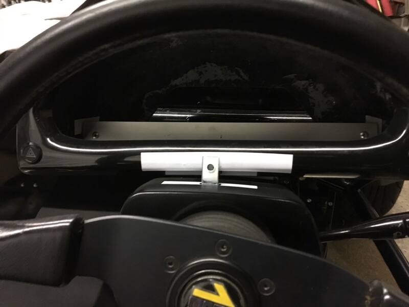

sod that ! I'm not some sort of electrical masochist - it can wait

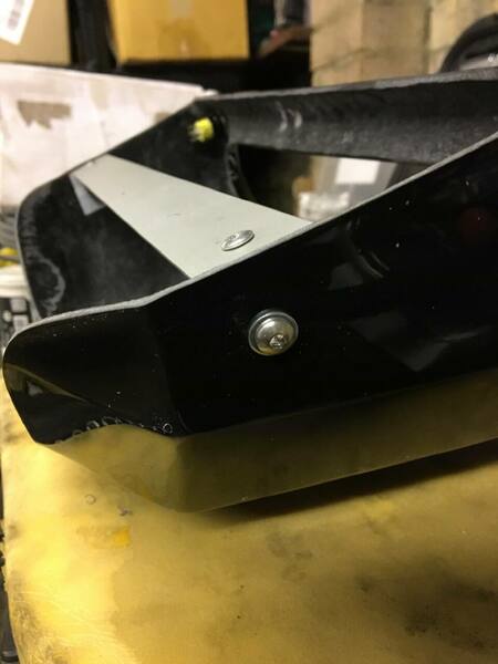

instead, I nipped out to the local diy place (maxwells in Birtley, not been there before but will go back, much better than b&q etc) and grabbed a few bits

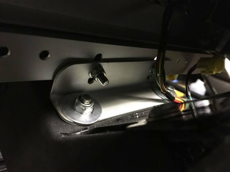

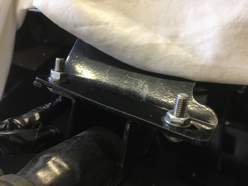

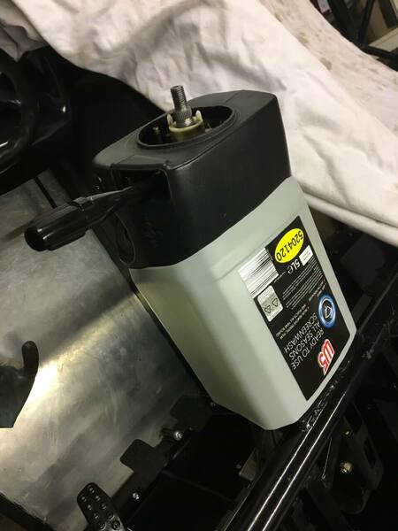

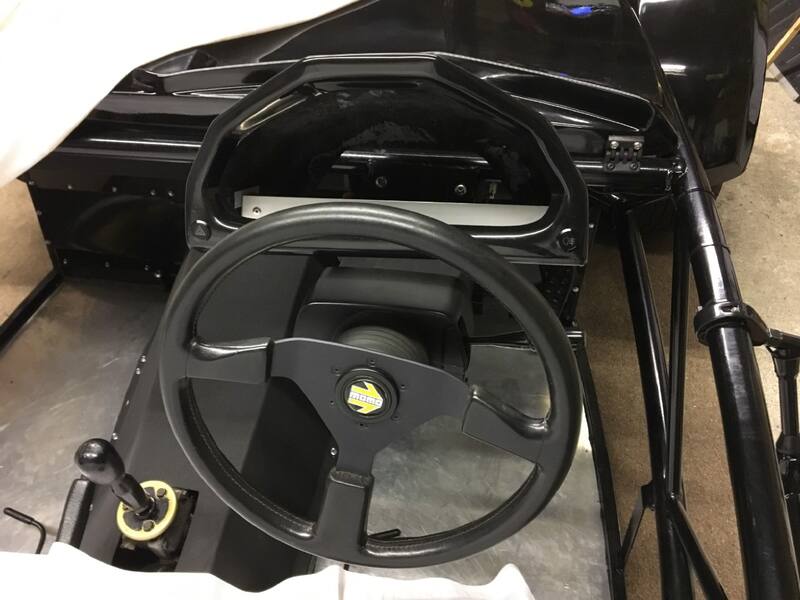

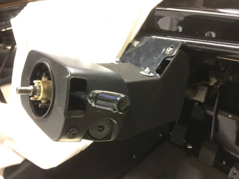

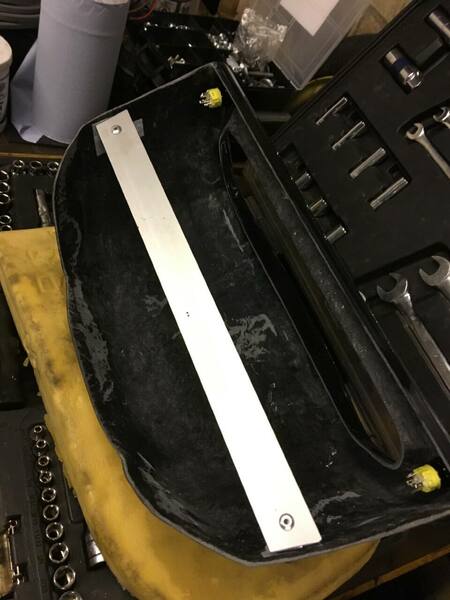

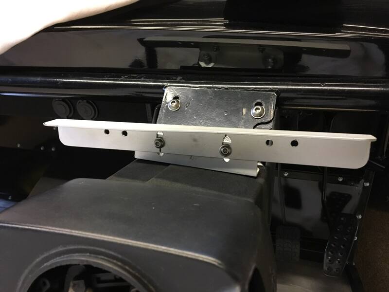

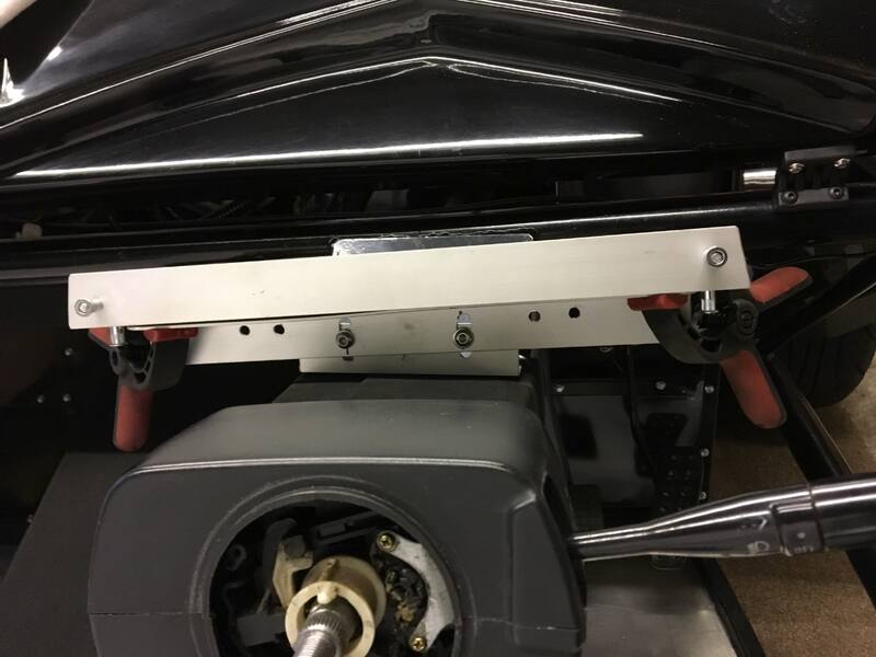

remember those bolts sticking up from the column shroud ?
well, we're going to need something to bolt onto them

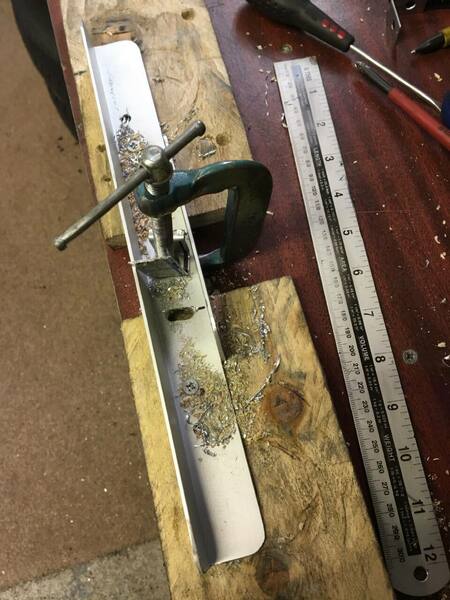

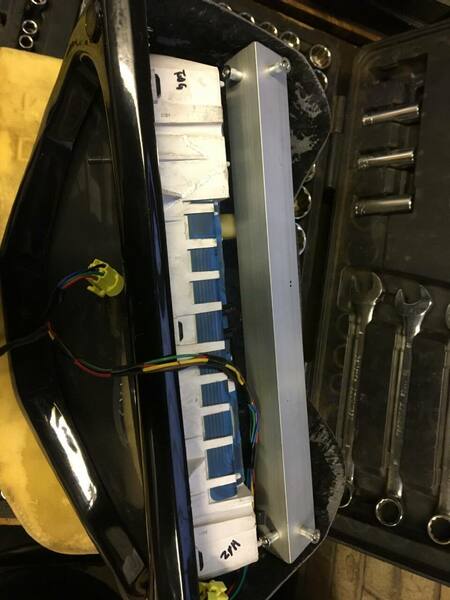

chop, drill, grind etc
I don't think much of my "milling drill bits" that I got from lidls, definitely not* operator error to blame for those wonky slots
quick test fit

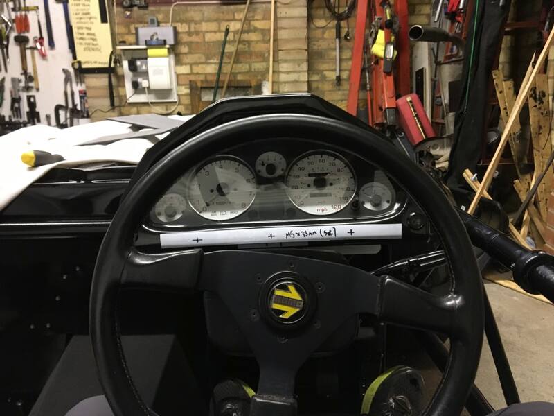

and the clocks are way too close to the bonnet :(
time for a rethink

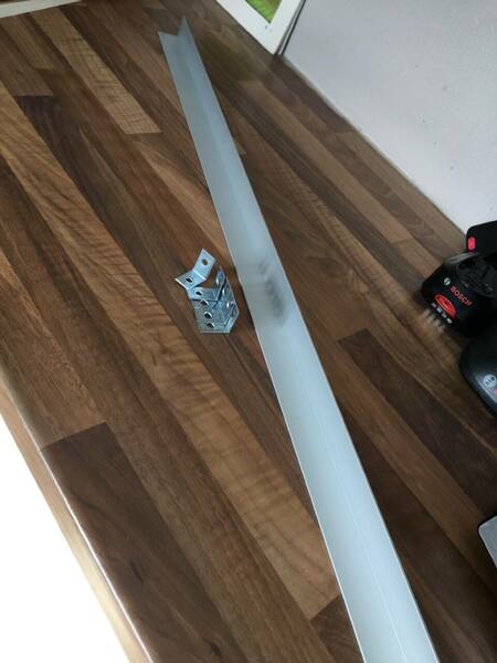

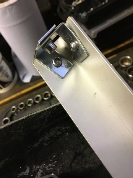

a spare bit of angle iron aluminium caught my eye

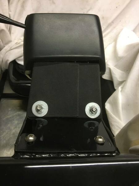

how about instead of bolting directly to the cluster, I bolt to the cover instead  ?

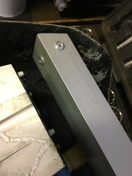

more chopping, shaping and drilling (I had no spare M5 nuts so rivets will do temporarily)
test fit - aye, that might work
rivets and bolts replaced by proper rivets (using all my fancy tools today)
what's on the other side ? yep, another rivnut ( I like these now, hated them at first but they are handy)
so the hood will bolt on here and be easily removable if needed
I'm pretty pleased with that - fits well and I didn't break anything :)

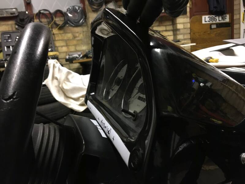

how does it look on the car ?
works for me :)
more drilling and rivnutting and the two brackets fit nicely together
it will need something at the front to minimise wobble
let's bung the dials in and see how it looks
needs a tweak of adjustment, they're pointing a bit higher than I'd like
but that will be easily fixed with an offcut to extend the bracket underneath
that was a job I'd been dreading and I'm rather satisfied with tonights progress - time for a celebratory beer :) cheers !
