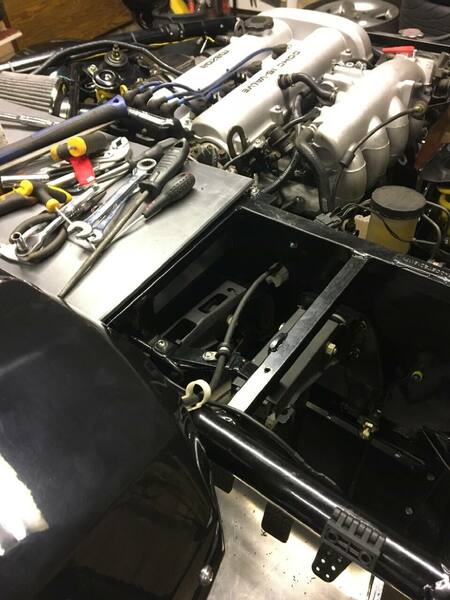

which seems like a good excuse to post this pic again
I've used that trick loads on 4x4s and works very well.

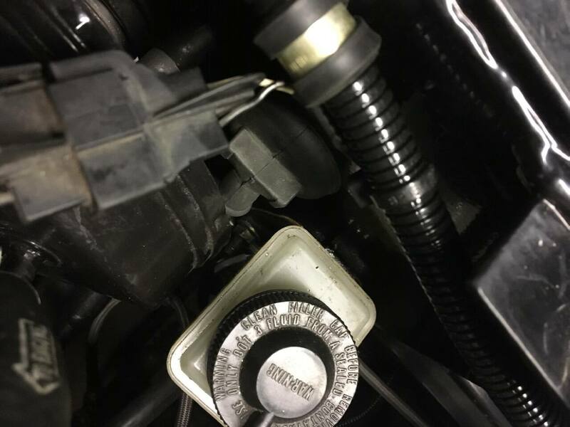

a post appeared on a local mx5 fb group with a member offering some parts before he took them to the tip
183414194_10165092495320181_350304435036169029_n.thumb.jpg.53fc90da48a19c00705d899f03b12e86.jpg
I couldn't believe my eyes !

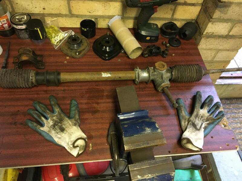

that is a mk1 manual steering rack - not very common at all - which would be perfect for the Exo. I currently have a de-powered steering rack fitted which is ok but the ratio on a manual rack is a much better option.
I sent a message straight away, attaching a pic of the exo to grab his attention and promising to bring a box of beers with me !
It worked and I arranged to nip down to Teeside yesterday afternoon and pick it up - One thing I hadn't counted on was it still having the hubs attached which made it rather awkward to bundle into the mx5.

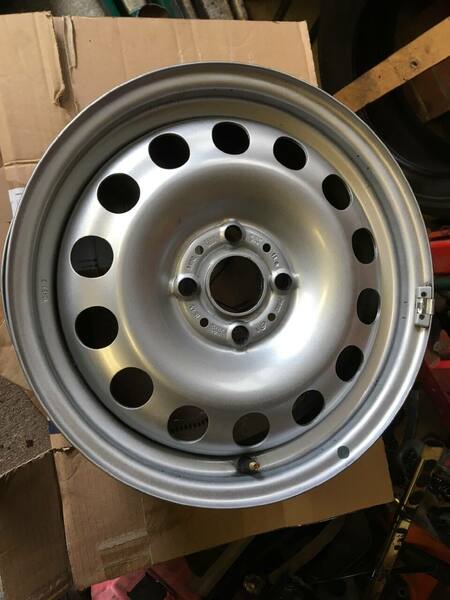

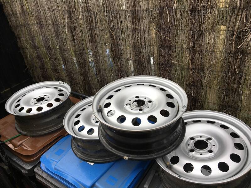

As I was heading that direction, I made an offer on a set of steelies I'd been watching on marketplace. These were also squeezed into the mx5 and brought home safe.
Keen readers will know that I already own several (four actually) sets of Bini steelies, one set of which was due to go for powder coating to become the main set of Exo wheels - no need for expensive powder coating when I have this set of delivery mileage beauties ready for tyre fitting next week :)
there are a few tiny marks but I'm happy with that

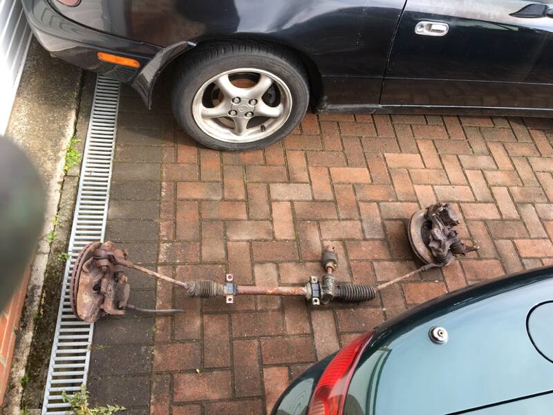

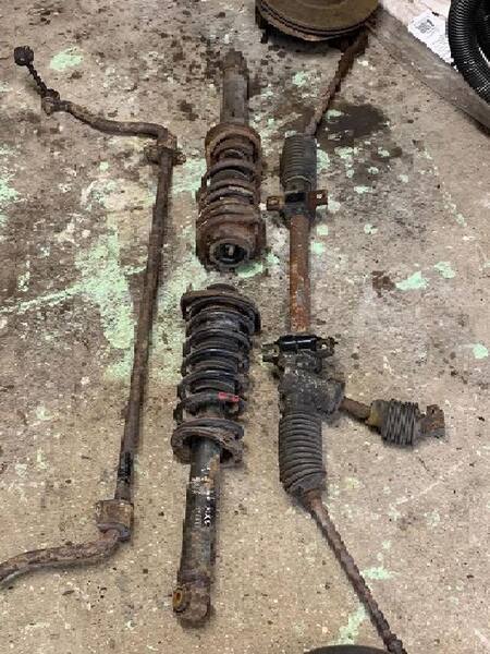

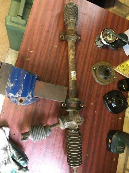

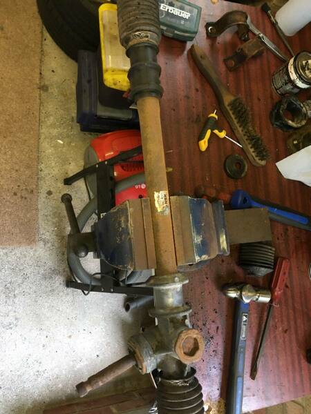

as for that steering rack, it might need a bit* of work before fitting
a quick going over with a wire brush and it shows potential
looks better already (excuse the accidental jazz hands)
I'll give it a proper clean up and paint during the week and order new tie rods & ends

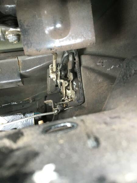

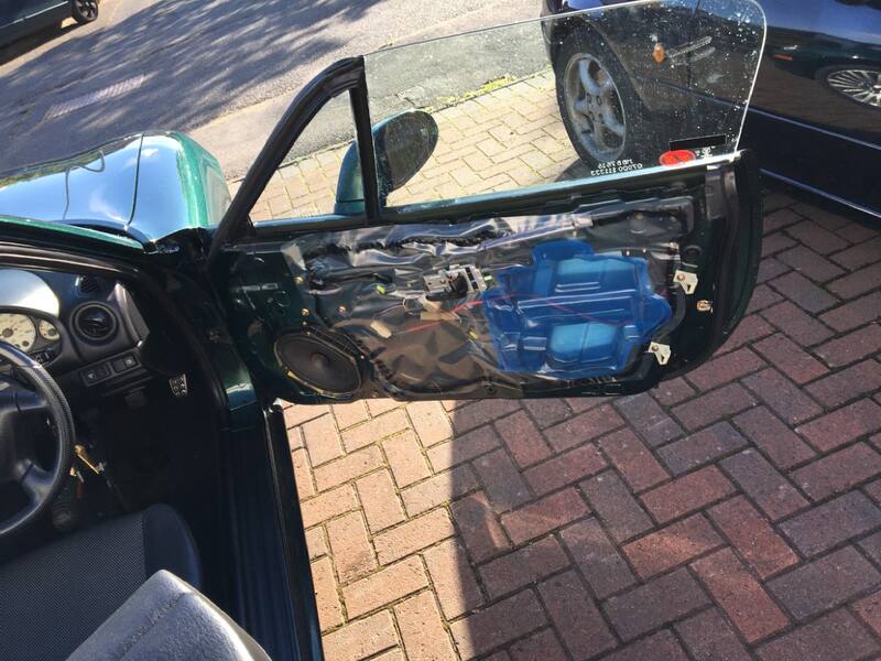

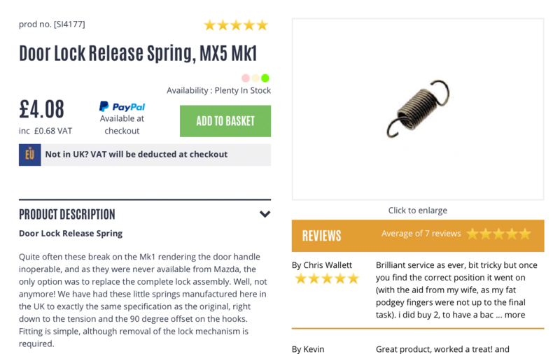

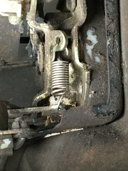

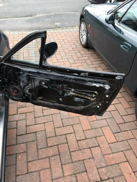

when I got home last night, I plipped the fob to lock the mk1 and heard a not good noise from somewhere inside the door
a tentative pull on the handle revealed something was indeed buggered - no matter how many times I plipped the button or tried the key, the drivers door would not unlock :(
going in from the passenger side didn't help either - only one thing for it - things need to come to bits

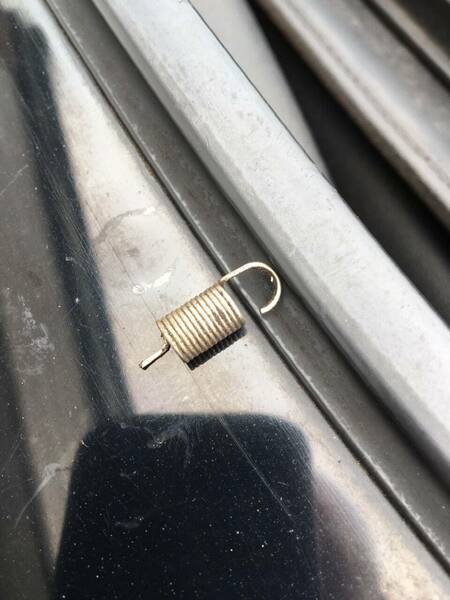

dropping the window allowed me to see what is going on - right in the middle of the pic, you might just make out "that bloody spring"
a common problem with mk1 mx5s, albeit one I've been lucky to avoid so far.
a bit of poking around with a wire coat hanger I keep for such emergencies got the door open, it was then a case of taking out the window glass and runner to retrieve this little bugger
and where exactly am I supposed to get one of these late on a Sunday afternoon ?
and also, where is it supposed to go back ?
I bent the end into a new hook, had a poke around and the job's a good 'un !
a quick test and it's working perfectly. result.
I managed to get the glass and (freshly greased) runners in and the door back together just before it started thoroughly pissing it down :)
And I saved £4.08 (didn't need to remove the lock either)

 I've had a fairly productive couple of days

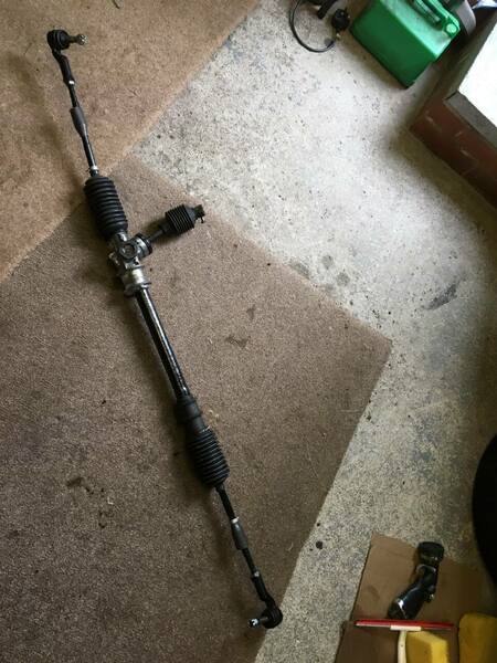

that manual steering rack that looked like it has spent a long time at the bottom of the sea
183414194_10165092495320181_350304435036169029_n.thumb.jpg.351f9c0bf9c3fcbe5e3a4ecd85027d67.jpg
is now much improved

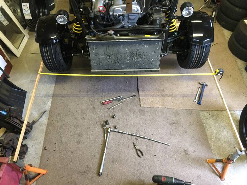

I got it fitted and roughly set up the alignment

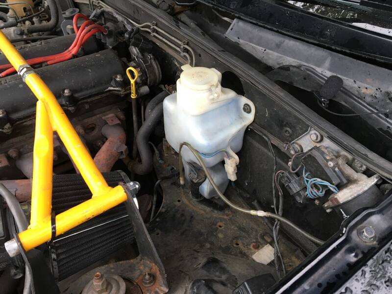

I had a sneaky drive up and down the road to test the new steering rack and it is much improved, I am so lucky to have saved that from being dumped as scrap
yes, that is a little puddle under the radiator :( fortunately just a jubilee clip needing tightened

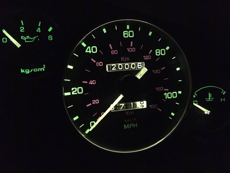

the black mk1 had a milestone odometer moment last night (which I missed)
that's KM so about 80,000 miles, not bad for a 27 year old :)

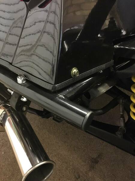

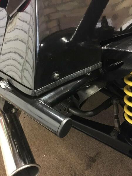

some fancy new bolts turned up so I replaced the tank cover fixings
much better

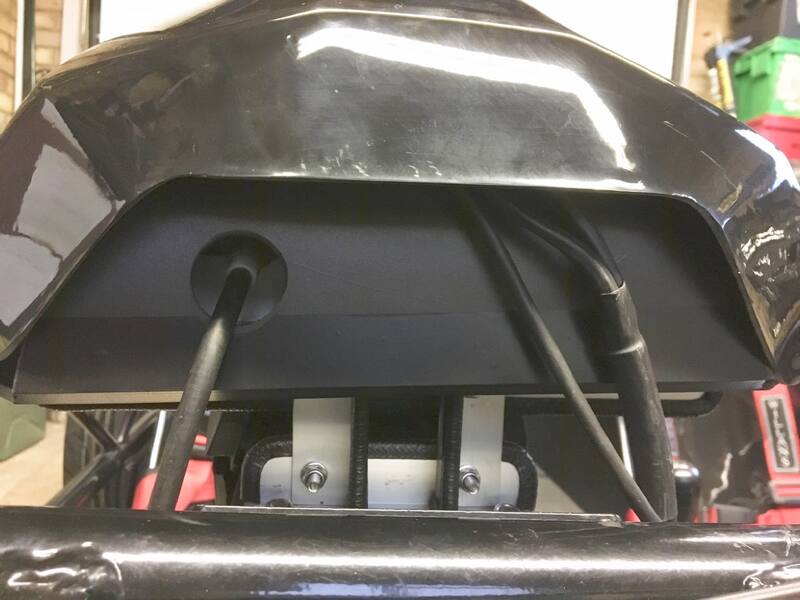

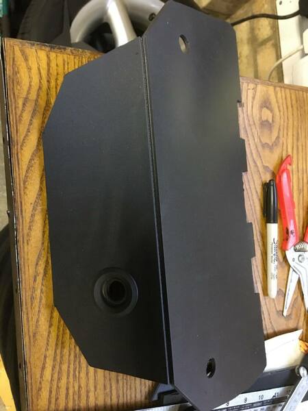

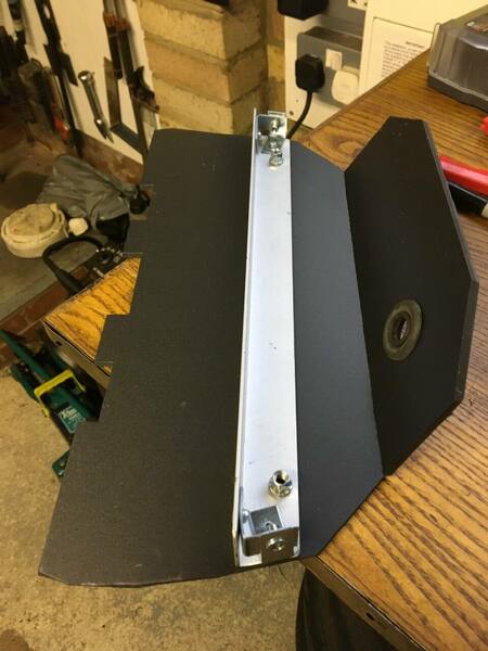

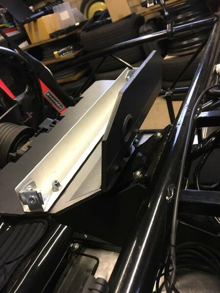

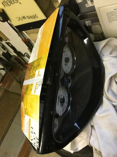

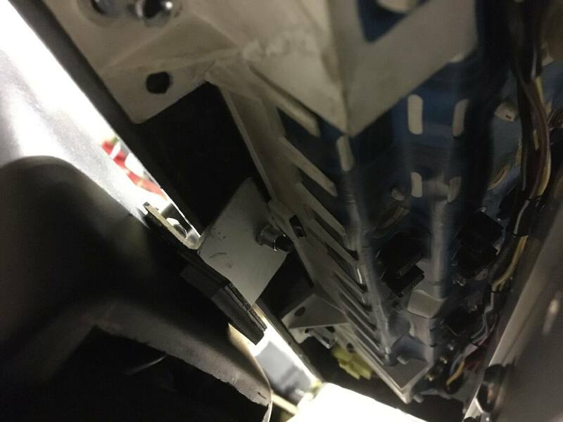

then it was time to work on that dashboard cover again
a cornflake box template was made
and I got busy with the craft knife
all this so the rear of the gauge cluster can be protected
not the best pic but I'm happy with that

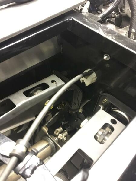

2. I spent THREE HOURS fitting a speedo cable to the Exo
that 30mm hole in the bulkhead required total removal of the pedal box and brake booster diaphragm, lots of tedious disassembly which could have been avoided by a bit of forward planning :(

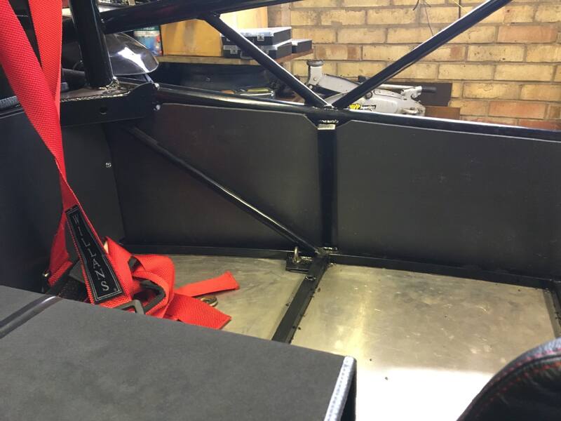

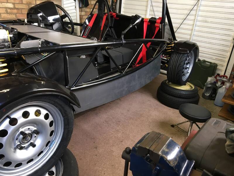

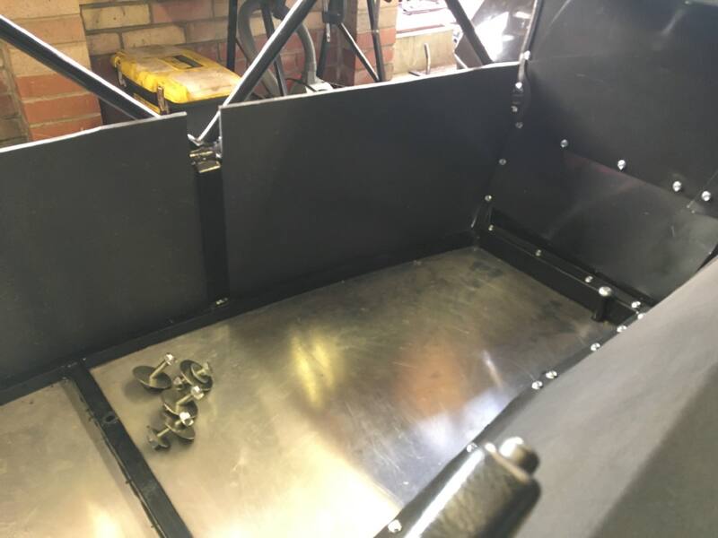

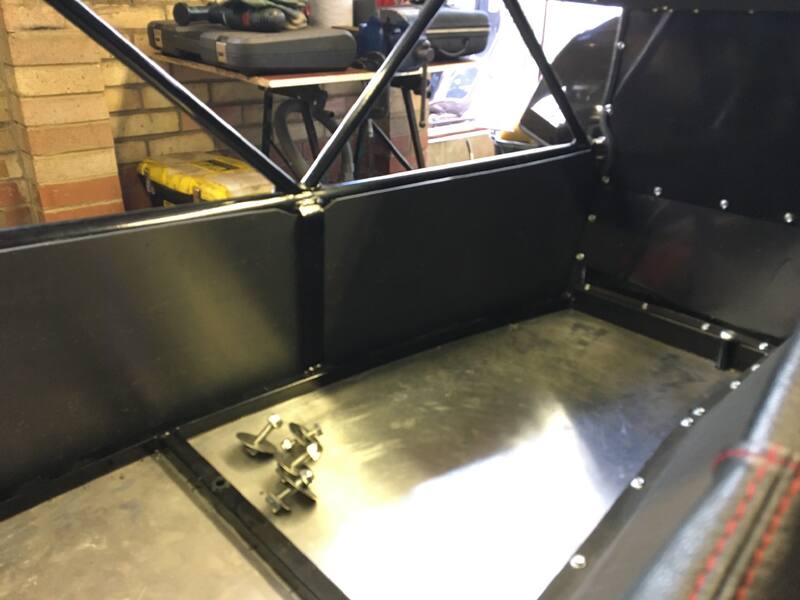

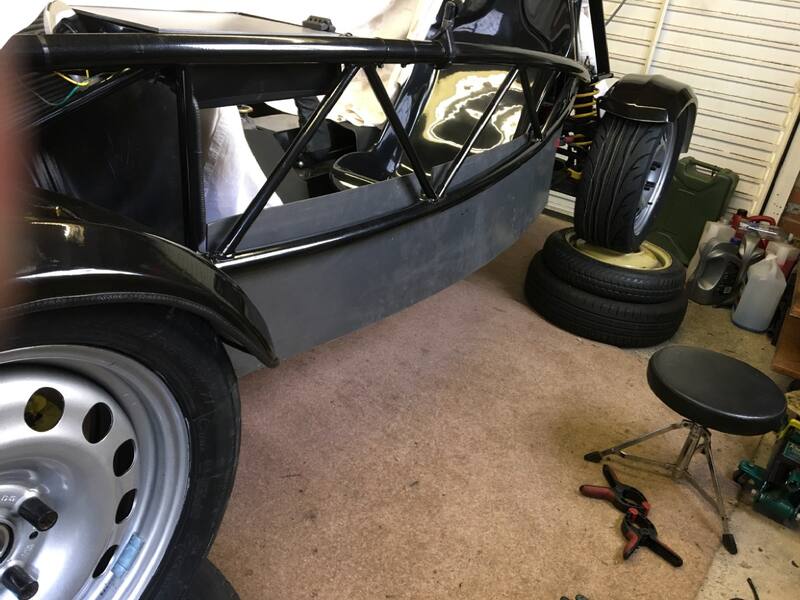

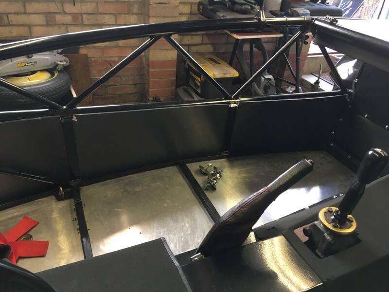

3. I started work on the side panels
lifting the car saved much backache
the kit includes two sheets of "foamex" which need cut to size, obviously a total fanny on
a couple of hours and lots of measuring and trimming later
looks ok
there is a protective film on them, the true colour is much darker and will look better.
having spent so long on the passenger side, surely it's just a case of copying the shape for the drivers side ? I mean, both sides will be symmetrical, won't they ?
will they bollocks :(
close but not quite close enough - a job for another day
