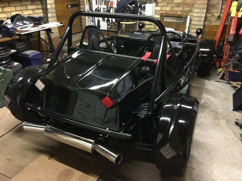

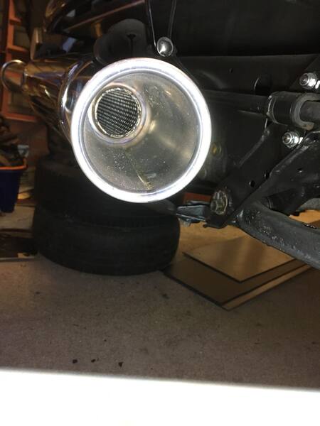

The eagle eyed amongst you will haveno doubt noticed there's not much coming out of the left hand pipe of my fancy twin exhaust ?
hmm.....
right hand side looks like
left hand side looks like
bloody rip off !

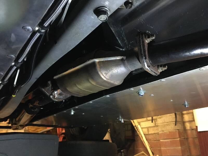

It's still gotthe decat fitted so is plenty noisey, I'll bung the cat back on and see what difference it makes, should tame it a tad
Right, let's see what difference this makes ?

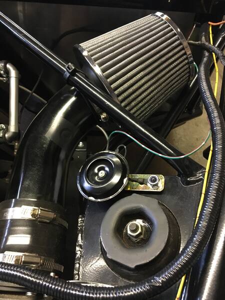

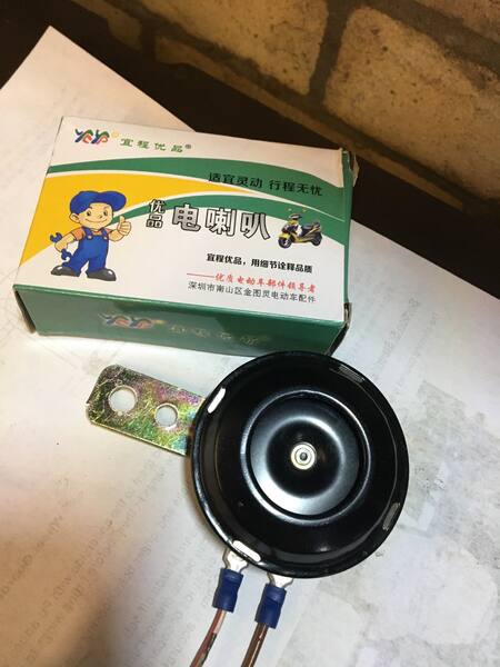

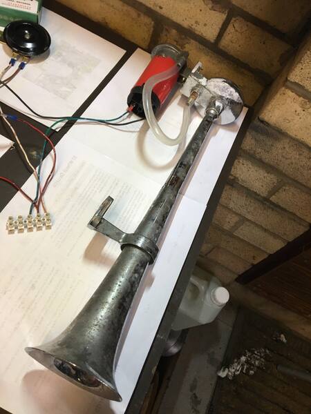

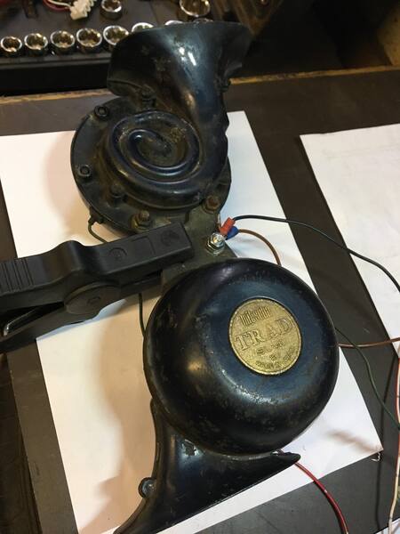

One little job that needs doing is fitting the horn - I ordered a neat little compact unit off the ebay which turned up this morning
oh yes, that looks like top quality
Other options are : two tones, nicked off the mx5
or this monster which was on the donor car
you can probably see which direction this is going but in the interests of science and with scant regard to my neighbours peace and quiet, let's have a wee test
(for an authentic experience, please make sure your sound is turned up nice and loud)
An easy decision made there :)
the ebay scooter horn is just too much like a yappy dog, 'mungous air horn it is then.
i might go and test them again,just to be sure :)
  • gm changed the title to gm's unhealthy obsession with mx5s - size is important when it comes to getting the horn :)
My humblest apologies to you all, I fitted the crappy, yappy dog horn :(
the big 'un was going to need all sorts of brackets sorting, I'll change it over once we're on the road

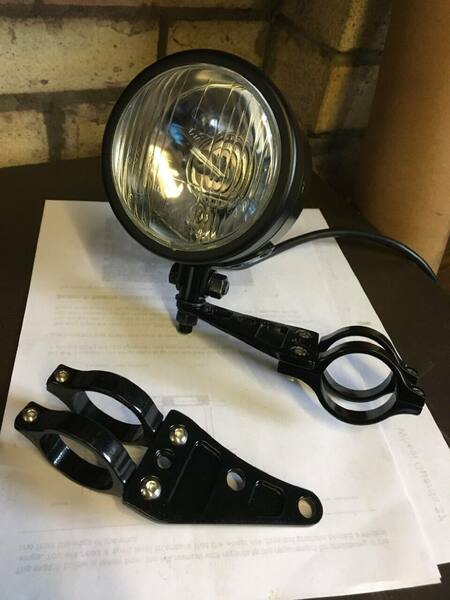

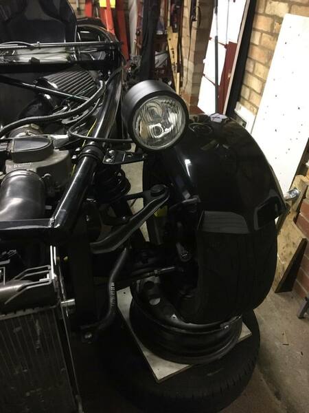

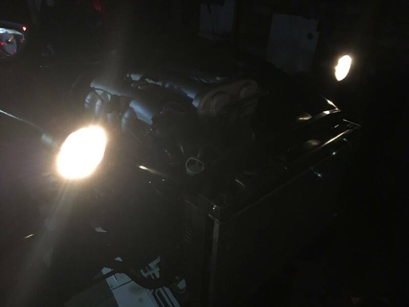

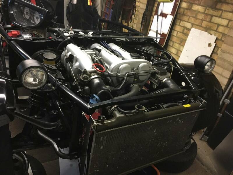

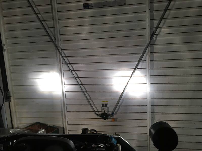

headlight fettling today :

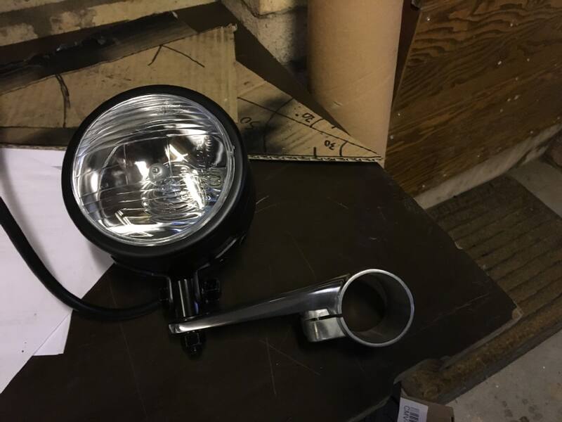

I sent back the polished aluminium brackets that I couldn't use
and ordered something more suitable (but just a little bit fugly)
I should really fit the bonnet first but wanted to see how sturdy the new brackets are
I needed to wrap a slice of neoprene rubber round the frame but they are nice and solid
they do look a bit awkward though - might be better once the bonnet is fitted (I hope)

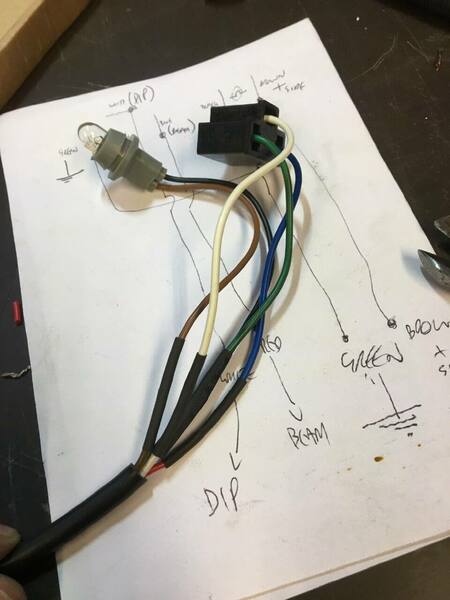

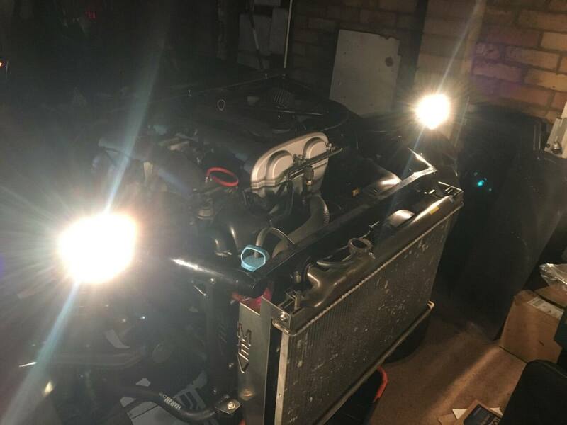

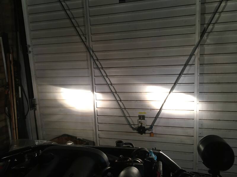

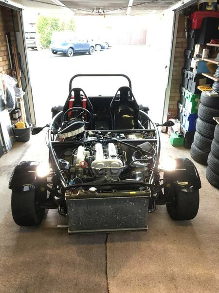

lets have a look at the wiring then

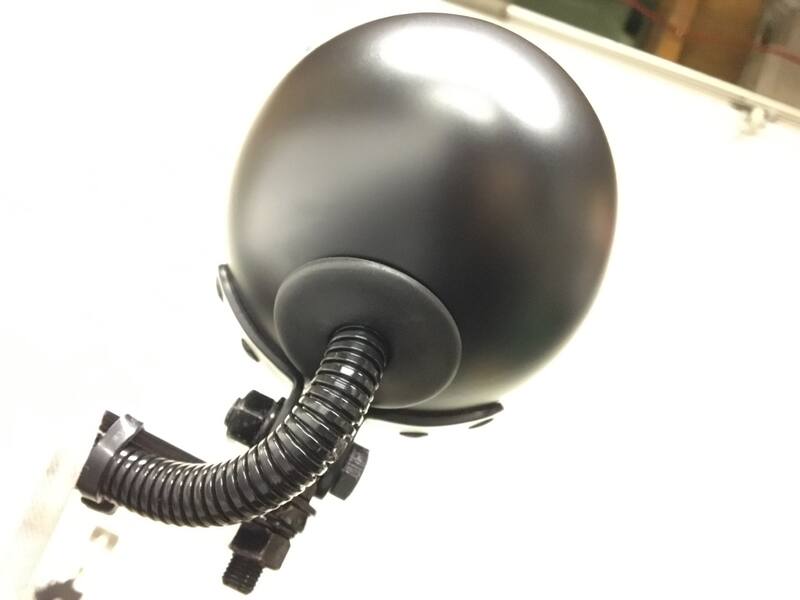

that was easy enough but why the enormous hole in the grommet ?

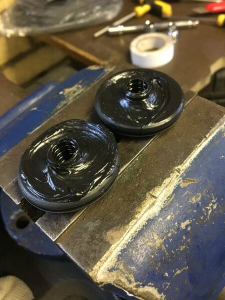

I got hold of a couple of blind grommets and set to work
goo applied

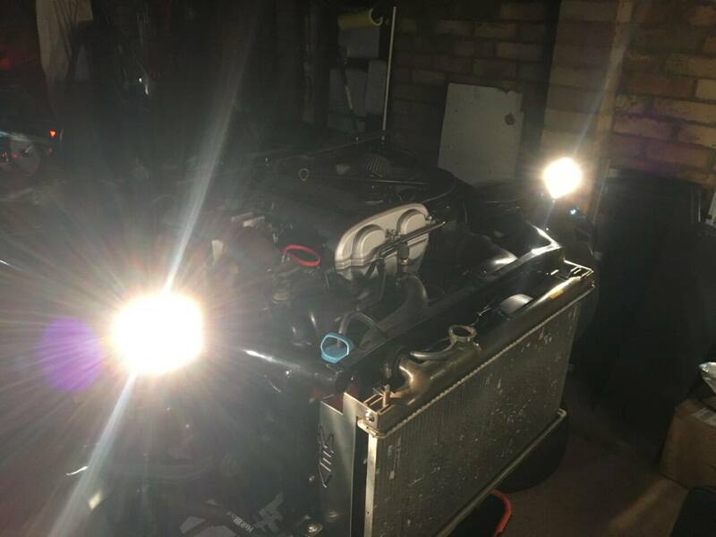

while the goo is setting, i'll check the wiring
sidelights
dipped beam
full beam
another job ticked off the list :)
(I nicked the night breaker bulbs out of the mx5, the supplied h4 bulbs were rather poor)

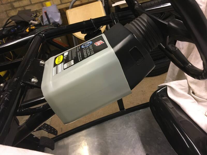

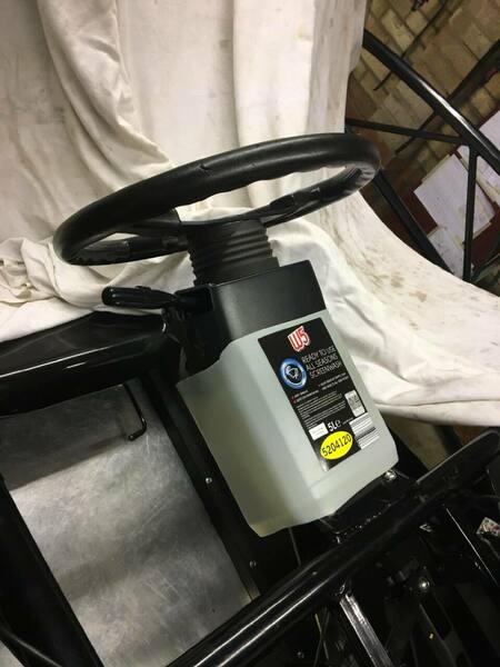

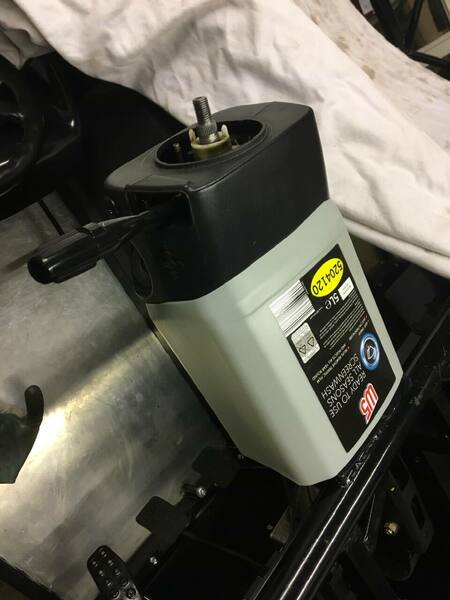

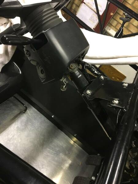

I have been pondering over what to do with the steering column and ignition wiring - the shroud leaves a little too much exposed for my liking
so what I need is something roughly this shape that I can extend the shroud by 20cm or so
I fannied on with bits of cornflake packet but was getting nowhere :(

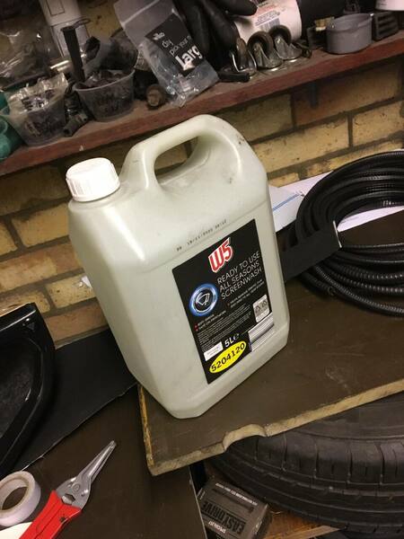

just as I was packing up for the day, I tripped over a discarded screen wash bottle
hmm, I wonder ?
not exactly substantial but makes a handy template - I'll dig out the alu sheet tomorrow and get cracking :)

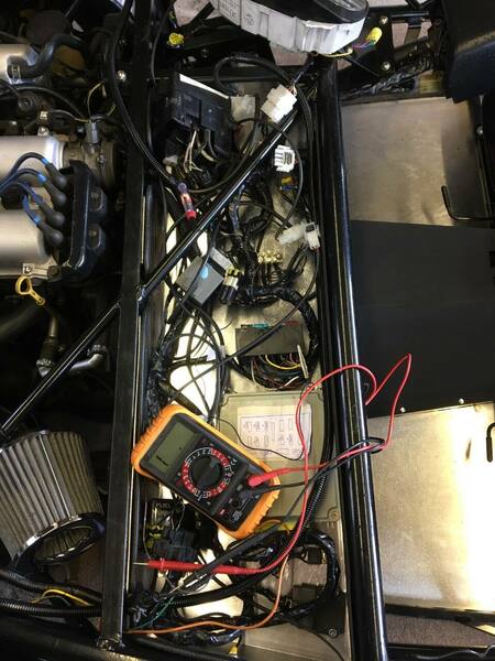

Remember that mess of a wiring loom that was working perfectly ? Until I wrapped the bugger up in tape ? And now it doesn’t :(
My first electrical fault - oh joy !
seems to be a bad connection somewhere in the rad fan circuit which has magically fixed itself. I’ll keep an eye on that :(
otherwise, seems to be running ok

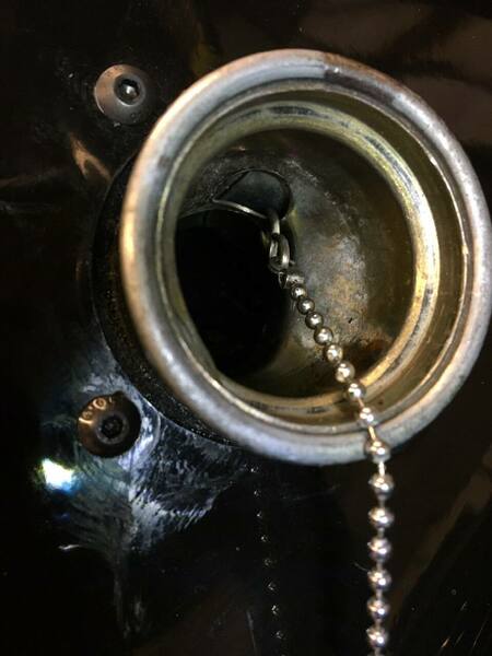

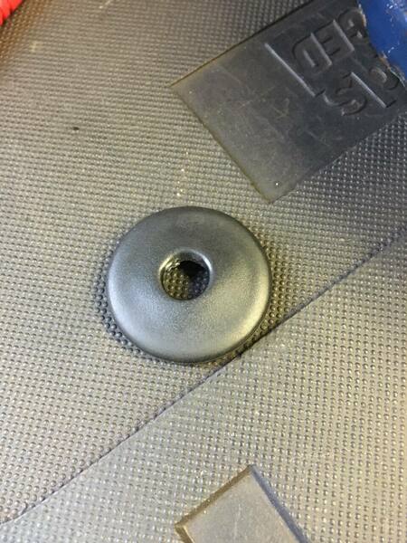

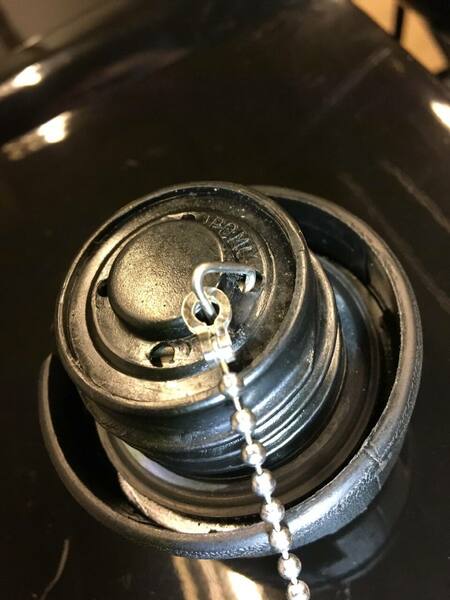

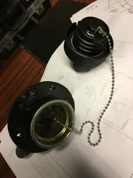

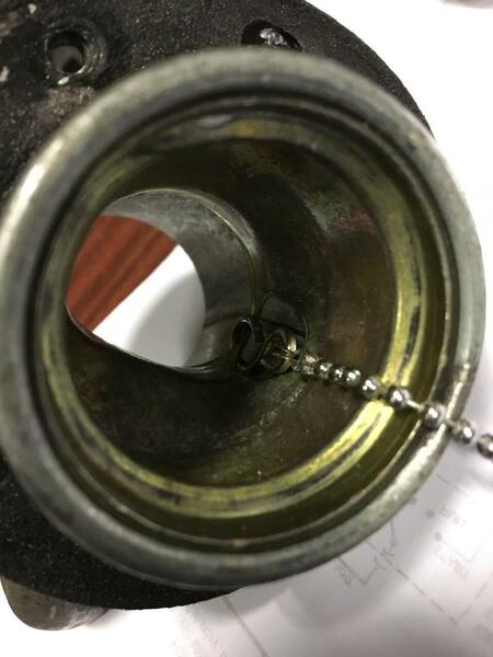

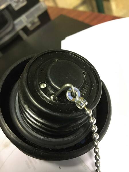

a bizzarre iva reg is that the petrol cap must be tethered to the car, just in case you do something daft like drive off without it :(
now, should I :
a) spend some money ?
or
b) channel my inner Baldrick and come up with a cunning plan ?
fortunately, there isn't a current mrs gm to ask awkward questions as to the whereabouts of the bath plug !

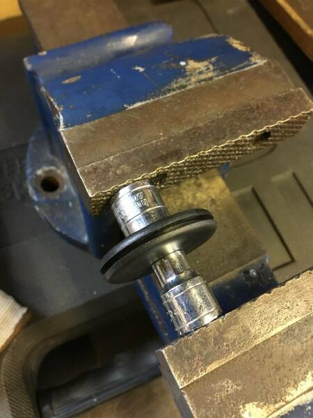

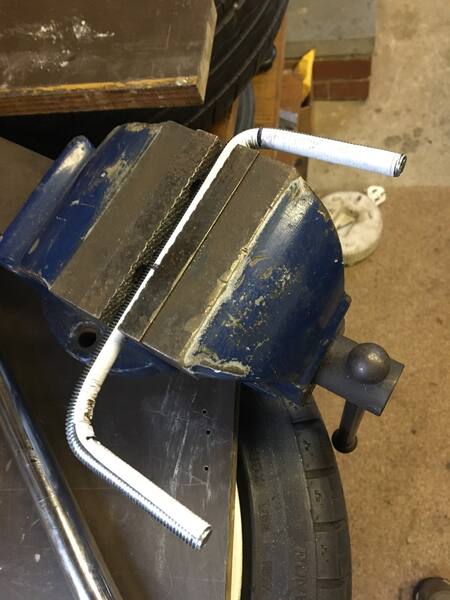

that was fiddly as fuck !
but we can call that job done !
except the filler needs to go on the inside of the tank cover and the cap on the outside :(

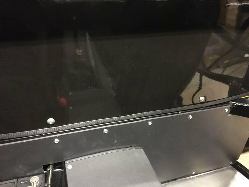

well, maybe I should finish the rear cover properly while I am at it
holes were drilled
and bolts were inserted
which were a bugger to line up but I got there eventually

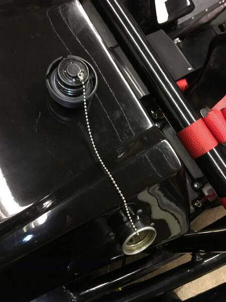

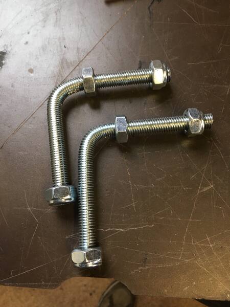

now back to that pesky fuel filler

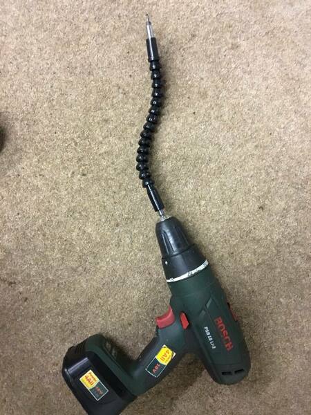

the bolts were tricky to get to so I whipped out a ridiculous item
which actually worked !
"plug" refitted on the right side of the cover
it's still fugly but it will do for now
boom ! I am compliant :)
and that is the rear end officially FINISHED !

Thinking about the ridiculous fake exhaust, I get a feeling that might be an IVA thing.  I'd be surprised if there's not something in there about side exhausts needing to vent to the offside of the vehicle only, so you're not blowing exhaust fumes at pedestrians on footpaths.
Would have just made the thing with one pipe though if it had been me!  The fake one just seems ridiculous.  Or just have the dual pipes but pointing out the rear...
