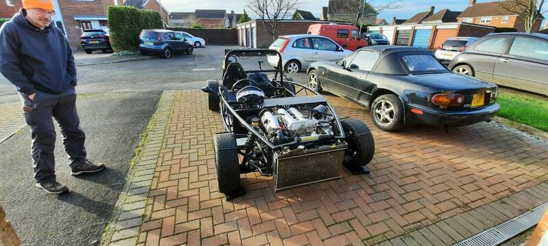

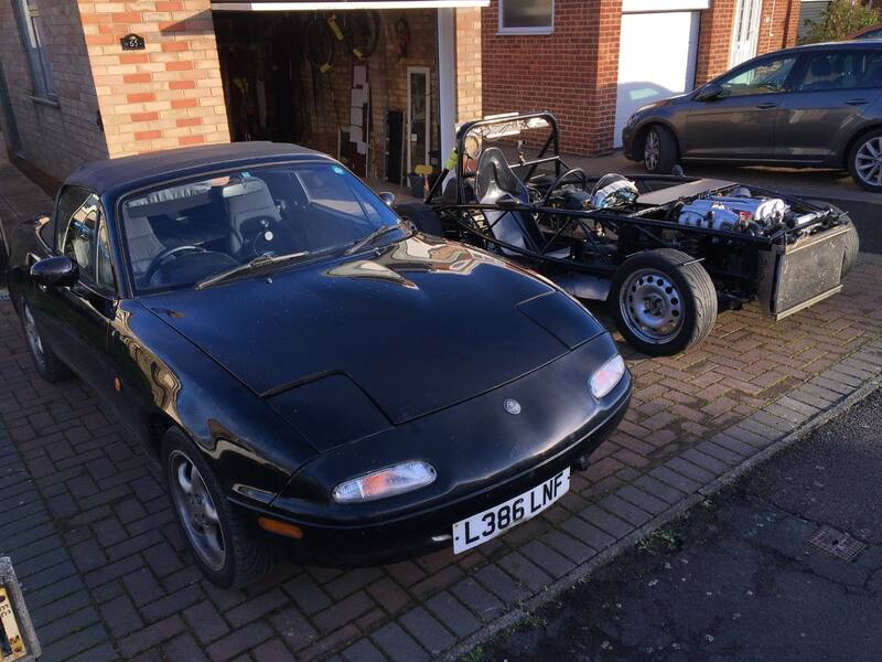

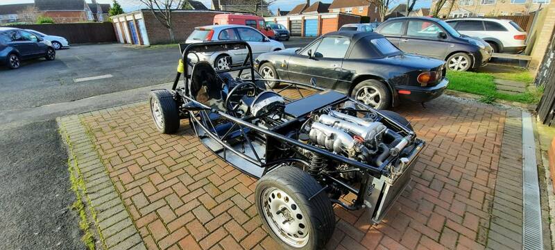

gm's unhealthy obsession with mx5s - must be summer - the toys are back :)
Well done. You always remember the first drive in something you’ve put together yourself 😂
Just recently picked up a couple of unfinished kits (one already IVA’d, one not) and am looking forward to getting stuck into them - just deciding on which engines to use!
Ummm, wow. We have just popped down to have a look. As the kids would say OMG.
And you were so graceful getting in and out when you had a wee seat in it :)
no videos today as i as I definitely didn't drive it up and down the street again :)
how about some 'before and after' pics instead ?
i can just get it off the drive without scraping if I go at an angle

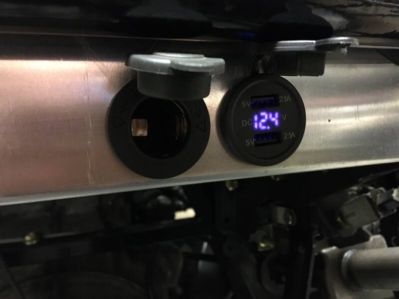

Not much to report today - wired up the 12v and usb sockets
didn't realise there was a handy voltmeter in the usb one :)

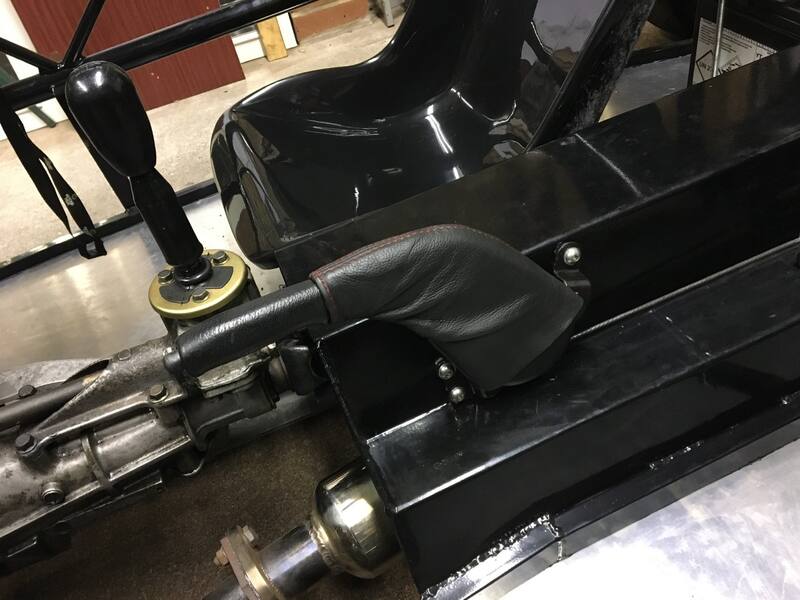

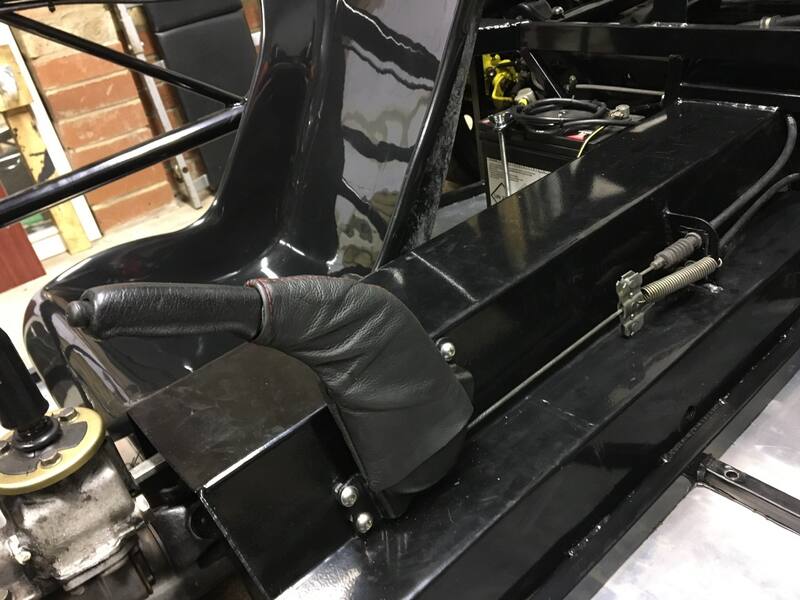

finished off fitting the handbrake
there's a matching 'leather' cover for the gearstick, both came off the donner car

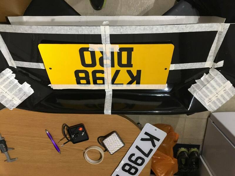

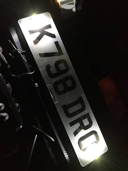

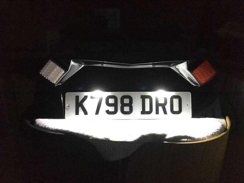

then test fitted my ebay cheapo number plate lights
in the dark - not sure if they will pass the iva, maybe I'll mount them above the plate facing down instead of at the ends

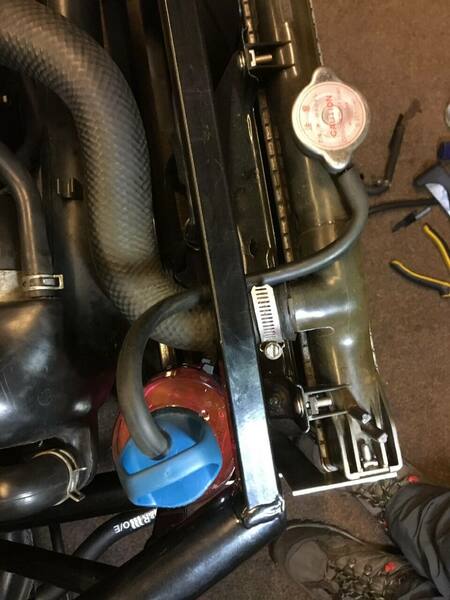

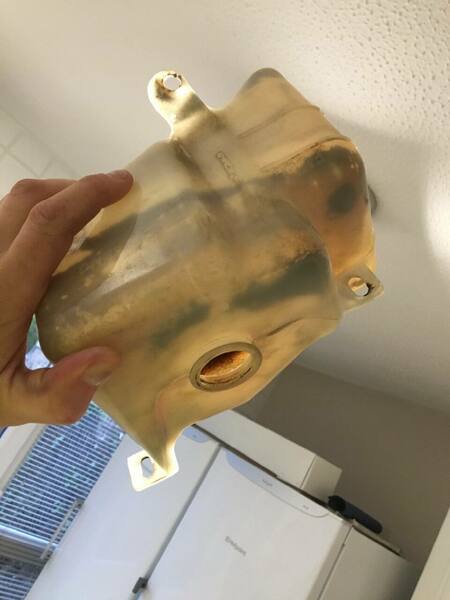

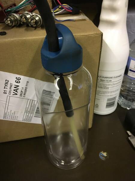

I did manage to tick off a few tiddly little jobs, first off being the coolant expansion tank
this is the one that came off the donor car (after it has been through the dishwasher) you can see why I might not want to use it

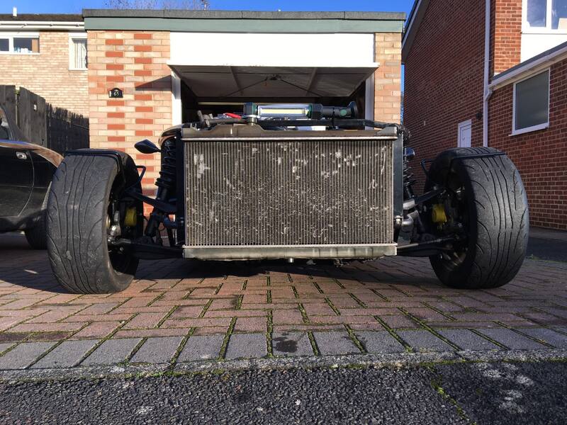

so I nipped along to the retail park to source an alternative
some quality parking going on here

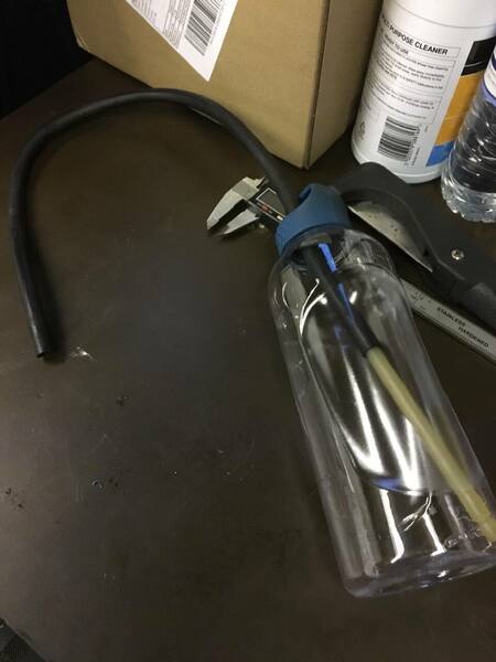

decathlon sports turned up a decent looking water bottle for £not much
which got a couple of holes drilled in the lid and suitable pipes attached
I might splash out on a cycling bottle cage for it but a couple of cable ties seem to do the trick for now
the piss weak coolant is just there for the pics, I'll put proper stuff in when I'm sure I don't need to take the radiator out again.

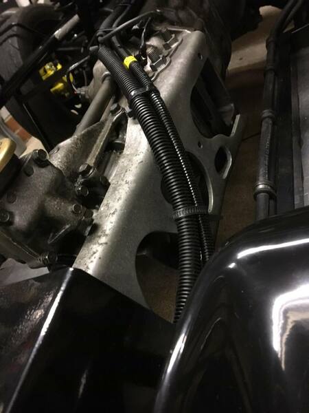

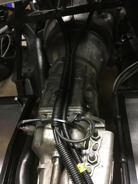

I spent a bit of time tidying up the front to rear wiring - exciting stuff !

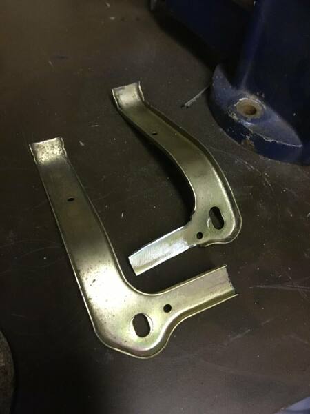

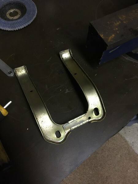

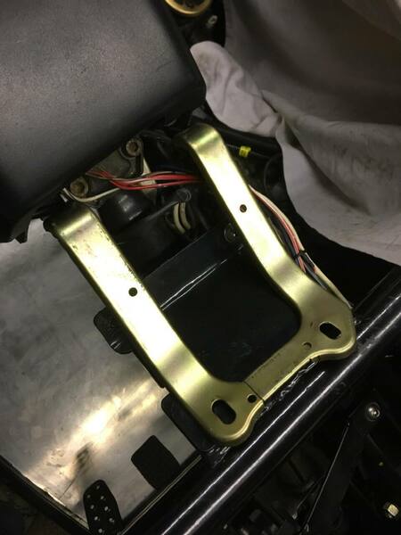

the fuel tank on the mx5 is sealed to the shell with this wonky square shaped gasket and bracket
I was looking to solve a different problem and happened across the bracket in my scrap pile
yes, that might just come in handy - let's grab the grinder a wee minute
stop..........hammer time :)
needs holes drilled but has potential

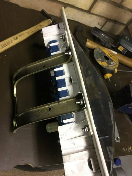

nuts and bolts
an offcut piece of plastic (from a window blind, the rod that weighs it down so it hangs straight)
sorted :)
I'll swap the plastic for something stronger but I'm pretty pleased with that

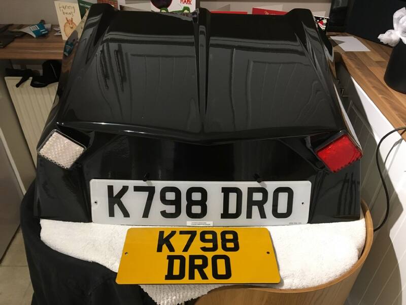

the rear cover that fits over the fuel tank needed a bit of work

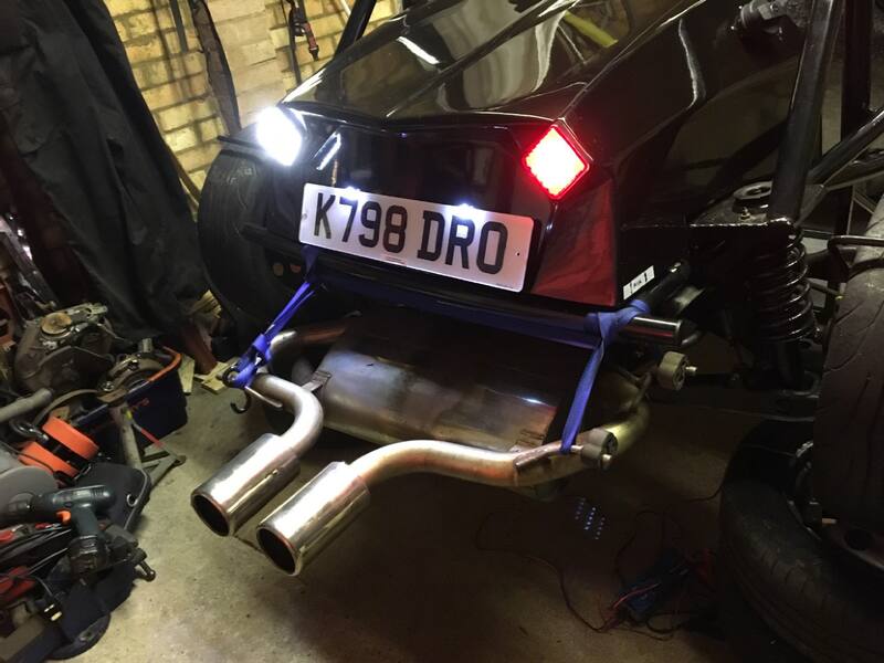

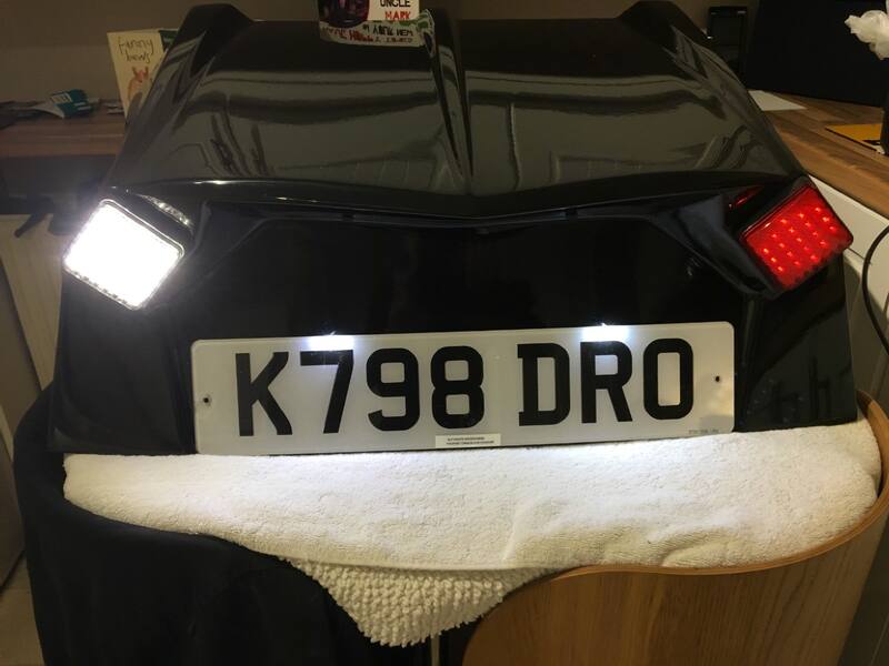

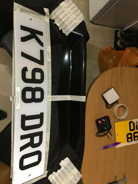

I'll have to fit a standard plate for the IVA but would prefer to use an import style one later - I'm using those little led bolts for illumination so can have them pointing down on a long plate or sideways on a square one
also fitting the reverse and fog lights to the corners of this panel
all fitted in place - the square* plate will definitely look better here, especially if I do buy a K123EXO registration

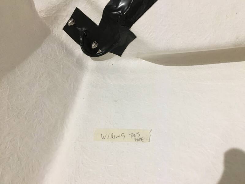

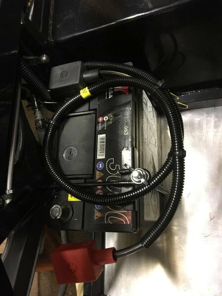

wiring complete
wait a minute - whats that little label on the left of the pic ?
oh, you cock !
lucky the cable is long enough to stretch across to meet the harness which runs along the passenger side of the car
a quick test
lights out in the kitchen
I'd say that plate is well enough lit
reverse light is blinding, fog isn't looking quite so clever :(
hopefully it's because I was using an iPod charger for power, I'll be royally pissed off if the wiring is wonky
I'll do the same for the lights on the rear mud guards tomorrow.
little steps :)

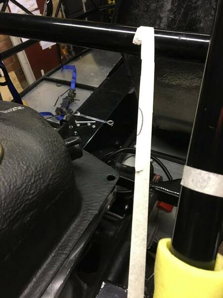

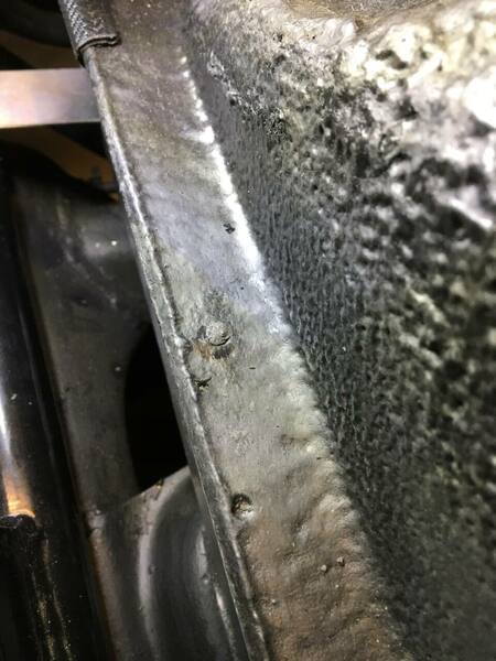

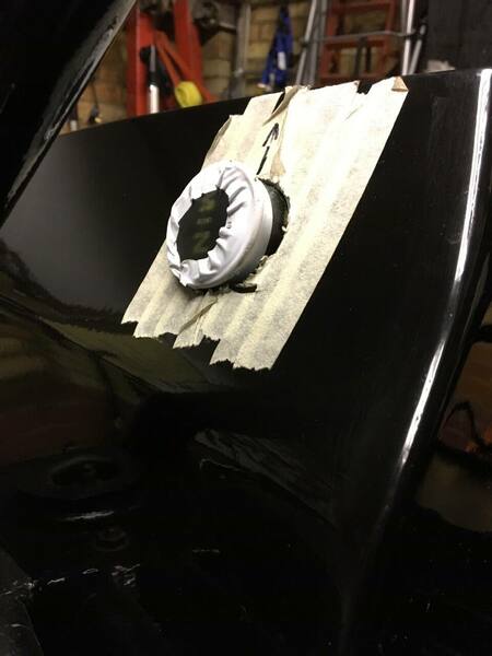

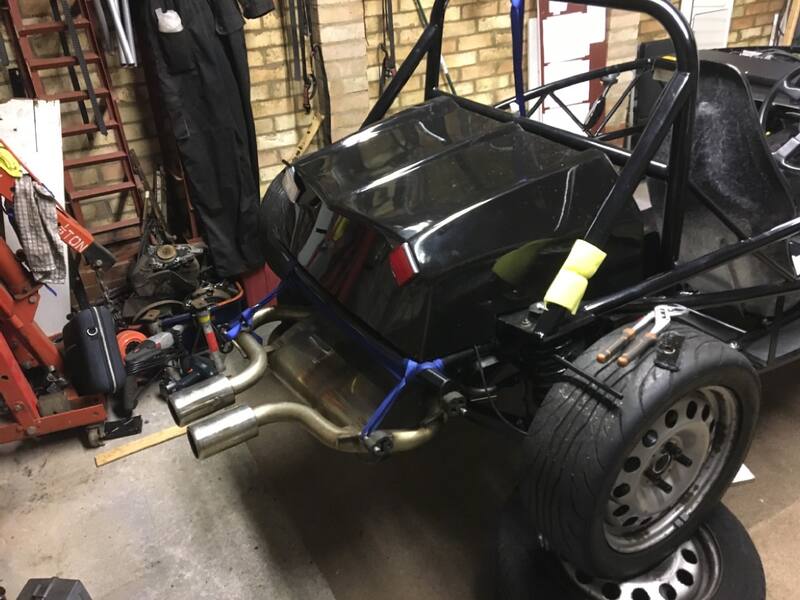

test fitting the rear cover was a bit of a bugger, I had to "adjust" the lip on the edge of the tank with my biggest hammer but it fits now :)
the fuel filler needs to go in that angled section near the roll bar diagonal, roughly where I've marked on the masking tape
take the lid off
just there will do

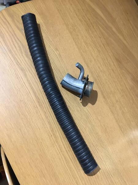

I cut down the original filler neck and have ordered some extra flexible tube to link it to the tank. I'm not cutting the hole until I'm sure its in the right place.

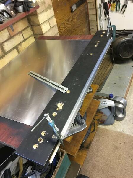

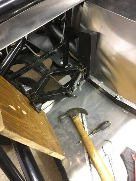

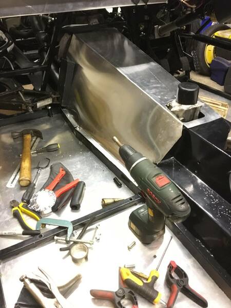

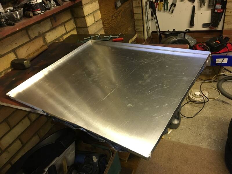

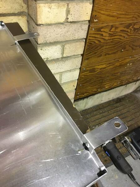

IVA regs require the fitting of a tray under the tank to keep any fuel leaks away from the hot exhaust.
lack of metalworking tools means it's time to get creative
bash, bash, bend, bash etc
rivets on the corners and a dab of gasket sealant and we can call that job done :)
I'll drill a drain hole once I decide which exhaust I'll be using

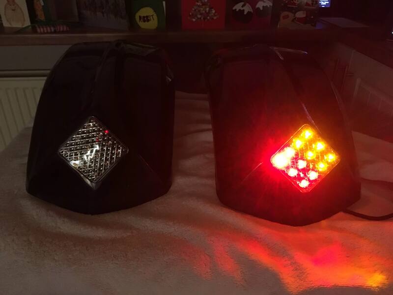

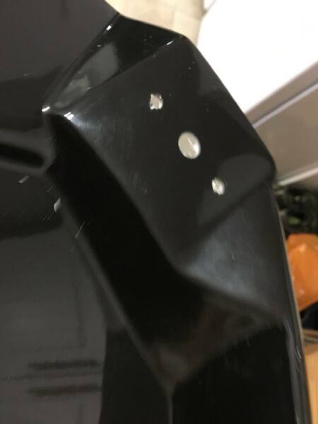

lights fitted to the rear arches and tested, ready to go on (bonus points for mildly offensive birthday card in the background)
look much better than I expected

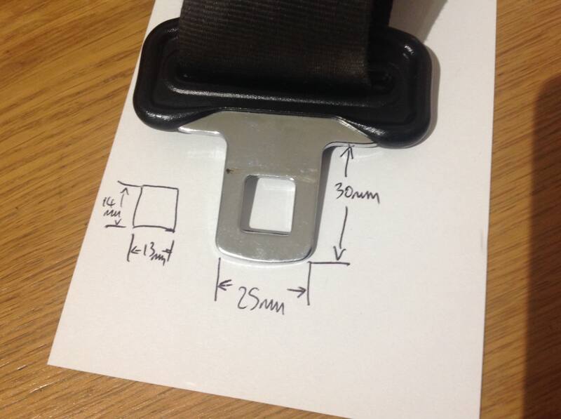

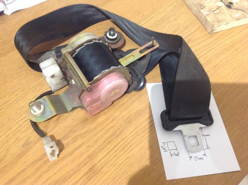

would you have any drivers side seat belts in your stash?
or recommend someoe to buy new ones from
thanks

I do but I'll need to check if they are mk1 or mk2 as they differ. the mk1 donner car had mk2 seats (belt receiver is fixed to the seat instead of the floor) so you may be in luck.
I've not long locked up for the night so will dig them out tomorrow and let you know.
there's definitely a pair of lovely* beige coloured ones from the v-spec from when I swapped the interior
will have to check about where they fit (didnt know that)
and i cant check as i cant get the seat out at the mo

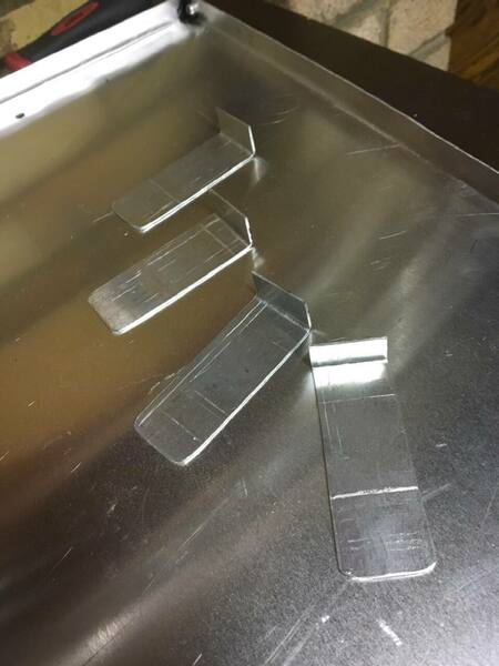

that fuel tray I made yesterday needed to be fixed in place
brackits
rivits (and goop)
fits neatly onto the subframe mounts, no chance of them coming loose :)
tank refitted (you can see how I carefully* modified the edge to fit under the cover)
and a wee drain hole (right hand edge, half way along) leading away from the 'zorst
alarmingly, that represents three hours work ! still, little steps :)

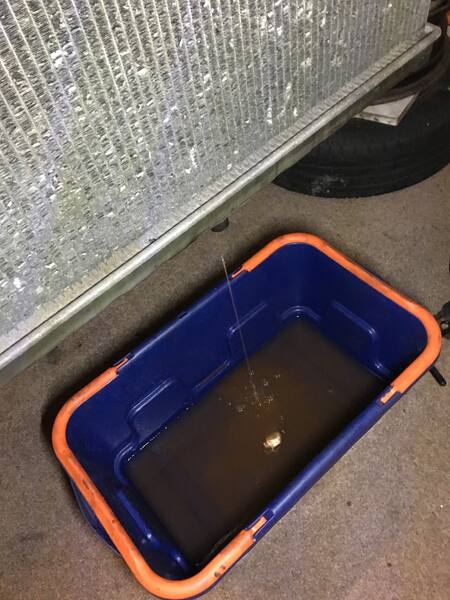

It's currently minus 3 outside and the latch on my gate is frozen shut - nipping in to the garage to fetch some wd, I noticed it is only 1oC in there - time for a bit of preventative maintenance
i suspect that a gallon of my piss would have better antifreezing properties than this lot
it can get refilled once I'm happy the rad doesn't need to come off (again)i

@hairnet
I dug those seat belts out of the garage, they are definitely mk1 type so I'm not sure if they will fit your mx5 or not ? check the size of the buckle on yours against my very technical drawing :)
there are two of them, let me know if they will be any good
ok cool
have to find out if mine have pre tensioners...........apparently they might........
wont know that till weekend when its light........

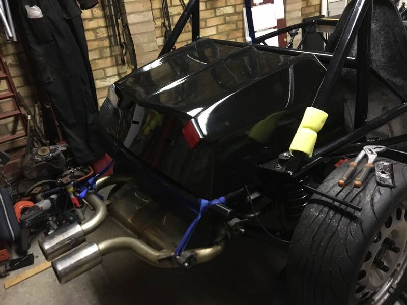

more wiring has been occurring - seemed to take way longer than it should but I guess it's worth doing right first time (label maker ftw!)
that all needed sorting out as it's almost time to fit the rear cover

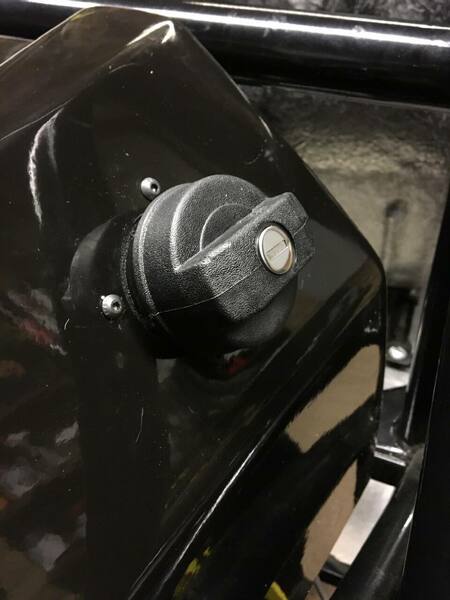

but first, the fuel filler needs doing
that awkward sod
needs to go in there
so a bit of careful* measuring later we have
(a Bini wheel centre was just the right size to keep the dust out of the tank)
then we need a cable clip to hold that wiring loom, just a quick wee hole here will do..

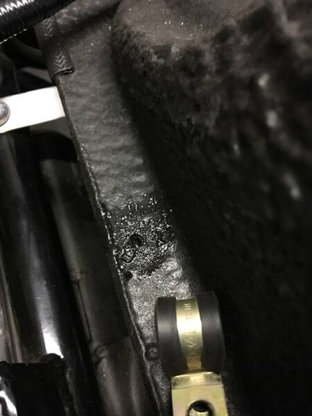

oh you fucking helmet !
yes, that is petrol
thankfully, chemical metal is a wonderful thing (I put more on once that had hardened)
and back to the original job - which turned out surprisingly neat
shame about that fugly cap but I'll replace it with something fancy when (if ever) funds allow
I just hope there's space to squeeze the nozzle past the roll bar (careful measuring, my arse)
that's the tank cover all fitted and another job ticked off the list :)

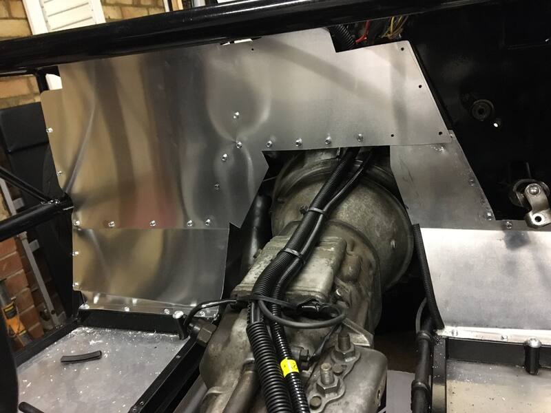

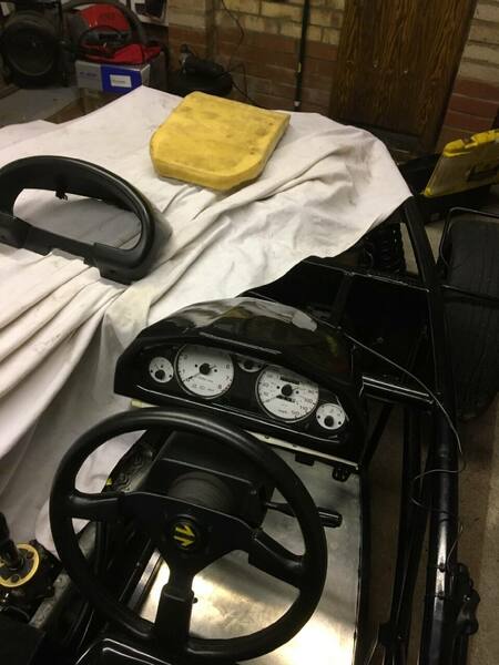

Time for some metal bending
pedals removed to make space
drivers kick panel trimmed and bolted in place
the passenger side is a bit of a nightmare so the wiring tray needed to come out :(
oh lordy !
but there's not a chance I could have got that in with the wiring in the way
a wee bit more tidying up to do and it's time for fun with wiring again :)
