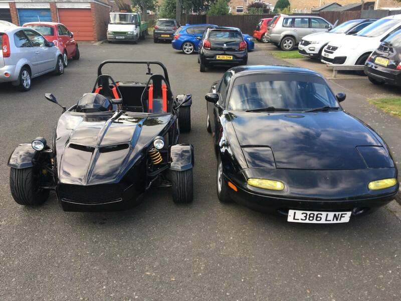

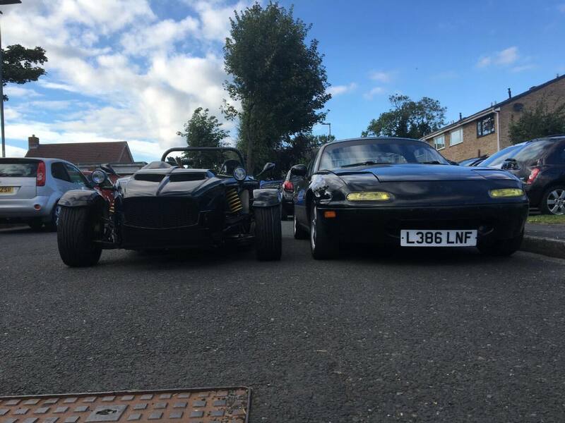

gm's unhealthy obsession with mx5s - must be summer - the toys are back :)
I took it outside to run up to temp and check for coolant leaks - no such leaks were evident so I took some pretty pics

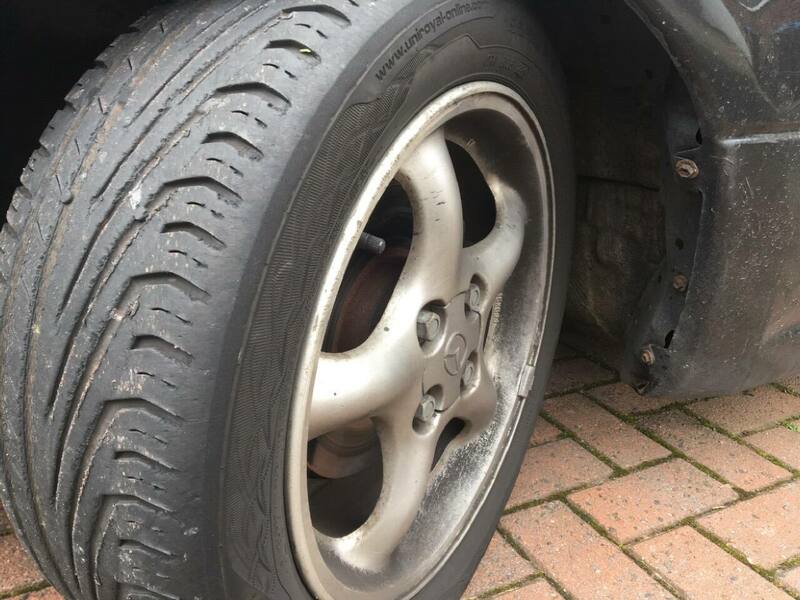

I'm still not sure on that tyre pen - will probably not bother on the good tyres
that grille mesh looks great though, I'm really pleased with that
no hooning today as too many neighbours out in their gardens :(

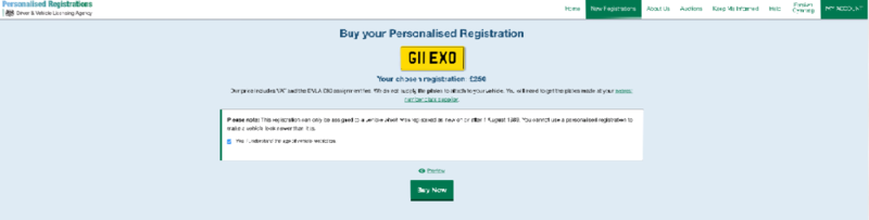

I've never bothered my arse with private number plates but think I may make an exception for the Exo, looking on dvlc, there are plenty of suitable plates available
this one caught my eye
829168724_ScreenShot2021-08-16at12_22.35copy.thumb.png.9b89172d48cf90777e55c7cff50486d2.png
but could I bring myself to be one of those folk who skilfully* amend their plate with extra fixing screws ?

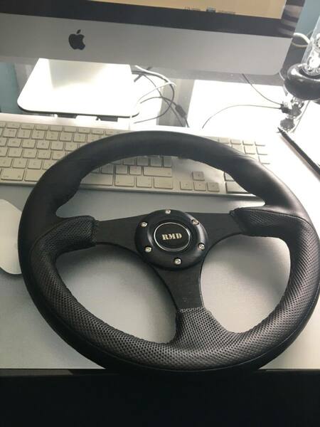

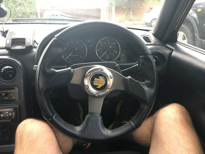

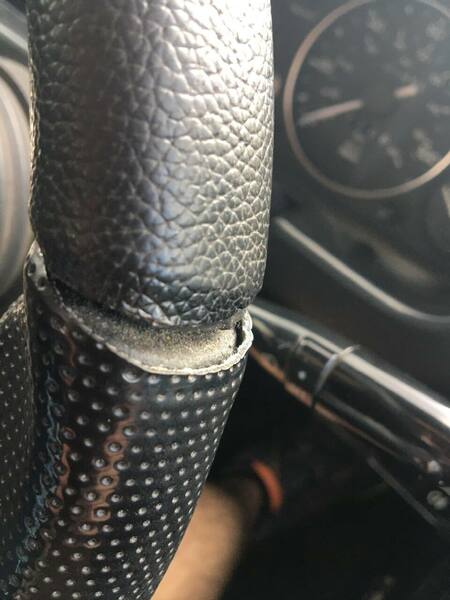

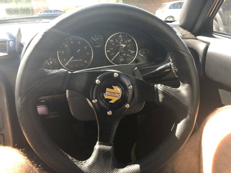

the steering wheel on the mx5 is staring to fall apart, shame as I really like it
I imagine its going to be all kinds of tricky to glue this together without looking a mess
a few beers were sufficient to relax my bidding finger last week :)
sorted ! pretty good quality for an eBay special (the only genuine momo bit is the horn button)

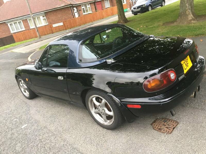

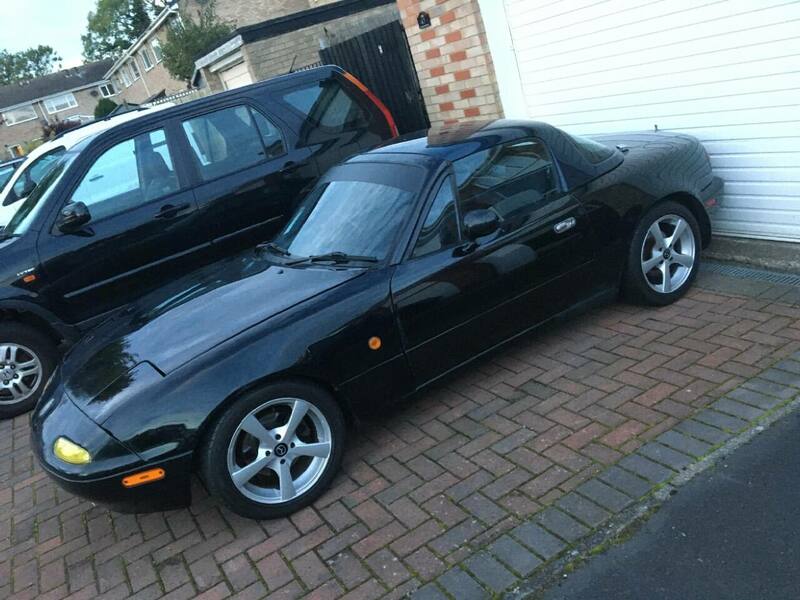

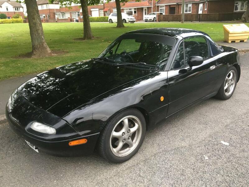

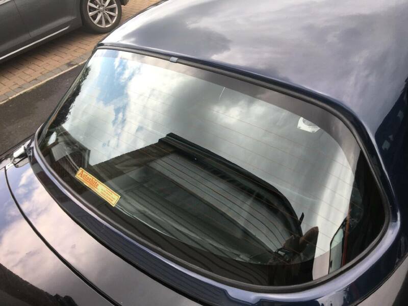

a cheap hardtop appeared on facebook marketplace, it was local and I had a few quid saved up in the car fund so went for a look and bought it straight away
wrong colour but having a different coloured roof is fashionable these days :)

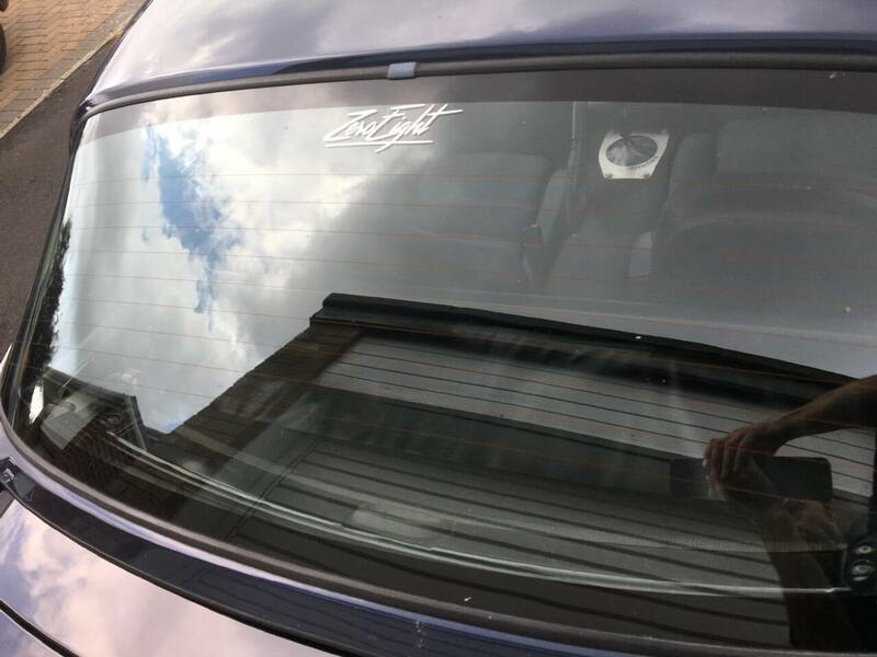

random sticker "Zero Eight" had to come off
much better

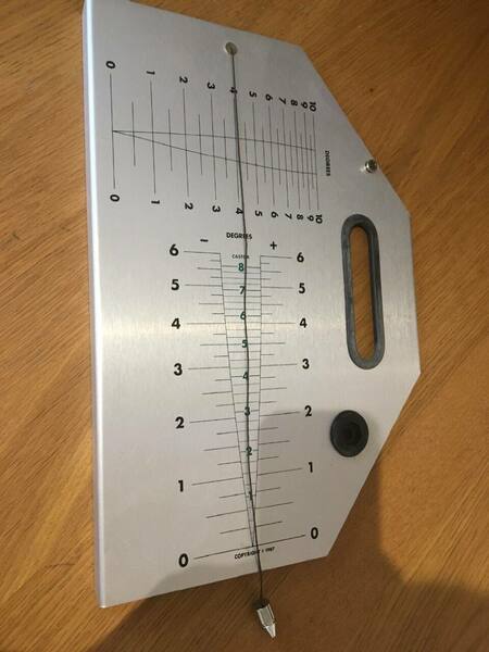

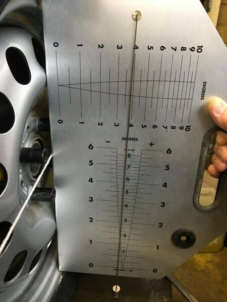

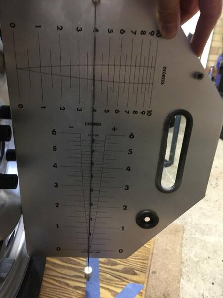

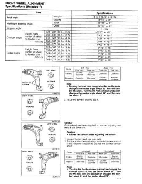

 I also bought this Camber and Castor Alignment Gauge
which will be very handy for setting up the Exo, once I've figured out how to use it :)
looks complicated, but I'll have a go and see how I get on

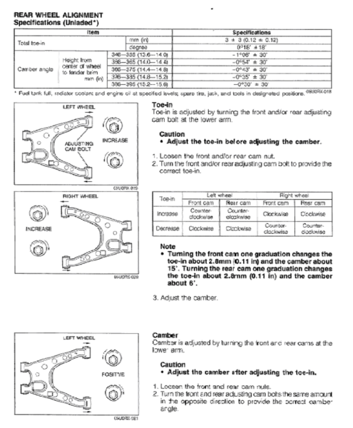

1698796755_ScreenShot2021-08-22at15_25_52.thumb.png.eb3d35219b3b58d317c1c1fccee11e36.png
taken from
https://www.merlinmotorsport.co.uk/files/transfer/technical/doc/adacambergaugeinst.pdf
so with a bit of luck, this will all eventually make sense

from
https://www.miata.net/garage/alignment/

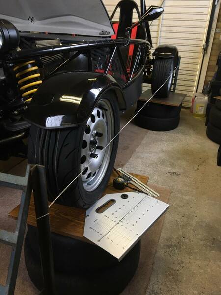

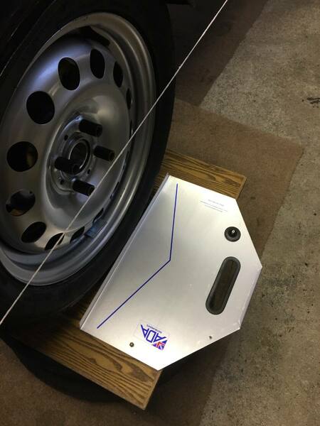

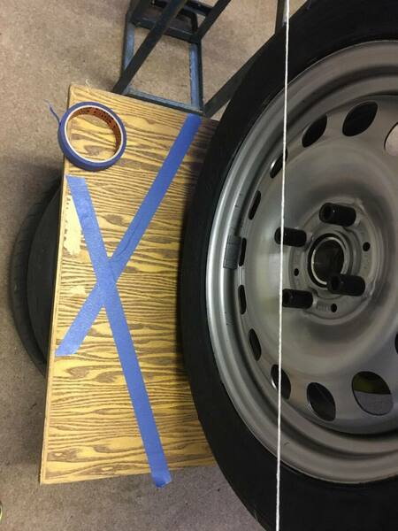

Wheel alignment today

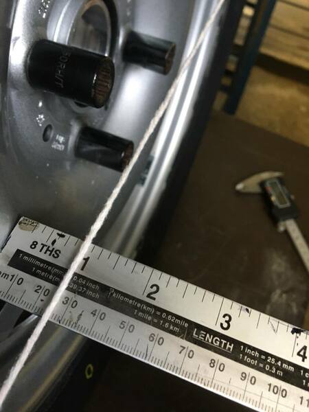

just getting the thing up in the air took an hour of fannying about with jacks
string was purchased and set up parallel
paperwork studied and tools assembled

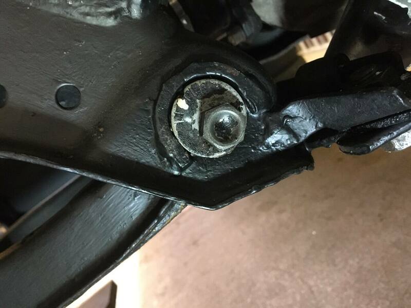

each corner has two adjustment cams
measuring the rear toe in
measuring the rear camber
the near side was close to spec, the offside took a bit of adjustment but is now bang on (assuming I’m doing this right)

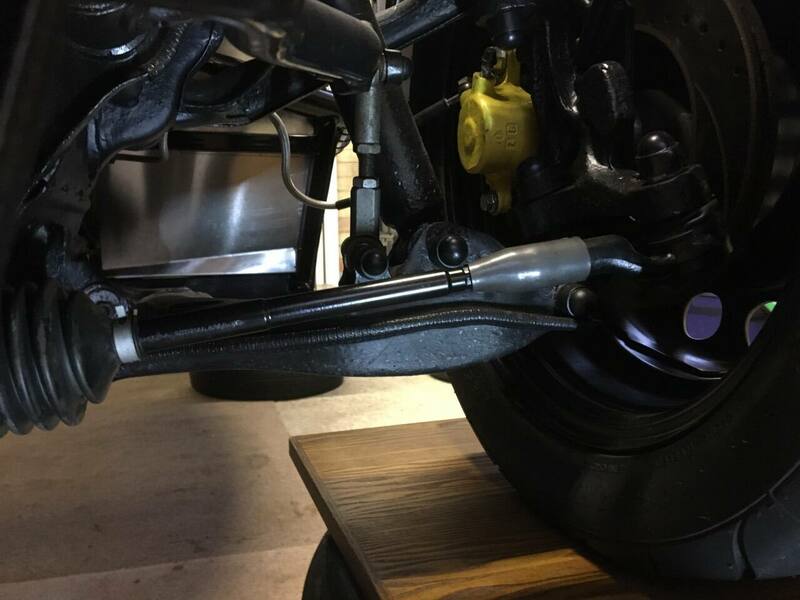

the front is a bit more complex, mark up lines with tape parallel to the template then align the wheel with each line, take the difference to measure the castor
then tweak the toe with the track rod ends
I’ll get it properly set up once it’s on the road but I’m fairly happy that it should be quite driveable for now

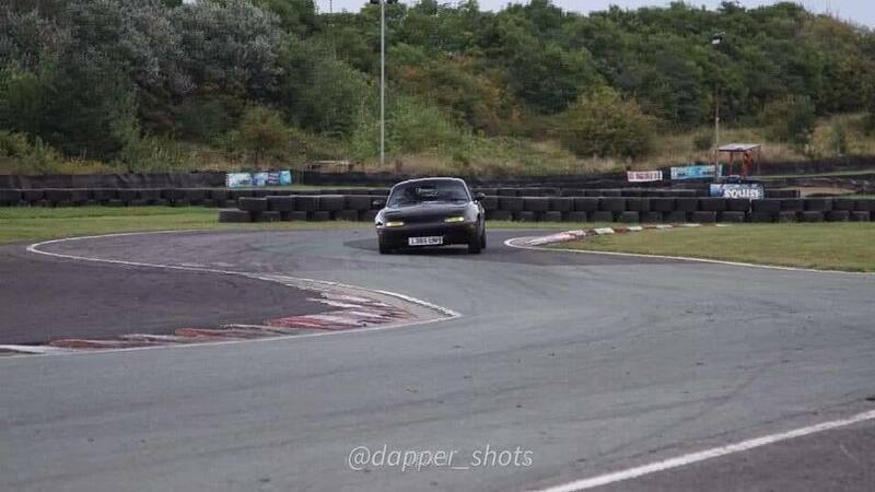

I went to a trackday last night down at Teeside Autodrome, it was rather damp at first but dried up and was plenty o' fun
being damp, I kept the road tyres on - might need a new set of those soon (brakes took an absolute hammering too)
but the little mazda, as always, took it all in its stride :)

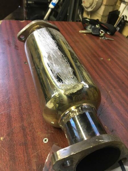

the silenced de-cat was just that little bit too low and was getting in a right state coming on and off the drive
so got replaced with a straight through decat for extra neighbour annoyance

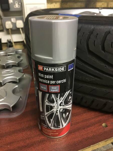

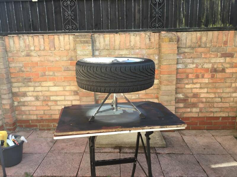

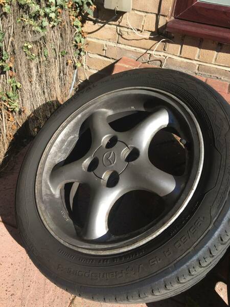

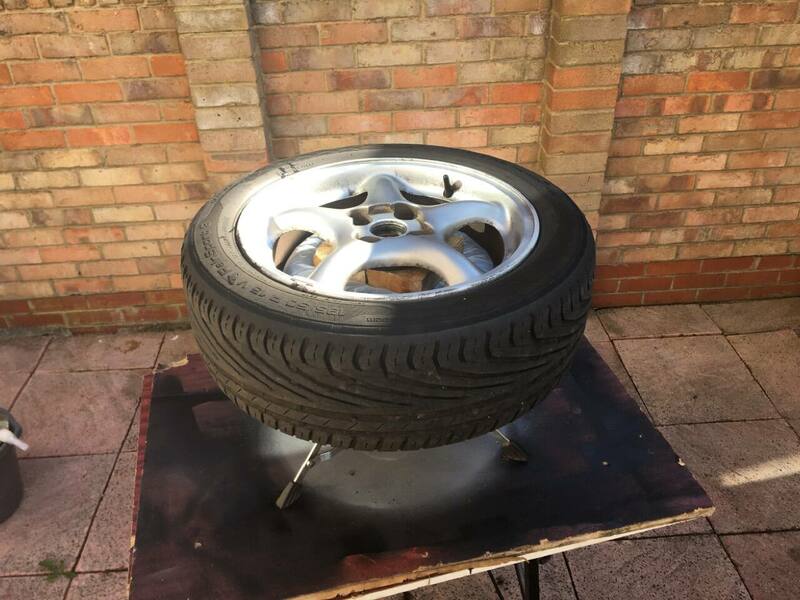

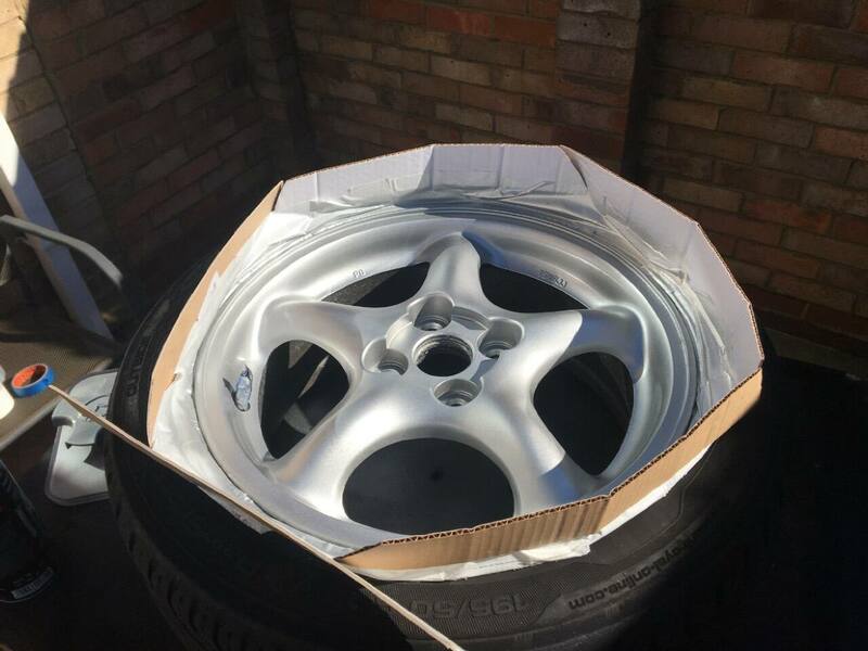

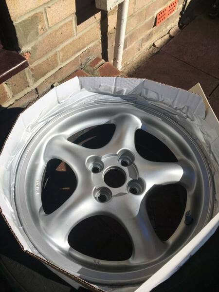

my road wheels which had been abused on track needed a bit of a tidy up
mmm, shiney

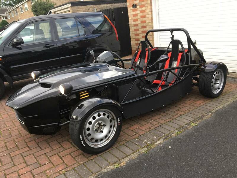

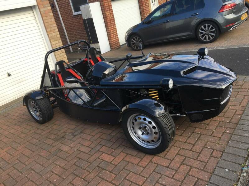

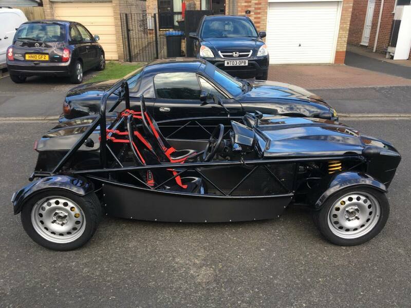

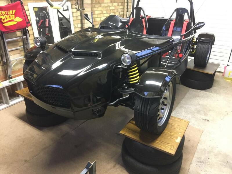

never mind the stupid mazda, what about the Exo ?
well, not much, I'm afraid - I've been pretty busy with work recently :(
but, as the sun was shining, I fired it up and brought it out for a naughty drive up and down the street and some photos
since my heath robinson wheel alignment, it drives much better, steering is lighter and self centres more.
 and I've still not booked the test, I'm waiting for the v5 for the donor to be returned as it needed correcting :(

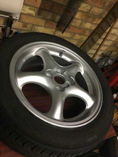

the mx5 needed some new tyres but a set of used wheels with decent tyres turned up locally at a reasonable price, it seemed rude not to
I don't much like them but the tyres are all in good nick, albeit rather squeally (nankang ns2)
the old set of wheels and tyres got refitted and abused round the track for @DVee8junior's birthday, we all had a go and agreed that it was indeed a fuck of a lot of fun !

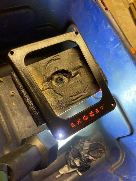

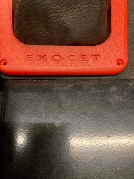

one of the members of the Exo fb group has been messing around with a 3D printer and produced these rather neat looking gear shift surrounds
I quite like the orange but decided to go for a matt black finish, after the first coat, I stuck my work light behind it
that's pretty neat but the letters all got filled in with a few more coats
it is a rather nice finishing touch, just needs screwed in place.

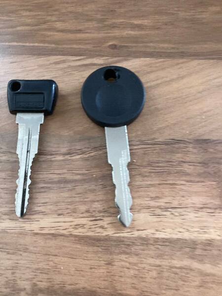

when I got home last night, I plipped the fob to lock the mk1 and heard a not good noise from somewhere inside the door
a tentative pull on the handle revealed something was indeed buggered - no matter how many times I plipped the button or tried the key, the drivers door would not unlock :(
going in from the passenger side didn't help either - only one thing for it - things need to come to bits
dropping the window allowed me to see what is going on - right in the middle of the pic, you might just make out "that bloody spring"
a common problem with mk1 mx5s, albeit one I've been lucky to avoid so far.
a bit of poking around with a wire coat hanger I keep for such emergencies got the door open, it was then a case of taking out the window glass and runner to retrieve this little bugger
and where exactly am I supposed to get one of these late on a Sunday afternoon ?
and also, where is it supposed to go back ?
I bent the end into a new hook, had a poke around and the job's a good 'un !
a quick test and it's working perfectly. result.
I managed to get the glass and (freshly greased) runners in and the door back together just before it started thoroughly pissing it down :)
And I saved £4.08 (didn't need to remove the lock either)

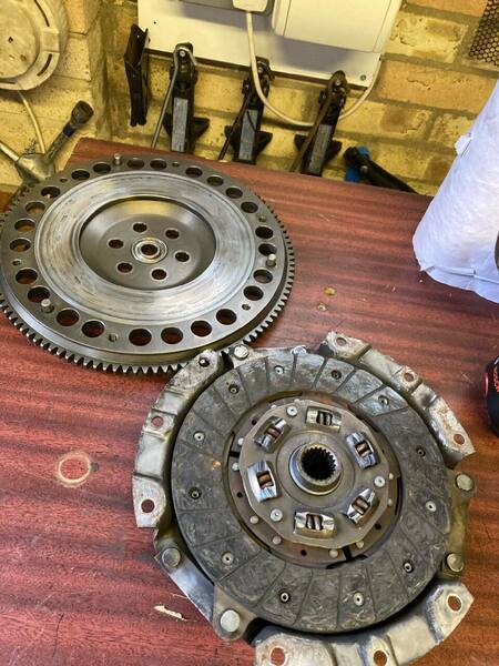

I spotted this lightened flywheel on fb marketplace which will be perfect when thrashing it round the track
the same seller had a rather tasty looking powder coated cam cover too so I made an offer for both

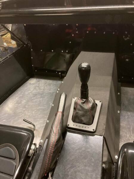

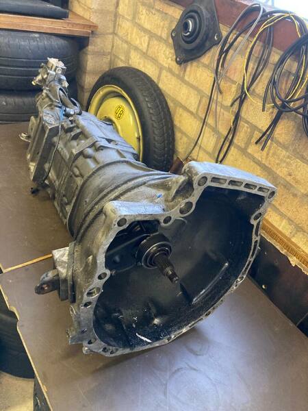

we did a deal then he offered me his spare gearbox at a price that was difficult to refuse - I explained that I couldn't collect but it turned out he was passing in his way home from work and dropped the lot off this afternoon
the gearbox might well come in handy as I currently have a bit of a stiff nob (yuk, yuk) if I'm swapping the flywheel, I might as well swap the box over too :)

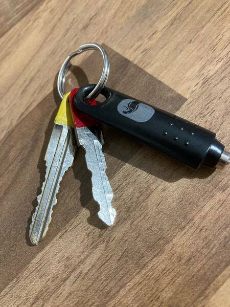

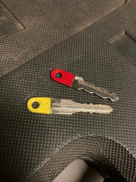

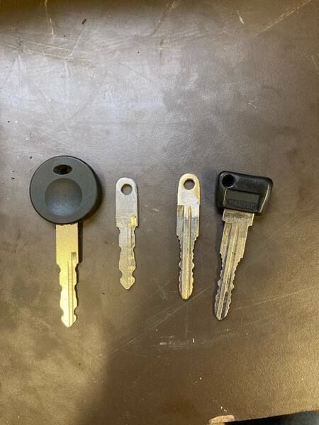

look at these ugly sods - something must be done
I have spares of both so let's have a go at some weight saving :)
Oh yes, much faster now
a wee dab of touch up paint
yes, very smart

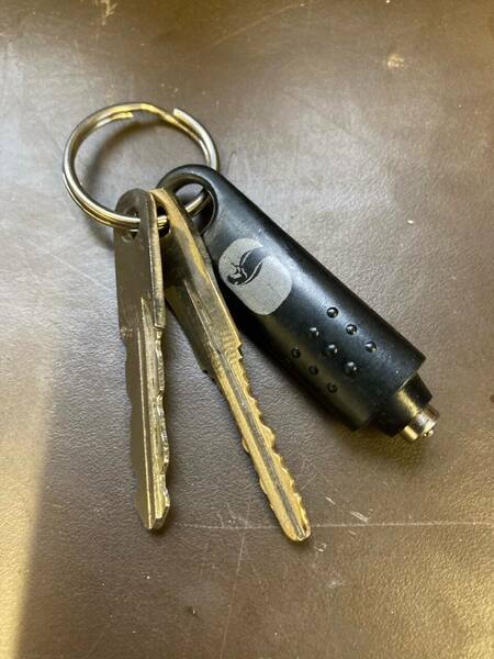

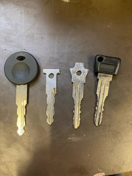

i bet I lose the buggers now !
  • gm changed the title to gm's unhealthy obsession with mx5s - weight saving (or taking the piss)
I hope the springs are weak in the locks. You haven’t left much leverage to get those keys to turn.
