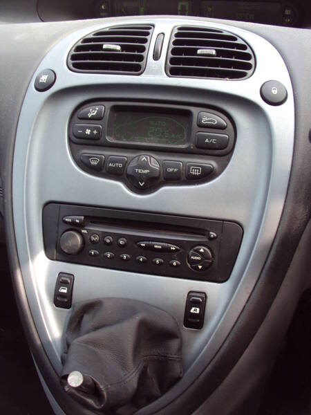

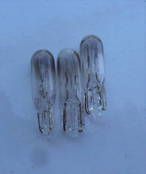

I have a collection of broken cars and today I thought that after a couple of years it was time to replace the bulbs in the Picasso air con display
This is the 1st time I done anything like this so I hope it turns out ok

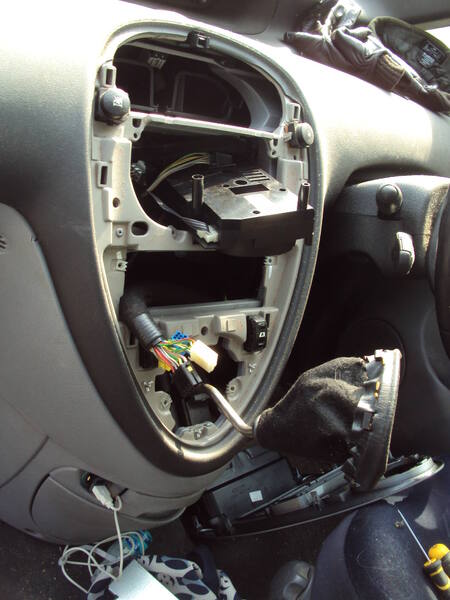

So 1st off removed  the end trims on the radio and then pulled the gear lever gaiter and trim panel off which left me with this, after which it was easy to replace the bulbs.
I replaced the gaiter as well and here it is finished.

You will not be surprised to know that a 18 year old French car has electrical problems. Picasso has radio on 24/7 and the heater blows hot on full speed and also cannot be switched off. Going to try remove a few bits this weekend after disconecting battery hoping that resets something.

The heater fan is as you say @RoverFolkUs. It comes on as soon as the engine is running and blasts hot air at the top fan speed. The digital display for the fan, air con etc is not working, disconected it but made no difference.
Going to try disconecting the battery to see if that changes anything. I suspect the heater resistor might have failed but dont understand how this affects the radio. Mind you if changing a bulb or fuse is not a cure its beyond my electrical abilty.

With climate control I suspect the issue to be a bit more complex unfortunately. It could be a faulty resistor that's shorted but I doubt it
Worst case scenario, if the true cause cannot be found, you could just wire a flick switch in series to the blower motor
But my first suggestion is to unplug the climate control ECU/control module. If that switches them off, then that module is fried. If the blower still stays on then the motor is probably shorted internally

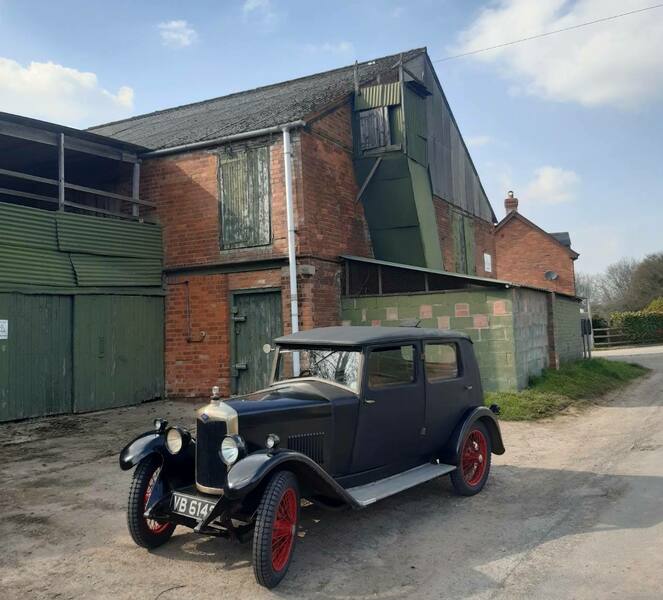

This is my 1936 Riley 9 basket case.
Anybody interested in reading about it on here. Progress will make a glacier seem fast

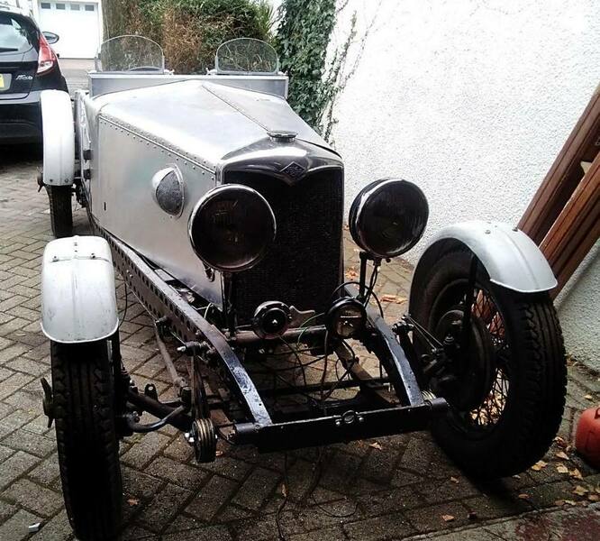

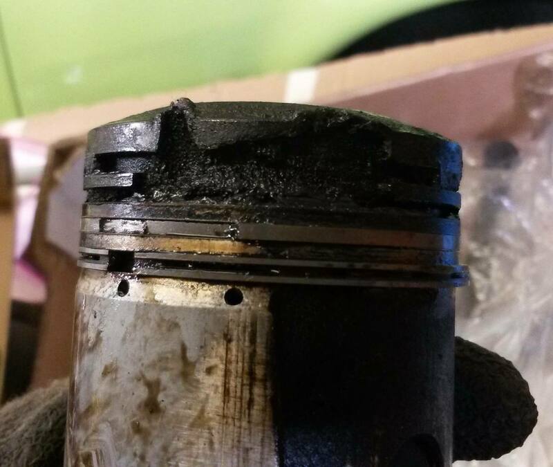

I have a complete running chassis, that is totally dismantled and knackered. The first problem is too find somebody to machine the front spring mounts,on the right (see photo )as they are welded into the chassis and then I can make some dumb irons and cross member. I do have 2 new springs so that will make  getting the front square. The chassis itself is 2 3mm U sections pushed together
Engine is need of a rebuild as the white metal on one big end detached its self living a very scored bore and piston

No there is nothing available as far as i am aware. I intend to make a triangular jig to bolt to the chassis through existing holes so that i can be sure of the mount position.
I then intend to cut the mount off and use it as a pattern to get a pair made. The other question is the grade of steel to make it from

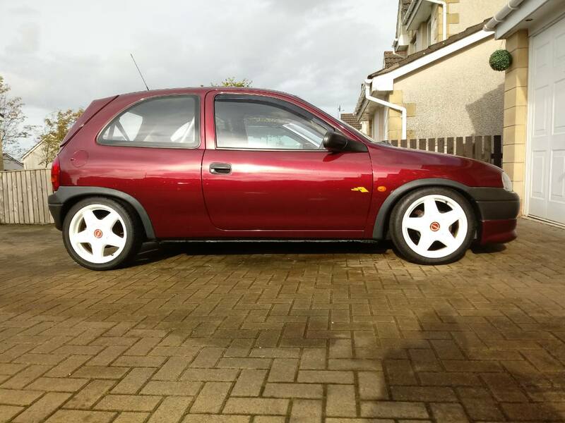

Have a pic of my Nine for inspiration...

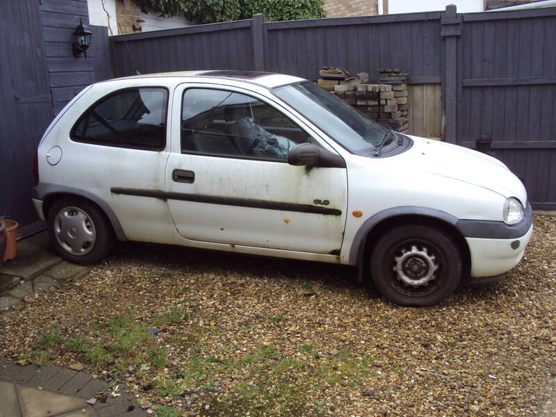

Sent the Corsa for scrap today, owned it 16 years. Too much rust appearing on seams.
