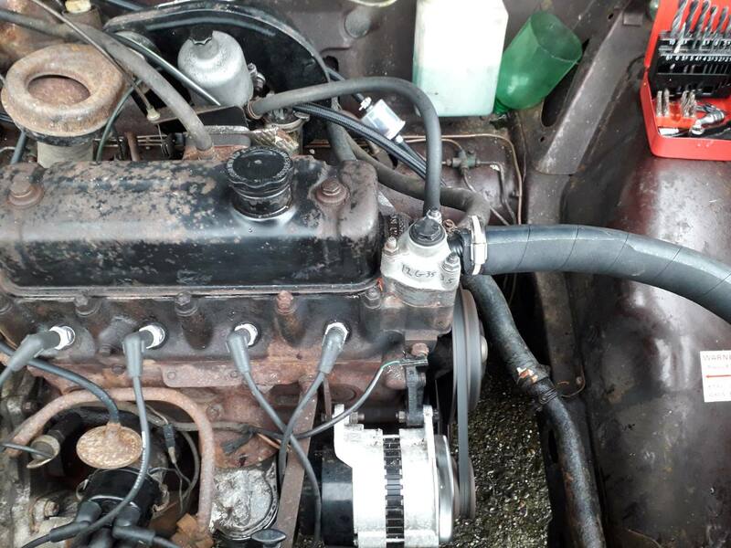

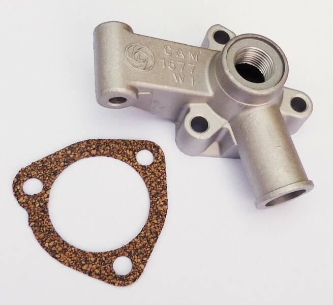

Some progress has been made...this is the closest I could get, it's meant for a 1.3 Marina apparently.
The observant amoung you will note that, owing to the outlet being at a slightly different angle, the top hose no longer reaches so I will have to hunt around for something as a suitable replacement.  I bought a length of generic hose a while back and this is plenty long enough but just kinks in the middle instead of curving so still scratching my head on that.  Still looking for a replacement stud, too.

Thanks but those don't have the fill port on top, the one I've got does and it's the only way to fill up the system properly.  Just need to get a slightly longer hose.
Oh good shout, yes it may well be, I'll get the tape measure out when I'm next out with the car and see what size I need.  Cheers!

These might be the studs you're after: https://www.ebay.co.uk/itm/BMC-B-Series-Stainless-Steel-Thermostat-Housing-Studs-Washers-Nuts-3/264855154869
The MG B version of that housing might work?  It looks like you could rotate it around and then chop off that sticky out bit if it was in the way of the rocker cover, still gives you the fill port in the top and puts the outlet angled towards the radiator.   https://www.ebay.co.uk/itm/Thermostat-Housing-Gasket-GTG101-for-MGB-MGBGT-Leyland-part-CAM1577/192096093599

One broken stud out, one new one installed.  Small steps, it tipped it down about 5 seconds later.  Only problem is my new stat housing outlet pipe is too small.
The other 2 don't look that clever - are you going to replace them while you're at it?

I had the same thought after looking at that photo, I bought a stud extractor which had the old one out in seconds, so they may come out OK.  They're smeared in copper grease so they look worse than they are but now I know the one I bought fits then yes, I will swap those too.

Incidentally, this happened at the weekend.
New flexible top hose, new stat housing, new studs.  Refilled and back in operation.
Sort of.
The housing is meant for a Marina 1.3 apparently, so while it is the closest to the original I have found, the outlet pipe is too small.  I cunningly fixed* this by wrapping the outlet in insulation tape - this has actually worked and formed a watertight seal but it is hardly ideal.  It will do until I can find the correct housing.
The second issue was indeed fortold.
On 1/20/2021 at 9:54 PM, Mr Pastry said:
You only need to get the broken one out, that is quite enough trouble.
The man speaks truth.  I decided that, as the threads were somewhat ropey on the other two studs, I'd replace them if they'd come out without a fight.  One came out with no issues at all, the other one appeared to rotate quite easily and then snapped off flush with the base.  Sigh.
I drilled it out - fortunately it's hollow underneath, meaning the ends of the studs sit in coolant, but it did mean I could clear out the hole reasonably easily and by packing out the inlet with cloths, didn't fill the cooling system with metal swarf.  Unfortunately the threads are butchered, so while the new stud did screw in, it wouldn't grip.  I then discovered that 3 of the 5 pack of nuts I'd ordered were defective and when screwed onto the new stud, mullered the thread and got stuck.  Sigh again.
In the end I re-used the one intact stud and sealed the housing with some red instant gasket, carefully cleaned off the inside of the housing so it didn't end up in the coolant, as I didn't have a proper gasket to re-use.  This sort of worked but it does produce a steady small dribble of coolant onto the head from the dodgy stud thread, causing much steam.

*  Fit the correct stat housing - I've ordered the MGB one as suggested by @vulgalour above to see if it's a better fit

Brief update: The MGB housing was exactly the same so no improvement over the Marina one, same diameter outlet.
