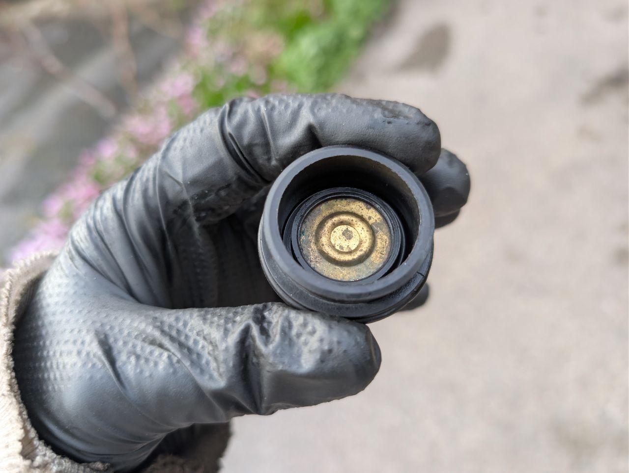

I had exact same engine in a Vectra boiling up like that. I'd dropped the cap while topping up by accident and my dog ran off with it (true story), dog was unharmed but the cap was a little bit chewed. New cap sorted it for about £20 from Vauxhall. The expansion tank can have little cracks in it and that has the same symptoms.

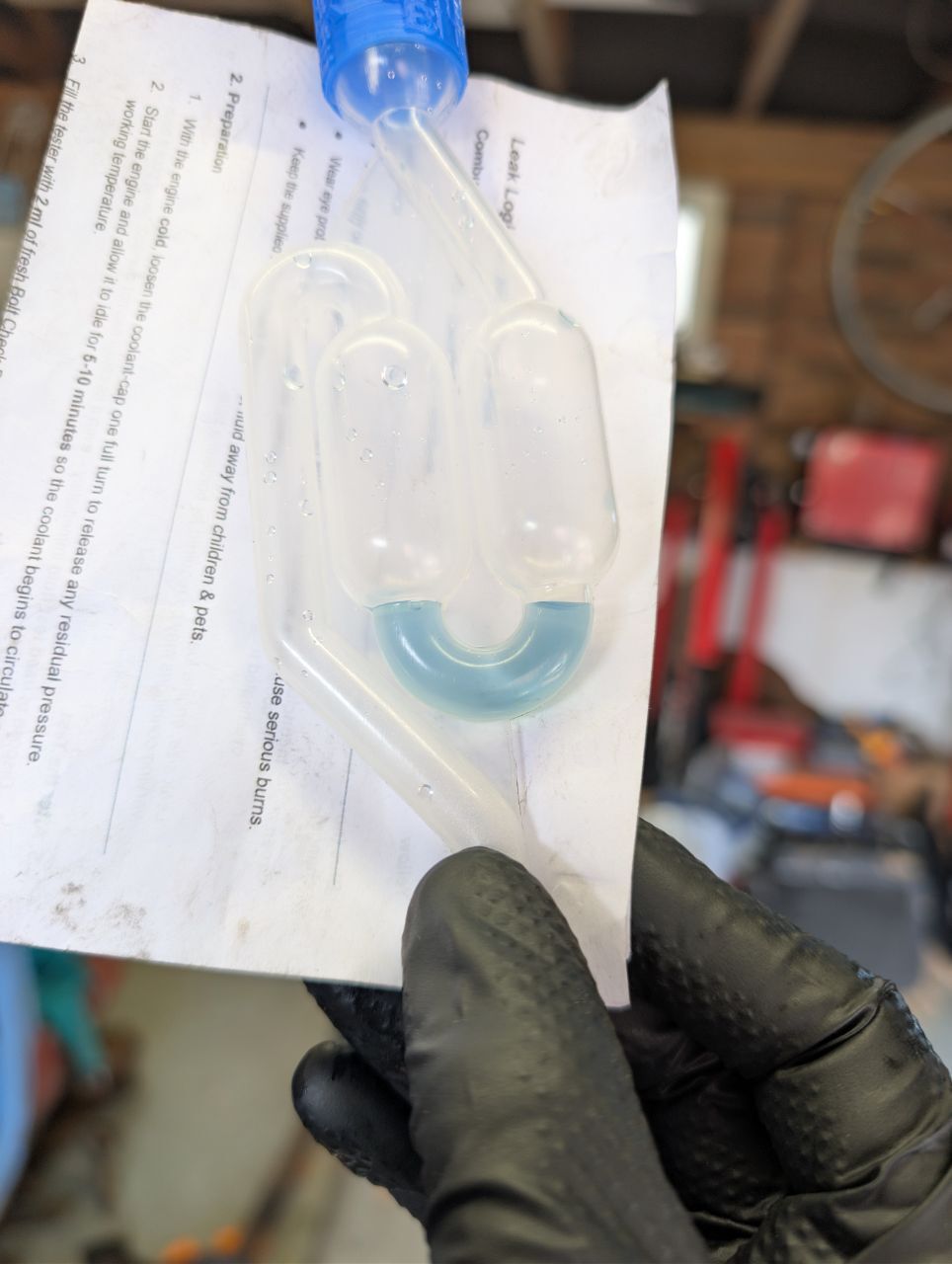

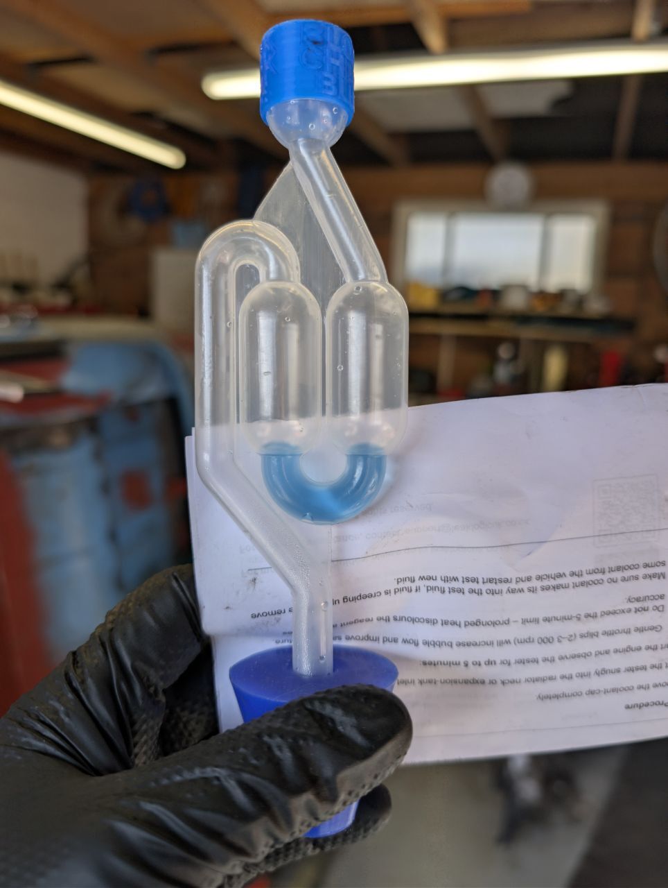

Hopefully it's hardy enough to not have done the hg 🤞

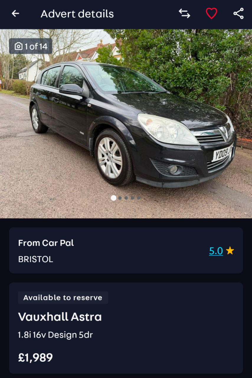

As an example looking for a cheap auto that's sub £2k on autotrader near me...
This is the correct option:
https://www.autotrader.co.uk/car-details/202602029602392?utm_source=share&utm_medium=android-app
But scrolling down to the next car is the one I'd go for:
https://www.autotrader.co.uk/car-details/202602139912941?utm_source=share&utm_medium=android-app
One is simple, reliable and cheap to run from a dealer that has good reviews. The other is a complex, needy and £700+ tax bracket car from a dealer with zero reviews.
But that's more my problem than the cars themselves.

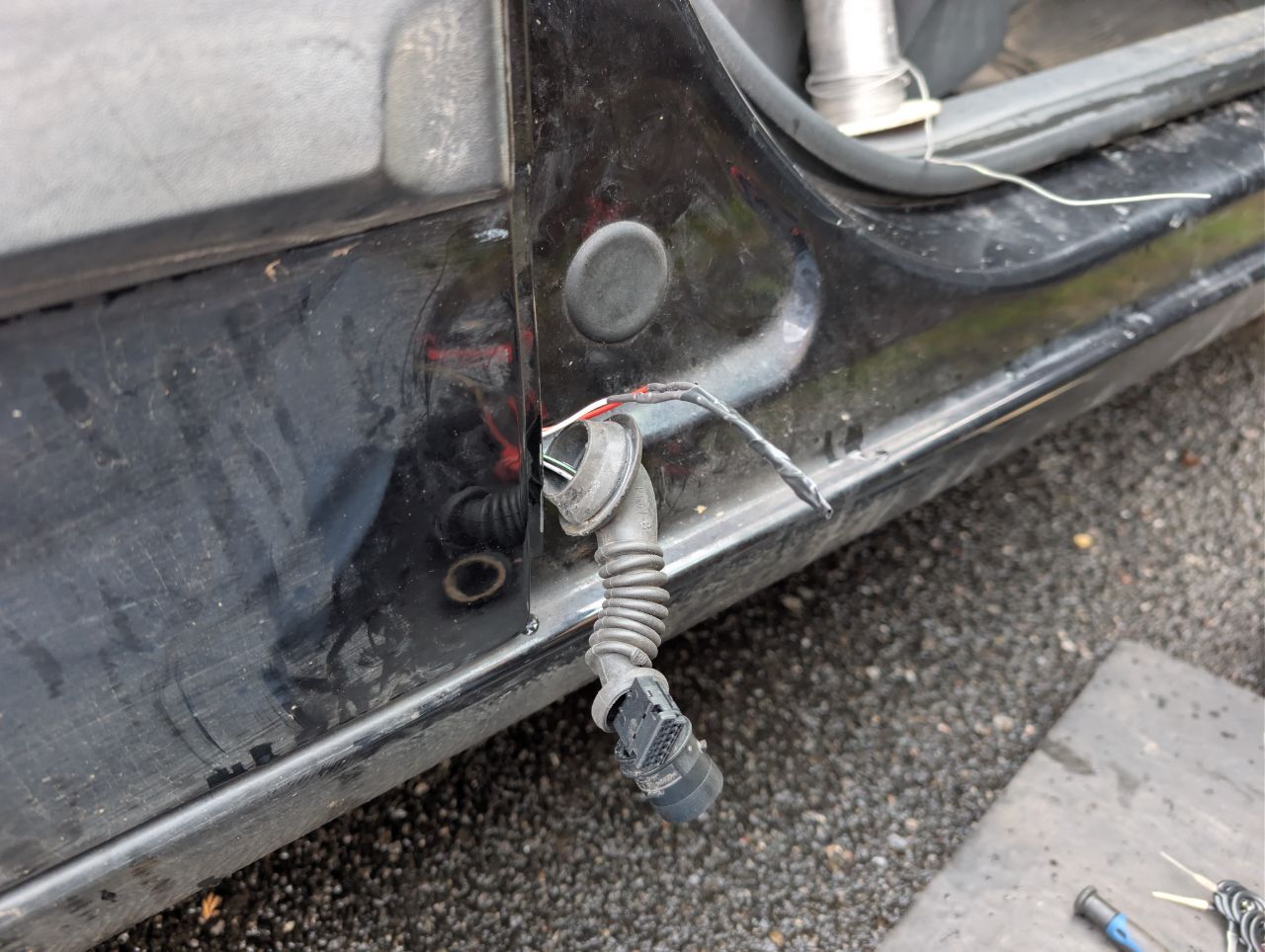

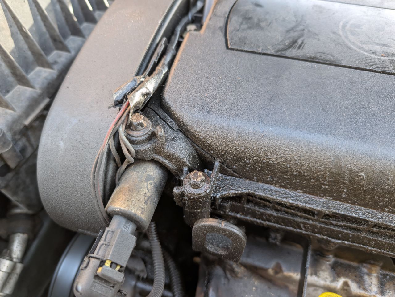

AVAS. At least with door wiring and as common issue as VAG of this era is with door locks. Actually wasn't too bad a job to sort this. A couple wires snapped and a few in the process of doing so. All soldered up and heatshrinked.
After replacing the fob battery, all doors now lock and unlock on the central locking again. That door had a habit of deadlocking shut and not opening. I managed after a bit of fiddling with a Tech2 to get it open and she left it open when it had its MOT so it didn't fail on it.

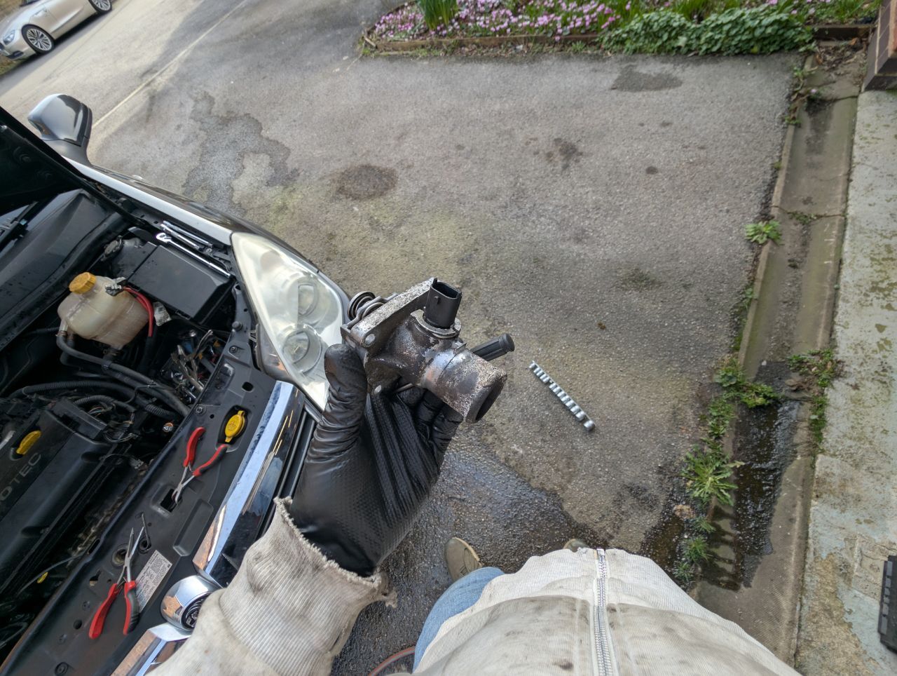

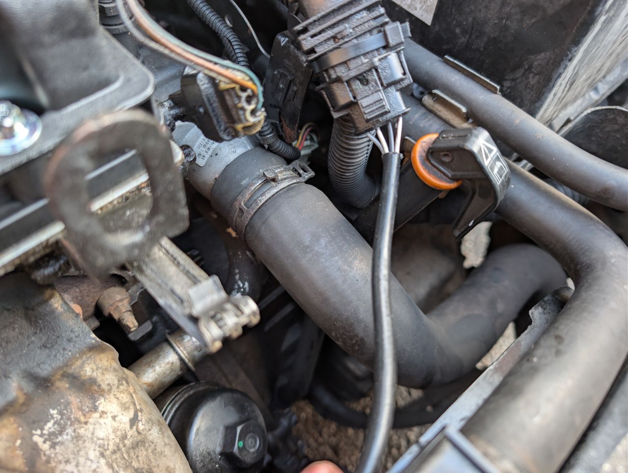

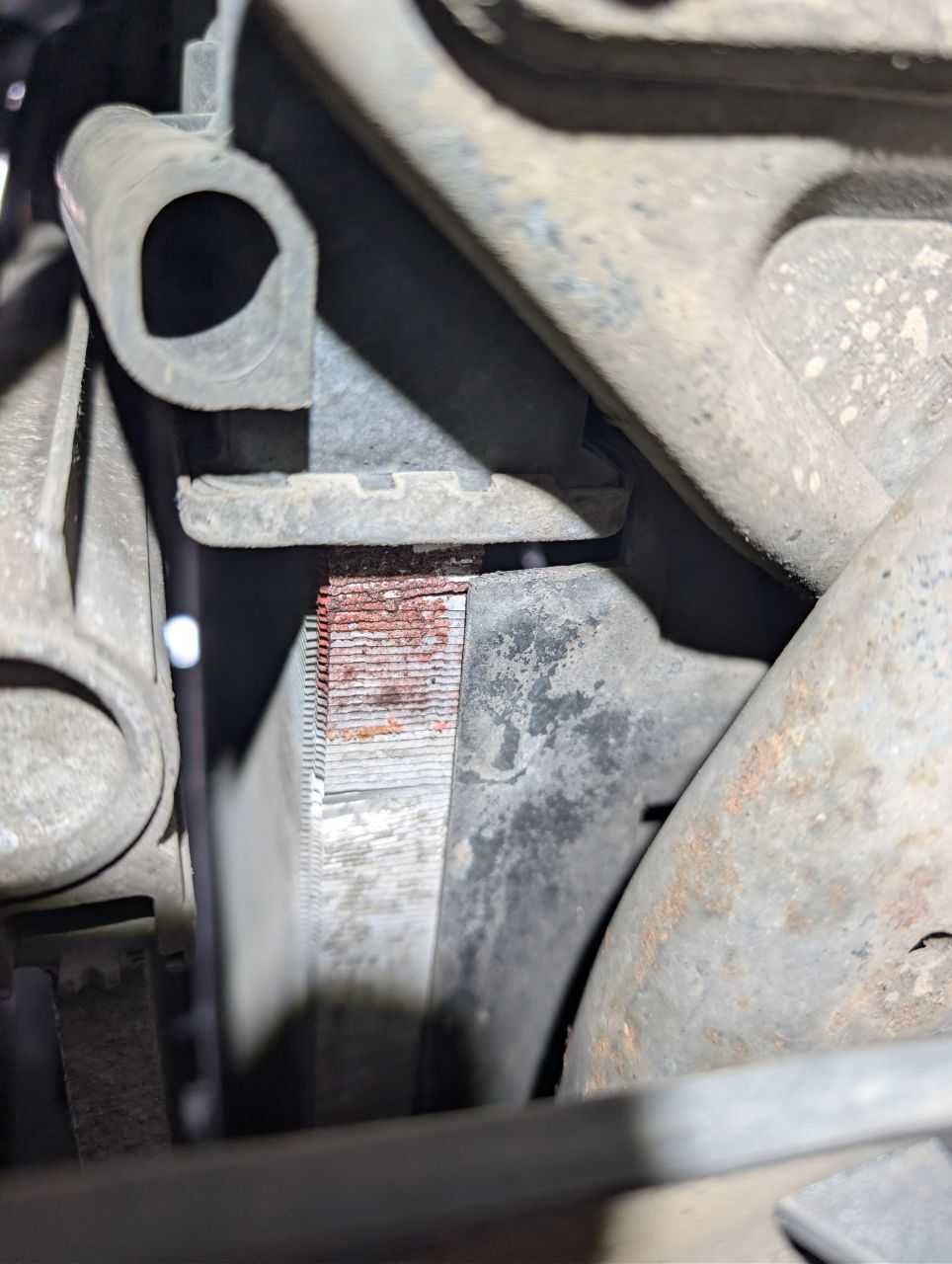

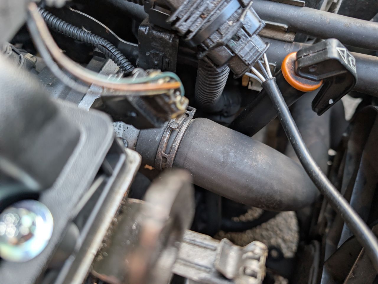

This is the bulge on the top hose. Not ideal but I don't think it's at risk of imminent failure. (Actually looking at it, I think worse than I remember!)

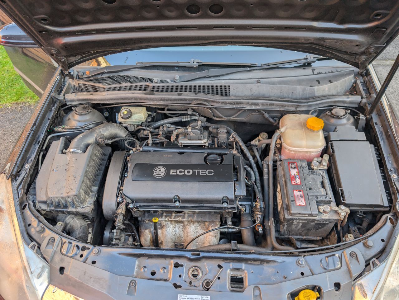

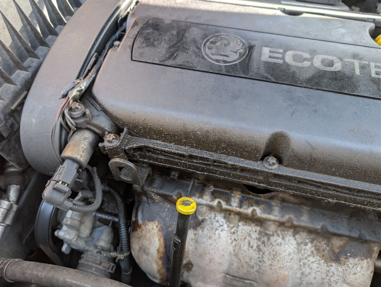

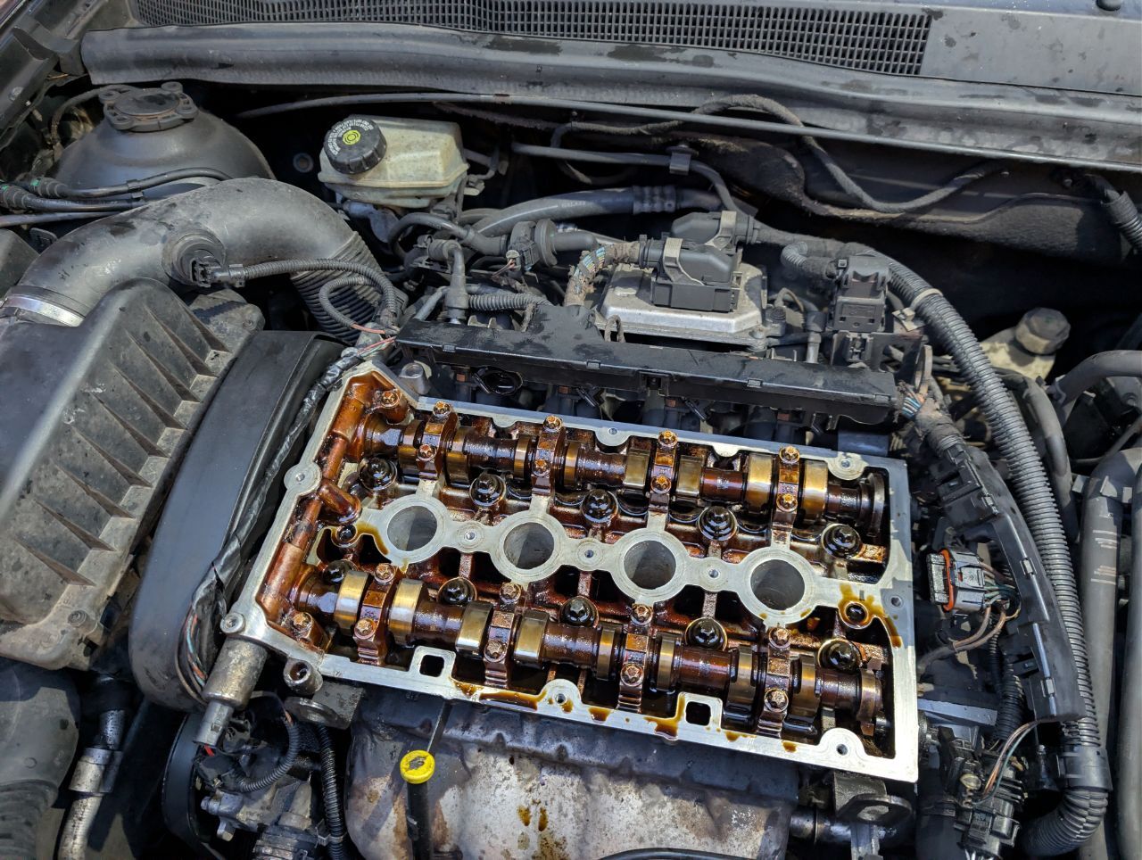

Anyway it's all looking much cleaner under the bonnet with it's fresh valve cover. I gave it a wipe down to clean off some of the crud and made it a bit more presentable. Still smells a bit from burning oil but I think that's just where so much was on the front of the engine, the remnants are dripping on it.

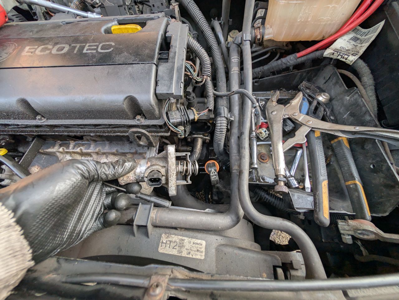

Cap arrived when I was doing the door loom so fitted that. Replaced the pollen filter - albeit the one that came out was in not bad condition. Then gave it a quick hoover and a quick Steve Wonder car wash (did it in the dark). Just to make it feel a bit fresher for her. I always think a clean car makes it feel so much nicer and I don't understand how people can drive around in something filthy.
She came over earlier and we took it for a spin to get it up to temperature again to check the new cap was behaving. It now seems to like to sit at 99c when up to temperature. I presume the correct coolant is helping do that versus straight water when I was testing.
I thought the thermostat had a coolant temperature sensor connected to it but I'm not actually sure that is the case? I need to look at the one that came off but I'm wondering if it's one of these electronically controlled thermostats like BMWs have? Basically they have a little heater to heat up the wax in the thermostat to allow it opening earlier. Thus can control more accurately the operation of it.
Then she chucked a bit of petrol in, dropped me back home and she went on her way. Mrs SiC said she got home safe and it "drove like a dream" in the 15 miles back. At least it's not filling the cabin with steam now. I forgot to say that when it arrived yesterday, her sun was curled up in the front seat with a hoody on as he was getting blasted through the air vents from the coolant steam. 😳

I've done that door loom a few times now! The fun part is getting the deadlocked back door open. Luckily zafira B door cards bend very well and I ripped it off the closed door but for the passenger side I went in through the speaker hole and twisted the snapped wires together enough for the central locking to fire and the door opened.
Had to do it on my Xsara too though, both front doors have had it done. I checked on my qq and it's bodge free (for now).
When my initial repair on the first door failed a year later I spent half an hour and pulled the B pillar trim out, pulled the entire loom back through and replaced the cable runs right down so the spider joints were nowhere near the bendage. It all outlasted the car.
Had to change the rocker cover gasket on the 1.6 meriva mostly because it leaked down onto the exhaust manifold and the ex didn't like the smoke and smell that produced 🙄

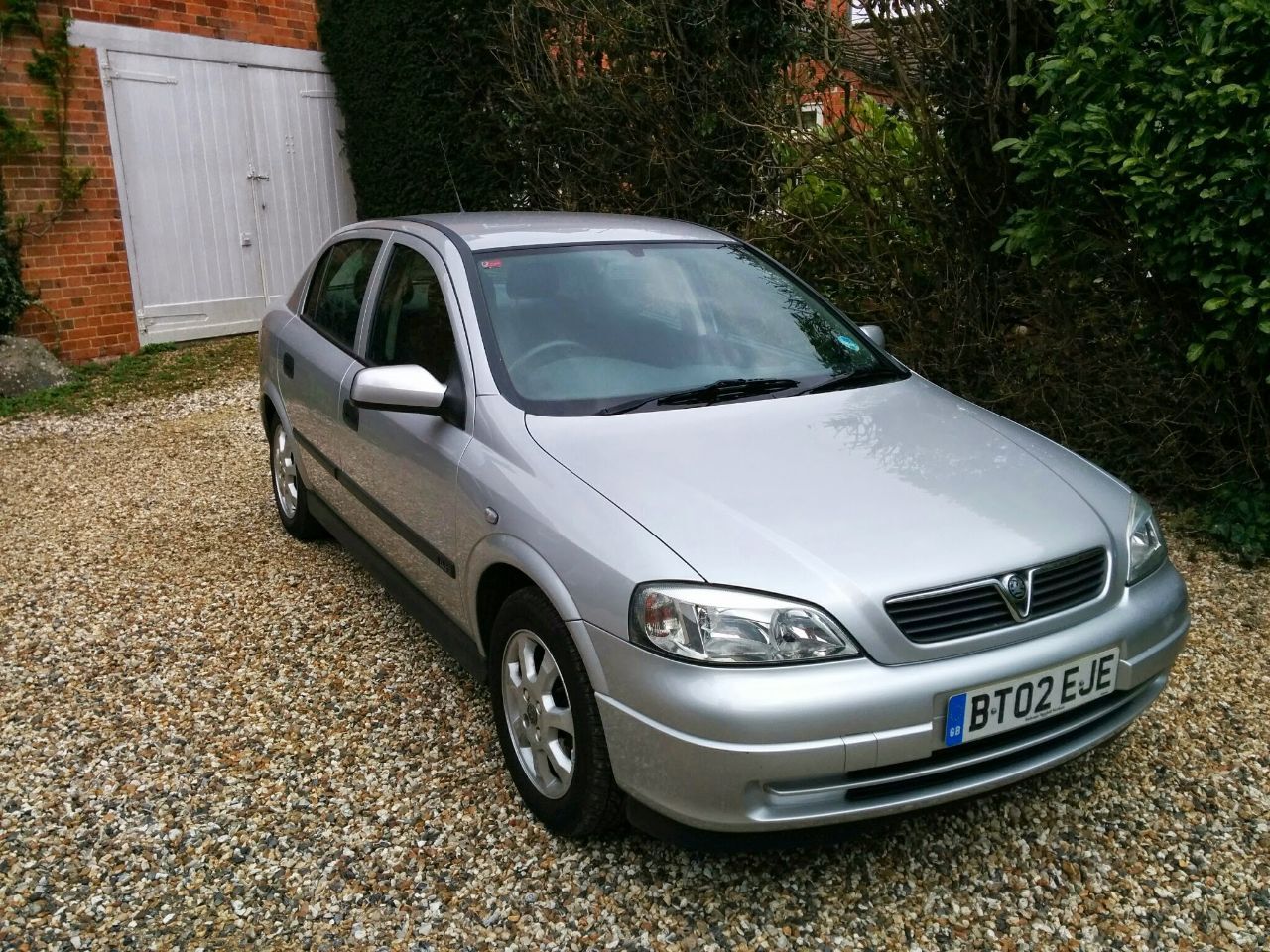

Another Astra cockroach story, this time that engine and model.
One of Mrs SiC other friends many years ago was breaking up from a pretty toxic relationship. Massively in debt (her partner put all the loans in her name) and still a lot of finance on a Smart fortwo left to pay, she was in a pickle. The Smart went back to the dealer but her credit rating meant no chance of buying anything new.
Her uncle found her a nice Astra G 1.6 16v Auto. Again she had an auto only licence from a dodgy left leg making it hard to use a clutch. This started playing up and misfiring all the time. A few different garages looked at it but couldn't figure out what was wrong. Countless coil packs, plugs and even timing checked. Everything was coming out okay. Problem was that the misfiring was knocking it into limp mode and giving no power. Even worse for someone skint, it meant it was running in Open Loop mode and burning huge amounts of fuel. Mid teens for the most part on motorway runs.
As she was doing a 30 miles daily commute, it was hurting her finances hard. Double edge sword of needing to go to work for money but no money to pay for a replacement car due to the Astra burning so much fuel.
So I offered to take a look at it. Had a good poke around and found that the retaining clip for the injector wiring harness was missing. I didn't have any clips but I had plenty of zip ties. So I strapped down that wiring harness that connected to all the injectors off a long plastic bar with zip ties.
We took it for a test drive and it ran perfectly! I advised her to take it to a garage for them to fix it properly.
Naturally that was never done...
Anyway about a year later it started misfiring again. Those zip ties had stretched and were no longer keeping it all electrically together.
This time she was at her uncles. Her resourceful uncle found a block of wood that fitted perfectly between the bonnet and injector harness to push the lot together perfectly.
That's not the whole story of that little Astra G.
It hadn't had an oil change for quite a long while and it was rattling. Even worse the oil light was coming on during some drives and on occasion the 'service warning' light. Taking a look I found zero oil on the dipstick. After putting in over 3.5 litres (4.5l total from memory) I got the level back on the dipstick. I advised an oil change would be a good idea.
Which she did.
On the drive back from the garage the engine light and service light came on. Thinking it was the block of wood had moved and needed reseating, she popped the bonnet to sort it.
Except the block of wood was in place.
No, it turned out that the garage doing the service didn't refit the oil cap. The engine bay was covered in oil where it was flinging it out from the cams.
Naturally she was fuming. She put the cap on and drove the 5 miles back to the garage for them to sort.
She thought the engine light was a warning that the oil cap was off. Actually it seems if one of these engines is abused enough and have so little oil, that it'll rattle enough to trigger warning lights as it thinks the knock sensor is giving false readings...! The engine light was on for the massive air leak from no cap. The 'service light' as those that really know Vauxhalls/Opel is not that it needs an engine service but that it has a fault code stored (and saying that it needs to see a garage) which was the knock sensor warning.
That Astra G continued to run with it's block of wood under the bonnet and rattly engine that had been oil starved a good number of times for a good few more years when the gearbox shat itself and it was scrapped. In total she put on a good 50k miles in those few years and allowed her to start getting out of her financial pickle. Any time I ever mention the car, it gives her fond memories of the grubby looking white turd that allowed her to get around while she got her ship in life back on course.
I have found repeatedly opening/closing it while operating both the handles can catch it mid mechanism change that you can open it again. That's what I managed to do on this.
You can just about get the rear door plug disconnected with the front door open. That was the backup plan. Front doors you're a bit more stuck on that and likely end up with cutting door cards as you say.
