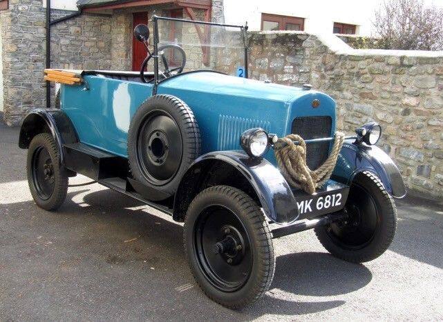

Popular Post plasticvandan Posted April 2, 2020 Popular Post Posted April 2, 2020 A rare thread from me, inspired by the super sentinel thread and now being on furlough for three months I thought I would start a thread on what I'm doing,though progress had been rapid so far so no doubt other projects will get done too! A bit if background,after years of wanting a vintage car,to complement his vintage bikes,my dad bought this 1925 Trojan Utility car in late 2018. A well known car with a trials history dating back to the late 1920s,heres a pic of it now and in 1929: Anyway the engine had supposedly had some work done on it before he got it and my dad drove it about three times before it cut out and had to be pushed back in the garage.on trying to start it (hand lever pull start) it got tighter and tighter until it locked up solid. Eventually he craned the engine out,a bizzare four piston but two Conrod 1488cc two stroke,and eventually managed to pull the crank out with pistons,it has a blind head as the block is all one piece,so no tappy action to be had at the piston end. Doing that in January combined with arthritis and a lack of enthusiasm,and the death of my grandad in June 2019,the engine has laid in bits strewn about the car ever since.Following my moving down to Dorset to live with him after my marriage breakup,I've long been meaning to get into it and sort it out once and for all,and now being off from Wednesday for three months,it was the perfect time. More to follow Stanky, Mike D, strangeangel and 78 others 81

Uncle Jimmy Posted April 2, 2020 Posted April 2, 2020 Bloody fantastic. Love the shank of hemp rope slung about the front. Do they have any form of suspension at all?
Tigerfox Posted April 2, 2020 Posted April 2, 2020 Lovely car Well you wont get nicked for speeding anyway, anything over 30 is i recall is unusual. I take it has chain drive to the nsr wheel ?

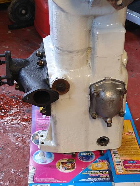

plasticvandan Posted April 2, 2020 Author Posted April 2, 2020 First thing to try and work out was why it locked up,cold and just on the starter.the pistons were still tight in the bore when the cover that goes over the crank was removed,and the white metal bearings all looked good.On removing the crank my dad found s fair amount of carbon build up on the ring grooves,which he cleaned out before the work stalled.I decided that the problem must be with the rings.Now,I can't find any reference material giving ring gaps,the manual simply says if you have any piston problems to send the engine to your dealer or the factory.... I found a calculator online that suggests ring gaps should be 0.04 X bore size, this has a 2.5" bore which gives a 0.10 gap. On removing the rings and trying them in their respective bores,which my dad had honed beforehand,I found the problem.Nearly every ring had no gap whatsoever! No wonder it locked and ran fairly poorly beforehand. Armed with that knowledge I filed all the rings down and got them all pretty close to ten thou. After cleaning the crank went back in Added some lubricant and success,it spins over nicely.madevs new gasket from greaseproof paper (can't be any thicker than 0.05" according to the manual) and added wellseal Assembled back together and tightened down and it still spins over,so hasn't tightened up which is good news. Today's job was two coats of enamel Then made new gaskets for the manifold and side flame traps,painted manifold and refit oil lines Got the mahoosive flywheel extracted from the 2 speed band gearbox and found my first problem,the self aligning bearing had broken,so now got to find one before I can refit the flywheel to the engine.ince that's done it can be craned back into the car. Coprolalia, LabRat, HarmonicCheeseburger and 38 others 41

plasticvandan Posted April 9, 2020 Author Posted April 9, 2020 Update time! A new flywheel bearing was needed,an imperial (obvs) self aligning bearing,which put a hold on things over the weekend,dad had found one last week and it arrived Monday and was dropped in after heating the flywheel Then attached and a new gasket made for the water jacket cover Tuesday was heavy lifting day! And the rest of the day spent bolting in and reassembling the hand starter All working,Wednesday was getting the ignition working again,carb and exhaust attached and: VID_20200408_192801938.mp4 BeEP, RayMK, spike60 and 26 others 29
plasticvandan Posted April 9, 2020 Author Posted April 9, 2020 Carb needs a strip and clean,needed doing before,it floods trying to start then does t get enough fuel to keep running.but I wanted to leave it till I had checked my engine work was ok and that it would actually run before messing with it,overall I'm really pleased,exactly one week from a dismantled engine in various places under the car and tubs of bolts to back in and alive,oh,and this is what my arm now looks like after a day of pulling the starter,this is why people weren't fat in the 1920s! Sudsprint, outlaw118, LightBulbFun and 9 others 10 2
