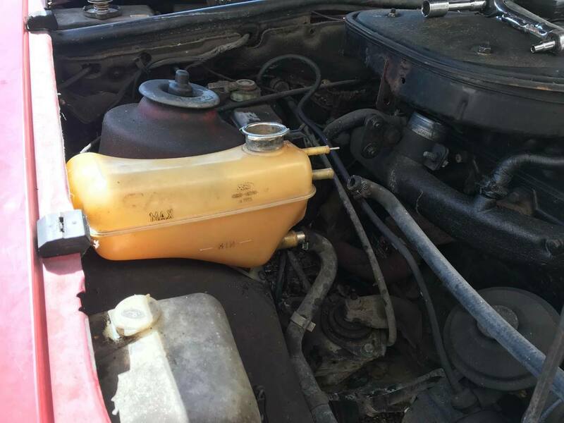

With the mighty 67hp Indenor running like a peach I treated the cooling system to a flush, back flush, de-algae'd the expansion tank internals and generally made it look less like a artefact that had lived through the industrial revolution. Car maintenance karma reared it's head at the end of the mainly smooth job by allowing me to snap the spade of the gauge temp sensor on the thermostat when jimmying the top hose back on. A few internet pennies later and it now has a new temp sensor in there.

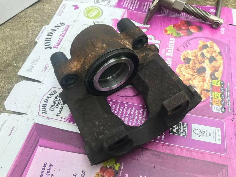

The front brakes were really satisfying to do, eventually.., once I'd finally got all the new parts together. I HATE shopping, particularly over the internet. Some time last year I'd replaced the exhaust on the Volvo 440 using AutoDoc - credit to them they had what I wanted - but it took months to arrive, so I knew to avoid AutoDoc and instead went for EUspares. Imagine my harumph when the confirmation and invoice email came through on AutoDoc headed pages! Needless to say 3 of the last 4 weeks have been waiting for the bits to arrive.
I could then rebuild the wonderfully simple callipers with new seals and pistons, put on new flexi's on and discs and pads. mmm. Love a good brake job me. I did have to evict some woodlice and arachnids on my way, but I'm sure they'll have just moved into one of my other heaps.

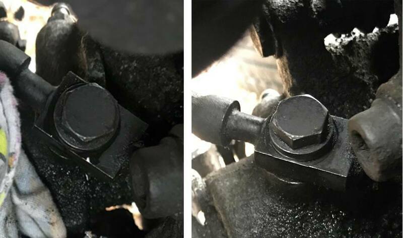

Contender for most simple fix: The “leaking” rear calliper simply needed the banjo fitting tightening on the calliper side of the flexi. As suspected from the paperwork, this calliper was new about three years ago and the garage that did it clearly didn’t tighten it up fully. I cleaned up the fitting, wailed on the brake pedal and sure enough I was greeted with brake fluid. After tightening it up to BeyondSpec Nm I tried again on the brake pedal and all the fluids stayed in the braking system.

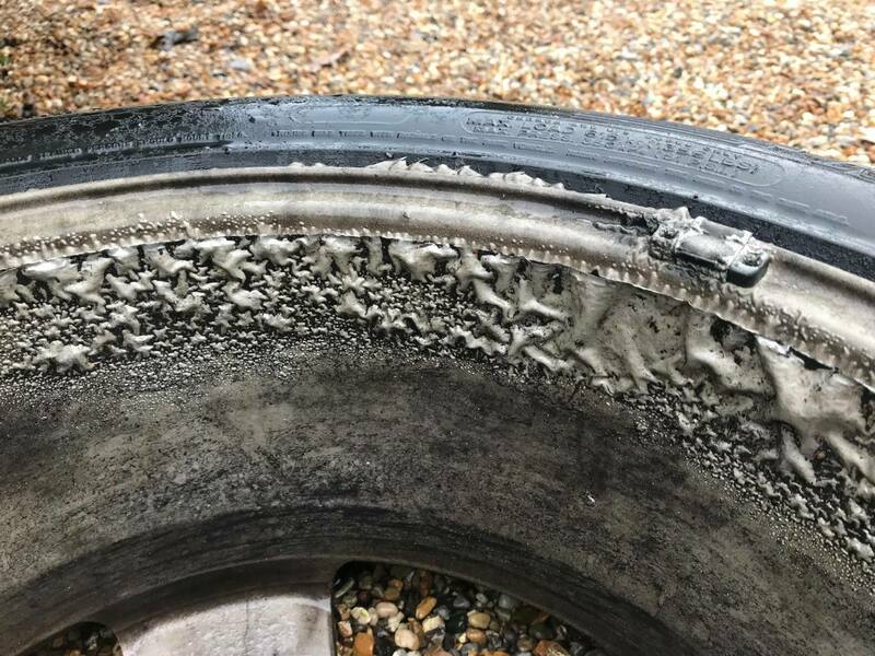

The downside is that three years of a weeping rear calliper has melted the paint on the rear alloy. And the spare as the tyre died too and the PO just put on the spare rather than work out what was going on.
Cleaning up after the “simple fix” was more of a pain. I stripped and cleaned the alloy inner dish on the two trashed wheels and protected things as best I could with a simple Hammerite brush job. It’s not so visible being behind the wheel face so was deemed sufficient.

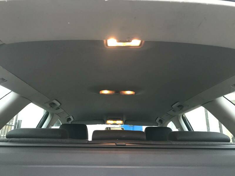

My recent long trip did teach me one thing about it though: the droopy headliner is really annoying tickling your scalp all the time! Buoyed by success of doing the Volvo 480 headliner I decided to take on the headliner in the Audi using some spare foam backed material a friend had given me. It was not as nice of a job as it was on the relatively miniscule Volvo headliner!
The main problem was that although the glue had broken down, it had not turned to dust like it had on the Volvo, so cleaning up the headliner board was a big claggy mess of a job.
I stuck it down in stages and trimmed it afterward.
The end result is a great improvement! In some of the photo’s it looks a bit creased – but the new material was stored folded for about a year, so as the foam plumps-up I’m hoping they’ll soften. It’s a shade darker than the original, but for a free fix on a car I’m planning on selling I’m quite happy. The pillar and door trims had a few clips or alignment pins snap, but it’s gone back together securely enough.

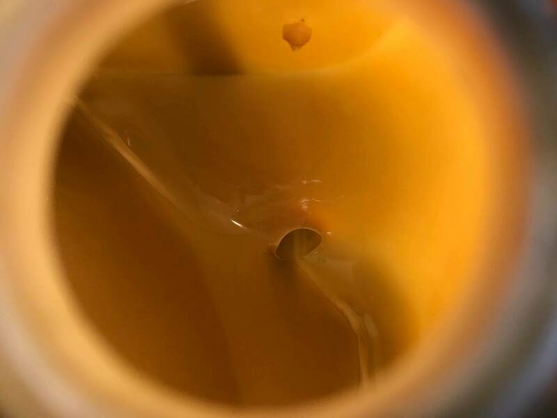

I’ve also changed the fuel filter. There’s 3/4 a tank of this rancid diesel in the tank, but the mighty Indenor seems to gobble it up readily. I get the feeling it’s not a fussy engine.
Did you clean out the fuel filter sump/ “crud accumulator” I hear no-one ask.
Yes. I also changed the seals, pre-filled it with the minging diesel, then proceeded to knock it over when trying to refit the bugger spilling about half a litre of diesel all over the engine bay and gravel. Damn it. At least I won’t have weeds for a bit. Primed and started up ok though, so job jobbed despite the spillage.

Erm red diesel isn't supposed to be in road vehicles....
Has polished up well though! What polish did you end up using?
I'm pretty sure you could just chuck totally unfiltered WVO in there fresh from the chippy with no issues. #sustainable #climate #gretahasawideonforsierras
I think that could probably run on liquidised pig shite with no issues.
Red diesel is cherry red right? Pretty sure you’re joking and this is just what happens to diesel sat in a Sierra for 20 years. Got me worried now, I don’t want any trouble. I was like that when I got it Mr. Officer. Maybe I’ll flush it with some vegetable oil or liquidised pig shit (whichever has the least tax on it) as @MrDuke and Mr. @greengartside suggest. 👍
It does look like red diesel. I wouldn't worry too much about it, to purge the fuel tank if you want to, tap the return line to a container and run the engine, diesel pumps return much more fuel than the engine combusts.
Before you put veg in I would check the fuel pump type.

11 hours ago, rob88h said:
Meguiar’s Ultimate Compound. Then Meguiar’s Gold Class Carnauba wax on top. It’s come up really well but photos do flatter it (as ever).
Nope that's cherry you've got there, old diesel doesn't change colour unless it has a significant bio content in which case it goes black and lumpy.
Shouldn't worry about it personally, just top up the tank with white as it does go off slightly.
Diesel does go off a bit over time, but not anywhere near as badly as petrol, and I've never personally come across a diesel no matter how long it's sat that provided the tank wasn't full of water that wouldn't run off whatever was in the tank, even if it's been sitting in a hedge for 30 years.
That does look like red diesel though - I'd not worry unduly though.  Just dilute it down by adding fresh to the tank as soon as you can.  The odds of you getting stopped and checked in a classic Sierra are negligible.  Now, if you were in a scruffy ass white Transit, then I'd be more concerned!
Agree on all counts that you've got a tank of Red diesel there.  It matches the red car tho.  Run it down as far as you dare and then fill up with fresh pump diesel.  Jobbed.
If it has gone off a bit, a single litre of 28-second oil (home heating oil or Kero) will help.  Don't put too much in as it's nowhere near as lubricating as 35-second diesel fuel.  If you're at all worried, put an equal amount of 28-second oil and fresh new veg oil in (maybe 3 litres of each) and marvel at how much quieter it makes the engine (a bit) and how much it now smells of chips, despite it only being a small percentage of the tank contents.
Or just ignore it all.

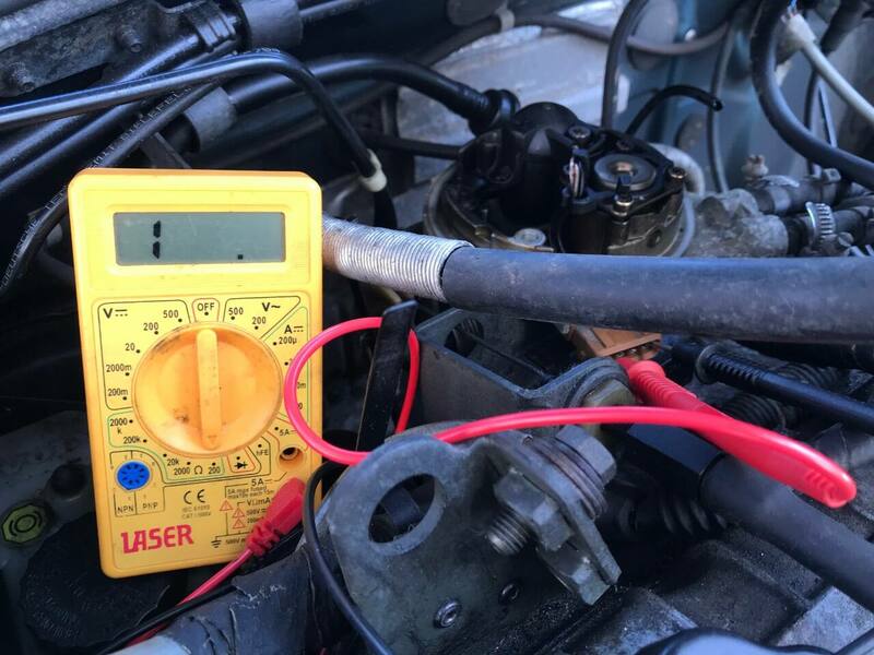

These 1.8i Volvos run some form of Bosch Jetronic integrated fuel and ignition EFI type deal. Something is clearly misread or misunderstood at the ECU. Most likely something to do with temperature effects.  After a bit of research, I have found I have the single point injector type. It doesn’t use a MAF but instead monitors Intake Air Temperature and Manifold pressure. PRIME SUSPECT. Running like shit when hot ambient air is about, after run and parked up or after steady cruise.
The connector block for the Intake Air Temp sensor and Fuel Injector is shared. The Injector resistance checks out.
BINGO! Intake Air Temp sensor is reading as an open circuit. The poorly Volvo doesn’t know when it’s eating hot air and and the ECU isn’t switching fuelling or timing maps hence running like crap.

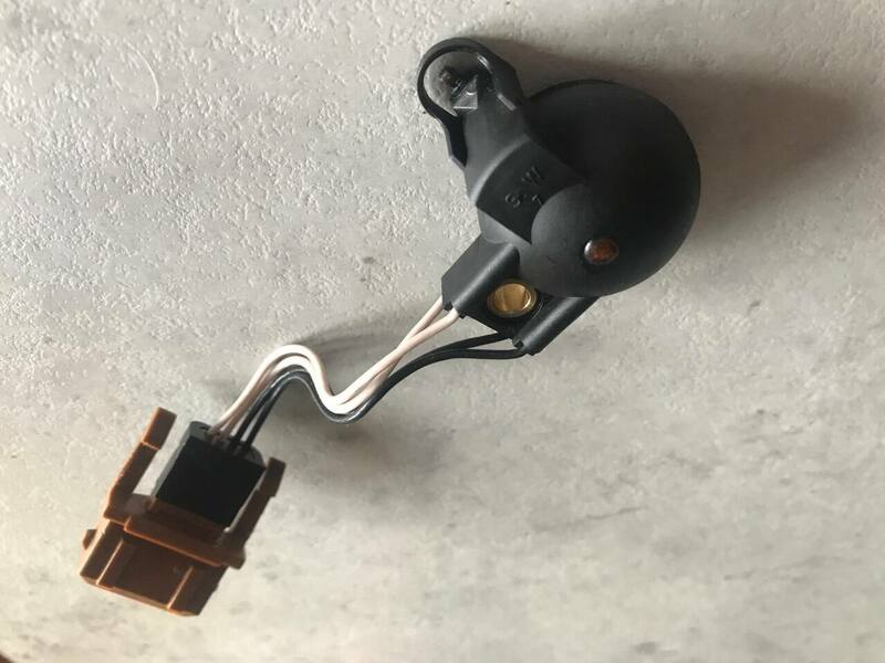

Try as I might I could not find a replacement part for the upside down picture, so step in a breaker:
For what we are about to receive may the Lord make us truely thankful. L_FPE gave it’s life so others may live. 12 backfire salute. Etc.
With a replaced Intake Air Temp sensor, so far, so far, the running problem seems to be gone for good. I did the KFC drive cycle, the worst for hot air: A warm up, slow queue through the drive-through, engine off to nosh in the carpark, startup again and then drive off with an engine bay full of as much hot air as Donald Trump. It used to throw a fit doing this. Now it seems to cope.
